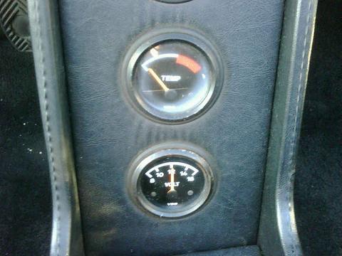

Attached ImageHello everyone, after being on the 914 club for almost a year, I finally decided to join the 914 world. I don't know what the story is but there has to be something in common here, other than the main topic of course... (IMG:style_emoticons/default/idea.gif)
Now to the main subject. I was driving on the highway at about 70-75mph for about a half hour yesterday and this is what my temperature gauge was showing. The outside temperature was about 80-85 SoCal.
[img]
As a matter of fact, the guage takes the longest time to get up. So, I guess there is only two things that can be wrong, the guage or the sensor in the taco plate. Is there a simple way to verify them? Is there some measurement that I can do with a standard voltmeter?
Thank you

Well, yes, you can do an ohm reading on the sensor, but why is your volt gauge showing 10 volts? I know mine does if I have the lights on and step on the brakes without the car running, but does yours read there all the time? And it should read slowly, oil takes a while to warm up. Do you have an external cooler on the car?
OK, if I do an ohm reading, what am I suppose to be expecting for a certain position on the gauge and what should be the needle position at normal operating temperature (80 -85F outside temp).
I have a stock 2.0 FI, no mods except Bursch exhaust.
The volt gauge is sort of random. It does move with flasher (normal) but I don't think the ground is proper. BTW, isn't there a better way of wiring the voltmeter guage to get an accurate reading (flasher or no)?
Thanks

I live in Anaheim Hills and that temp reading is spot on in SoCal.
Should be about 240-252 at the heads. I have an infrared heat meter and at full temp, the gauge indicator never gets past the T in Temp in this area.
And you have your foot on the brake in the picture. I can see your leg, but the gas pedal is clearly visible.
Mine doesn't go down to 10 volts, but brakes and signals sure makes it move below 12.
What is it at when your foot is off the brake? Should be 13.5V.

Also remember that the temp travel is shorter on the wide-red-band temp guage - as opposed to the later ones with the short red zone. IIRC the red zone on yours starts at about 450 deg., so divide up about 60% of the gauge arc & I agree with avidfanjpl/John above - you're about right for a 80 degree SoCal drive.

that is an oil temp gauge, not a head temp gauge. Therefore, it will take a longish time to get up, as you have to wait for 4 quarts of oil to warm up.
Oil temps and head temps can be (but are not always) unrelated.
Oil temps go up with engine revs. So, if you are doing a lot of driving in 5th at 70 you are only barely turning 3K rpm. This will keep your oil cool. Doing the same 1/2 hour run in 4th will raise your revs about 1000rpm and you will see your oil temps rise too.
As an example, before I put my secondary oil cooler in...
my way to work in the morning is 45 miles, mostly freeway, and almost all of it is downhill. The trip takes about 45 minutes, and at the end of it my oil temps may only barely be 190 degrees. The trip is in 5 gear, and even though the car is moving quick, the engine is spinning slow.
on my way home, the same 45 mile drive is still freeway, but almost all uphill. I have to keep the car in 4th to keep head temps down, and this revs the engine to about 4K+ for the entire drive home. Even with the oil cooler, my OTs are pushing near 220 - though my head temps are very happy around 365 - even after 30 minutes of constant climbing at 70+ mph.
I'd say you are probably fine.

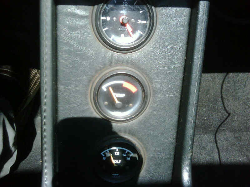

On the later type Oil Temp Guages with the shorter red zone, where would you estimate the normal temp setting I am in Southern Florida which averages about 93 degrees with matching humidity. My guage is showing the needle over the E in Temp. Would that be considered normal?
Just checking as this is the first Summer this car has been running in 10 years.
Thanks,
Vysoc (IMG:style_emoticons/default/idea.gif)
I'm in Miami and I also have the shorter red gauge and my needle gets up to the P when I am on the expressway at 70mph, it moves down to the M in the city, but never goes below it. I have measured the taco plate temp with an infrared gauge and it's about 220-230 at the P. Not bad considering the heat here. Engine is a 2.0L with a cam, 40 dells and a bursch exhaust.

i have a short red gauge and mine stays up high but never gets to red but it still worries me when i see it that high. i just wanna cover it up so i dont' worry so much lol

Thanks for the information especially from the my neighbor in Miami, I will be sleeping better this evening. My set up is a 75 chassis with a '73 GA 2.0 engine
DJet FI car has run great since rebirth, just really did'nt know what to expect for engine temps etc.
I plan on running it up to Sebring on the back road highways to see how she will handle a hour and forty minute run.

I'm glad to see that this is a good reading on my temperature gauge but this one is for the oil.
For the voltmeter, it is at about 12V and I did a reading with a digital meter on the connectors on the back of the gauge and got 12.3V. I have no poblem starting the car. The battery doesn't seem to be low. I even parked my car the other day with the left blinker on (the left blinker stays continously on even without the key) and after my days work, the car started right away. (IMG:style_emoticons/default/huh.gif)

This morning after my ride to work(15 min on hway) here is the reading. Outside temperature is 65-68F. I probed my battery at Idle at the end of the ride and it was at 13V , next I probed the coil and it was at 12V. I guess I should have reved the engine to get the alternator kiking, will do that later today.
I will try to measure the oil temp with a thermocouple.
BTW how do I confirm that the sender and gauge are a match set? Is there an identification somewhere or part number?
Thanks.
