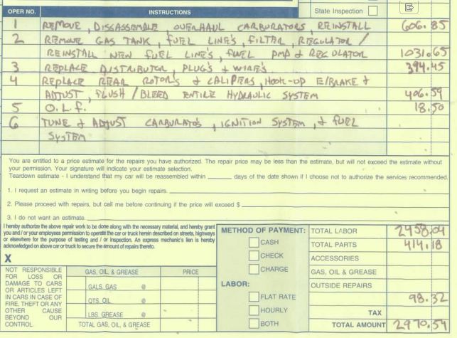

Rebuild carbs, install "owner supplied" rear rotors and calipers, re-install emergencey brake, install new fuel lines, install new fuel pump and reg, install "owner supplied" distributor - all for only $3,000.00!!!
Now I'm not experienced in this arena but I walked out feeling like I got (IMG:style_emoticons/default/sheeplove.gif) This shop has a great reputaion for its work but is also known for its high prices. The owner said he couldn't give me an estimate because he didn't know exactly what he was getting into except that he felt it wouldn't be "in the thousands"...$3k is considered "in the thousands" isn't it (IMG:style_emoticons/default/confused24.gif) Anyway, I took my medcine and learned an expensive lesson...GET ESTIMATE IN WRITING next time idiot (IMG:style_emoticons/default/headbang.gif)
Copy of invoive attached

The only thing that stands out to me is the distributor work. I can do all that in less than an hour. That seems like over 4 hours of shop time.
What is the hourly labor rate?

Copy the itemized bill here and someone might give shop hours to do the stuff, giving you some overcharge arguing room with that shop? Just a thought.

That's 3 - 8 hour days if the rate is $100.00 per hour. Seems a bit expensive.

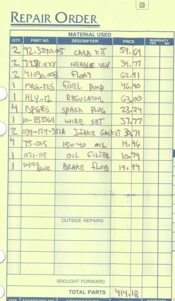

(IMG:http://www.914world.com/bbs2/uploads_offsite/dio265.diomedestorage.com-654-1282680647.1.jpg)
(IMG:http://www.914world.com/bbs2/uploads_offsite/dio159.diomedestorage.com-654-1282680647.2.jpg)

I personally think it should have been a little less, but you also have a ~$400 parts bill, and a 98.32 for ???? is that outside work or tax? Don't know bout your state, but here no tax on labor. Total around 2400 for labor, so is 24 hours realistic for all that work.

assuming $100 an hour (for that rate you shoudl get an experineced guy that works fast and accuratly)
four hour to replace dizzie and wire and plugs, common, now i can do that in my driveway in under an hour tops. rip off
four hours to bleed and adjust the brakes, common half a day????? , maybe just over an hour at home, laying the floor with a roll aournd jack, a shop with a lift could shave more time off that. rip off
i am getting full motor rebuild for less labour than charged you
I'd complain to the owner, if not go to the state autoboard and complain, if you did nto agree to three thousand in charges andtalked of under $1000 in charges, then he has no right to go over in prioce without your authorization.
Question him on these charges. I have purchased decent running 914 complete cars for less money than this basic repair bill !

Lets hope that "15W40 oil" wasn't just anything off the shelf...
Where the hell did he get those part numbers??
600+ bucks in labor to rebuild carbs?? Art Thraen charges less than that and the carbs are completely restored by an expert!
My prices aren't cheap at all and I believe that proper compensation is required, but this even seems a bit extreme to me..

Realistically, I would get 5 hours for the carbs, including R&R and tuning them. Maybe a half hour for the distributor, plugs, and wires, an hour for an oil change WITH a sump cleaning AND a valve adjustment (can't even THINK about adjusting the carbs if you don't know how the valves are), maybe an hour and a half for the brake rotor/caliper/bleeding thing, and adjusting the handbrake, and the tank lines thing is up in the air. Maybe 2 hours, maybe a little more. That's 11 hours. I doubt it would actually take that long, but you never know. I don't think the average tech could get it all done in one day, but a day and a half isn't unreasonable.
If he used the right pump (and the one he lists seems way to cheap for a good one), you wouldn't need a regulator. The intake gaskets seem a lot higher than they should be, and the wire set part number has that FLAPS look to it. In California, the state people LOVE to besmirch because of the "difficulty" of doing business as a repair facility, the failure of the shop to issue a written and signed estimate before the tech even opens the hood of the car is grounds for the customer to take the finished car without paying for the work, or even the parts. And there's a good side for the shop: Customers with groundless or bogus claims are shown the door by the Bureau of Automotive Repair. It goes both ways ....................
On the other hand, you appear to have ignored the option to have written estimate, all three parts. That puts you in bed with the guy doing the screwing .........

and list price on those NGK plugs is $1.90 each.
