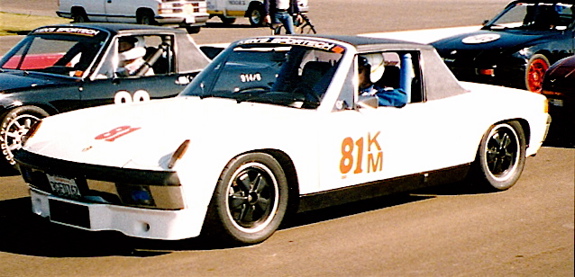

140s on the rear are a bit stiff, but not that bad. I've had them but I like a stiff ride. Passengers sometimes don't appreciate it though. Need good shocks to control the spring.
I have/had 160s on both sixes. On the four I had 140s. Also, one four with stockers.

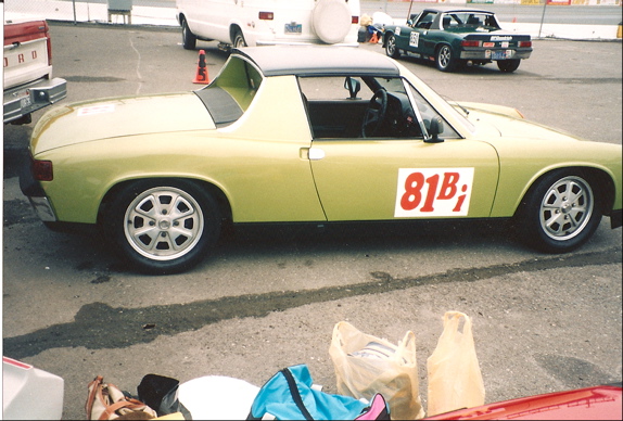

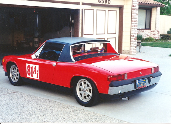

every 914 (5 of them)I have ever owned has had at least 140# rear springs. They work well in combination with stock front bars, but as stated above they need a good Bilstein or Koni to compliment and control them.
Tangerine #81 140s Konis front and rear
Delphi green #81 140s Konis front and rear
White #81 225s custom valved Bils front and rear

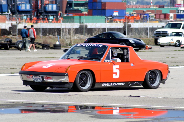

Phoenix Red #5 21 mm front bars, 180# rear springs Konis up front, Custom valved Bils in the rear.
White '75 stock front bars, and 140# rears with Koni adjustables front and rear.

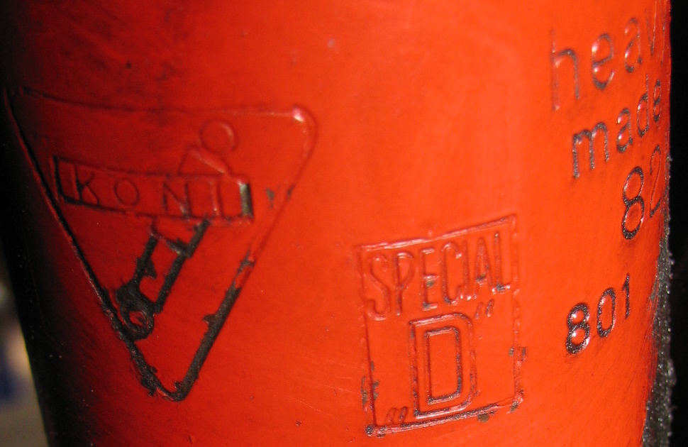

Stock rear on the 73 2L was 100#
140# would be pretty harsh for a DD unless you have a short commute or well padded butt! (IMG:style_emoticons/default/biggrin.gif)
100# should be stiff enough with good shocks for street fun, but maybe 120# for AX.
Boge shocks are the baseline stock set-up & not very stiff, & I hear their newer HD ones aren't much better. That's why Porsche offered the Bilstein option from the factory. You can still get Bilsteins & front inserts for the Boge Struts, as well as same for Koni's. They recco getting all 4 corners the same mfgr., type & stiffness at the same time - so you'll want to do the front inserts too.
A lot of folks don't like the KYB's - esp. with a street car/DD use.
Back in the day I upgraded to these rear Koni Reds (similar to their street HD ones now, but called "Super D" back then) F & R when my Boges wore out, & they gave a good deal of handling improvement over the Boges IMHO -
BTW - your stock 16mm F & 15mm R factory sway bars should be fine for street & street class AX, but you may want to go through & re-bush everything on the F & R suspension while you're in there upgrading stuff, if they've never been redone in 37-38 years. If you need new tie rod ends/ball joints up front, then you may as well go with the Turbo Tie rod kit for a few bucks more, but stick with the OEM Lemforder kit - not the cheaper & lower quality aftermarket tir rod ends/bj's - cuz I thought they were (IMG:style_emoticons/default/stromberg.gif) & sent them back & just paid the extra for the OEM ones in the other kit (PP, AA, Pelican, maybe PMB & others carry it).
