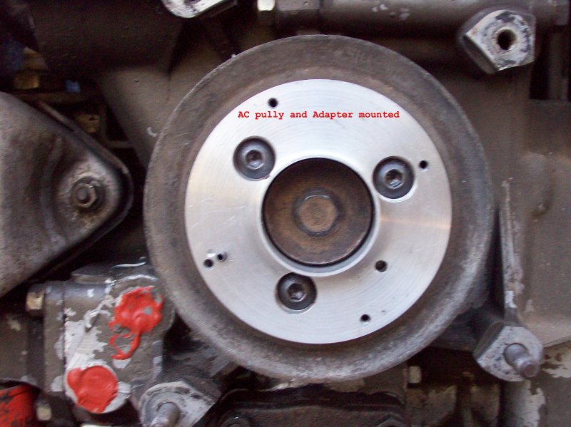

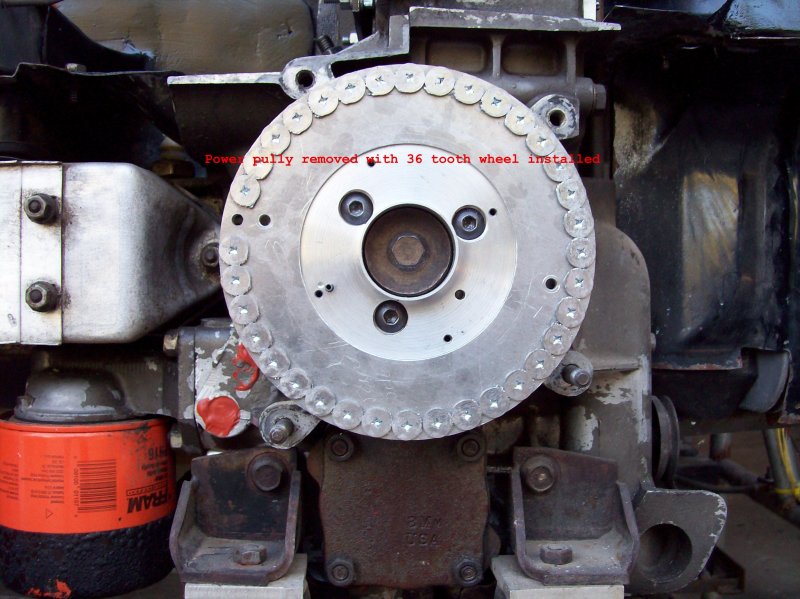

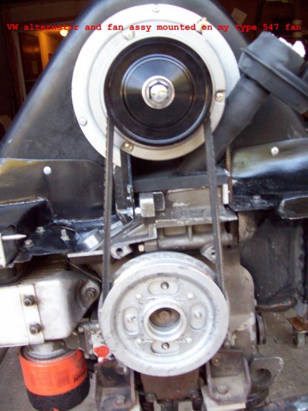

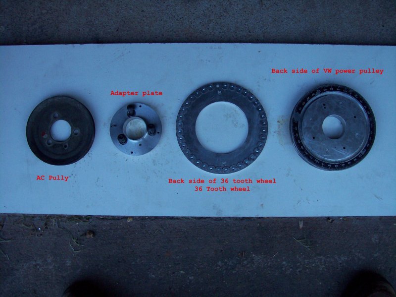

904svo
post Sep 1 2010, 08:29 AM
Post #35
904SVO
Posts: 1,129
Joined: 17-November 05
From: Woodstock,Georgia
Member No.: 5,146
Here's my 36 tooth wheel design mounted with AC pulley to drive my 547 fan design.
