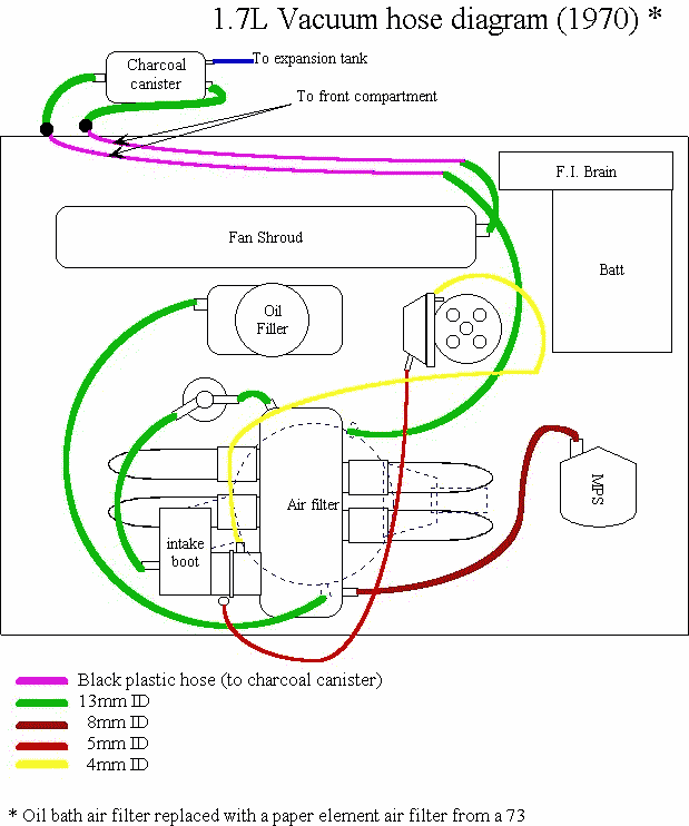

Take the intake manifold off and look for a 3 way vauum hose. It cracks, it cannot be seen with the main plenum on , and it will casue all of these issues. I know because years ago I pulled an engine to rebuild it convinced it was in need, ended up finding that piece was hard as a wedding dick and split in 2.
scotty b
post Sep 8 2010, 07:09 PM
rust free you say ?
Posts: 16,375
Joined: 7-January 05
From: richmond, Va.
Member No.: 3,419
QUOTE(scotty b @ Sep 8 2010, 04:53 PM) *
Take the ( " air filter " in the diagram )off and look for a 3 way vauum hose. It cracks, it cannot be seen with the main plenum on , and it will casue all of these issues. I know because years ago I pulled an engine to rebuild it convinced it was in need, ended up finding that piece was hard as a wedding dick and split in 2.
O.k. slight brain fart. It is not a 3 way vacuum line it is a 3 way metal thingy ma hooch and it has a hose that makes a awkward angle to the plenum. thereis also a line on the underside, that can't be seen. This diagram only shows the 2 on the top 13mm one to the filter housing and one to the boot. I don't recall where the one on the underside goes.
