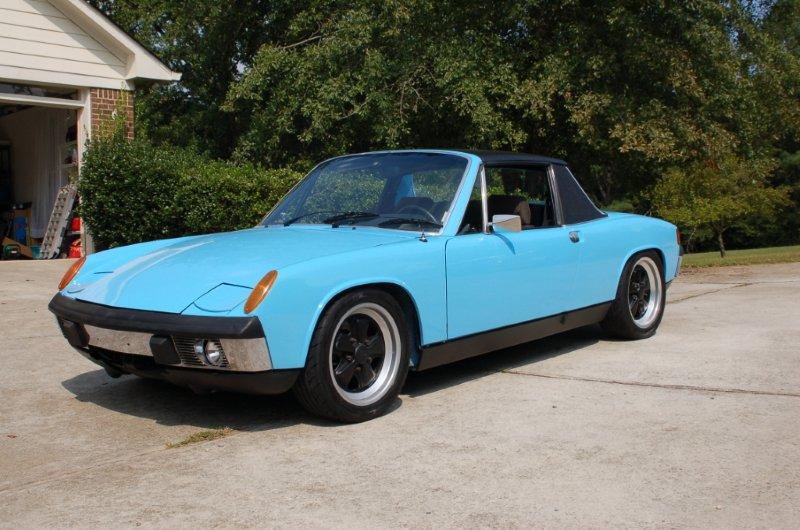

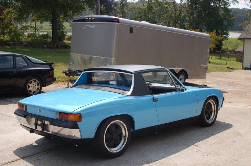

What started as quick and easy conversion for a Grassroots motorsports 2000 challenge car. One thing led to another and before I knew it I had gone over budget.
I started with a V8 car with a bad engine so instead of another SBC or LS1 I bought a wrecked Subaru SVX for the engine. Then found a wrx transaxle with axles clutch and all parts needed.
The engine and transaxle mounts were done over a couple of weekends. Then we got real busy at work and was not able to work on it for a couple of months.
By this time I had changed my mind about the grassroots challenge car and figured I just fix it up. So a color change paint job was in order. I did this myself in the garage and had to wait until spring to shoot the paint.
I've been driving now for a few days tuning the Megasquirt DIYPNP that I built over the winter. I guess its time to go get a tag and start driving.Attached Image
Bob (IMG:style_emoticons/default/driving-girl.gif)
