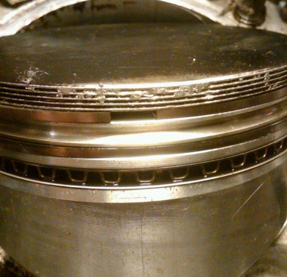

I have a set of KB performance 96mm pistons. I recently disassembled most of my engine. The engine was freshly rebuilt (with about 250 miles) however I was having an issue with cyl 3 so I took the engine out.
About 25 miles prior to removing the engine, I stripped the #4 spark plug hole. I replaced it with with a time-sert. I thought that I had done a good job of removing the metal fragments. Once I got the cylinders off, I realized that I missed several metal fragments.
What can I do to fix the piston? Is there a DIY fix? Yes, there are some minor gouges on the cylinder wall- I am going to get it honed.

Vacca Rabite   could you try going in with a dental pick to remov...   Sep 15 2010, 08:06 AM

DNHunt   This sure has the feel of a disaster that builds f...   Sep 15 2010, 08:35 AM
charliew   Only if the new piston is havier than the old one....   Sep 15 2010, 03:56 PM
brant   I think its replacement time I agree with Dave... ...   Sep 15 2010, 04:46 PM
tornik550   I went outside and tried to pick the metal bits ou...   Sep 15 2010, 07:24 PM

tornik550   So does anybody know a good source for reasonably ...   Sep 15 2010, 08:13 PM

plays with cars   Sorry, no help on a head stud, but I will second y...   Sep 15 2010, 09:32 PM
Krieger   How about Jake Raby or FAT Performance?   Sep 15 2010, 10:59 PM
Krieger   Two more maybes: Ottos, High Performance House-Ric...   Sep 15 2010, 11:01 PM
Vacca Rabite   If you have a local bug shop, they will have the s...   Sep 16 2010, 06:02 AM
draganc   "...two of them were used to build a rotesse...   Sep 16 2010, 10:00 AM
tornik550   Update- I searched my old emails and found that I...   Sep 16 2010, 08:09 PM
