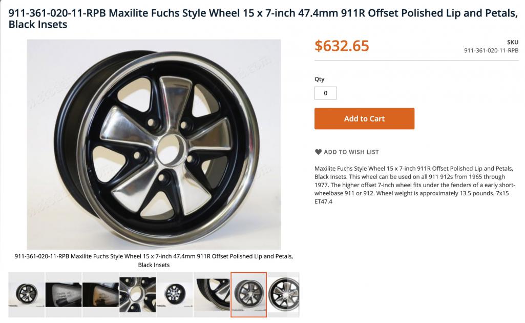

Danny,
The 4 lug or the 5 lug?
if 5 lug I am diging these deep 7s for the rear and a matching 6 x15 for front. The 7s are Supposed to? Fit. On stock body.
Best Bob B
