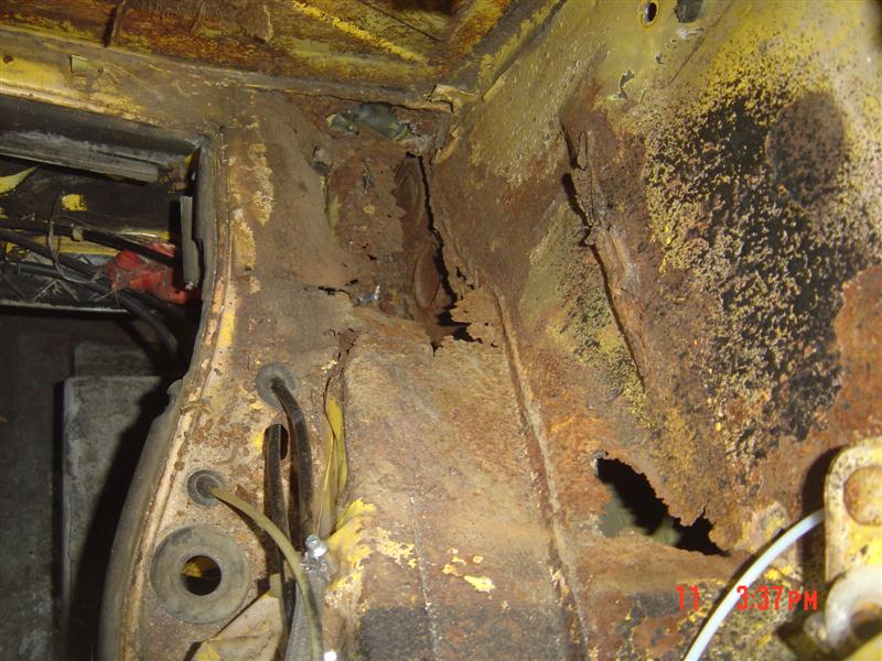

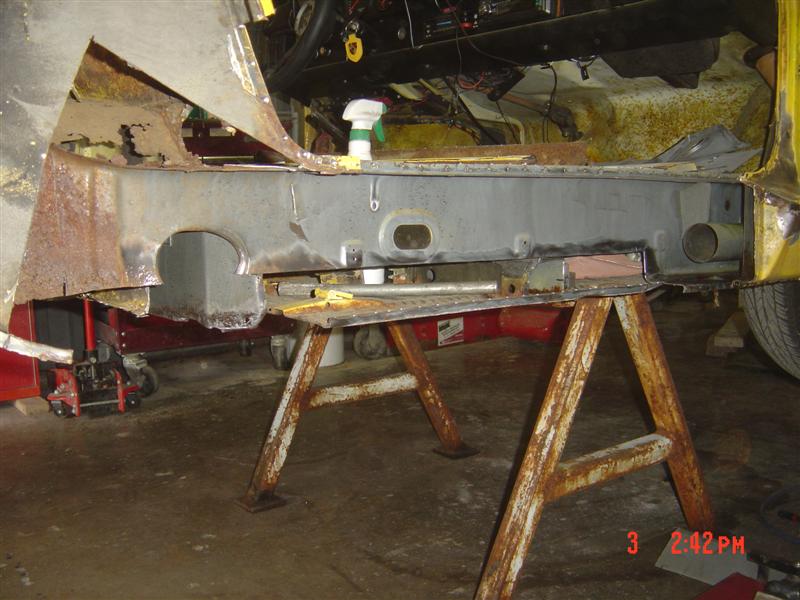

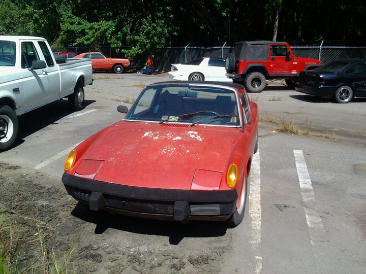

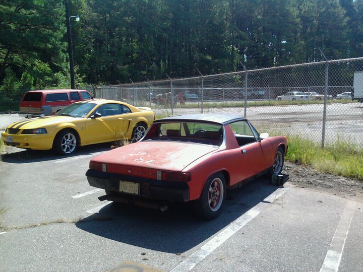

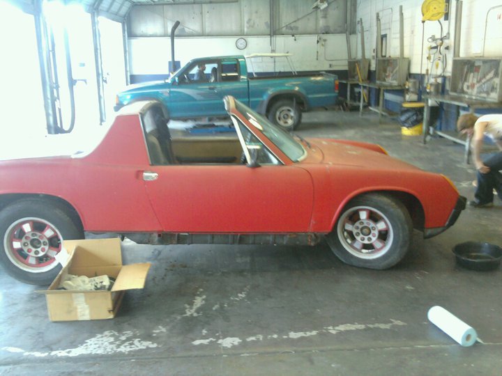

I decided to start a build thread like so many others in the hopes of motivation and some usefull advice. I bought the car back in febuary and tinkered with it since then but due to health problems and work i was unable to do much. I now have some time to put toward it and im excited to get to work. Last week i pulled the rocker covers off to check out the rust. It turned out not to be as bad as i had thought. The longs are rusted out near the jack post, worse on the drivers side, the battery tray is mostly gone. Friday i pulled out the interior and spend the weekend making new upholstery. This is the first time i've ever attempented to do this. It didnt come out perfect but its better then what was in there and it only cost around 120 bucks which is much cheaper then what local shops whated to do it. So far i have the area around the seats done and the material cut out for the seats but i needed to take a break from it and watch some football (drinking beer and doing upholstery dont mix, welding on the other hand).
Attached Image Attached Image Attached Image Attached Image Attached Image Attached Image

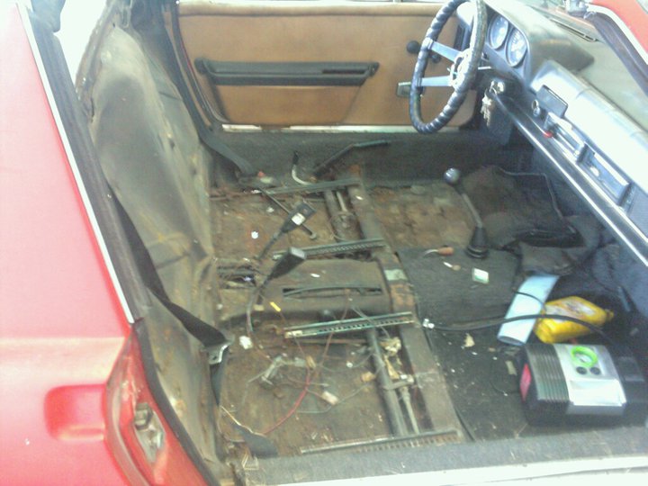

Got the suspension, the ball joints changed out along with the pad behind the seats today. I was wanting to pull the engine today but due to a broked garage door i couldn't use the lift. Maybe tomorrow i'll be able to do that. I'm looking forward to making the rust repairs and doing the body work.

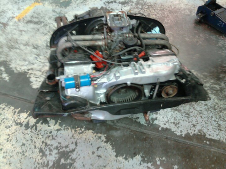

I pulled out the engine this afternoon. Got that down to just over an hour. The CV joints were another story. It looks like the PO tried to use an allen wrench making the bolts impossible to remove. Last time i ran into this issue, on the transmission, i was able to get them out using an bolt extractor but there isn't enough room to use an easy out. Does anyone have any ideas on a easy way to remove them? I really don't wanna drill them out.
On a good note i figured out why my shifter has a huge amout of play in it, the bushings that connect the tail shaft to the shaft that runs through the tunnel. They seemed in good shape the last time i had the engine out but somehow they turned to dust. I knew i should of replaced them last time i had the engine out but i couldn't figure out how to remove them, i guess leaving them sit for 8 months will take care of that for you.

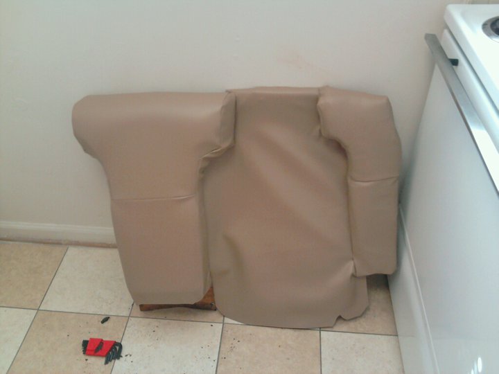

Now the next thing i need to is finish the upholstery and kill time till vacation at which time i will attack the rust and lay down some paint.

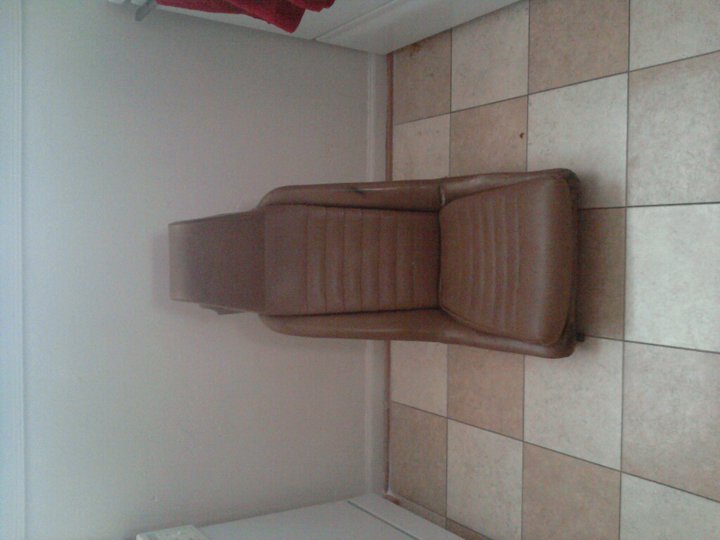

well had to brake out the cut off wheel to get the rails off the seats, the prongs are totally rusted off so i'm going to have to fab up some new ones. I think i'm going to call it a night and leave the seats for tomorrow.
