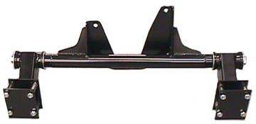

Just to be different and because I'm running a 3.6 engine and I know this mount works with the 3.6, I went with a Patrick Motor Sports firewall mount. Here's a pic....

Don't use it! You'll spend 40 hours trying to make a shift rod that fits. In the scope of a six conversion project, $450 bucks is a spit on the griddle. Don't try and save money on one of the most critical components of the conversion. The other thing is if you ever plan (or hope) to put heat exchangers on the car, most crossbar mounts will interfere.
I did a conversion with one of Patrick's chrome moly bycicle handle cross bar mounts. It works OK, but that chrome moly bar is like a spring. When you go over bumps you can feel the power plant bouncing.
The other thing is routine maintenence. The crossbar mount makes working on the car more of a hassle. If you use a firewall mount and cut the four cylinder mount consoles off the car, you gain a little room underneath.
This is just my opinion. Which is derived from some experience. Also I do sell Rich's mount, (and have them in stock btw).

We have had 2-3 cars running around the tracks here with 3.6's mounted to the stock 9146 single bolt mount with NO issues. I dont recommend it, but I also dont recommend using anything that bolts into the tub. The factory welded the stock 6 mount in for a reason. I weld ALL the RJ mounts I use. I like the looks of the newer Patrick setup, but price comparison stops me from using it. I like the fact that the RJ mounts can be used with solid mounts or 911 sport mounts.

B, I plan on welding my mount to the firewall. They're available in bolt-on or weld-on, I opted for welding. RJ had some concerns with using his mount for a 3.6. I actually bought one from him and he told me it wouldn't work, so I sold it. I'm not sure Rich has done a 3.6 with one of his mounts. Don't get me wrong, RJs a great guy and has great parts, but when it comes to the 3.6 there's a lot of uncertainty. (IMG:style_emoticons/default/confused24.gif)

The 3.6 is different animal. He would need to change the nose cone setup, but the current weld in mount would stay the same. I may help him out since I have a 3.6 that needs rebuilding. My comments werent really aimed at you.. just a FYI for others following along. I fully expected you to weld yours in.
Somebody mentioned the "boucing" of engines on the cross bar mount... they where 100% dead on. It feels hilarious.. until the mount cracks..

How do the V8s get away with a crossbar mount, is it just more beefy?? I would imagine that a V8 would wind up a cross bar pretty well !!

The V8 is triangulated in the mount. The V8 wants to lift up and out of the car when on the gas much more so than a flat 6. I HATE the Renegade cross mount, but it does work and I havent seen one fail... but they do flex big time. I duped it out of chrome moly ages ago and did a guesseted triangualtion to the block. I also got rid of the cheezy 1 inch wide steel pieces that go across our outboard engine mounts and hold the cross bar. I went to a delrin round block. Works slick and you jack the car up from the cross bar with NO FEAR. It wouldnt bend.
