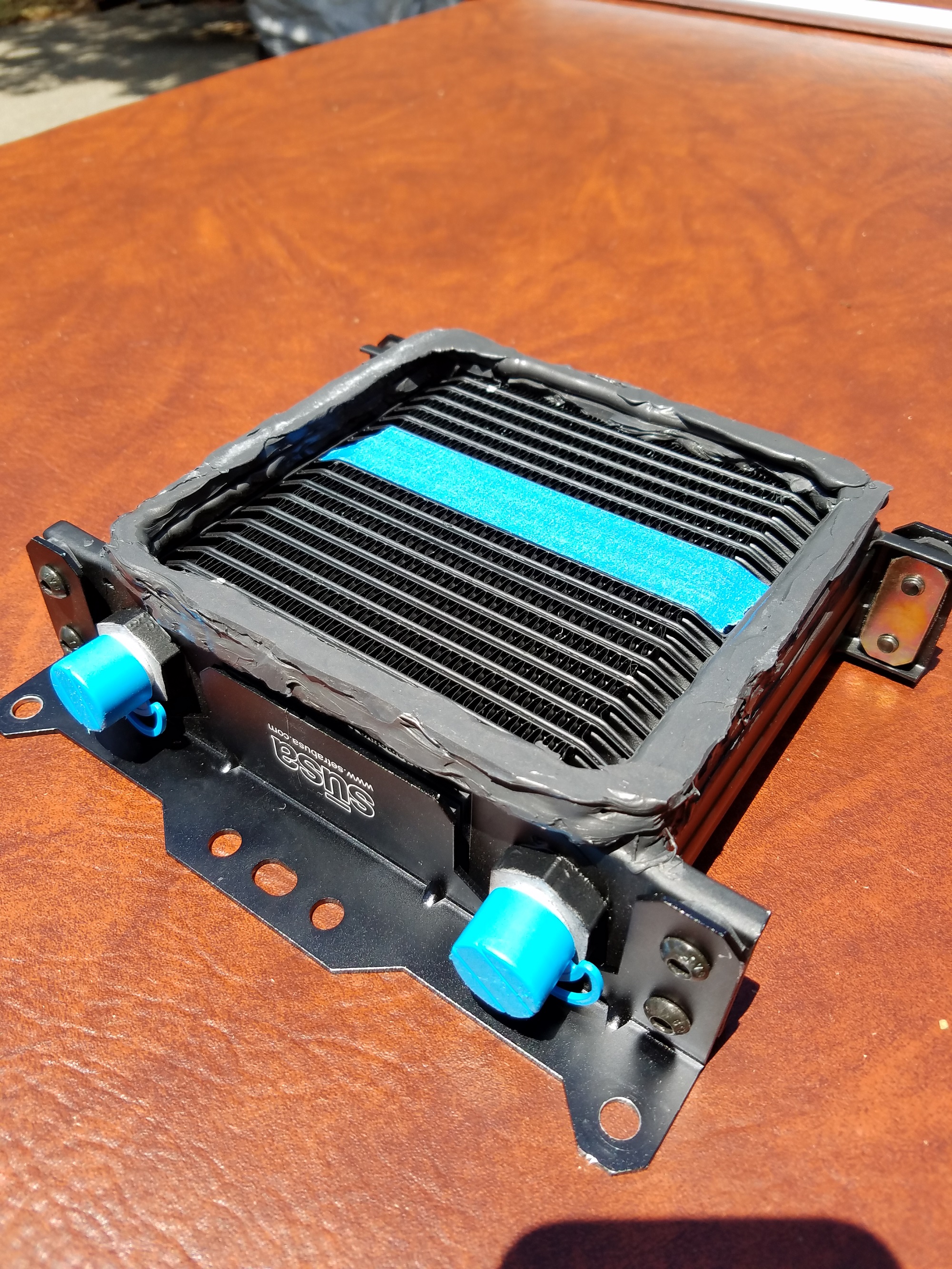

Krieger   I have an RX-7 cooler with a shroud that I built t...   Sep 24 2010, 08:53 PM
