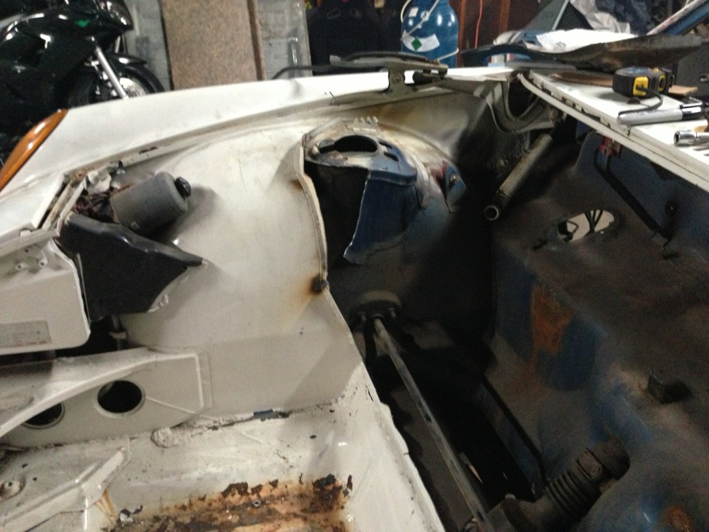

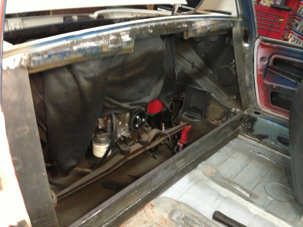

Well the shifter is off visiting a friend in what i will call "Beta" mode. I have everything made and tested to a point I will have it installed in next couple of weeks...
Now to the new stuff...
I finally finished the door sill on the passenger side...
(IMG:http://www.914world.com/bbs2/uploads_offsite/i163.photobucket.com-12156-1356741346.1.jpg)

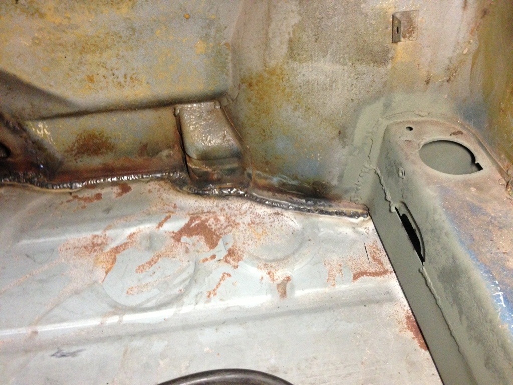

I finished welding in the fillers for the firewall
(IMG:http://www.914world.com/bbs2/uploads_offsite/i163.photobucket.com-12156-1356741346.2.jpg)

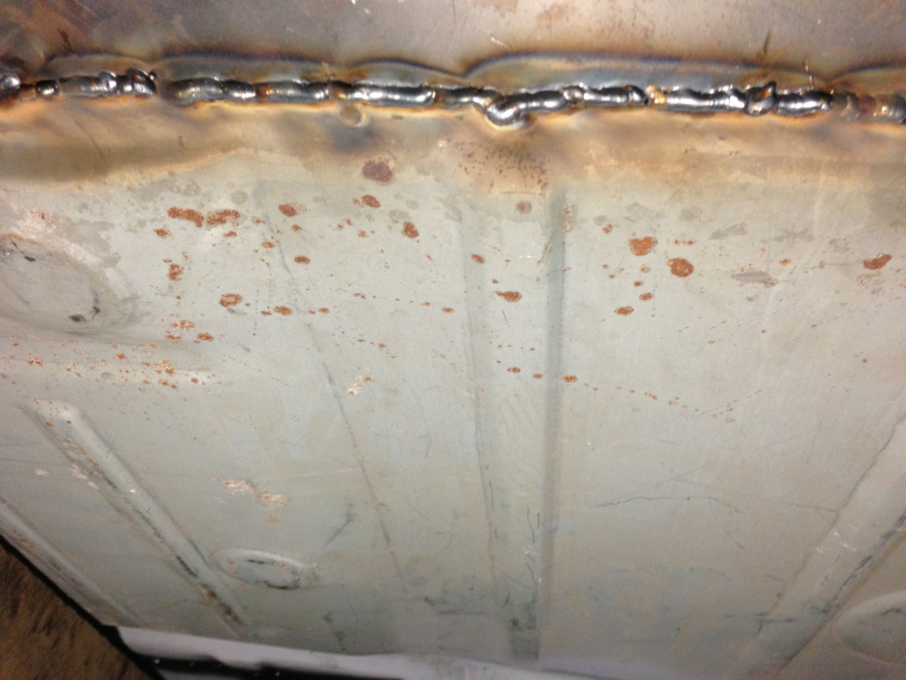

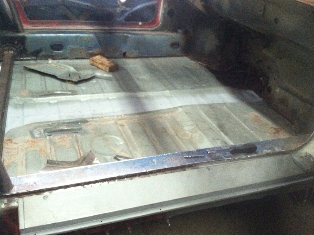

Then i finished welding in the floor.... all except the small area that is missing where the pedals used to go...
(IMG:http://www.914world.com/bbs2/uploads_offsite/i163.photobucket.com-12156-1356741347.3.jpg)
(IMG:http://www.914world.com/bbs2/uploads_offsite/i163.photobucket.com-12156-1356741347.4.jpg)

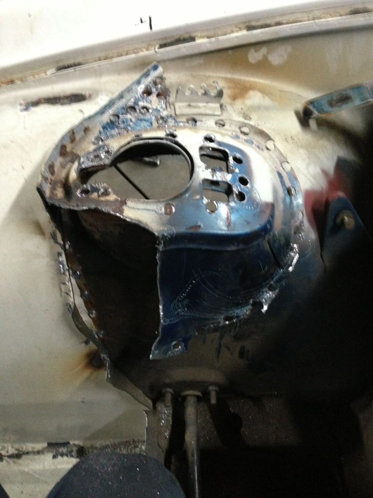

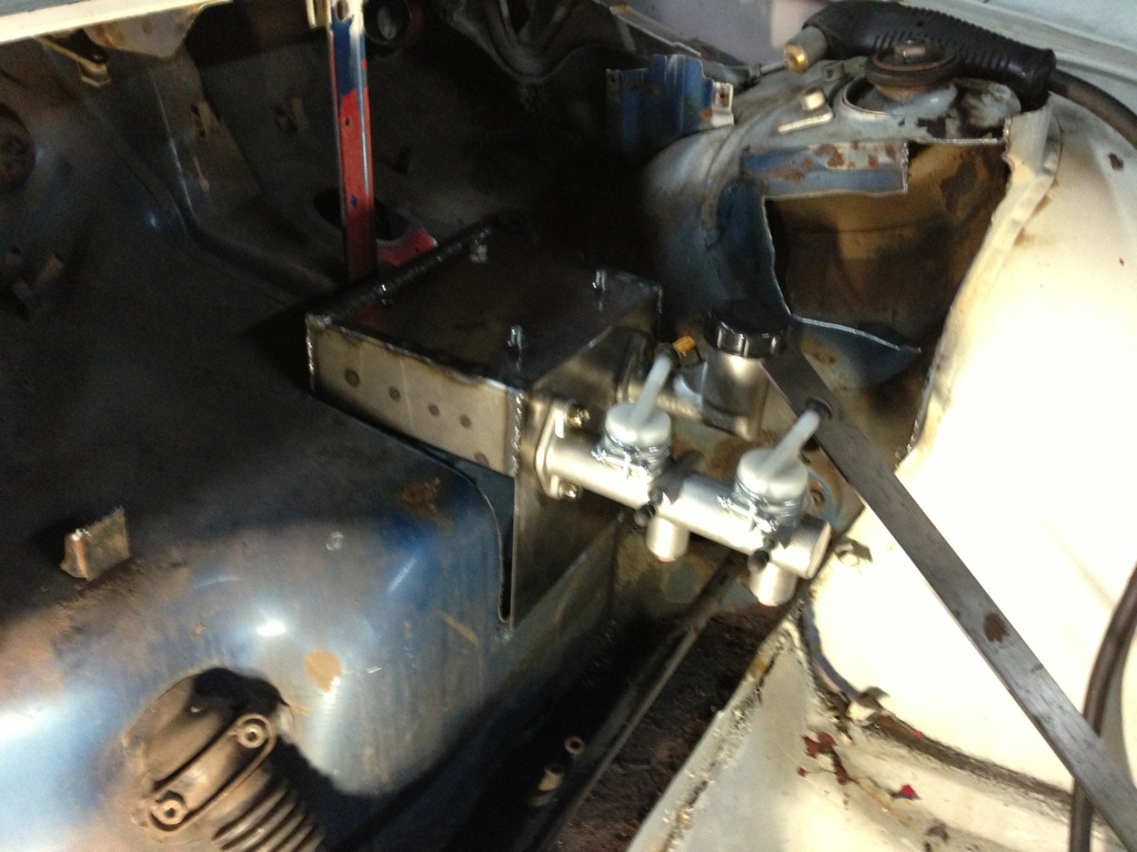

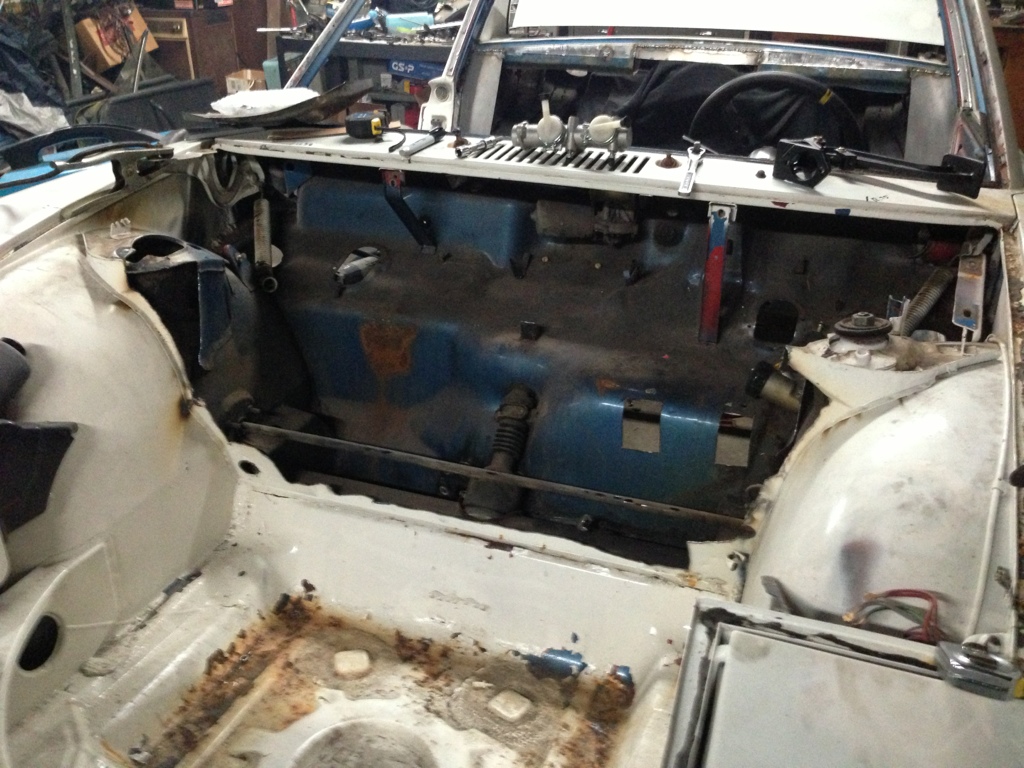

I then went loco and chopped up the front firewall! (IMG:style_emoticons/default/ohmy.gif)
(IMG:http://www.914world.com/bbs2/uploads_offsite/i163.photobucket.com-12156-1356741347.5.jpg)
(IMG:http://www.914world.com/bbs2/uploads_offsite/i163.photobucket.com-12156-1356741347.6.jpg)

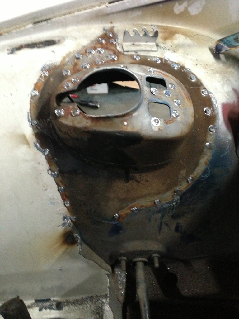

Then i had some fun with a spot welder...
(IMG:http://www.914world.com/bbs2/uploads_offsite/i163.photobucket.com-12156-1356741348.7.jpg)
(IMG:http://www.914world.com/bbs2/uploads_offsite/i163.photobucket.com-12156-1356741348.8.jpg)

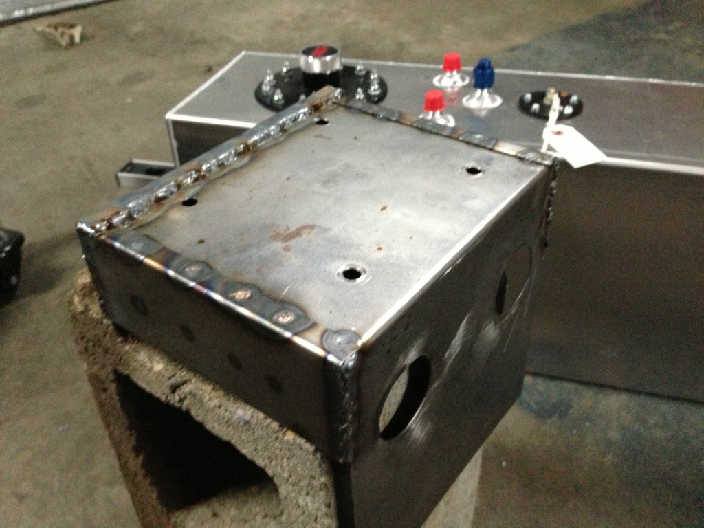

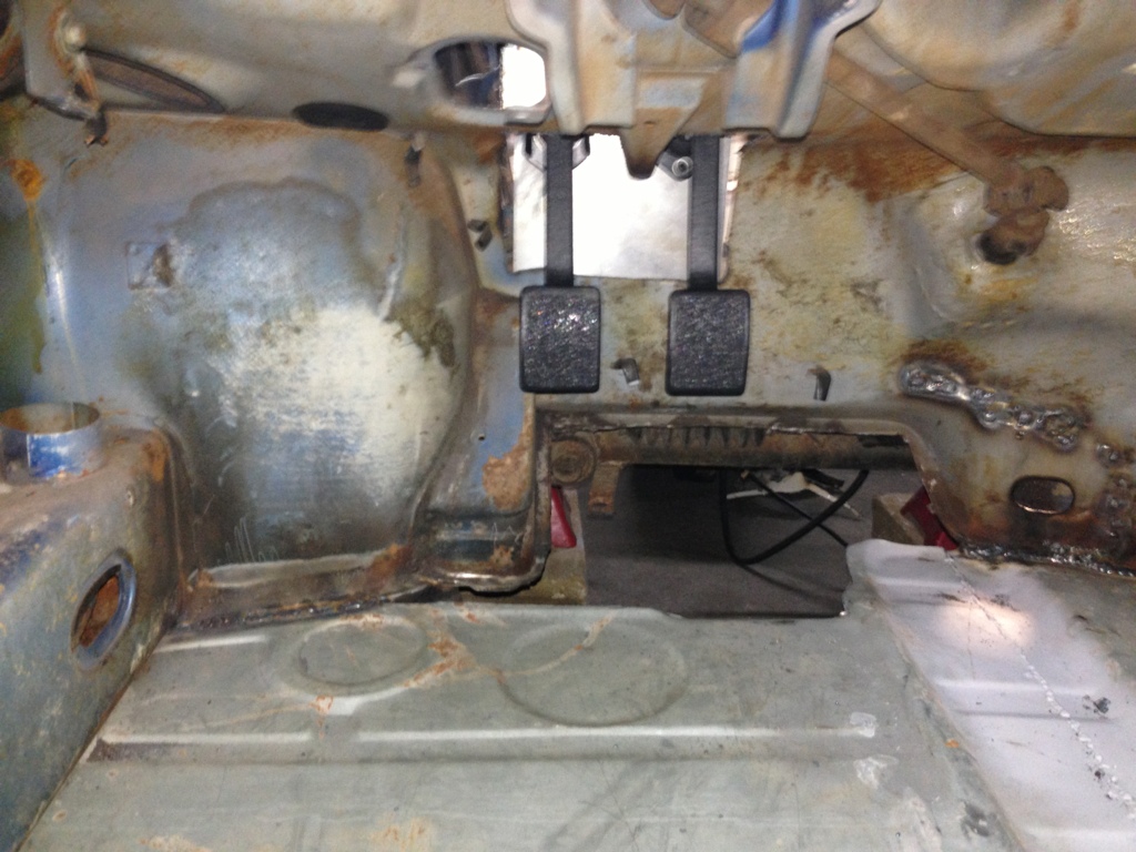

And because I have servere A.D.D. I moved over to my pedal box...
(IMG:http://www.914world.com/bbs2/uploads_offsite/i163.photobucket.com-12156-1356741348.9.jpg)
(IMG:http://www.914world.com/bbs2/uploads_offsite/i163.photobucket.com-12156-1356741349.10.jpg)
(IMG:http://www.914world.com/bbs2/uploads_offsite/i163.photobucket.com-12156-1356741349.11.jpg)

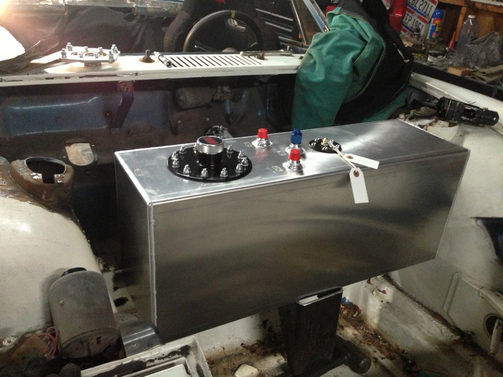

Oh and I set my christmas present in to see how it looks...
(IMG:http://www.914world.com/bbs2/uploads_offsite/i163.photobucket.com-12156-1356741349.12.jpg)

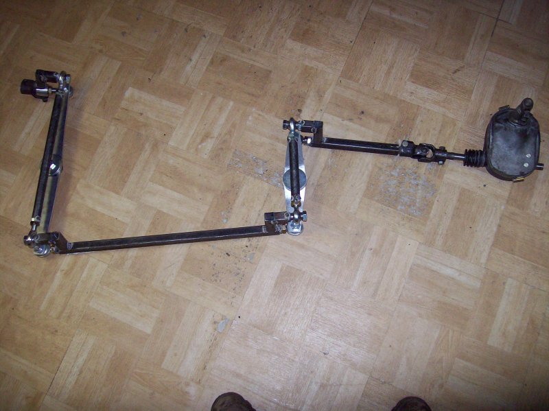

I keep the 914 shifter in my car and came up with this linkage arrangement.
I did not have enought room to install cables between the back wall and the front
of the engine so I went around the engine.
