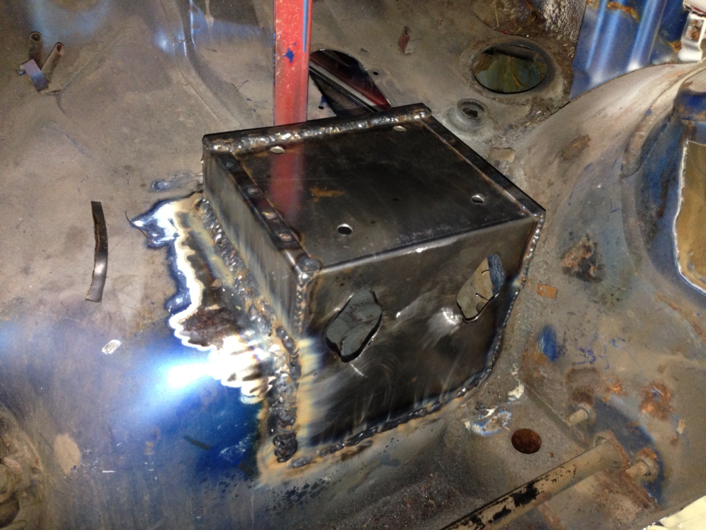

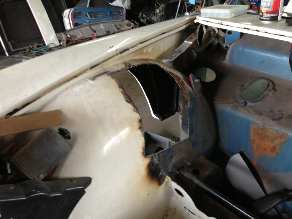

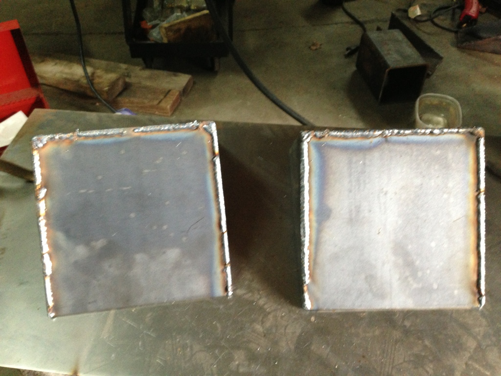

okay... so When I got home from work I got a little time to work on the car.
On monday, I went to see a fellow Porsche friend that owns a metal supply store and picked up a piece of aluminum for the firewall.
Today I got it fitted for the hole.
(IMG:http://www.914world.com/bbs2/uploads_offsite/i163.photobucket.com-12156-1357182507.1.jpg)
(IMG:http://www.914world.com/bbs2/uploads_offsite/i163.photobucket.com-12156-1357182507.2.jpg)
This is it for tonight.

rnellums
post Jan 3 2013, 01:05 AM
Post #124
Professional Enthusiast
Posts: 1,673
Joined: 26-November 09
From: Littleton, CO
Member No.: 11,072
Its starting to look like a real cockpit! Keep it up Thomas.

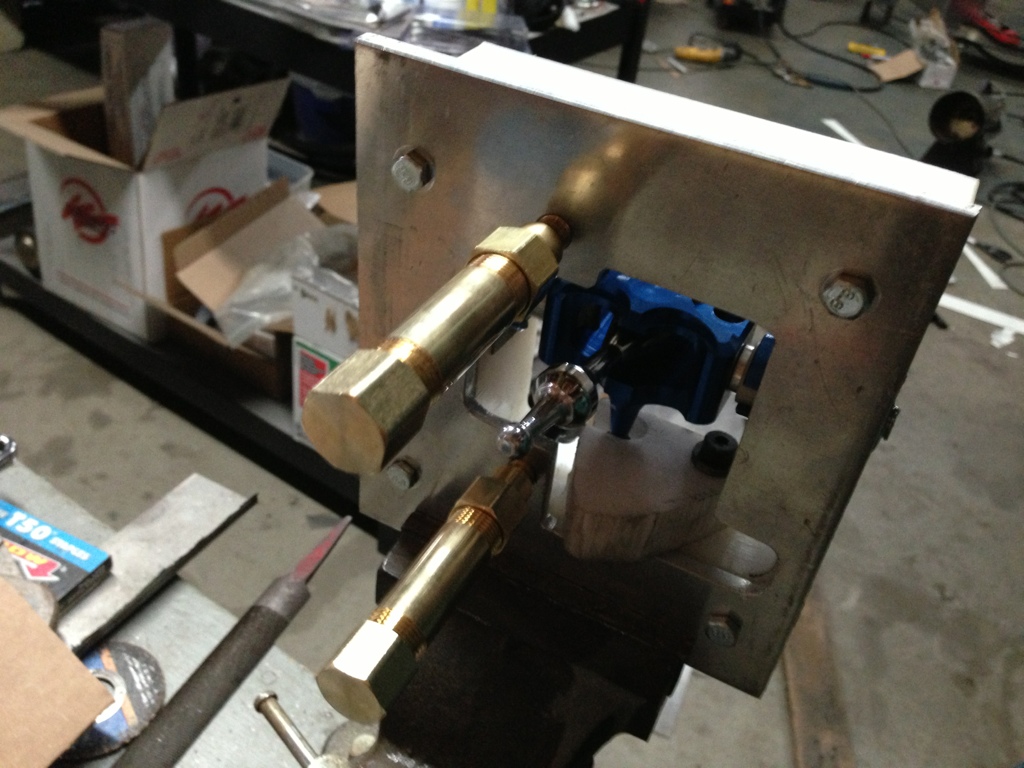

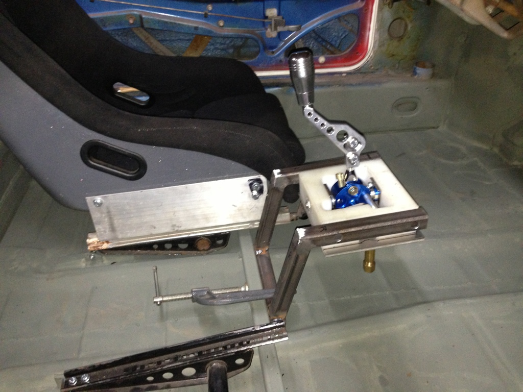

Today I got some time in the garage and finished up the shifter. Now all I need to do is test it with the cables on the trans...
https://www.youtube.com/watch?v=-u0vDi6SQbI
www.youtube.com/#/watch?v=-u0vDi6SQbI
This is since the embedding is not working...
tscrihfield
post Jan 6 2013, 04:41 PM
Post #126
Drive Fast and Take Chances
Posts: 643
Joined: 8-September 10
From: Amelia Ohio
Member No.: 12,156

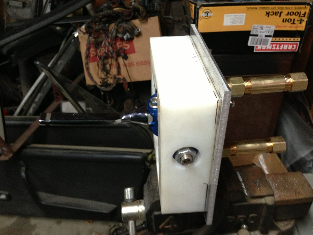

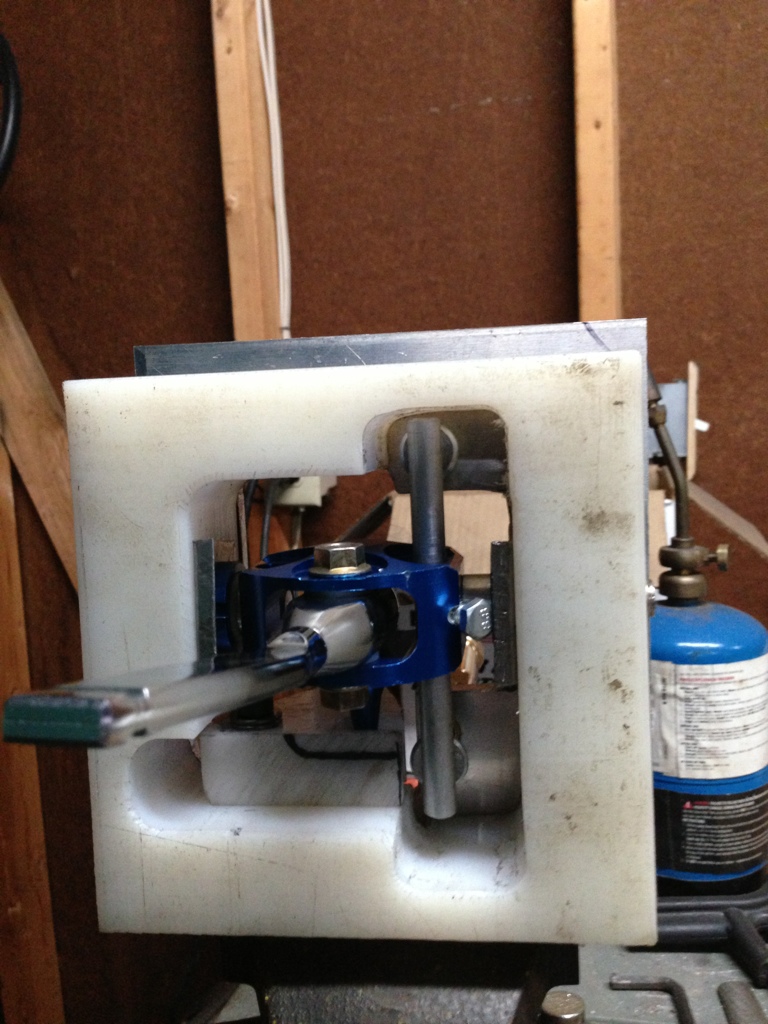

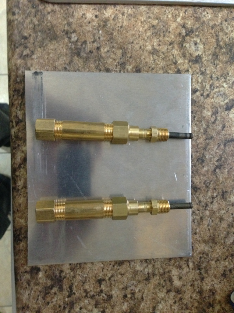

Now for still frames.

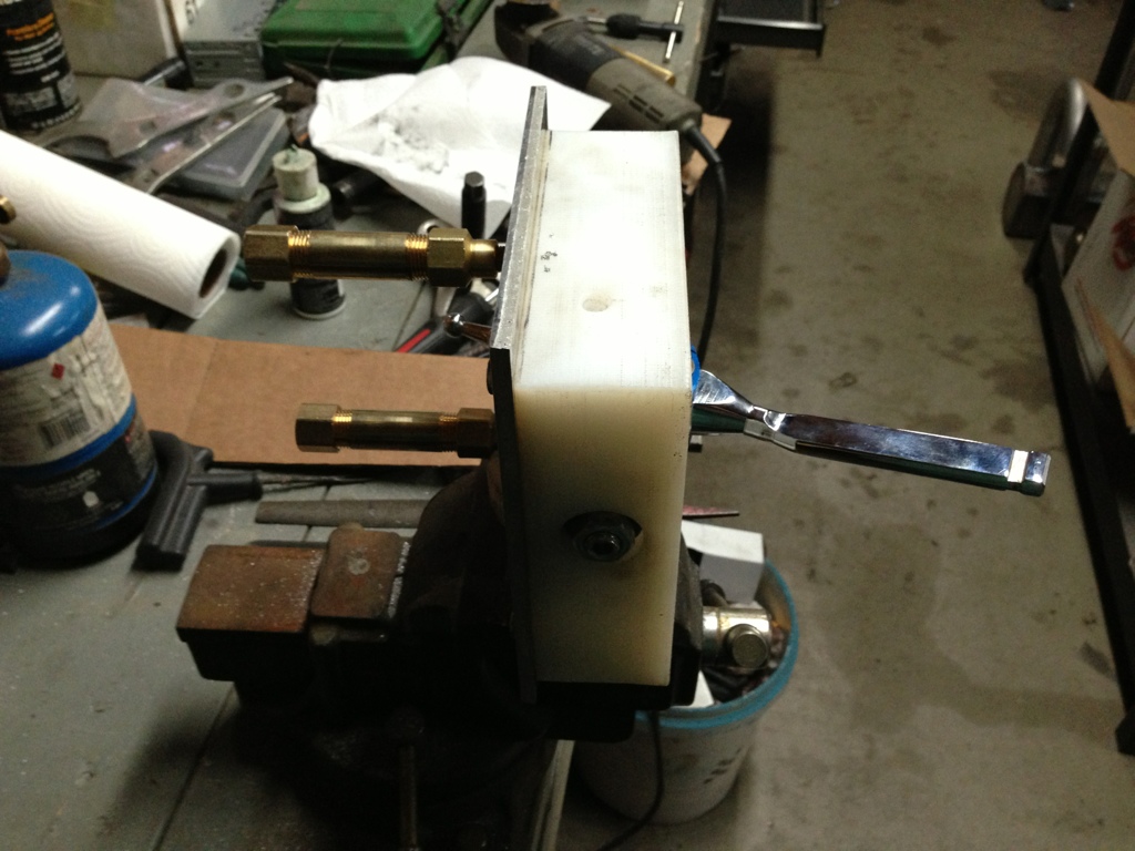

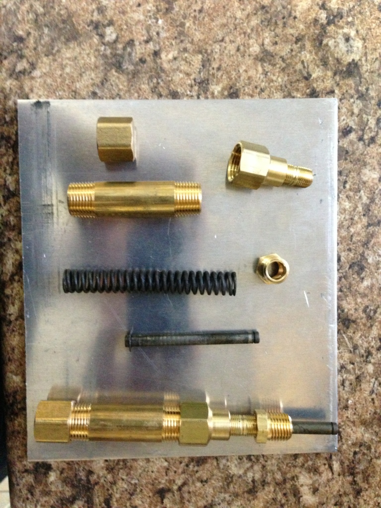

The spring plungers...
(IMG:http://www.914world.com/bbs2/uploads_offsite/i163.photobucket.com-12156-1357512106.1.jpg)
(IMG:http://www.914world.com/bbs2/uploads_offsite/i163.photobucket.com-12156-1357512106.2.jpg)

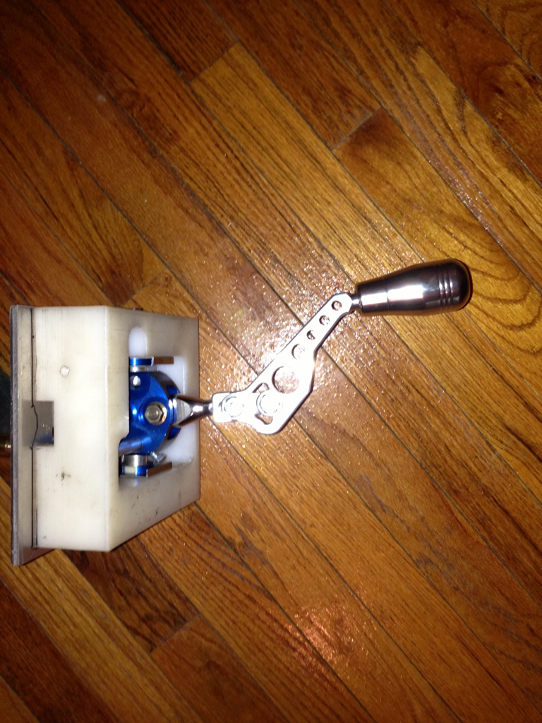

The shifter...
(IMG:http://www.914world.com/bbs2/uploads_offsite/i163.photobucket.com-12156-1357512106.3.jpg)
(IMG:http://www.914world.com/bbs2/uploads_offsite/i163.photobucket.com-12156-1357512106.4.jpg)
(IMG:http://www.914world.com/bbs2/uploads_offsite/i163.photobucket.com-12156-1357512106.5.jpg)
(IMG:http://www.914world.com/bbs2/uploads_offsite/i163.photobucket.com-12156-1357512106.6.jpg)

Is having the springs vertical going to make mounting it in the tunnel difficult? Seems like they take up a lot of space. The motion looks excellent though.

QUOTE(rnellums @ Jan 7 2013, 09:48 AM) *
Well.... That's just it, there's not a tunnel... But the mounting of this shifter is going to be higher than the stock shifter. If you take the normal shifter go about 4 inches back and 8 inches up. That's where this will mount. I'll tell you though, when I did the mock with the other shifter, this thing has a tighter pattern than my GTi for shifting and it is solid as it gets. I cannot wait until I mount it... Now I just need to finish the seat mounts...

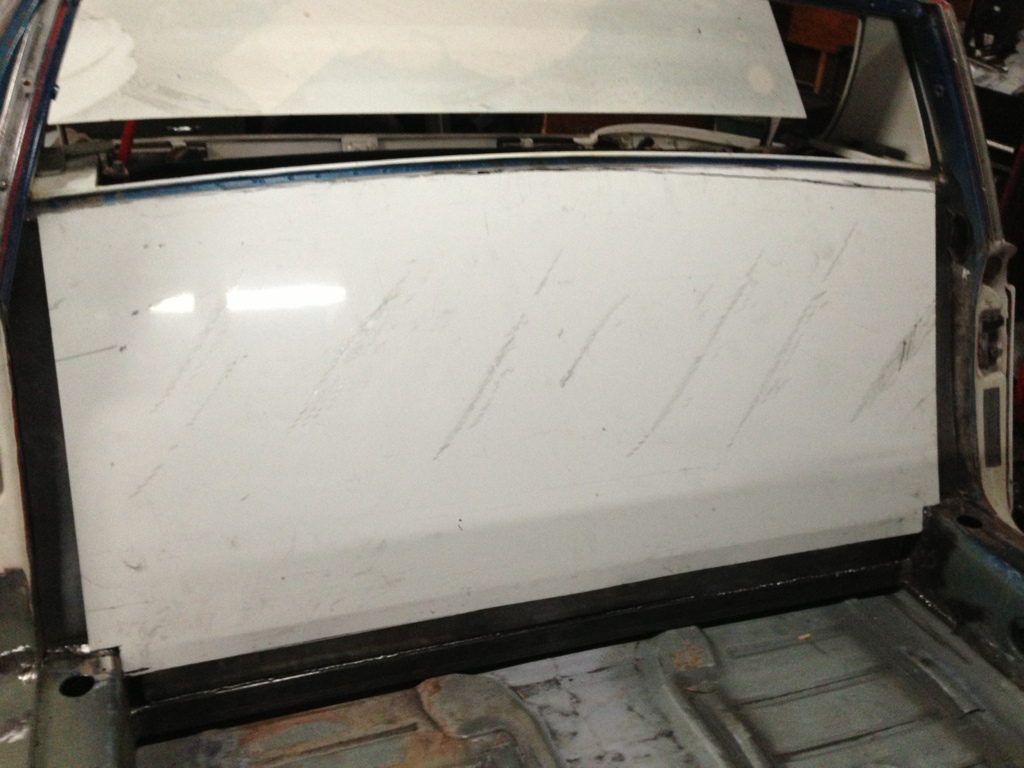

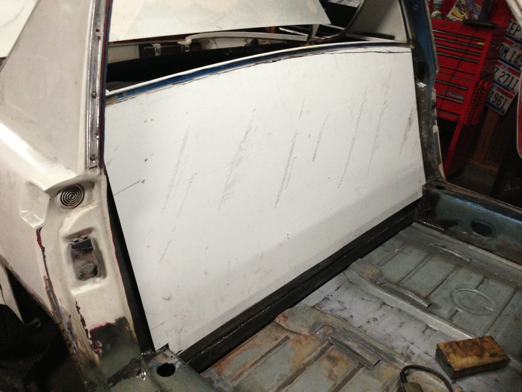

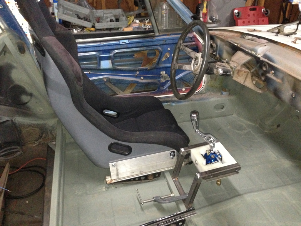

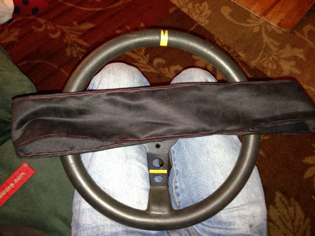

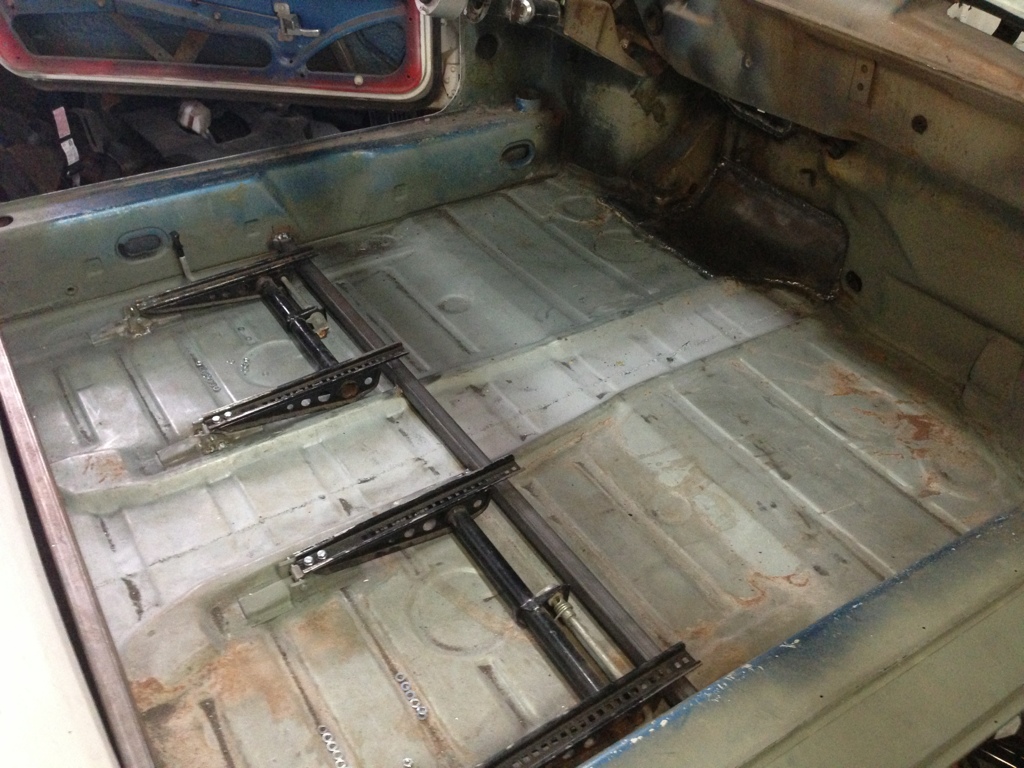

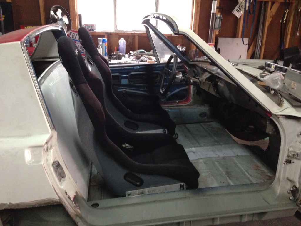

A couple weeks ago I figured out a way to mount the seats utilizing the stock mounts and rails. It turned out nice and fear of height is not an issue.
(IMG:http://www.914world.com/bbs2/uploads_offsite/i163.photobucket.com-12156-1360203803.1.jpg)
This past week, it got up to 60 degrees before it went to sub zero temps two days later... So I spent some time working on the car while it was nice. I mounted the pedal support box I made.
(IMG:http://www.914world.com/bbs2/uploads_offsite/i163.photobucket.com-12156-1360203803.2.jpg)

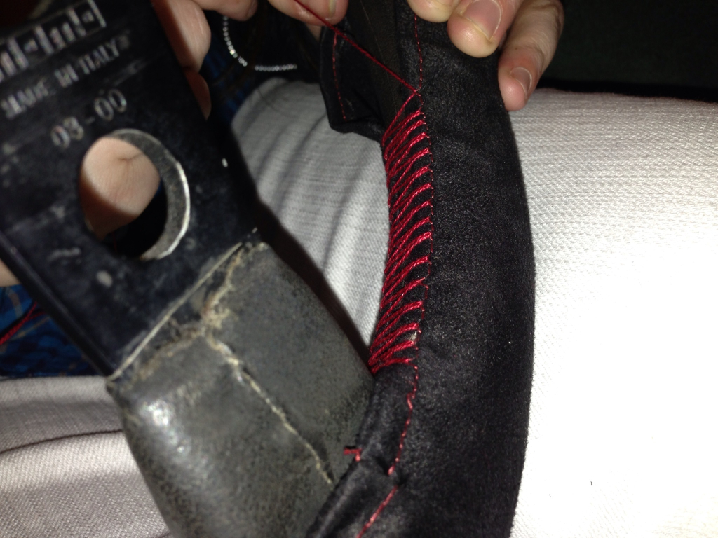

Over the past couple of weeks I've been working on a neat project for the interior. With the project I have figured out how to work a sewing machine and how to do pretty nice hand stitching.
(IMG:http://www.914world.com/bbs2/uploads_offsite/i163.photobucket.com-12156-1360203803.3.jpg)
(IMG:http://www.914world.com/bbs2/uploads_offsite/i163.photobucket.com-12156-1360203803.4.jpg)
I am sure that I will have to make another one because I am not sure I like how this one is turning out... But I have enough material to make few errors and perfect this.
(IMG:http://www.914world.com/bbs2/uploads_offsite/i163.photobucket.com-12156-1360203804.5.jpg)

How do you think the new seats will affect legroom. It looks like they might be set up a bit further forward than stock. Recovering a steering wheel is tough, I remember recovering a stock wheel at one point and it didn't come out spectacular. It might be that gluing some 1/4" foam scrim to the back side of the suede before sewing it on would hide any wrinkles, or try using a material that will stretch a bit and cut the piece slightly smaller than it should be. (Thats what I did with seats at least)

The seats could go back more. Not to mention, I gain some room due the firewall that I built. The seats are in the stock location with almost identical to stock mounting, with a few modifications.

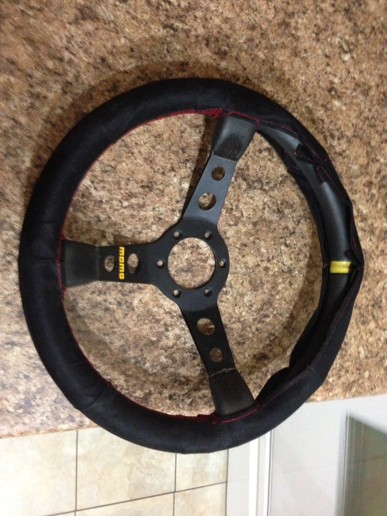

Thanks for the advice on the steering wheel. I just wanted to try it for fun and if turns out, I'll keep it. If not, I will send it to a professional.

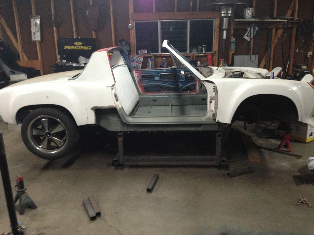

Now for some progress.
I got out to the garage pretty early for me on a Saturday (11:00am)... I'm usually working on Saturday mornings so it was nice for a change.

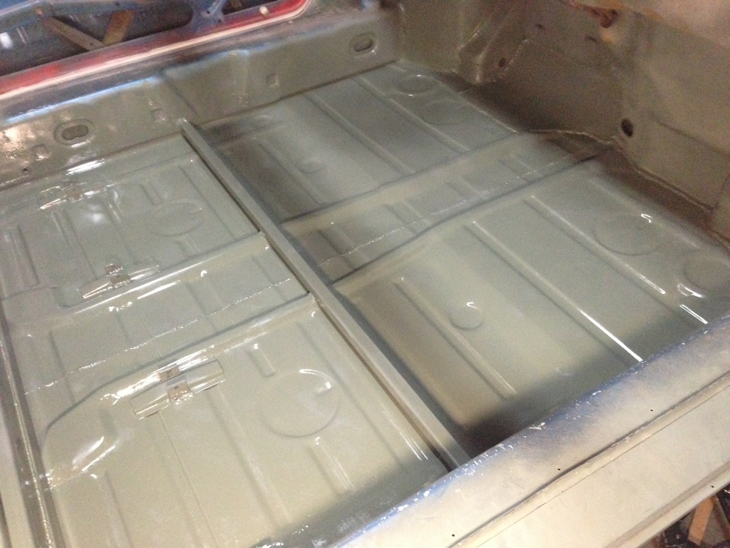

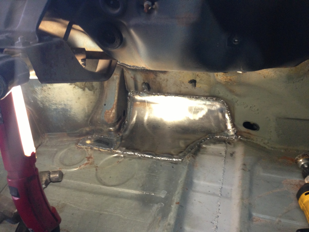

I started with the hole in the floor that was in need to be patched.
(IMG:http://www.914world.com/bbs2/uploads_offsite/i163.photobucket.com-12156-1360454916.1.jpg)
Then I put the seat mounts back in to see where I could fab in a brace for the floor.
(IMG:http://www.914world.com/bbs2/uploads_offsite/i163.photobucket.com-12156-1360454916.2.jpg)

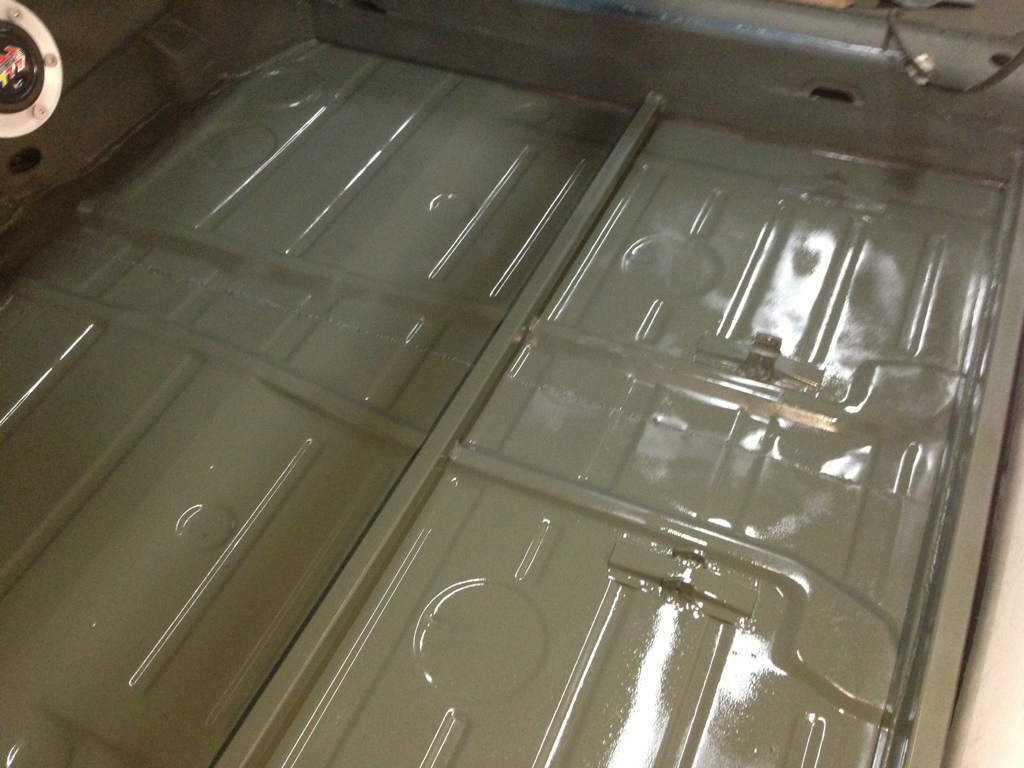

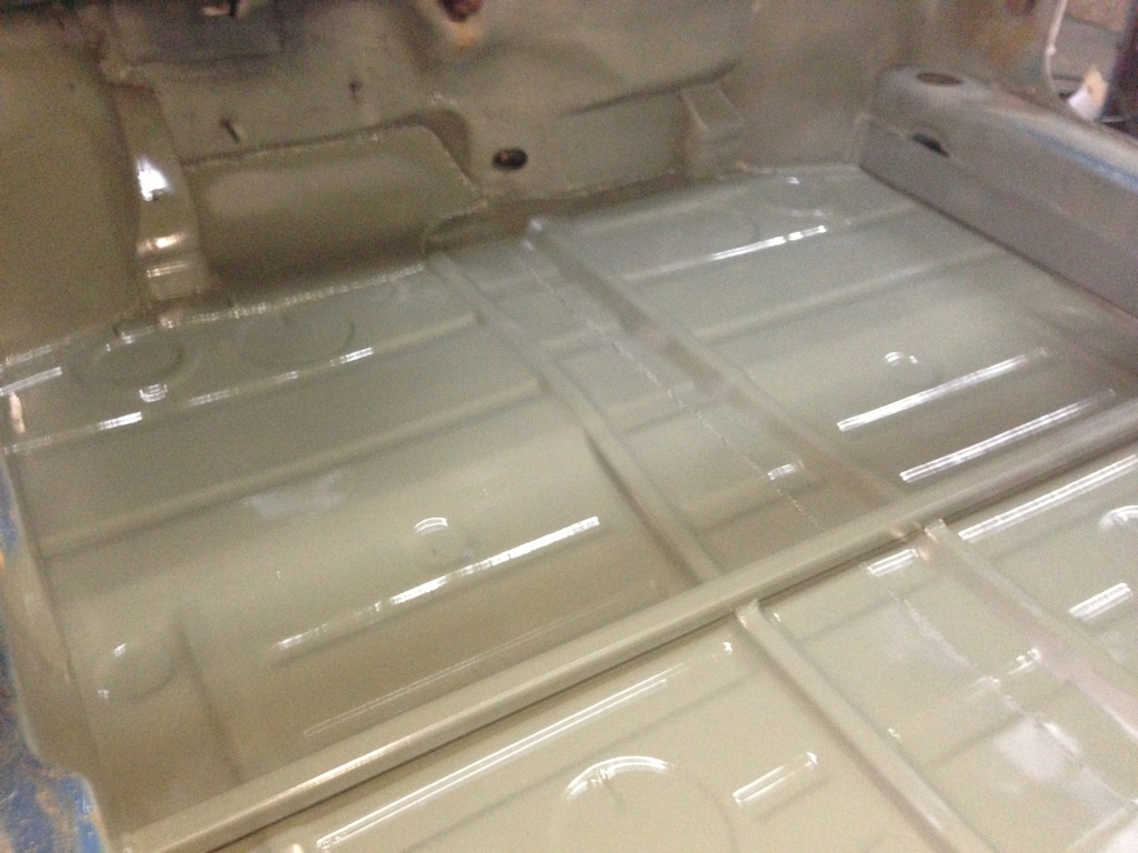

And lastly, I spent the better part of the afternoon sanding the floor to prep for primer.
(IMG:http://www.914world.com/bbs2/uploads_offsite/i163.photobucket.com-12156-1360454916.3.jpg)
(IMG:http://www.914world.com/bbs2/uploads_offsite/i163.photobucket.com-12156-1360454916.4.jpg)
(IMG:http://www.914world.com/bbs2/uploads_offsite/i163.photobucket.com-12156-1360454917.5.jpg)
It was a long afternoon... But an enjoyable one!

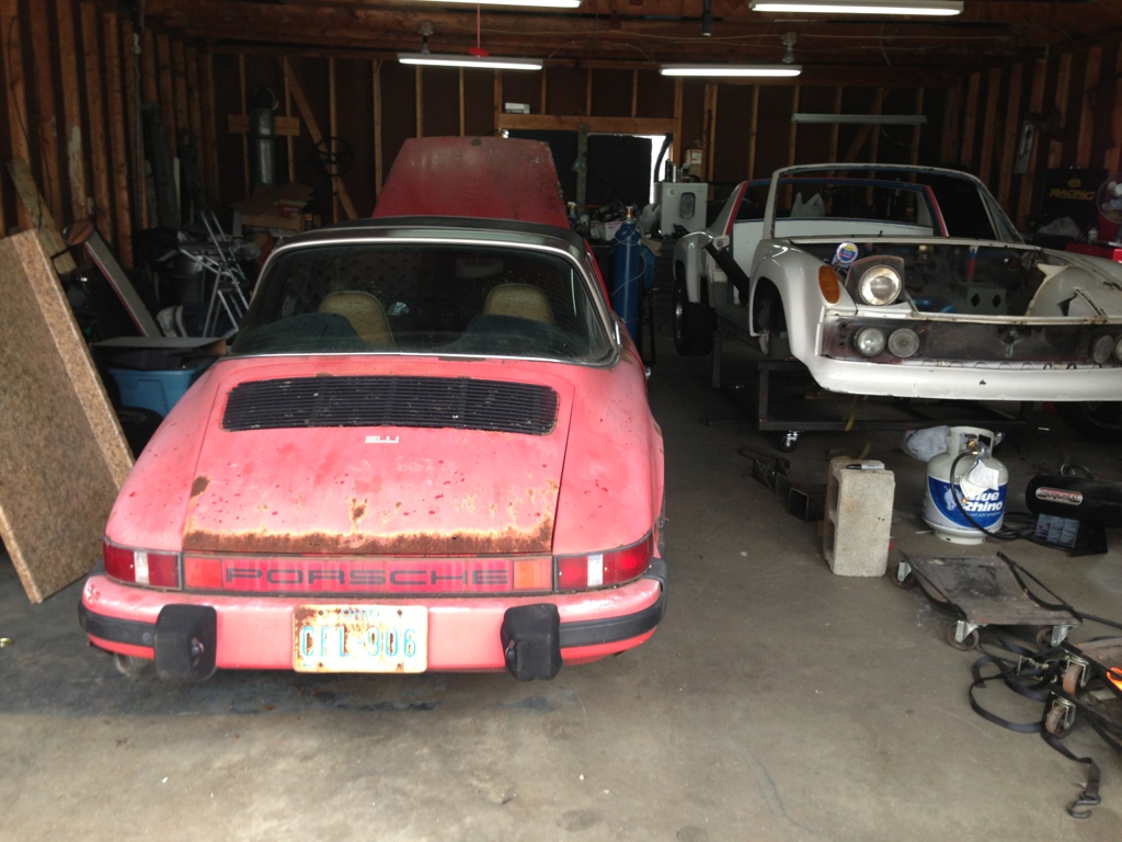

Got a few things done the past couple days.
Made some changes to an old cart I had built a few years back and added new casters. Then I sat the teener on it so I can start pulling everything back off of it and get the suspension straitened out.
(IMG:http://www.914world.com/bbs2/uploads_offsite/i163.photobucket.com-12156-1361118683.1.jpg)
This will be a good stopping point because now I have to spend the next few weeks stripping this down....

I have a handle on the shifter now.

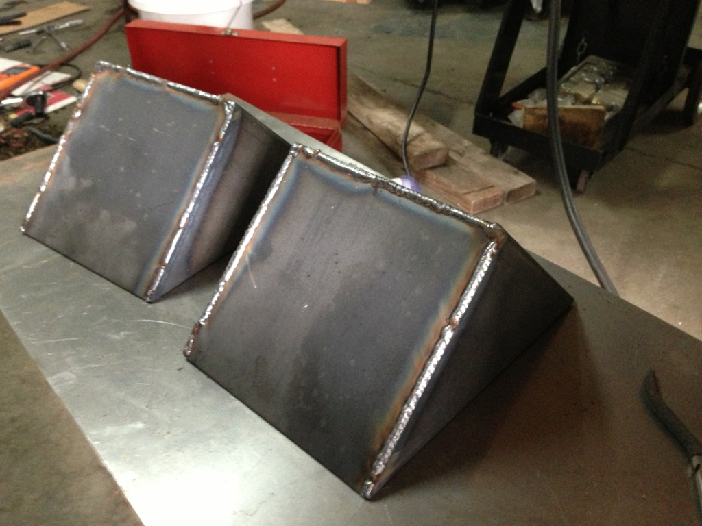

After hashing out exactly what I wanted for my camber plates, I have built them. They are a combination of 1/8" sheet and .2" plate. I figure for the verticle surface 1/8" will be plenty strong after I bent it in the break press and welded the top plates on.
(IMG:http://www.914world.com/bbs2/uploads_offsite/i163.photobucket.com-12156-1364008890.4.jpg)
(IMG:http://www.914world.com/bbs2/uploads_offsite/i163.photobucket.com-12156-1364008890.5.jpg)

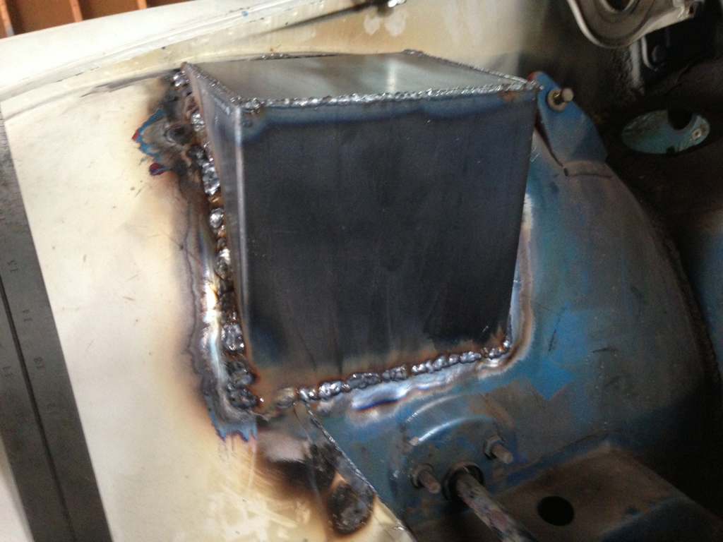

Car is at a snails pace but by golly this thing will roll on its own when I stop redesigning and rethinking what I want outta this thing. All in all I'm having fun though!
Recent stuff. Most is just tacked in place waiting for everything to come together.

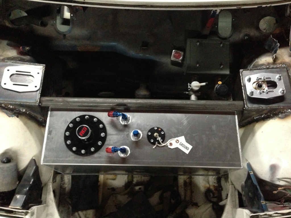

(IMG:http://www.914world.com/bbs2/uploads_offsite/i163.photobucket.com-12156-1368065744.1.jpg)

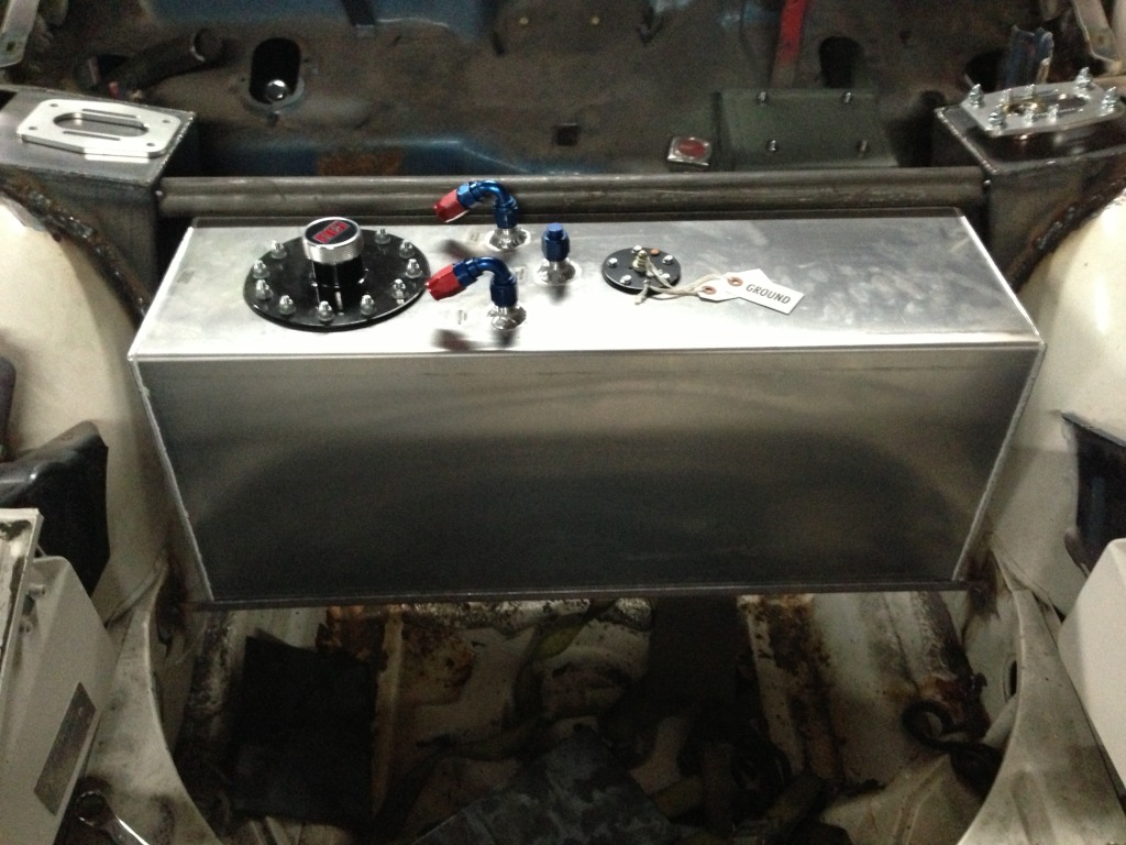

Tank is mounted and test fit with the hood and against the strut reinforcement bar..

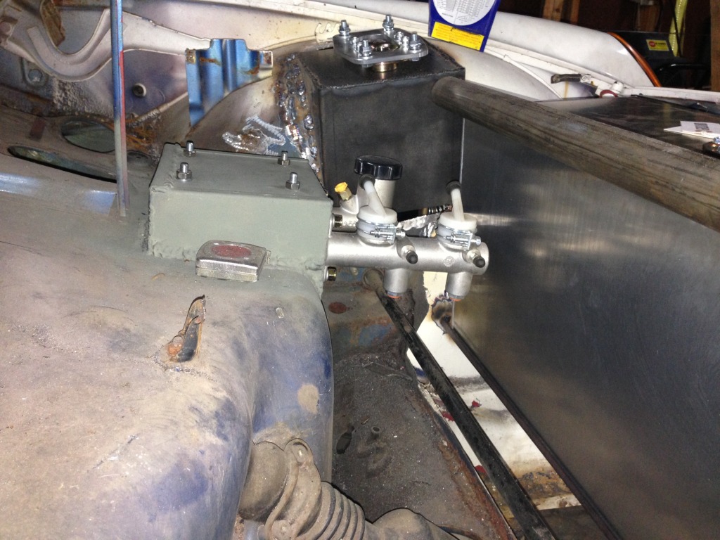

(IMG:http://www.914world.com/bbs2/uploads_offsite/i163.photobucket.com-12156-1368065744.2.jpg)
Top view you can see the master cylinder and clutch cylinder hiding behind the tank and under the strut bar.
(IMG:http://www.914world.com/bbs2/uploads_offsite/i163.photobucket.com-12156-1368065744.3.jpg)
View from behind the tank...

you are not afraid to get radical with the fabrication.
Love the cable shifter setup and fuel cell.

Thomas,
Why so high with the tank? Is something going under it?
Van
tscrihfield
post May 9 2013, 06:06 PM
Post #140
Posts: 643
From: Amelia Ohio
Member No.: 12,156
Thanks John! I am going a bit radical, my thoughts are... It's just a car!
Van, nothing right now. There are two reasons though. 1 provisions for a GT cooler in the future when it has the 6 in it. 2 I am making a through hood filler so I wanted it close to the hood. The CG is not as low I know but what can you do with such A tall profile tank.
Thomas
