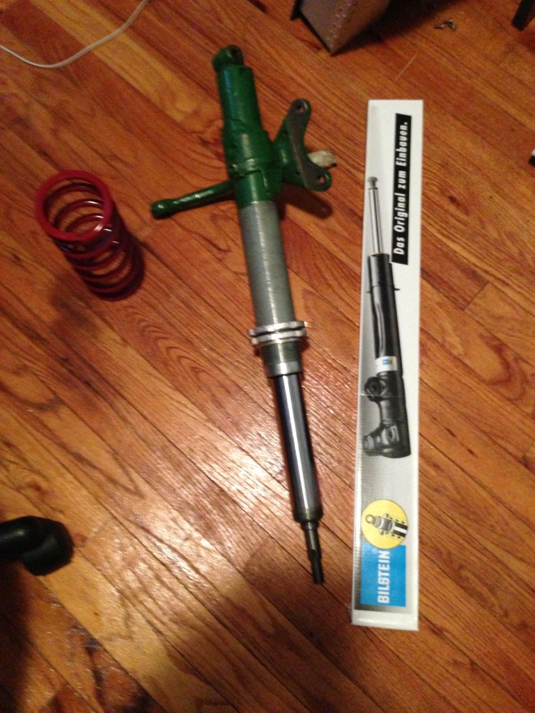

Sorry that I am just getting back to the thread. But thank you Steve for the kind words! If you need any advice in doing these upgrades/conversions I wouldn't mind sharing my knowledge.
I have not been doing too much lately as I am doing some work on a friends boxster. Infamous IMS bearing replacement, deep sump and clutch. Hopefully done before the Ault Park concours this weekend.
I am also collecting parts for my RSR struts. Anyone know someone who has done this on a 914 before that wouldn't mind to be contacted? Unfortunately this is one area that I don't just want to jump into due to the expense of parts and modifications. I know that elephant racing has some options but has been difficult to make contact at convenient times.
Currently the struts already have the spindles raised, what I am after is inserts used and what is the preferred spring rate and valving for a street/track car.
Thanks,
Thomas

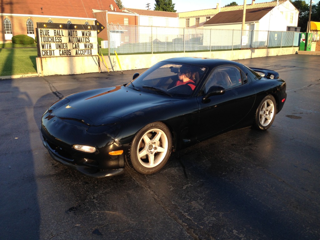

I've been busy since the last post. Not necessarily busy on my stuff but, busy none the less. I have now ordered the bits for my RSR coil over struts and am in anticipation for them to get here this week.
I have been having fun, fabbing and mounting this in an FD RX7.

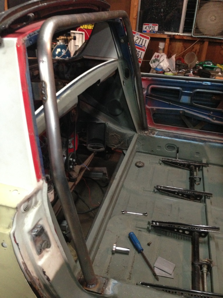

Then I went out and got my roll bar welded in. I need to clean up some welds but it turned out good.
(IMG:http://www.914world.com/bbs2/uploads_offsite/i163.photobucket.com-12156-1376360466.2.jpg)

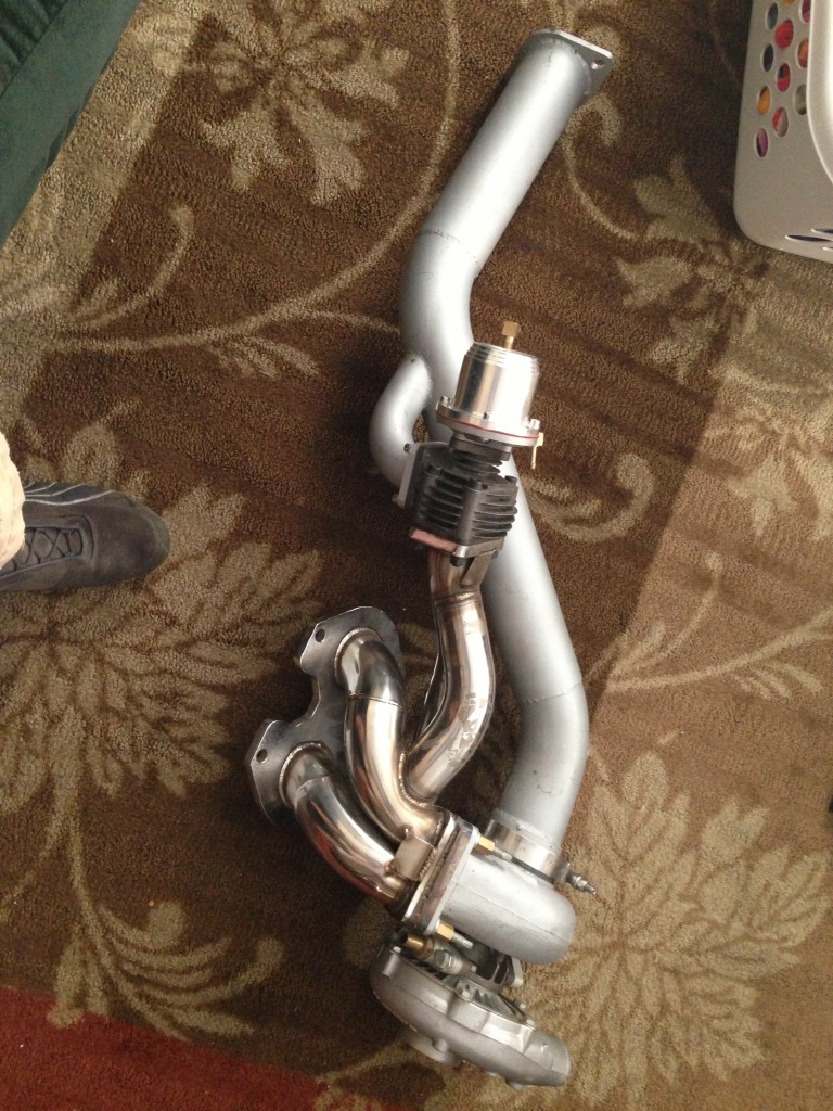

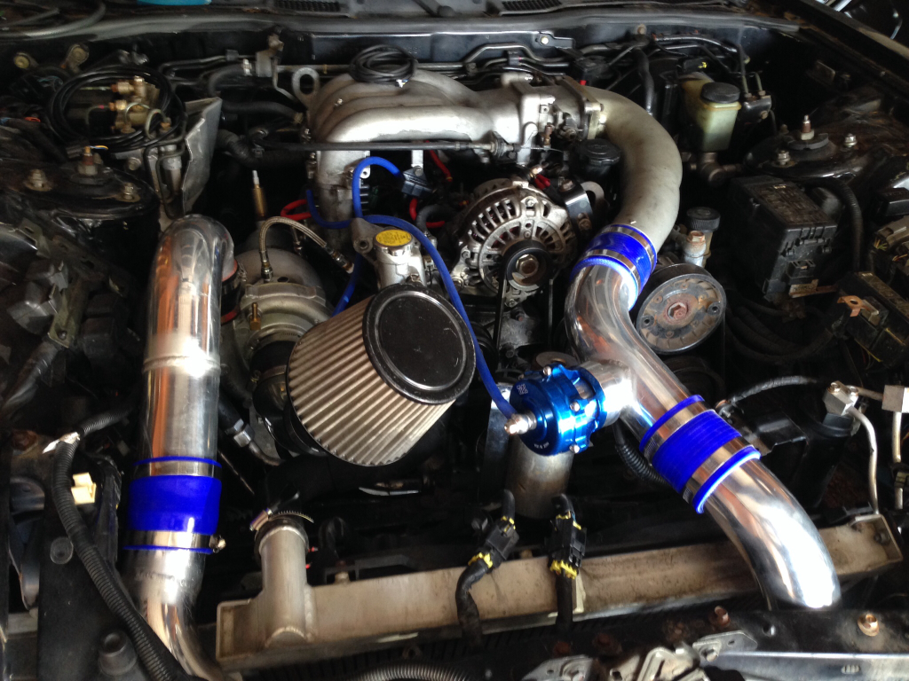

As I said before, I am building a massive single turbo RX7. I finally got the turbo in.
For those who know that there is compressor surge... I have figured it out(BOV needed more vacuum so I added a larger line). This was literally the first drive in figuring the setup out. I have to say, the Apexi power FC has made this job effortless and I love the ball bearing Garrett I strapped to it.
The engine bay...

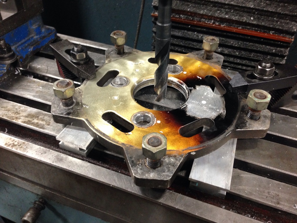

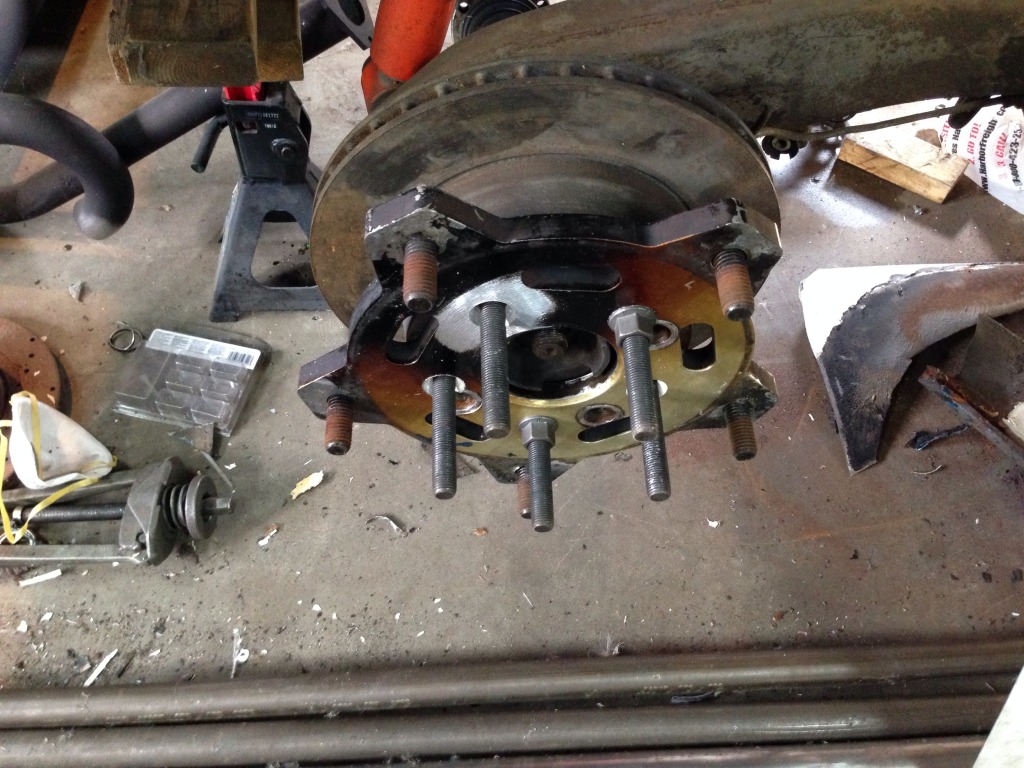

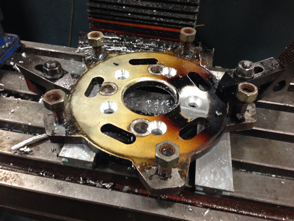

Woke up early this morning to get some work done at the shop. I recently bought some wide5 three piece wheels and the bolt pattern was 4x130mm. So I welded up one hole and put it in the mill.
(IMG:http://www.914world.com/bbs2/uploads_offsite/i163.photobucket.com-12156-1383433312.1.jpg)
(IMG:http://www.914world.com/bbs2/uploads_offsite/i163.photobucket.com-12156-1383433312.2.jpg)
The charring is the clear coat on them.

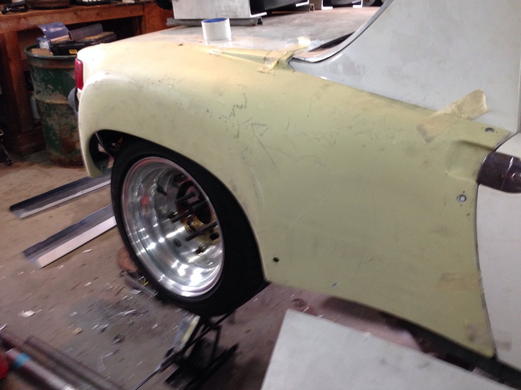

I brought them home and mounted them to see how they look.
(IMG:http://www.914world.com/bbs2/uploads_offsite/i163.photobucket.com-12156-1383433312.3.jpg)
(IMG:http://www.914world.com/bbs2/uploads_offsite/i163.photobucket.com-12156-1383433312.4.jpg)
(IMG:http://www.914world.com/bbs2/uploads_offsite/i163.photobucket.com-12156-1383433312.5.jpg)
I have to paint them yet but I like the look of them and they fill up the wells with the 11" flares. I'm most likely. Looking at buying a custom set of Fuchs for the street, but that is in the future after the car is mobile.

How much risk is there of making the bolt circle slightly off center?
tscrihfield
post Nov 2 2013, 07:09 PM
Post #154
Drive Fast and Take Chances
Posts: 643
Joined: 8-September 10
From: Amelia Ohio
Member No.: 12,156
QUOTE(rnellums @ Nov 2 2013, 08:52 PM) *
Do you mean eccentric? If so, there is always risk. But with the machine I did the work on, I am more than confident that they are good. Plus, if you look at the first image of them on the table. You'll see where I did touch off with the drill verifying the program and bolt holes were concentric. I used the cmm to verify after I was done, no worries now.
rnellums
post Nov 2 2013, 10:25 PM
Post #155
Professional Enthusiast
Posts: 1,673
Joined: 26-November 09
From: Littleton, CO
Member No.: 11,072
so I shouldn't try this with my corded Milwaukee drill?
tscrihfield
post Nov 3 2013, 06:57 AM
Post #156
Posts: 643
From: Amelia Ohio
Member No.: 12,156
QUOTE(rnellums @ Nov 3 2013, 12:25 AM) *
Depends on how steady your hands are. (IMG:style_emoticons/default/confused24.gif)
I can see it being done more primitive tools, just not that primitive....
