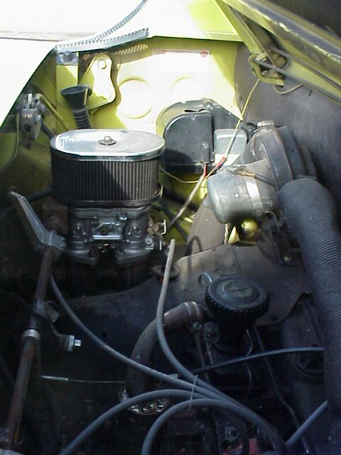

Hello everyone, I am a newbie and I am fortunate to find all of you here at this forum to share ideas. I just picked up a 914 with a 1.7 engine. there has been some work done to this babe previously. the gas pedal was stock, I removed it and order a new one from pelicanparts.
I am not sure that the previous owner installed it correctly. I have been looking at some pics and I am more confused than ever. the cross bar is installed facing the front of the car. I have seen some facing the back. for me to make it face the back means that I would have to flip the carbs i think, wiich seens to be the correct eay considering the lenght of the old cable.
can anyone help with some pictures. (IMG:style_emoticons/default/piratenanner.gif)

The linkage bar can be on the front or the back. Some prefer one over the other, but either will work. Post some pics of your setup. I'll post some pics of mine later if no one beats me to it.

Thanks Mike. I will in a few.
there is a metal plate atteched to one of the carbs that the cable is attached to. it it was attached to the pasenger side. it did not make any sense to me. going out to take pics now.......

QUOTE(ppetion @ Oct 10 2010, 11:49 AM) *
QUOTE(ppetion @ Oct 10 2010, 11:10 AM) *
QUOTE(ppetion @ Oct 10 2010, 10:37 AM) *
The pics are in my photobucket: here is the URL http://s1127.photobucket.com/albums/l638/ppetion/
Thanks
I have atteched some pics, thy are not the best as the sun is beaming right on the engine

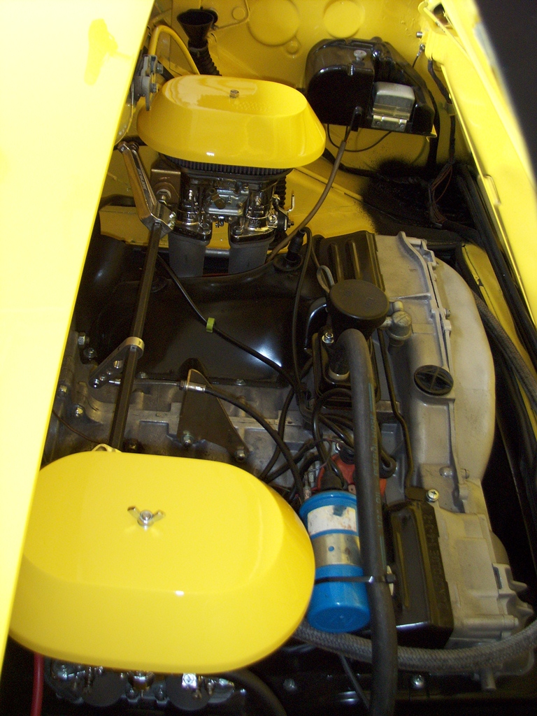

post Oct 11 2010, 06:28 PM
Mike Ginter
Posts: 16,111
Joined: 26-December 02
From: Denver CO.
Member No.: 20
I didn't realize you were putting all of your eggs in one basket. I forgot about this and didn't get a pic taken of my setup. However, there are hundreds of pictures on this site of carb linkage setups. Search is your friend. You'll see pics in these threads with the linkage at the front of the carbs and the back. You can do it either way as I said before. You just have to get creative about how you run the cable and setup the linkage.
http://www.914world.com/bbs2/index.php?showtopic=98073&
http://www.914world.com/bbs2/index.php?showtopic=107538&
http://www.914world.com/bbs2/index.php?showtopic=91165&
http://www.914world.com/bbs2/index.php?showtopic=84598&
A picture of my first 914's linkage setup. I took this same carb and linkage setup off of this car (years later, long story) and put it on my current 914:

Socalandy
post Oct 11 2010, 08:06 PM
Its got to be Yellow!!!
Posts: 2,433
Joined: 29-August 09
From: Orange
Member No.: 10,742
the setup Gint has is a Redline kit. I run that as well and works perfect
