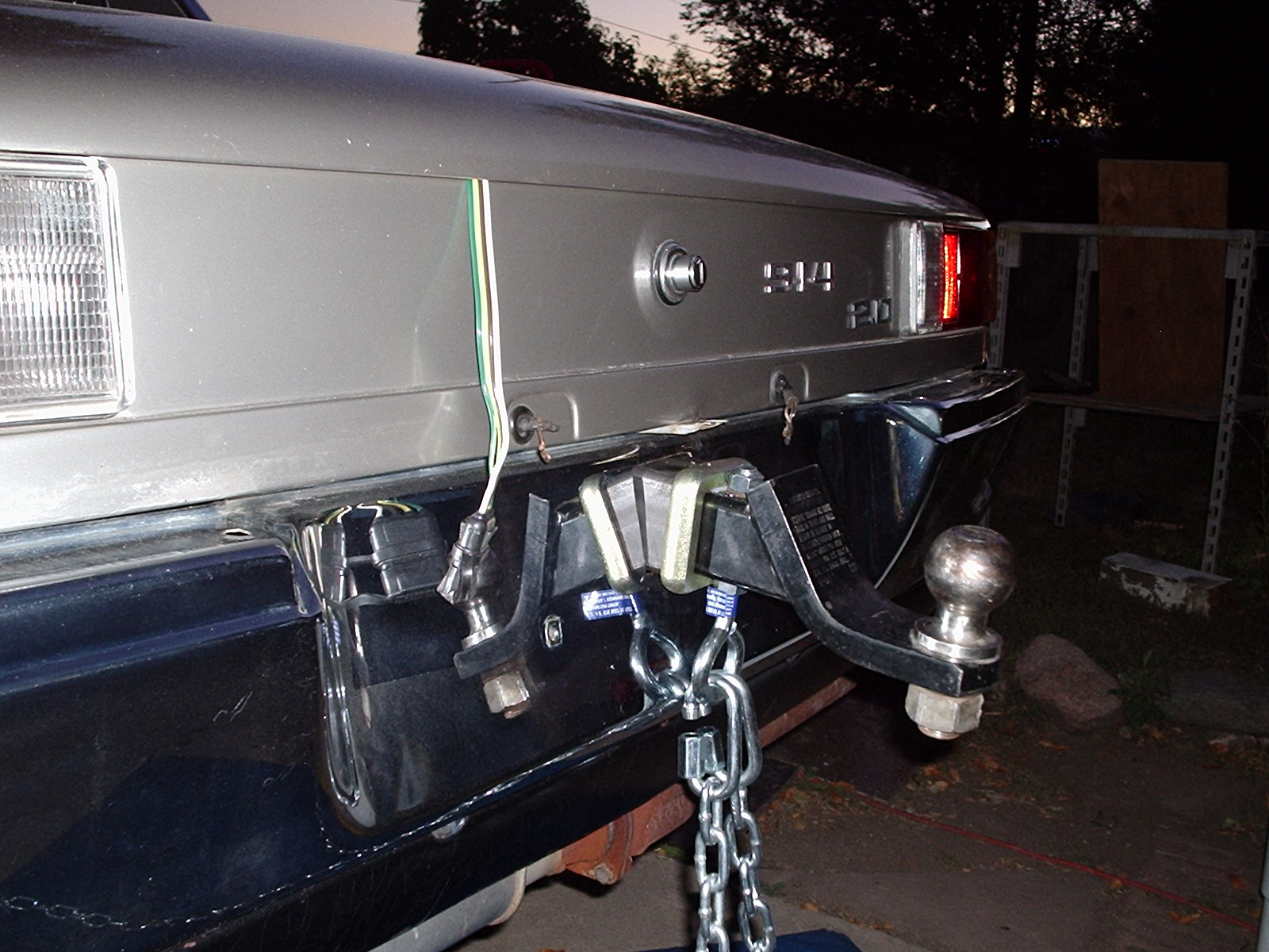

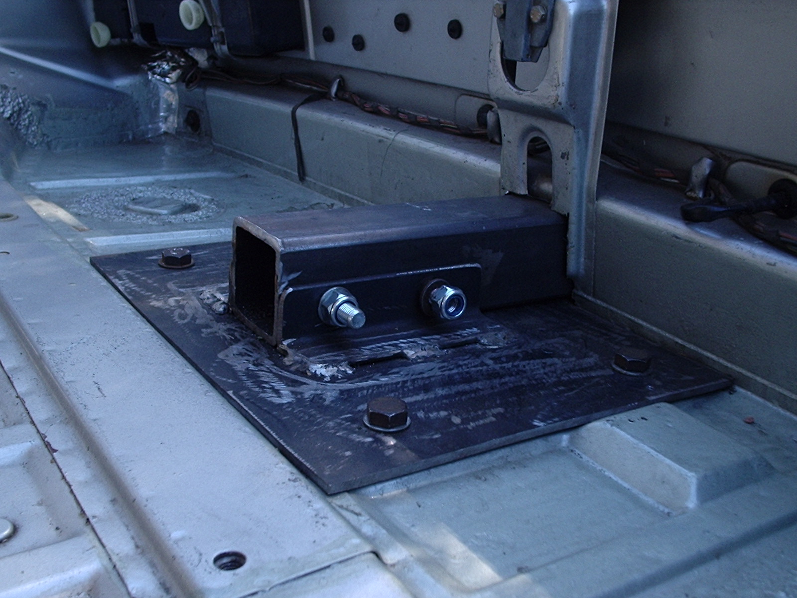

With lead designer from Alien, Rick
we came up with a "Removable receiver hitch"
Pics. says it all

Sacrifice a very nice bumper. (IMG:style_emoticons/default/happy11.gif)

Answers
1) Very easy to set up, no scratches
2)Same as above (IMG:style_emoticons/default/biggrin.gif)
3)Very confident. I strap the rear wheel down, front forks are bolted down with quick release.
4) The reciever hitch itself would be the most expensive, donated by one of our fellow member, metal? $20-30 ? (I had a lot of scrap laying around from Kar-B-Q)
5)Nope
6)Nope

I dont see a locking pin on that receiver, was that pic prior to the hole being drilled?
How much did the bike rack cost you?
I have always wondered how sturdy side to side those hitch racks are, Comments on that?
Thanks!
majkos
post Oct 20 2010, 03:20 PM
Post #29
Posts: 1,370
Joined: 29-February 04
From: Mile High 914
Member No.: 1,729
QUOTE(Andyrew @ Oct 20 2010, 01:00 PM) *
Thanks!
Good eyes!
Second set of bolts goes thru the bar
The bike rack;
I do all kind of wheelie and dealing, trade outs
and think it costed me $45 Many,many moons ago
They're sturdy! but here's the catch, the bike tends to *snap* side to side.
Rocking back end forth, bam! ...........bam
I strap the ends down to the bumpers, (no worries there, the bumper)
Haven't really checked with the 914
I threw the rack on today to see if it's doable. (IMG:style_emoticons/default/biggrin.gif)
Another shot of the hitch,finish that night

QUOTE(majkos @ Oct 20 2010, 01:39 PM) *
Interesting concept, but IMHO too much hacking to a nice 914 for a bike rack.
Too bad somebody can't make a hitch crossbar mount tight under the rear valance (or under the bumper in place of the valance with the valance removed), which tucks cleanly away under the bumper with the hitch insert removed (not to mention no holes thru the 914 rear wall/bumper/trunk floor where future rust dwells) -
... say something similar to this one by GoWesty for Vanagons .....
http://www.gowesty.com/ec_view_details.php...gory_parent_id=
... not sure what to attach the crossbar mounting plates to up under there - maybe the rearmost longs - plus it will need to clear around or at the ends of the muffler/tailpipe. This Vanagon one was easy because the detail of the bolt-on connectors is to the 2 L&R tow hooks under the rear bumper.
I know I've seen some 914's towing small trailers on here before, so somebody must have a way to attach a tow set-up.
Any hitch wizzes out there have any thoughts on this?

Tom, Im pretty sure all the 914 hitches go through the bumper. All the one's that I have seen do at least.
Andy -
There's gotta be a better way to do a thing like that GoWesty Vanagon set-up, but the tow insert will need to sweep out & up in order to get to the proper hitch height level - cuz IMHO it's pretty "Hill Billy" to hack into a 914 like that! (IMG:style_emoticons/default/dry.gif)
- & I'm part WVa Hill Billy too! (IMG:style_emoticons/default/biggrin.gif)
Maybe by connecting extension struts/bars from the orange arrow points at the rear underbody crossbrace &/or longitudnals' rearward extensions in pic below? (IMG:style_emoticons/default/idea.gif)
That way the hitch loads transfer to the longs directly, which are the main fore-n-aft structural components of our 914s' unibody "frame".

You could probably tie into the trani mounts and have a custom welded unit.. But it would have to be 1/8" plate or better...
I dont have an original car by any means so hacking into a 914 is nothing for me (IMG:style_emoticons/default/smile.gif)
But its good to discuss for those wanting to go that route.

no easy solution on mounting a hitch to the trans mount because the exhaust/muffler
is in the way.
and that bumper?
it has rust bubbles.
I was being mean
play in the rack/into receiver is the culprit of the snapping issue.
it's a tight fit but still wobbles.
maybe i should go for a bike ride tommorrow.......
