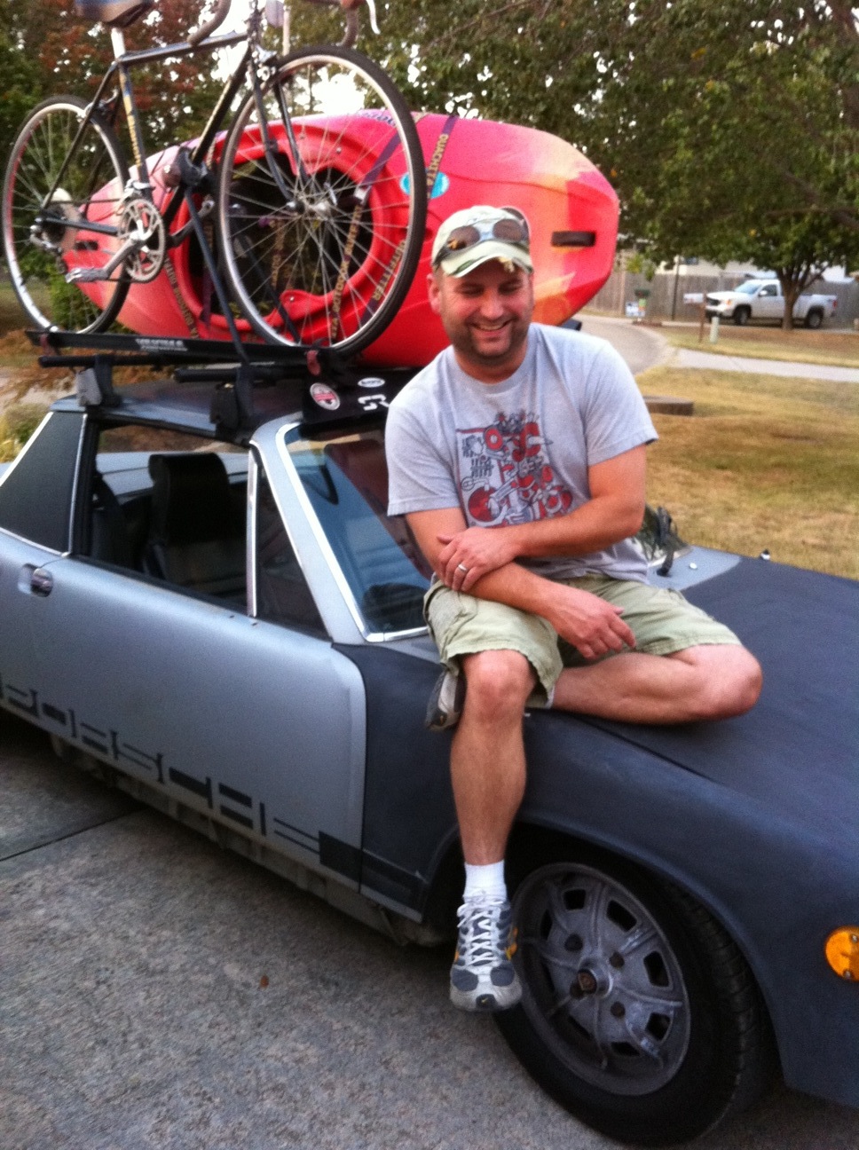

I had a rack left over from my Saturn when I took it off, so I decided to see if it would fit on my 914. It did. Very well I might add. It's a yakima rack, and hooks under the edges of the targa top, and clamps down tight right above the hooks to the top side.
It works fantastically, and I have cornered fairly quickly with the car while the bike and one of my kayaks was on top. It did just fine.
I wouldn't recommend racing around corners with it however...as somehow sooner or later it will probably mess something up. Its just not made for itm just as any of the other racks described here aren't.
That being said, it handles just fine. I can carry my bike, and at least two boats on top of the car. Sooner or later I am gonna put my 16 foot sea kayak on top and get some pictures, just to be funny.
Here are a couple pics.

Actually, the bike mounting is up there right beside the kayak. Here is another pic of it with a bike on it, close up shot. Pay no attention to the man in front of the curtain cheesing it up. I will try to take some really detailed pics tomorrow if I get the chance.

Actually on the highway it does just fine. At least I haven't had any problems any of the time I've been on the highway. I notice a decrease in speed a bit but hey, I get to carry my bikes and boats. The faring on the front of the rack system helps deflect some of the wind. It's the part with stickers directly behind me in the pic.
The rack also has a bar that holds the bike in place really well, so i don't have to take off the fron tire whenever I mount it up there. I think the rack model is called the Cobra, or something. I can find out for sure if there is interest.
Here is a closer pic of the rack...it shows how the rack grabs ahold of the top.
It's been a perfect setup for me, and so far I haven't had any issues out of it. It's been up for about a month or two now, and I use it alot.
Joe

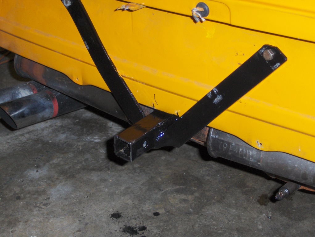

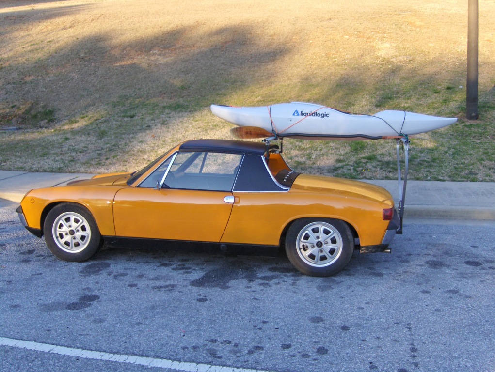

Here are some photos of my set up. I have a 1 1/4 inch receiver mounted just below the bumper. This enables me to leave the tag in place. It accepts a standard bike carrier. I have a set of bars that attach to the rear receiver, and also to the rear of the roll bar. This allows me to carry 2 kayaks. It doesn't add any load to the front windshield frame, and also allows me to remove the top if I want. I can also access both the rear trunk and engine compartment with everything installed and loaded. The receiver has a steel tube that is supported on the rear of the car by two 3/16 inch bars. The inner portion of the tube is welded to a 1/2 inch bar that is bent to go up and over the muffler and transmission. I have a few bolts through the trunk floor that hold the 1/2 inch bar. I have trailered a 30 foot long sailplane trailer with this set up, no problems. JoeO

Side view of both bars, and detail of rear end of receiver tube mount.

Receiver is a standard 1 1/4 inch tube that is mounted as shown. Notch out the rear valence to clear the tube. Outside mounts are shown. As I said, there is a piece of steel bar welded on the inner portion of the tube that is bent to go over the muffler, and is bolted to the floor of the trunk. The receiver accepts a standard 1 1/4 inch bike carrier. Either an expensive one from Thule or Yakama, or a cheap version from Harbor Freight. Just plug the bike carrier into the receiver, and insert retainer pin. I just included this info since someone asked about mounting the hardware. Someone could also mount the front bar as I did. I leave the aluminum retainer blocks on the car. I just plug in the front bar and insert two quick release pins to hold it on. The bar is a standard Thule aluminum cross bar, and would accept Thule bike holders. JoeO

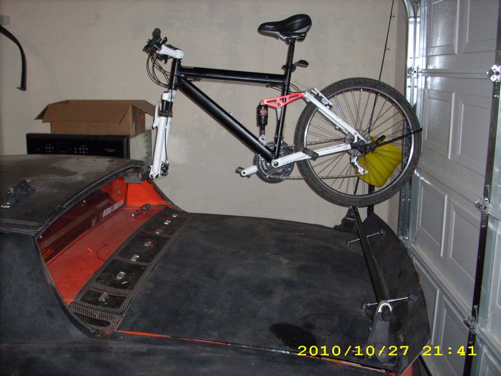

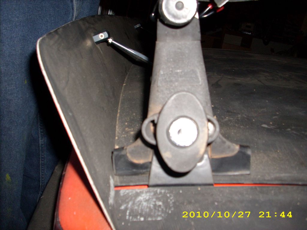

Got my setup!!
The raingutter mounts are perfect for the trunk!!!
So far im out $73! Plus maybe 5 bucks in scrap metal.. (However I do want to redo the mount as even with a bunch of reinforcement its wobbly.. I did make it out of 14ga metal though so now im gonna try 1/8"...)

post Oct 28 2010, 08:32 AM
Post #60
Posts: 1,370
Joined: 29-February 04
From: Mile High 914
Member No.: 1,729
I suggest some how connect the two plates, help brace themselves.
You've put together a nice, easy and afforable set-up!
