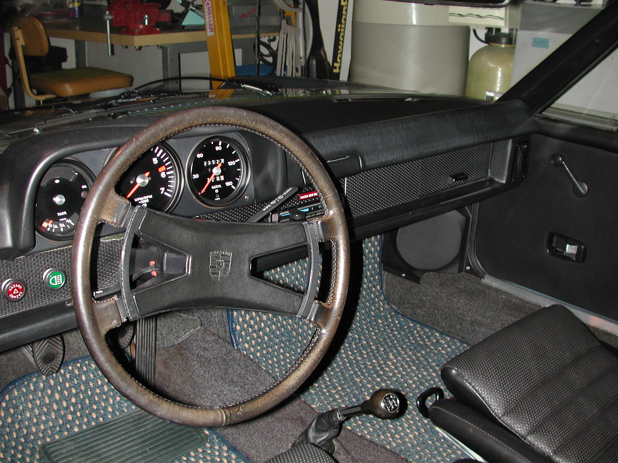

I use KEFs & Tannoys at home. I just don't have the time or energy anymore to put a system in the 914.
