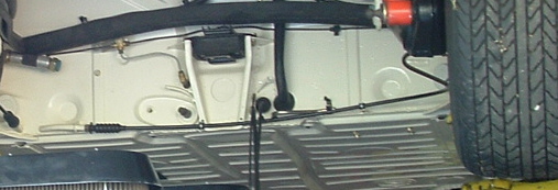

> Right Handbrake Cable Attachment, been scouring the PET... is it just a loop?
Eric_Shea
post Oct 31 2010, 10:43 PM
PMB Performance
Posts: 19,304
Joined: 3-September 03
From: Salt Lake City, UT
Member No.: 1,110
Wondering what holds the right parking brake cable to the tabs welded on the back of the floor pan. The PET is a little unclear but it looks like there may be loops that just hold the cable.
The tabs have speed clips on them.
Anyone?
TIA
E.

sixnotfour
post Oct 31 2010, 10:50 PM
Posts: 10,906
Joined: 12-September 04
Member No.: 2,744
adel clamps
McMark
post Nov 1 2010, 12:59 AM
914 Freak!
Posts: 20,180
Joined: 13-March 03
From: Grand Rapids, MI
Member No.: 419
Little metal loops that look a bit like a P or d or b. They have a rubber insert that protects the cable from wear. There is a small phillips head screw that screws into a 'speed-nut' on the chassis tab.
ChrisFoley
post Nov 1 2010, 08:14 AM
I am Tangerine Racing
Posts: 7,990
Joined: 29-January 03
From: Bolton, CT
Member No.: 209
QUOTE(McMark @ Nov 1 2010, 02:59 AM) *
Yeah, Adel clamps. (IMG:style_emoticons/default/biggrin.gif)
Eric_Shea
post Nov 1 2010, 08:31 AM
PMB Performance
Posts: 19,304
Member No.: 1,110
Thanks Gents.
