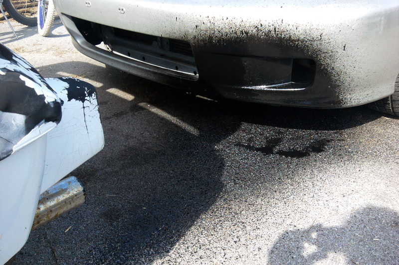

Well, I got my LE to start up once again. Ended up being fouled plugs. Replaced with new ones and it fired right up and ran great. Revved up no problems. (IMG:style_emoticons/default/piratenanner.gif)
Lot of white smoke coming out of the exhaust. I thought it might be unburnt fuel until I saw this:
(IMG:http://www.914world.com/bbs2/uploads_offsite/www.volksbraggin.com-10419-1288633589.1.jpg)
(IMG:style_emoticons/default/headbang.gif)

dflesburg   Wonder what was fouling the plugs... LOL   Nov 1 2010, 11:50 AM
messix   DOH! :stooges:   Nov 1 2010, 11:52 AM
Sleepin   I would say that you have a 99-00 Civic that needs...   Nov 1 2010, 12:16 PM
poorsche914   LOL... yep, cleaned that up right away. So... any...   Nov 1 2010, 12:25 PM
ClayPerrine   Dood..... Yer 914 blew a nasty, oily fart all ove...   Nov 1 2010, 12:24 PM
messix   oil level to high, over pressured crankcase [no ve...   Nov 1 2010, 12:35 PM
underthetire   Ha, the 914 just shit on the ricer ! Nice...   Nov 1 2010, 01:00 PM
76-914   Ha, the 914 just shit on the ricer ! Nice...   Nov 1 2010, 01:11 PM
poorsche914   [quote name='underthetire' post='1389438' date='N...   Nov 1 2010, 02:23 PM

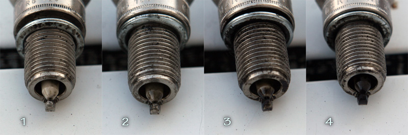

messix   #4 doesn't look to good. that hole is most lik...   Nov 1 2010, 02:40 PM
RobW   Bummer on the engine :barf: Classic picture tho...   Nov 1 2010, 03:05 PM
poorsche914   Bummer on the engine :barf: Classic picture th...   Nov 1 2010, 03:38 PM
messix   did you crank this over and over trying to start i...   Nov 1 2010, 03:29 PM
poorsche914   Yes, I did crank and crank and crank.... Also doub...   Nov 1 2010, 03:37 PM
messix   Yes, I did crank and crank and crank.... Also dou...   Nov 1 2010, 03:44 PM
poorsche914   don't drive it or run it any more untill you c...   Nov 1 2010, 04:10 PM
messix   don't drive it or run it any more untill you ...   Nov 1 2010, 04:14 PM
kg6dxn   You need to drain the oil from the exhaust :D Seri...   Nov 1 2010, 03:57 PM
messix   You need to drain the oil from the exhaust :D Ser...   Nov 1 2010, 04:09 PM
rick 918-S   Cool NARP photo! Just like Herbie!   Nov 1 2010, 04:51 PM
windforfun   Nice fart.   Nov 1 2010, 04:54 PM
poorsche914   Nice fart. Technically, I suppose it was a ...   Nov 1 2010, 04:56 PM
r_towle   First, you cant trust a cold compression test. It ...   Nov 1 2010, 05:56 PM
poorsche914   Thanks, Rich. Been planning to get a warm compres...   Nov 1 2010, 06:00 PM
r_towle   if its close...re-torque the heads and test it aga...   Nov 1 2010, 07:06 PM
Black22   My car did everything you described...white smoke....   Nov 1 2010, 07:48 PM
poorsche914   My car did everything you described...white smoke...   Nov 1 2010, 08:46 PM
