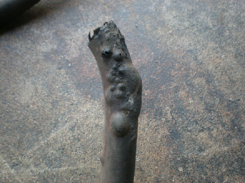

AvalonFal   I posted this pic a while back, but here's an ...   Dec 12 2010, 11:01 AM
realred914   I posted this pic a while back, but here's an...   Dec 12 2010, 11:21 AM
AvalonFal   I posted this pic a while back, but here's a...   Dec 13 2010, 08:53 AM
