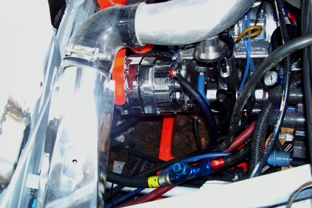

Many of you know my car. It was Steve Malmz's car he found in a yard as a roller. It was a former SCCA club racer. Malmz named the car Sasquach. Malmz put a V8 in it and drove it until his priorities changed. It was sold to a guy in Kentucky (unknown name), he regeared the transaxle and drove it little. He sold it to a PCA member in Irvine, CA. That guy used it as a DE car until I purchased it. I installed an EFI system and drove the crap out of it. Recently my clutch went out and I decided it was time for a change. The V8 is going to another member. My engine choice is Top Secret, under wraps until I make my final choices. a Turbo Rotary. I'm taking a twin turbo and converting it to a single large turbo. This mod keeps it simple and increases horsepower. My new license plate will be "914 TT".
The car has 930 suspension and brakes. 930 steel flairs grafted on, a total of 8 flairs were used. Two per corner to make up the radius. There is a roll cage with removable door bars. The cage is tied to the rear suspension but not the front. The bodywork ant paint are 10+ years old and the car is several shades of white. The chassis is super solid. Only minor surface rust has been found. The Original owner/racer installer a stiffening kit and various braces. The suspension console is unusual. Steel plats replace the inboard pivots. 1/8" & 1/4" plate steel reenforcement plates are surrounding the console. A 1" bar ties in the console to the firewall.
Here are the first pics of me stripping paint from the engine bay and the unusual consoles.

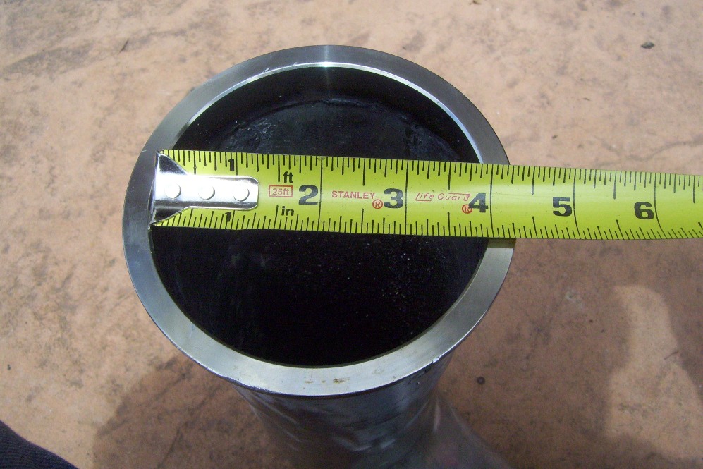

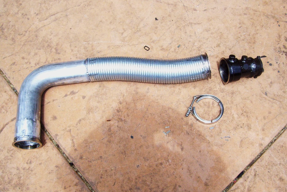

kg6dxn   Got my V Band exhaust clamps in... 4 INCHES!...   Feb 17 2011, 08:05 PM
Andyrew   NICE! I love Vband clamps. 4" is Biiiig A...   Feb 17 2011, 08:07 PM
kg6dxn   NICE! I love Vband clamps. 4" is Biiiig ...   Feb 17 2011, 08:20 PM
ChrisNPDrider   I thought "TT" meant Targa Top? :D You...   Feb 17 2011, 10:03 PM

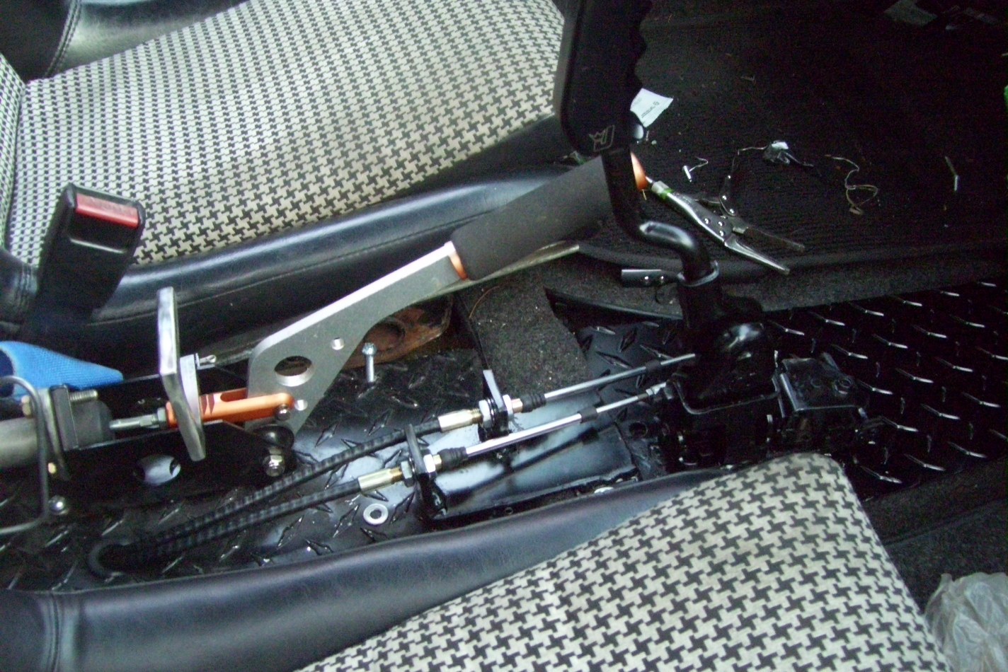

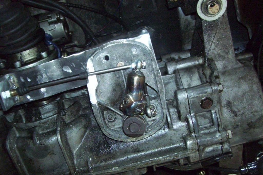

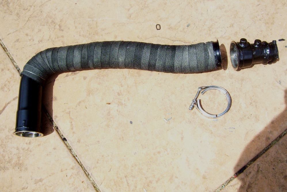

kg6dxn   My adapter showed up. Now i can finish the fab of ...   Mar 6 2011, 01:11 AM
kg6dxn   Another...   Mar 6 2011, 01:12 AM

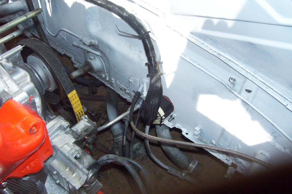

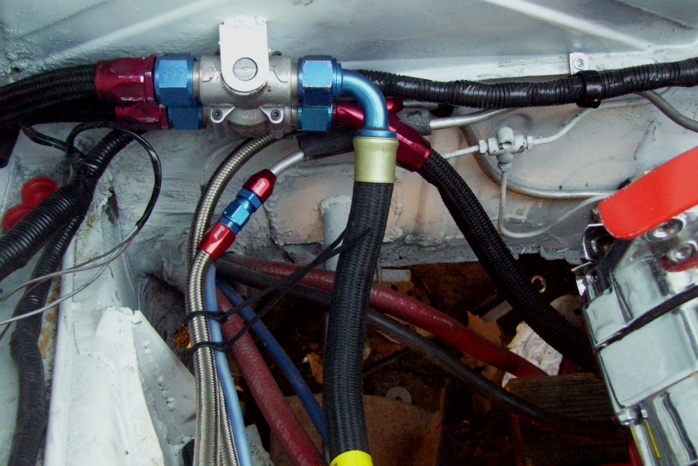

kg6dxn   I did some work inside. I welded a bracket that bo...   Mar 6 2011, 01:18 AM
kg6dxn   Now I have to figure out where I am putting my boo...   Mar 6 2011, 01:23 AM
kg6dxn   Now for the sad part. My car is outside! I was...   Mar 6 2011, 01:25 AM

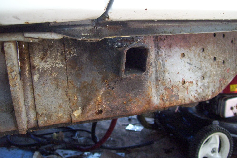

kg6dxn   I forgot to mention. I found some major California...   Mar 7 2011, 09:51 PM
Lennies914   I forgot to mention. I found some major Californi...   Mar 7 2011, 09:55 PM
kg6dxn   More...   Mar 7 2011, 09:53 PM
roadster fan   :headbanger: Looking good, keep up the good work...   Mar 7 2011, 10:01 PM
Andyrew   My honda has more rust than that!   Mar 7 2011, 11:11 PM

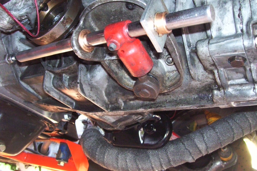

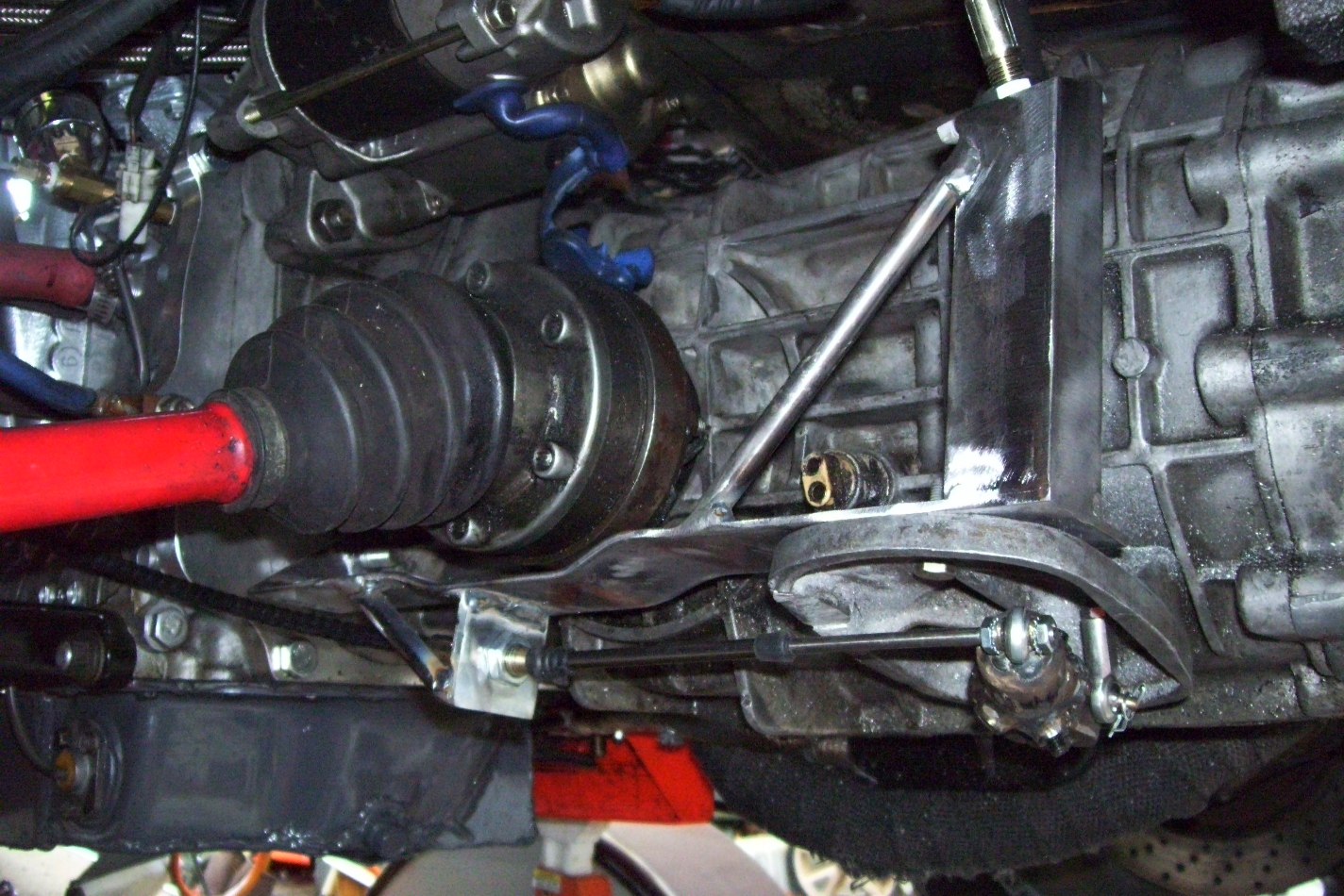

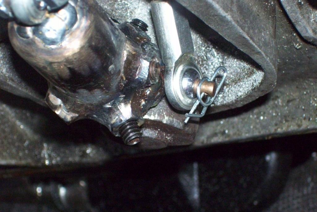

kg6dxn   I finally got my engine mount finished and install...   Mar 20 2011, 04:48 PM
kg6dxn   Here's another pic. The rain in Cali is really...   Mar 20 2011, 04:49 PM

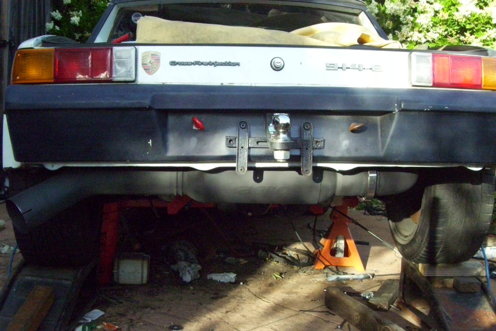

kg6dxn   I have also been working on my trailer hitch. I to...   Mar 20 2011, 07:26 PM
kg6dxn   More...   Mar 20 2011, 07:27 PM
kg6dxn   More...   Mar 20 2011, 07:29 PM

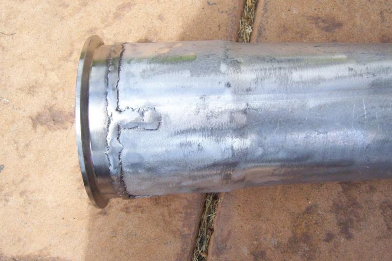

kg6dxn   Goober welds... Before I added gas to my mig welde...   Mar 20 2011, 07:32 PM
kg6dxn   The money shot. Can't even see the motor hardl...   Mar 20 2011, 07:35 PM
Andyrew   I like it all!!! Remember to primer ...   Mar 21 2011, 09:38 AM
kg6dxn   I like it all!!! Remember to primer...   Mar 21 2011, 09:50 AM
Andyrew   Ahh, that makes more sense. I didnt put 2 and 2 to...   Mar 21 2011, 10:10 AM

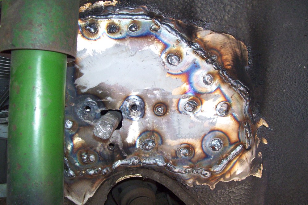

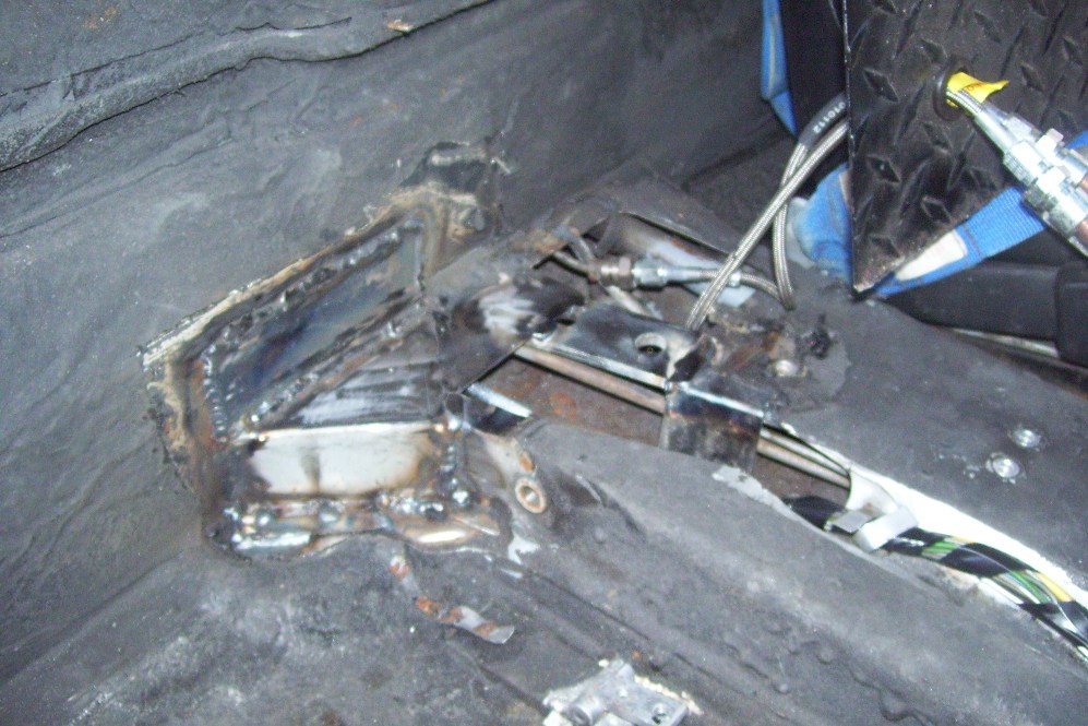

kg6dxn   Did some more work in the trunk today. Cut out the...   Mar 26 2011, 07:30 PM
kg6dxn   Got it trimed and welded. I also welded in some 1....   Mar 26 2011, 07:33 PM
kg6dxn   Got everything tied in and primered...   Mar 26 2011, 07:35 PM

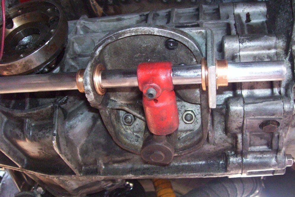

kg6dxn   Strawman get me thinking about the engine bar moun...   Mar 26 2011, 07:38 PM
kg6dxn   I beefed up the engine mounts with some 14ga steel...   Mar 27 2011, 08:30 PM
