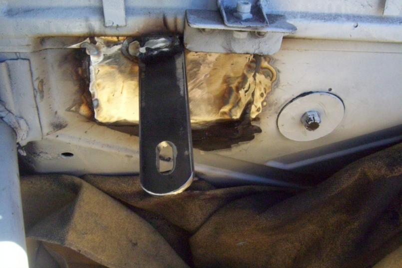

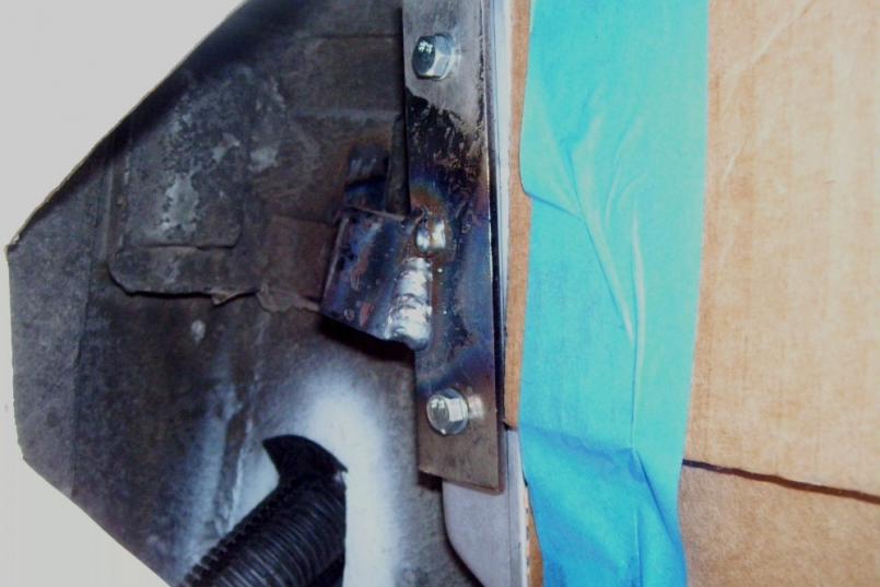

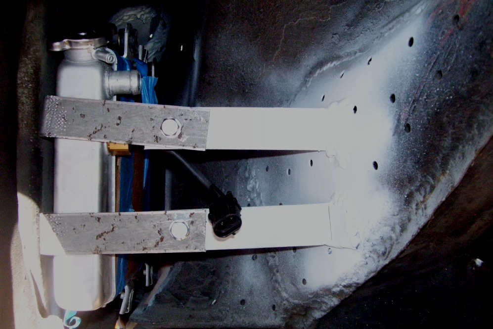

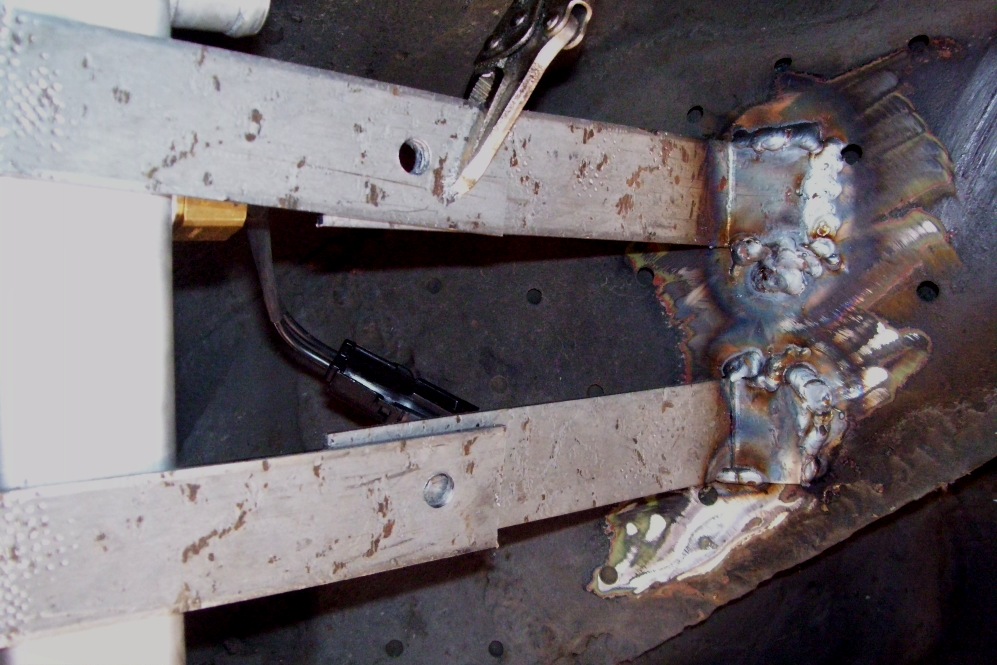

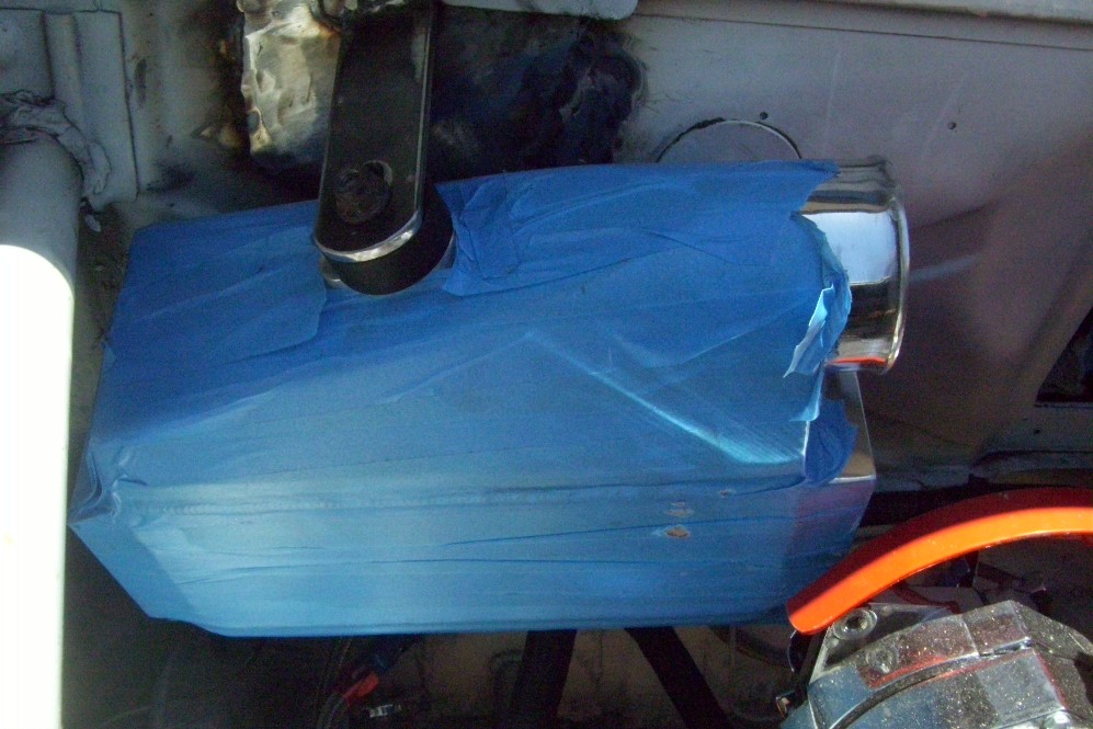

I got the intercooler brackets installed. I beefed up the firewall with some 14ga steel. There is a small gusset onder the bracket. I found some poly bushings to isolate vibration. Below a bent up some 1/4" stock and welded to the lower firewall brace. everything fits and everything clears...

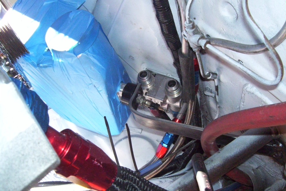

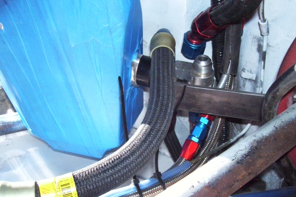

Here's a shot of the bottom...

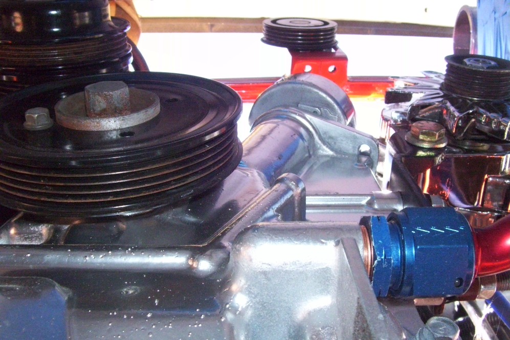

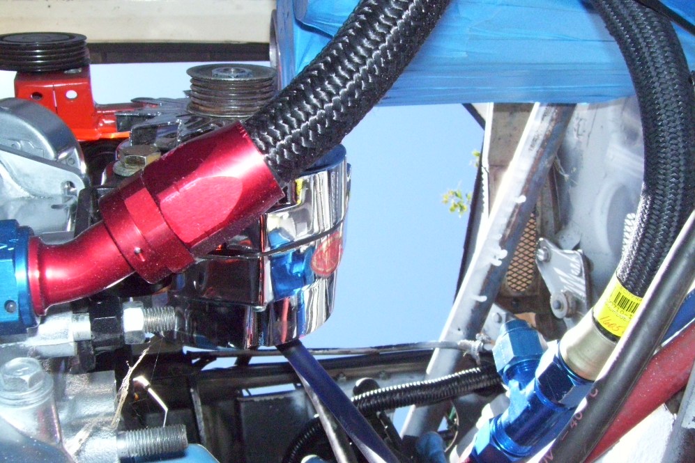

This engine is so small, I can work on the front of the motor... Notice my pulley with one bolt. I noticed my turbo drain line not hooked up. Missing bolt on water pump. water pump pulley missing 2 nuts... etc...

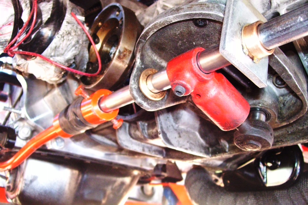

Got my shift rod connected... (IMG:style_emoticons/default/piratenanner.gif)
I had to bend the rod around the engine but it works great. very smooth ande tight...

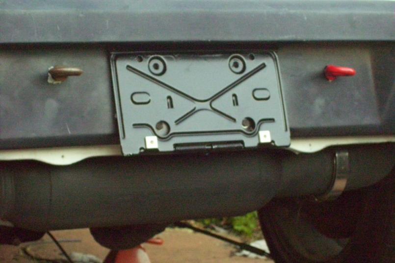

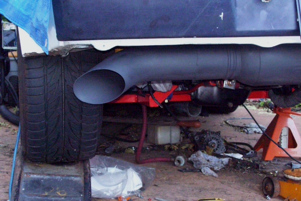

Spent a few on the car after work. Mounted my spring loaded license plate holder. This will hide my hitch receiver hole when not in use. I also cut the exhaust tip square with the rear of the car. The outlet looks even bigger now. It's a 4"x5" oval, slightly angled down. I might even be able to get a stock valence to fit. With a little mod. Anyone have one they want to get rid of?

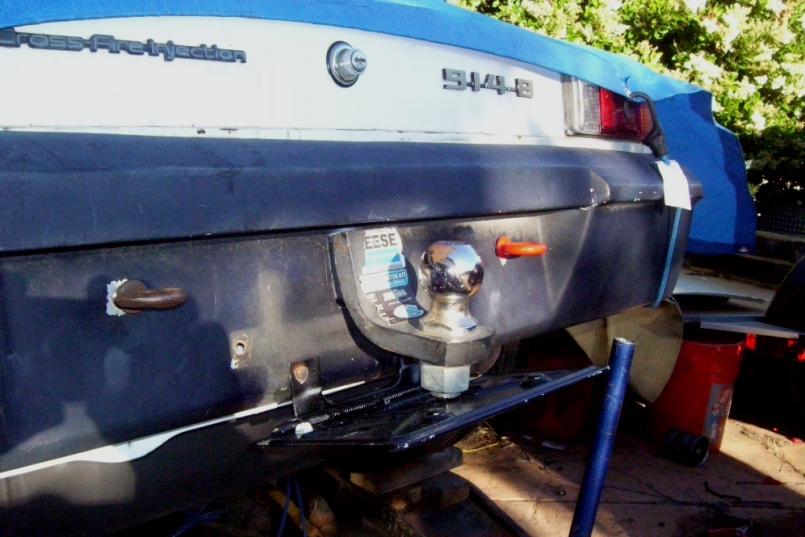

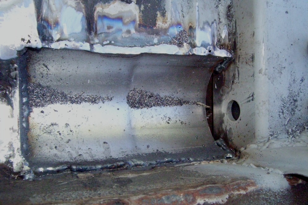

Installed vacuum hoses from my BOV to my Boost Controller to my Waste Gate. Also cut a piece of 3" pipe lengthwise and welded it into the trunk. This wil alow my hitch pin to be inserted into the receiver tube.

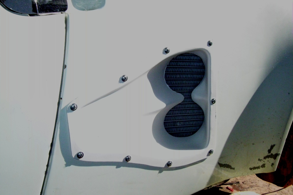

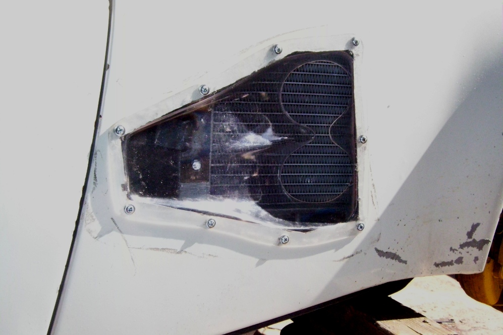

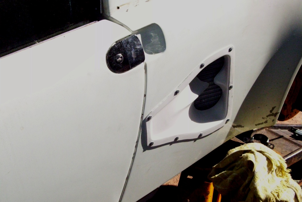

I installed the intercooler heat exchanger in the rear quarter panel. It is ducted with a NACA duct into the fender. It was hard deciding to cut the quarter panel but, it can be repaired if I don't like it. Im using the 914-6 oil tank knock outs to route the coolant hose to the intercooler. There will be a fan on the back side of the heat exchanger to pull ari through it. I have to fab an inner fender skirt to shield road debris. Im thinking of louvers to send the air down in the same direction of the tire rotation. This should create a slight draw of air when in motion. Here are some pics...

More...
They are lexan and semi flexible...

I forgot to mention it's mounted at an angle. The front is flush with the inner firewall. The rear is close to the fender to make tha air flow and room for the fan.
