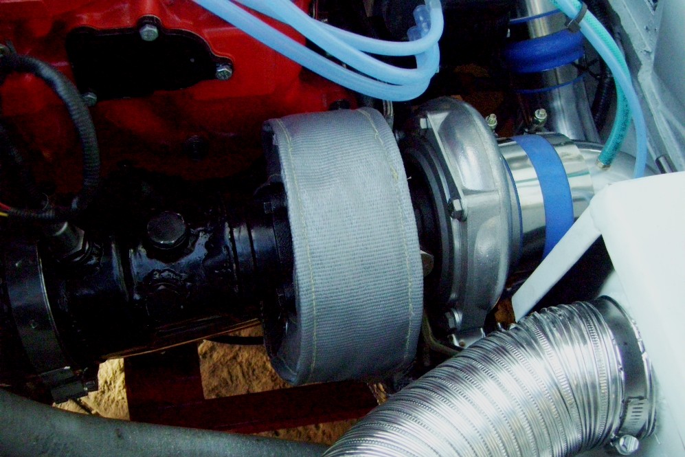

I put a blanket on my turbo to help mitigate engine bay temps. I ordered a heat sink for my O2 sensor as well. Should be here in a few days.

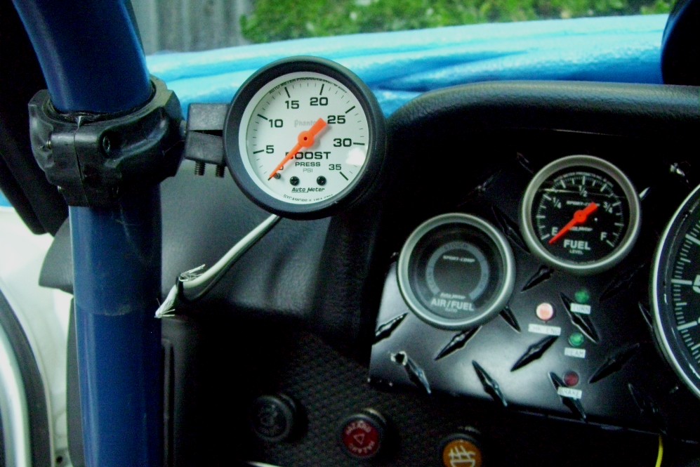

I also got a roll bar mount for my Boost gauge. I still need to feed the tube into the cabin and wire the lamp. I'm shooting for 15psi max. I did buy an 8psi spring for my wastegate just in case I want to drop the boost down.

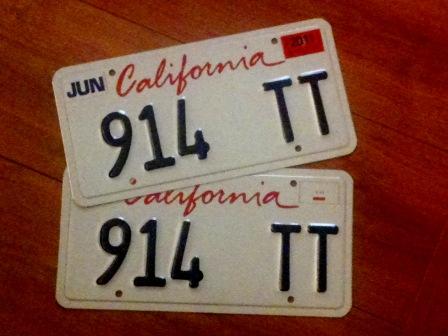

I found both my license plates (IMG:style_emoticons/default/piratenanner.gif) They fell behind my tool box in the garage. (IMG:style_emoticons/default/dry.gif)
