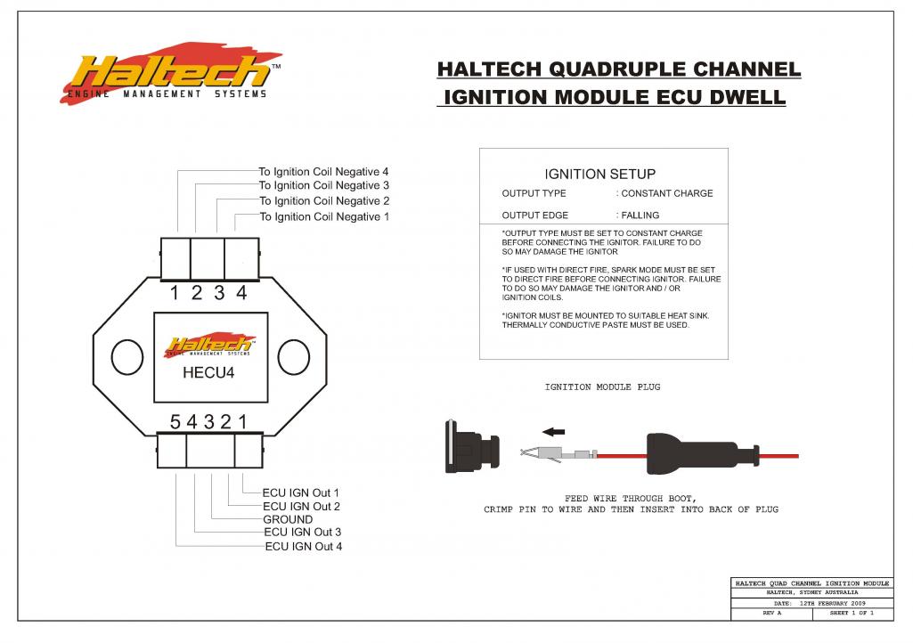

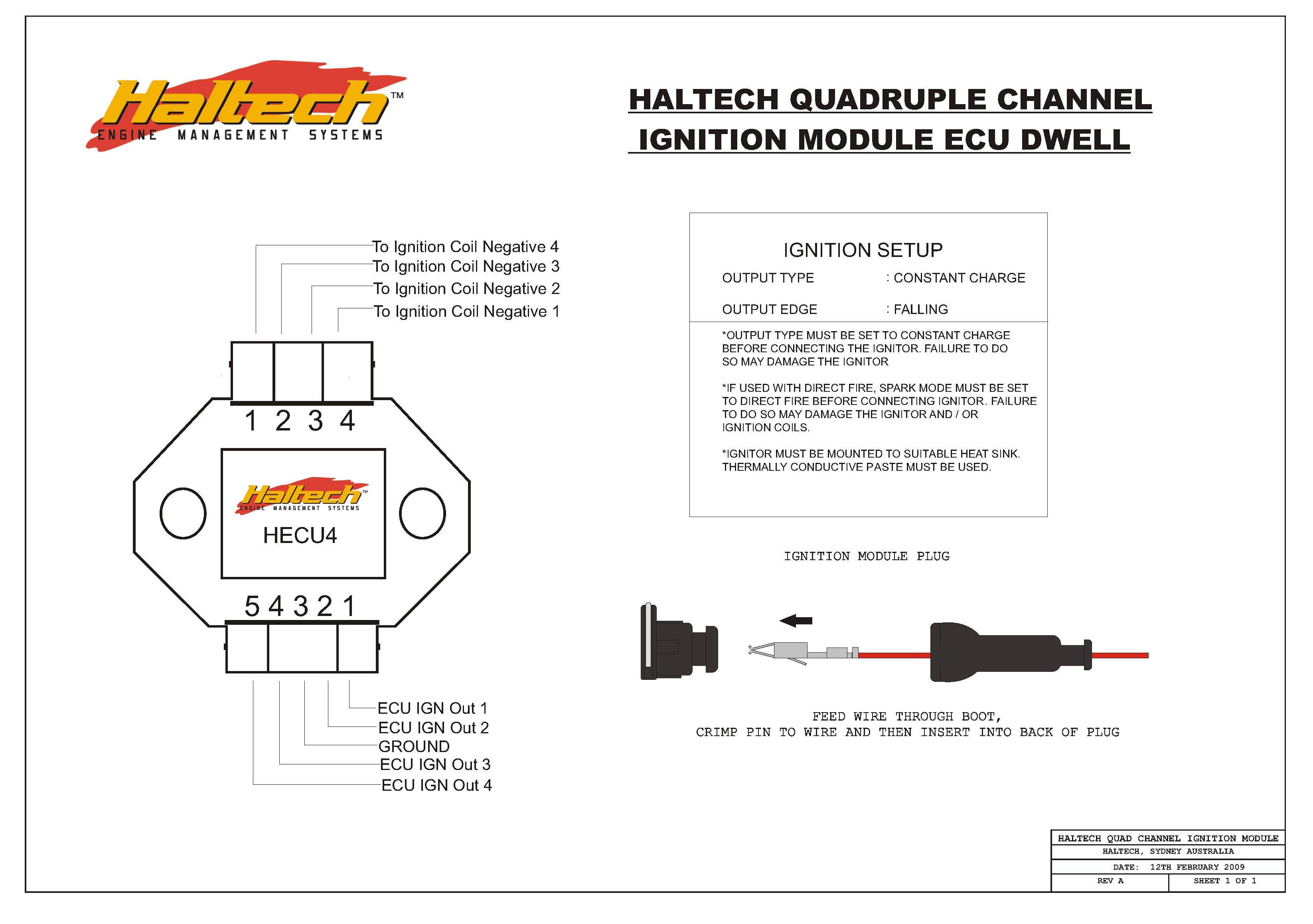

I found a cheaper solution. Haltech makes an Ignitor module. I'm looking at the quad channel ignitor. This will allow me to keep the wasted spark on the leading plugs but also gives me the option to go with 4 direct fire coils. The two lagging coils are already direct fire. The leading coil is a basic dual post type. The Haltech module is directly compatible with the ECU and I won't have to loose the real estate to mount 3 or 4 MSD boxes.

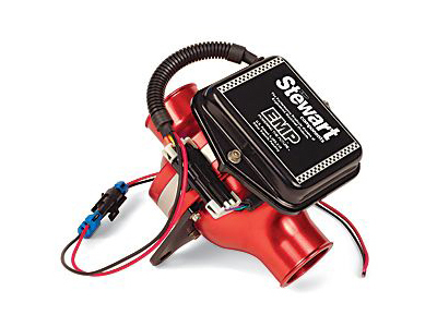

Here's a pic of the water pump I'm planning to add. Pricey at $400... (IMG:style_emoticons/default/sad.gif)

Have a look at the electric water pumps, direct replacement on series 4 onwards, weren't that expensive from memory, should be able to control it from the haltech, we have been running one on a 20b twin turbo drag car doing low 8s with no issues, I am looking to use one.
