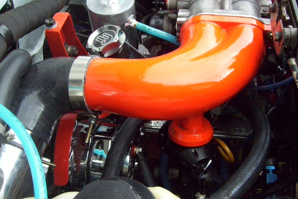

Took my wife out tuning tonight. All was going well until my BOV blew off. I guess the circlip was not seated all the way. I still have the clip but the O-ring is somewhere on the freeway (IMG:style_emoticons/default/sad.gif) I will see if my FLAPS has one close to the size tomorrow... Anyone have an extra HKS BOV O-ring?

Got an O ring from the auto parts store. Going to be tuning again soon. I have to take off the intake snorkel to get the BOV back on. It's mounted to the bottom. I an going to ease the edge of the clip a little to help it seat all the way.
I guess I'm lucky the vacuum hose held on tight...

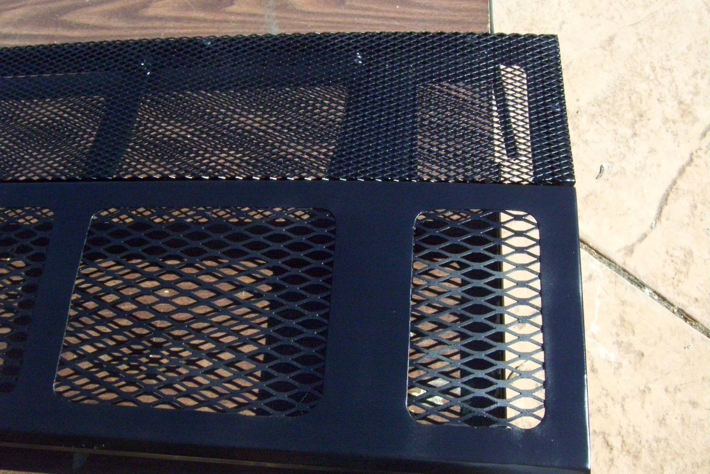

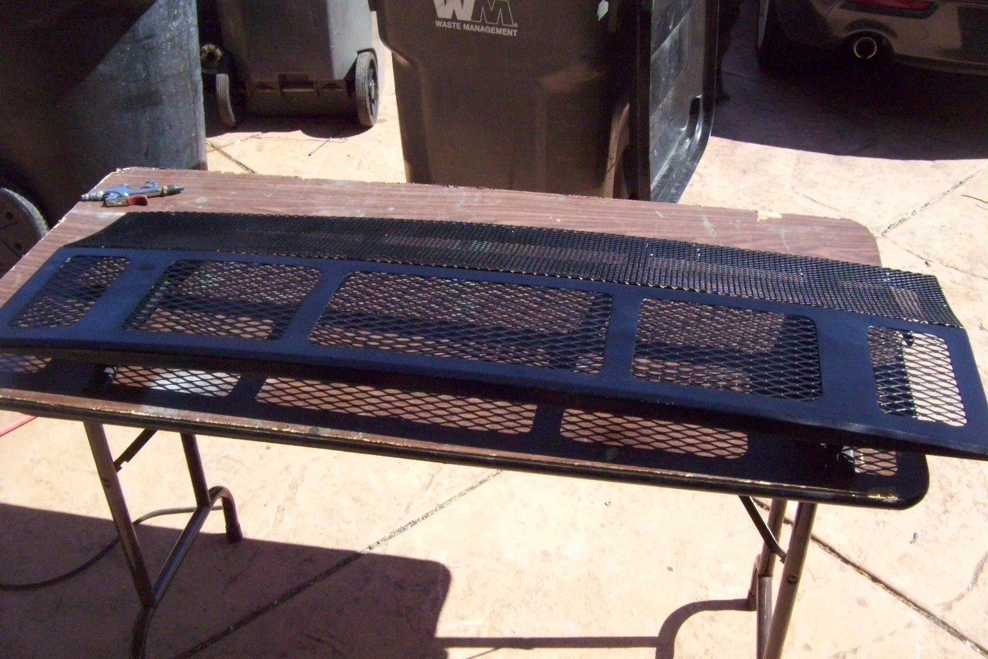

While I'm waiting for parts to show up I gat bored. I decided to make a GT style lid today. I had an extra lid sitting in the garage for a while. It's now painted semi gloss black. It's drying in the garage so pics will come later. I also picked up some Boxster quarters and vents. I may decide to swap the NACA ducts for Boxster Ducts.

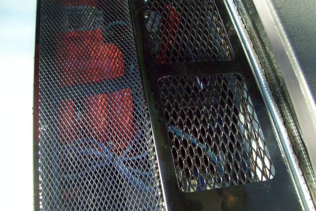

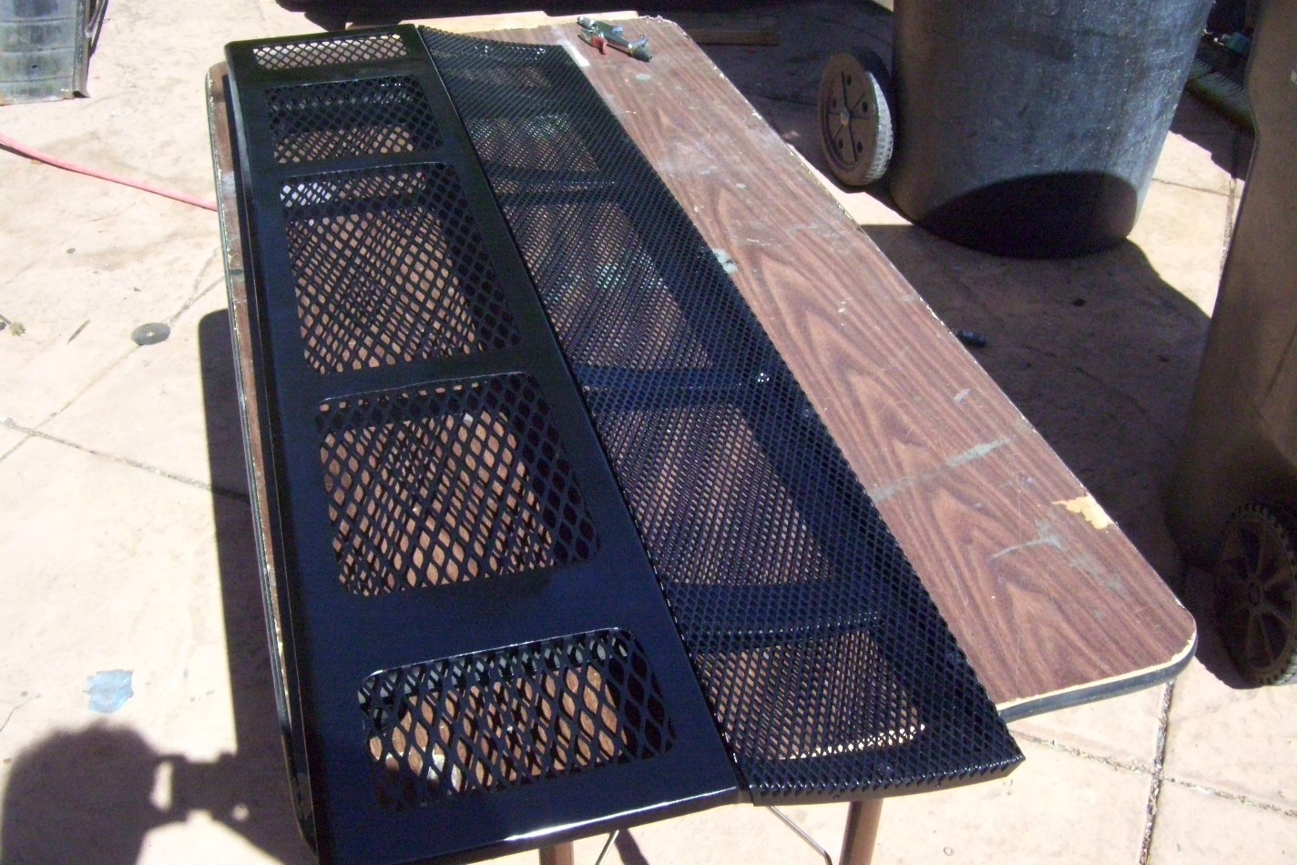

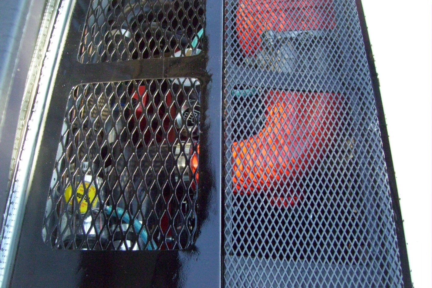

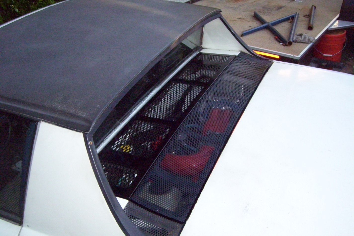

Here's pics of my interpretation of a GT lid. I cut windows in the top. I used a 1" punch to cut the corners. I then welded supports on the 2 center window supports. The window supports mimic the original supports under the stock grill. I also cut out the diagonal support. The diamond mesh is bigger than stock but I can live with it. If I decide to keep this style, I can use the mesh from my other lid. Or use this mesh and make a new on from my other lid. I also did not do too much paint prep. The whole car will get blasted next year for paint anyway. I reduced warping while welding with freeze spray. Worked great until I ran out. I used getto freeze spray. Can of compressed air held upside down.

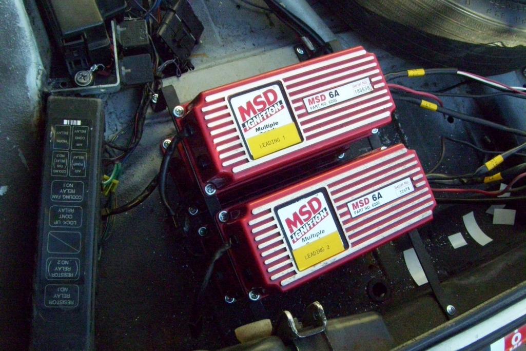

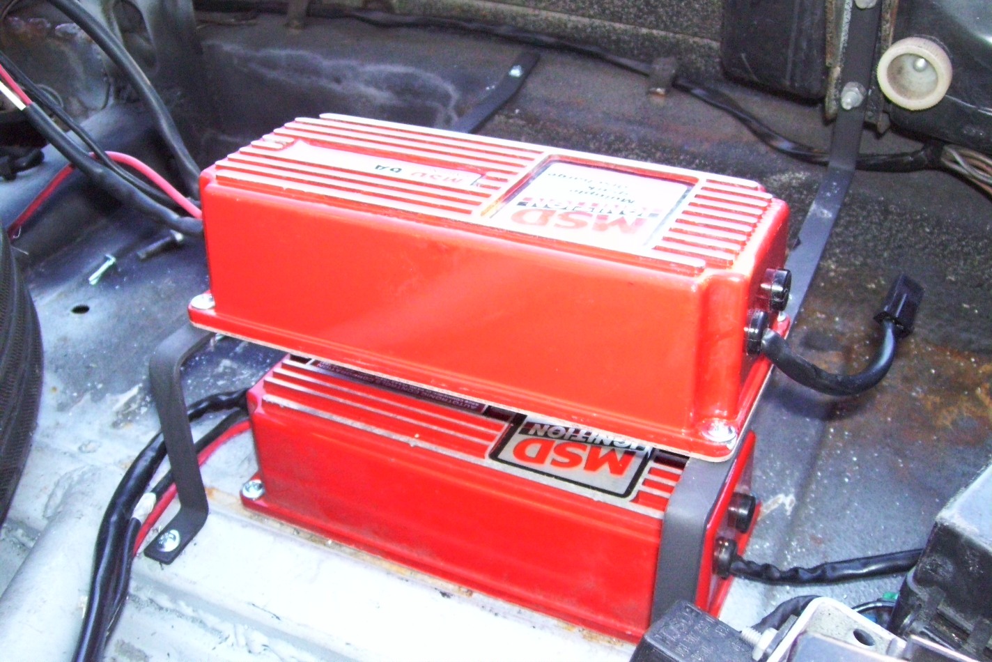

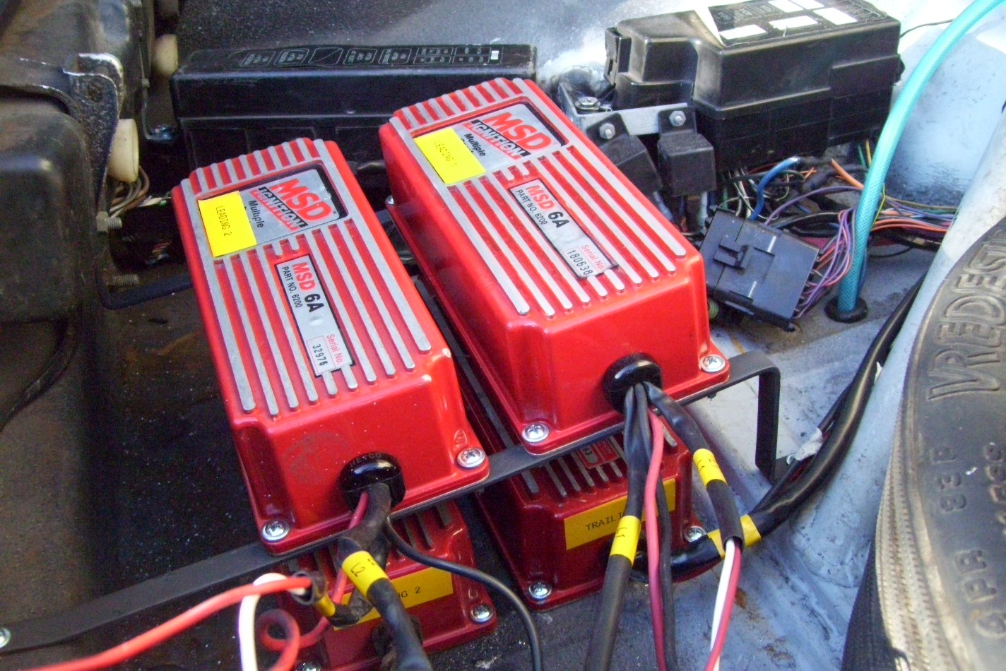

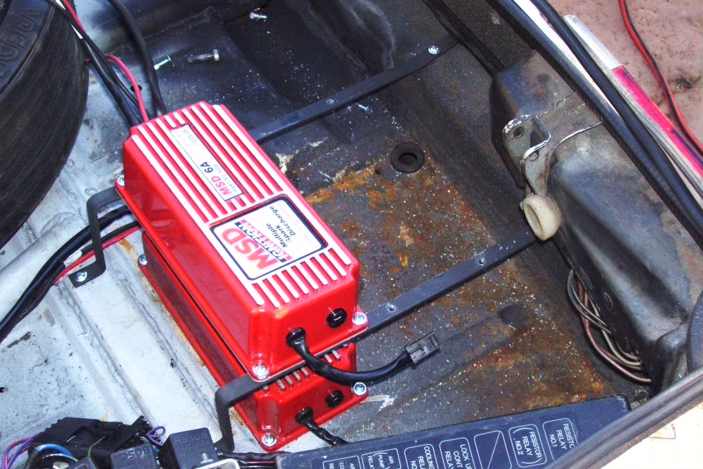

Here is the first of 4 MSD boxes. There will be 2 mounted side by side and 2 above. I have designed a simple bracket to float two on top of two. This way I can maximize the real estate. The targa top will still clear everything. The 4 coils will go in the engine bay on the rear firewall, drivers side. It is very crouded in my engine compartment now. Big difference from just the short block mocked up.

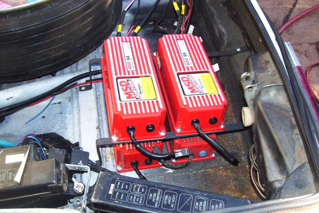

2 of 4 MSD boxes in place. The bracket is a simple 1/2"x1/8" bar stock. I used the two taillight housing nut to secure one side. The other corners with self tapping screws...
Waiting for more parts to show up... (IMG:style_emoticons/default/sad.gif)

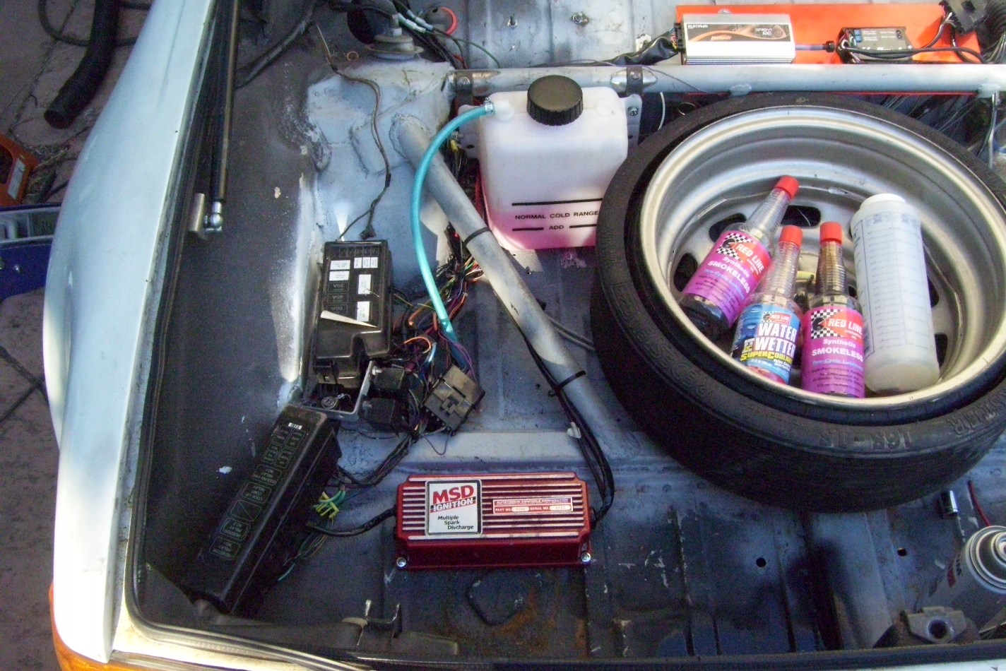

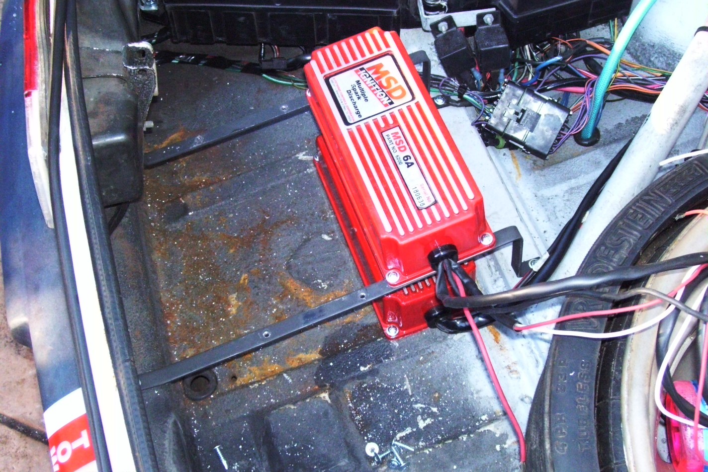

All 4 MSD boxes installed. I used a label machine to bust out tags for the boxes and cables. Leading 1 & 2 and Trailing 1 & 2. Now to get it wired and connected to the 4 coils (whenever they show up). I hope this fixes the plug fouling and bad spark problem (IMG:style_emoticons/default/biggrin.gif)

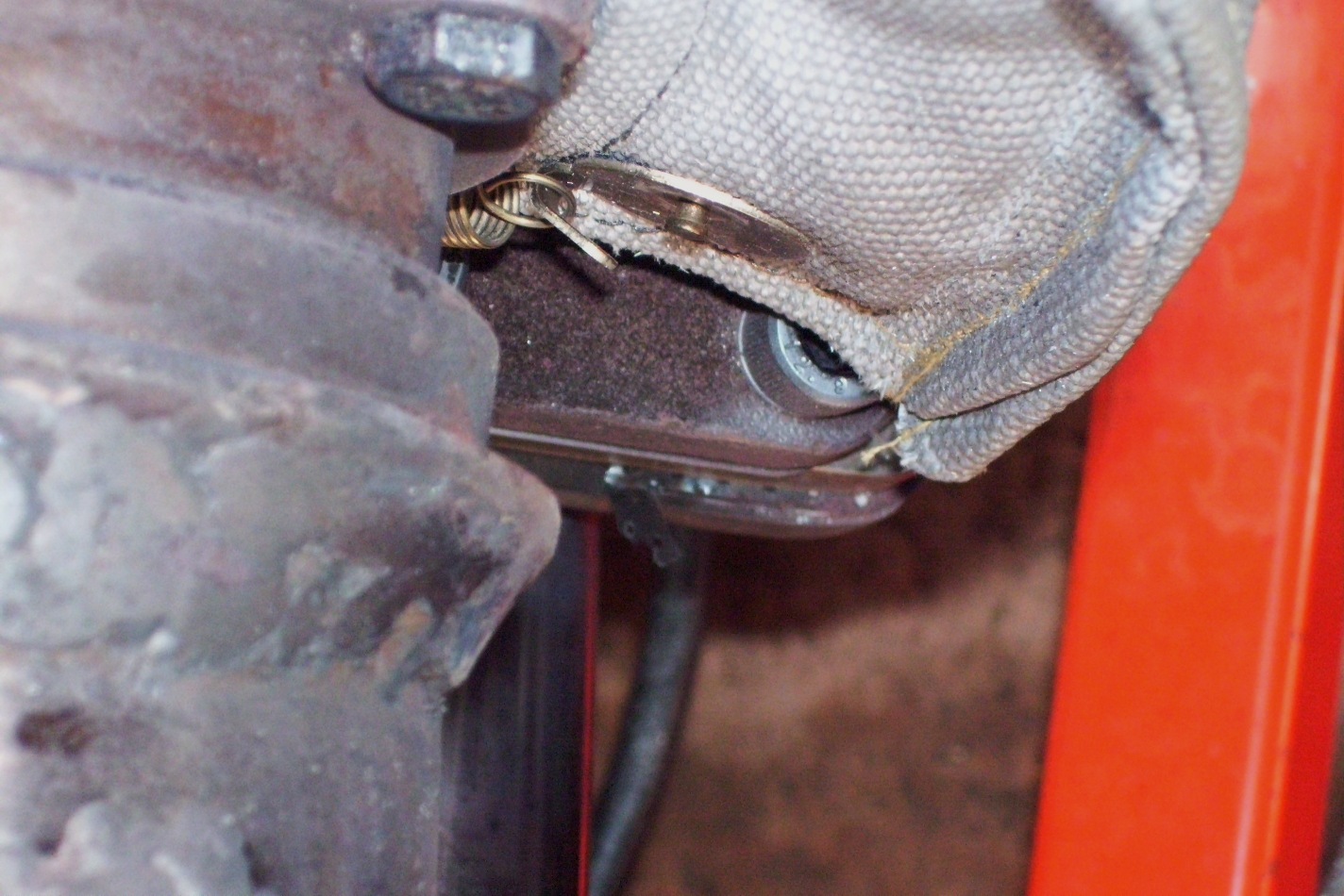

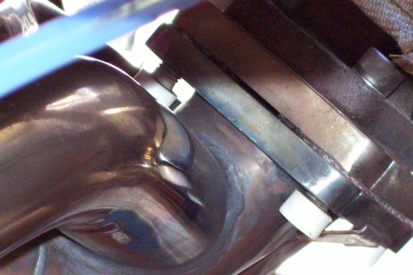

I blew out my turbo flange gasket today. Problably due to my flange bolts coming loose (IMG:style_emoticons/default/dry.gif) It was a sandwhich type gasket POS. I ordered a new stainless steel gasket to replace. Tuning this setup is a PITA! I know I will bite the bullet and pay for tuning at some point. The only tuners that specialize in both Haltech and Rotarys are all down in SoCal. 7-8 hours away by trailer (IMG:style_emoticons/default/sad.gif) Plus $125 per hour. The fee is not to bad but it will take me $400 is gas just to tow it there and back. It does run well enough to tool it around as long as I stay out of the boost. When the boost comes on, the secondary injectors come in and it falls on its face. Going way lean.
I'm going to play with fuel maps more and see if I can get it worked out. Either way I plan to have it to the breakfast next saturday.

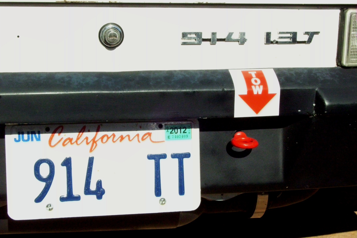

Here is my badge (Thanks Jim). It looks cool except for the speckles of tranny oil from my drip.

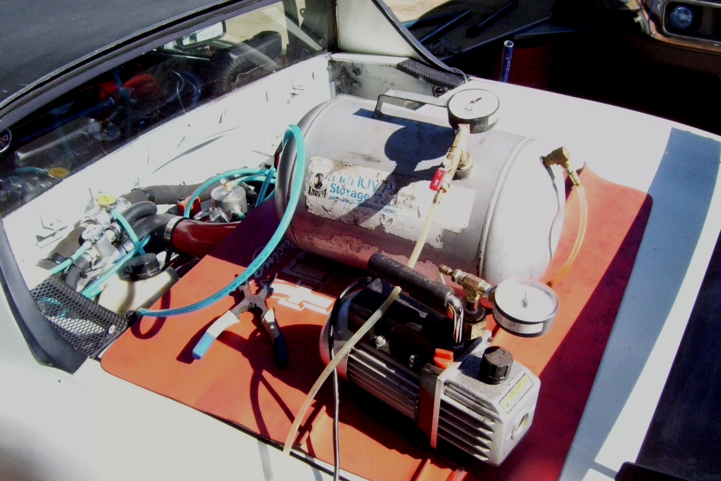

I use this setup to suck all the air out of my cooling system. Vacuum pump pulls on the storage tank. Storage tank pulls on the closed cooling system. This forces all the air out. I then pinch off the line, remove it from vacuum and put the hose in a tank of water. Then release the clamp and the cooling system sucks water back in. I leave the vacuum sucking for about an hour at a time. I do this every time I run it for a couple of weeks, or more often on a whim. It's kind of anal but my V8 ran between 160-180F. This motor in known for running hot. When you overheat a rotary it's rebuild time (IMG:style_emoticons/default/sad.gif)

Thats a killer air removal setup!!
