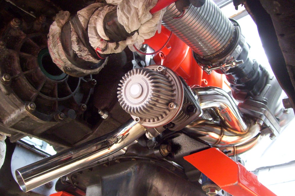

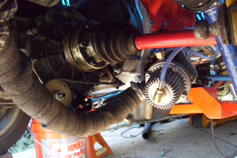

I tracked down my overboost problem to the Wastegate. It does not open, or not enough. I instaled a 6psi spring and it still will not open. I'm going to take it all apart to see what is going on.
