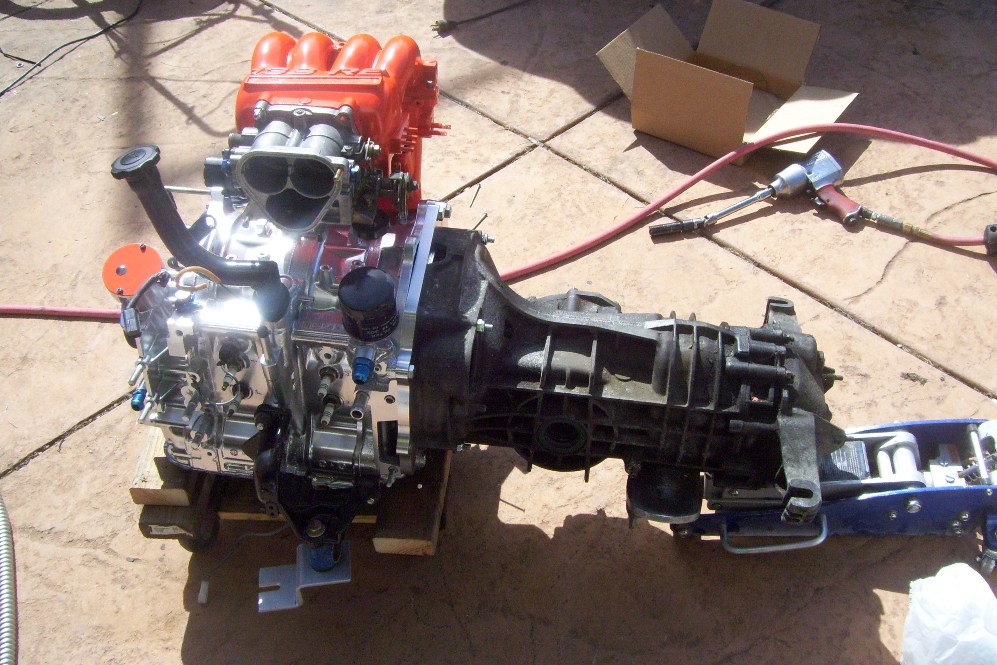

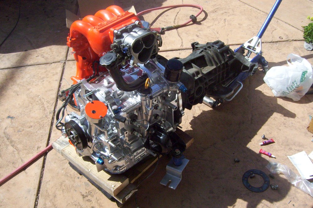

My adapter showed up. Now i can finish the fab of the motor mounts. I bolted my core tranny to it for fitting purpose.

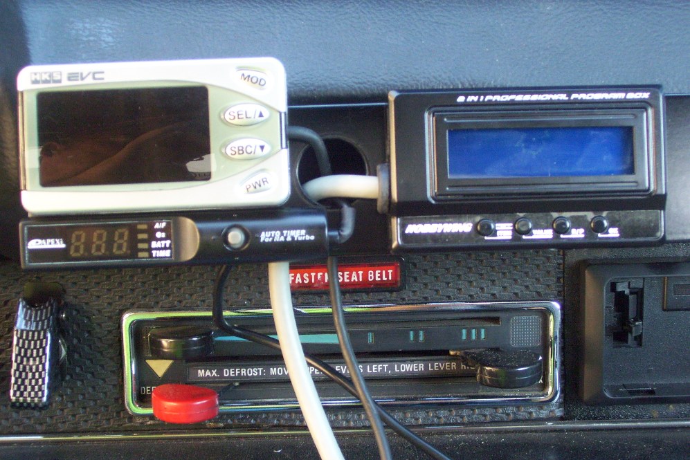

I did some work inside. I welded a bracket that bolts to the existing ash tray mounting screw holes. Mounted are my HKS Boost controller, Apexi Turbo Timer and my oil injection pump controller. I left some extra space to the right for my Navigation maybe.

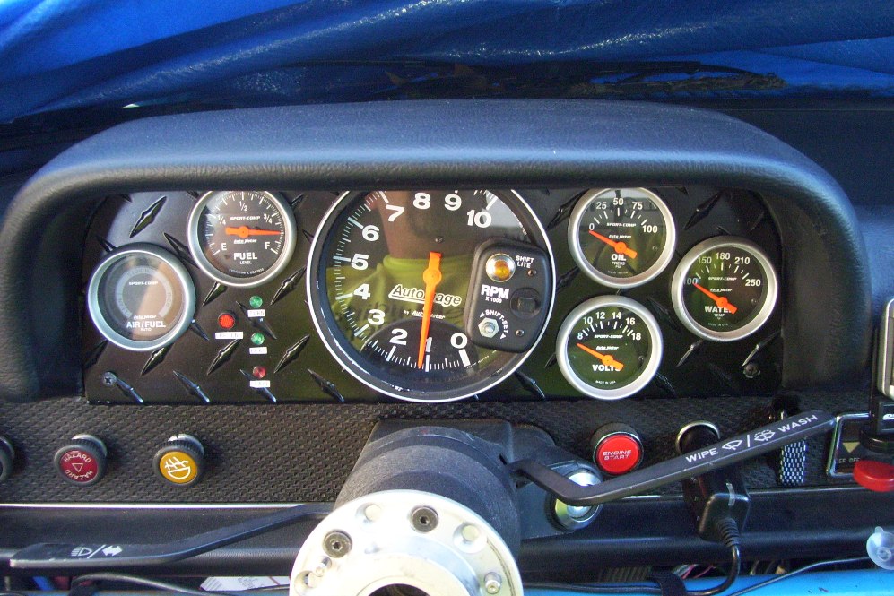

Now I have to figure out where I am putting my boost gauge. Either I redo the dash or find a cool pod for the dash.

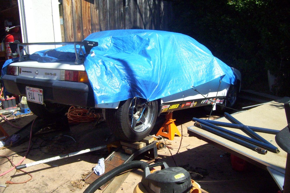

Now for the sad part. My car is outside! I was parting out the car in the garage when my clutch went out and... well... things snow balled into an engine swap...

Mike it looks like your making great progress! PS, you have more visible guages than I could imagine actually using! Count one vote for navigation. I always put a spot for those in my cars, really makes for a much more enjoyable experience when you dont have to worry about that.

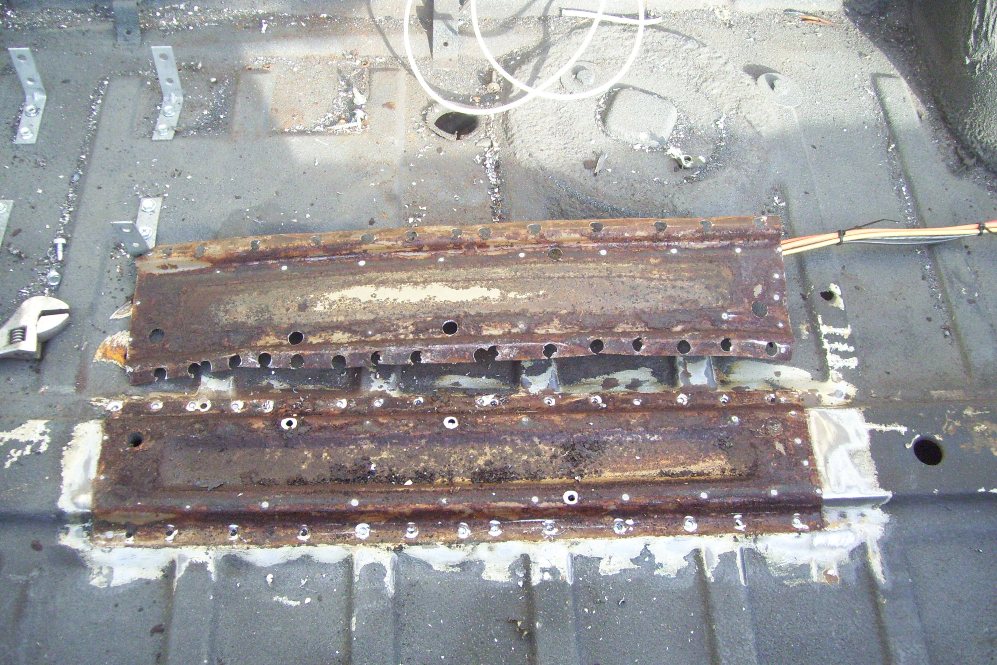

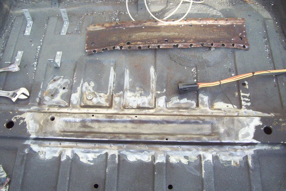

I forgot to mention. I found some major California rust on my car. I fixed it with a wire wheel and some zinc primer. I am building a trailer hitch and tying it into the roll cage. Pics of the receiver tube coming this weekend...

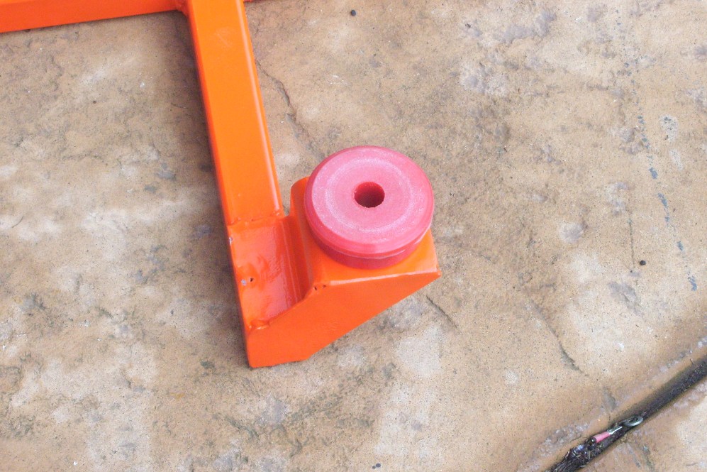

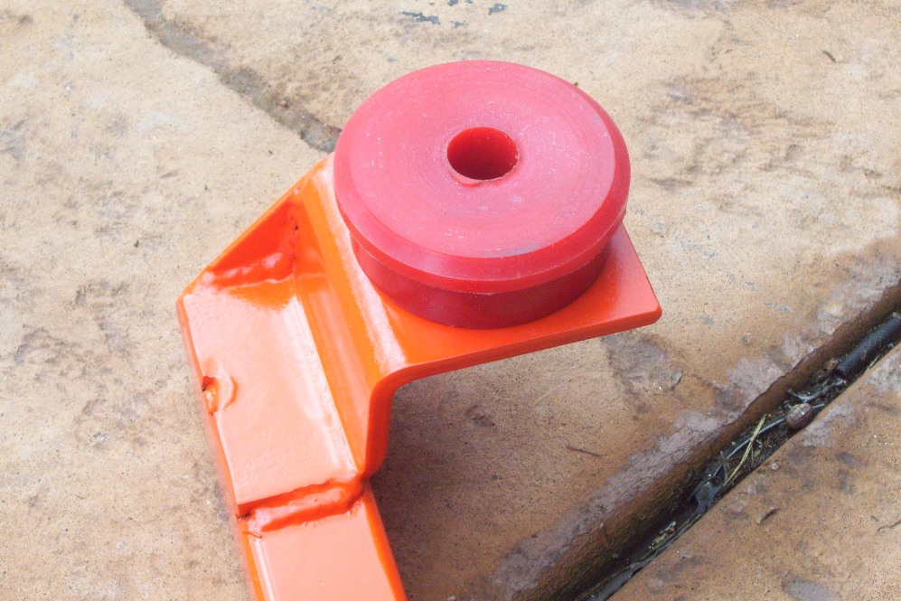

I finally got my engine mount finished and installed. The welding was complete two weeks ago. Paint last week and install today. I built it with 1.25" square tube 0.120 wall and some 1/4" steel plate. Then covered it with VHT orange/red. The bushings are high durometer poly from an old project.

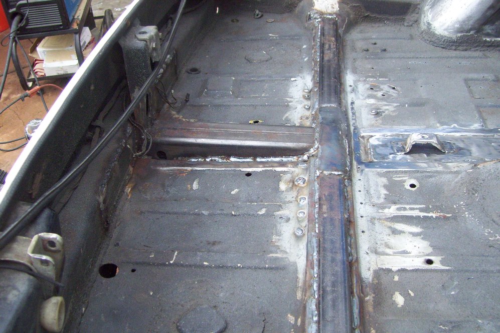

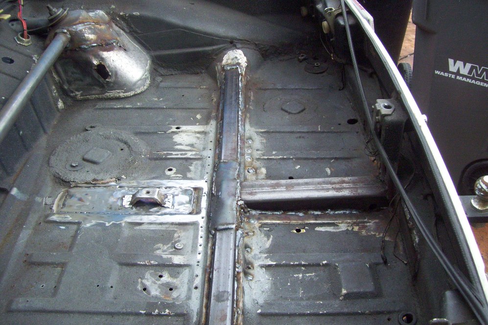

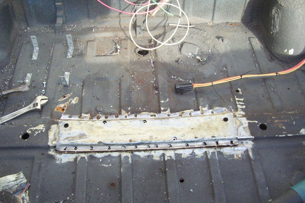

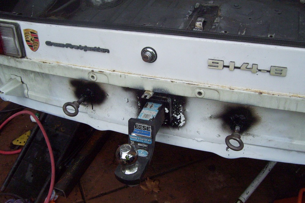

I have also been working on my trailer hitch. I took inspiration from Majkos and the car-b-que. I welded in the receiver tube. The transmission brace now has some 1.25, 0.120 wall square tubing to re-enforce the brace. Some 1/8 plate ties the two together. I drilled some holes in the bottom of the trans brace to weld some plugs on the underside. I also welded some 1/8 plate to the rear bulkhead. I welded the receiver to this and added some screw in eye bolts to tow from. The whold thing is beefy and solid. It all hides under my spring loaded license plate holder. I welded some 14ga to the center of the trunk to hold my spare tire bracket too. most of this work was done two weeks ago. Now I need to turn to the right tower damage. I suspect this happened during the cars racing career. The steel is super thin under the damage. I will cut a patch panel from the car in the garage.

More...
