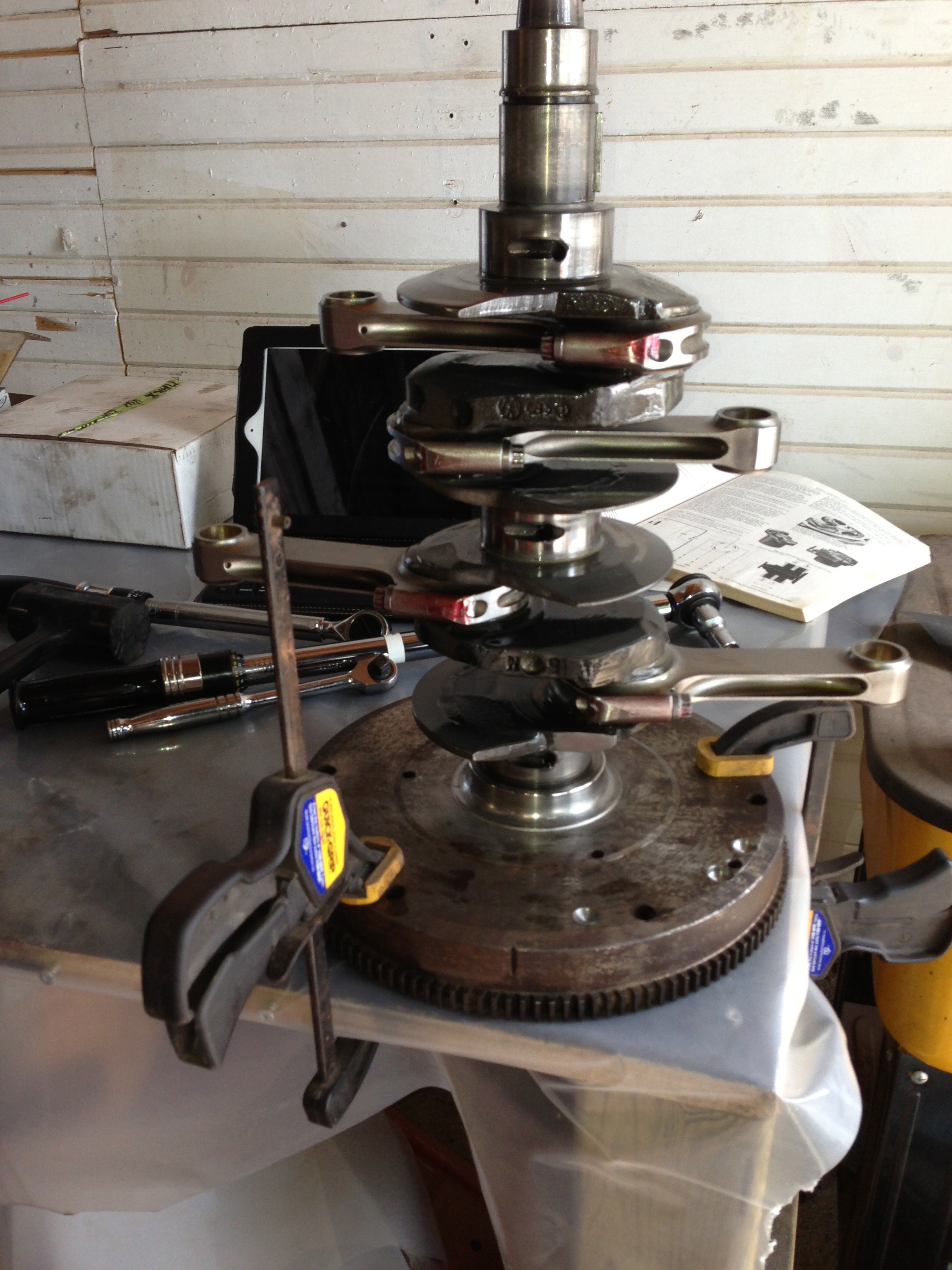

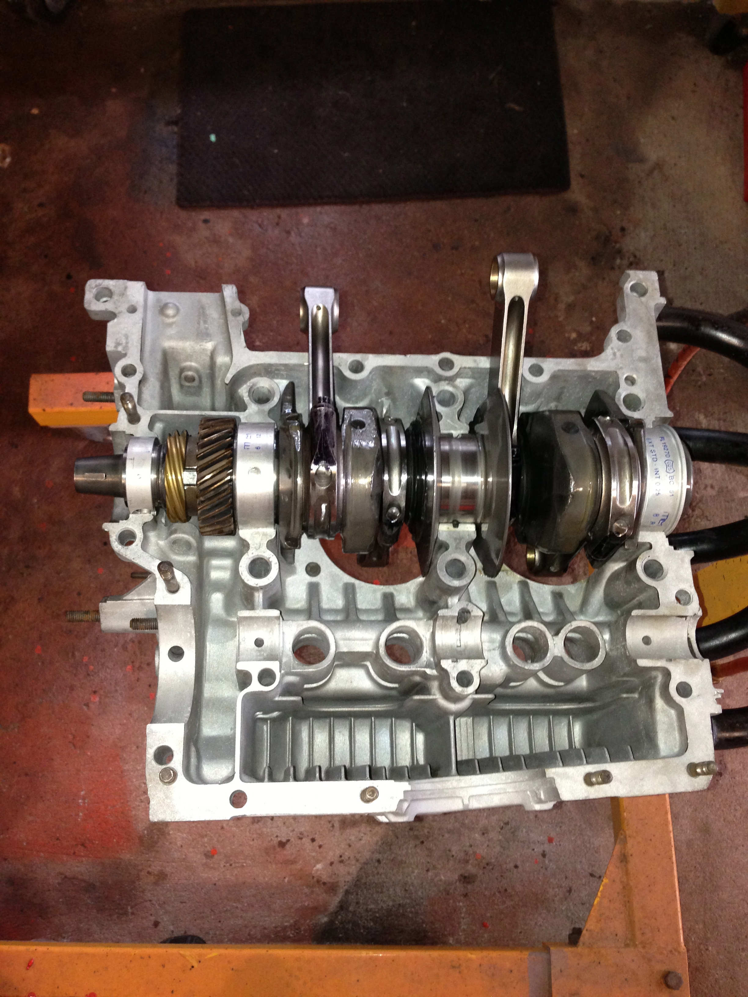

Got my engine internals back from balancing ( Thanks Mark Henry !! )
I have a 80mm nitrided crank and rods from Mark Henry ( I believe they are originally from Jake )
Bolted the flywheel on to use as a base while building up the crank shaft.
cleaned the crank and all oil galleys.. and then cleaned up the rods/bearings and put them on... all oiled up and torqued to 24 ft-lbs.
Mark Henry
post Jul 2 2013, 05:11 PM
Post #162
that's what I do!
Posts: 20,065
Joined: 27-December 02
From: Port Hope, Ontario
Member No.: 26
How come you have the rods on the main journals??? (IMG:style_emoticons/default/WTF.gif)
Just messing with you (IMG:style_emoticons/default/biggrin.gif)
Looking good (IMG:style_emoticons/default/first.gif)

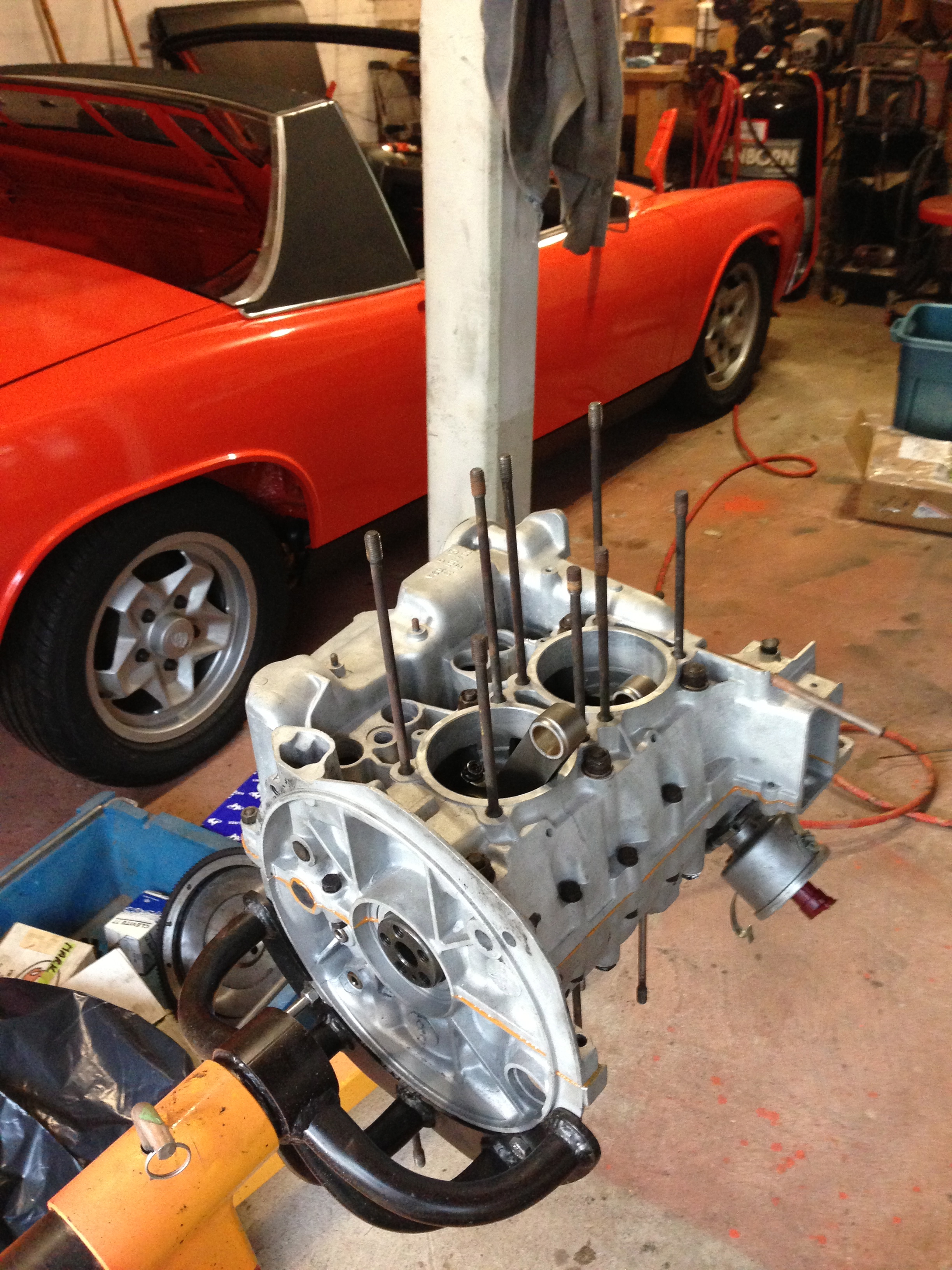

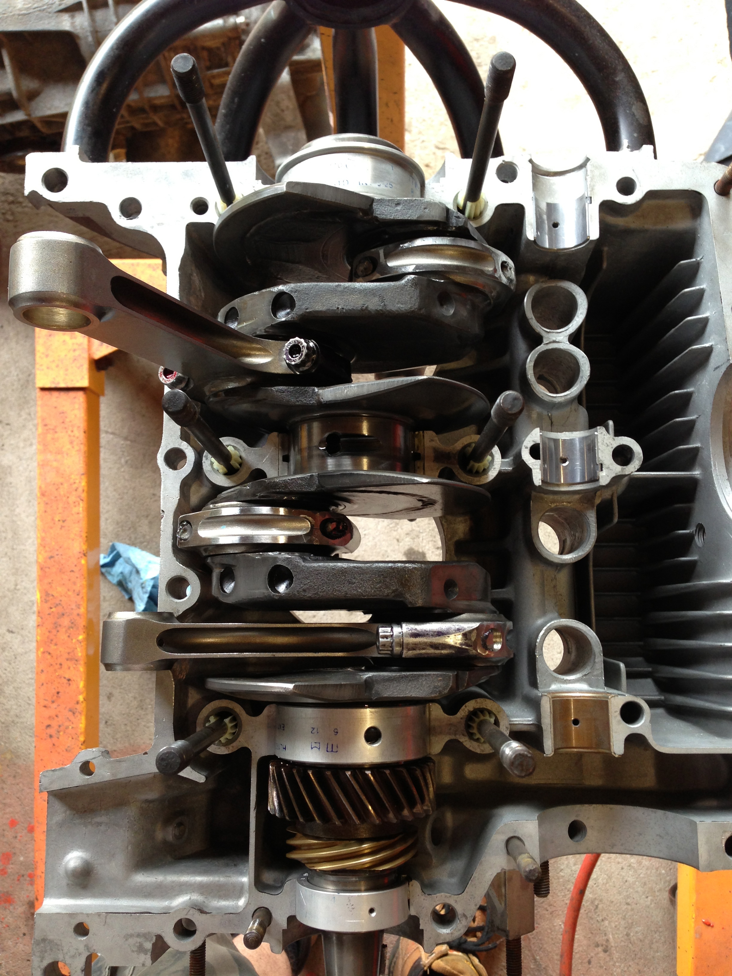

Another few hours on the engine today... put all the studs back into the engine case halfs. Got the crank gears onto the crankshaft and put the crank into the case.. spins nice a free...

wndsrfr
post Jul 4 2013, 09:23 AM
Post #165
Posts: 1,461
Joined: 30-April 09
From: Rescue, Virginia
Member No.: 10,318
QUOTE(MrHyde @ Jul 3 2013, 01:10 PM) *
Hard to see how much clearancing was done on the case webs......be sure to check it with both halves snugged up .....slide a long feeler gauge into each as you rotate and hold the rods vertical....btdt.
MrHyde
post Jul 4 2013, 10:29 AM
Post #166
Posts: 525
Joined: 13-October 10
From: Ontario, Canada
Member No.: 12,268
Already did some grinding on the engine case a while ago.. but when I put the cylinders on today for mock up I'll check out my work and see if i need to grind more

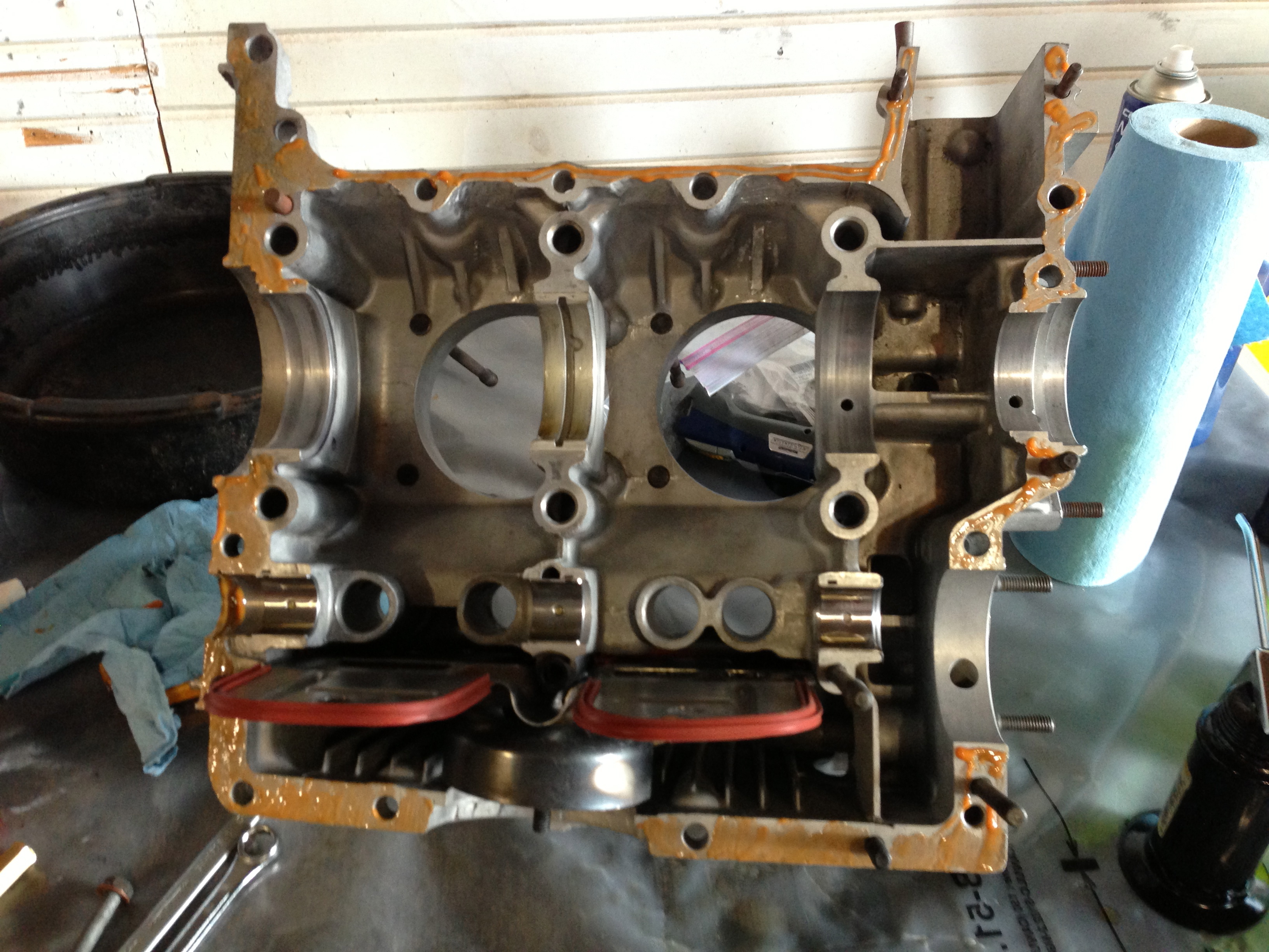

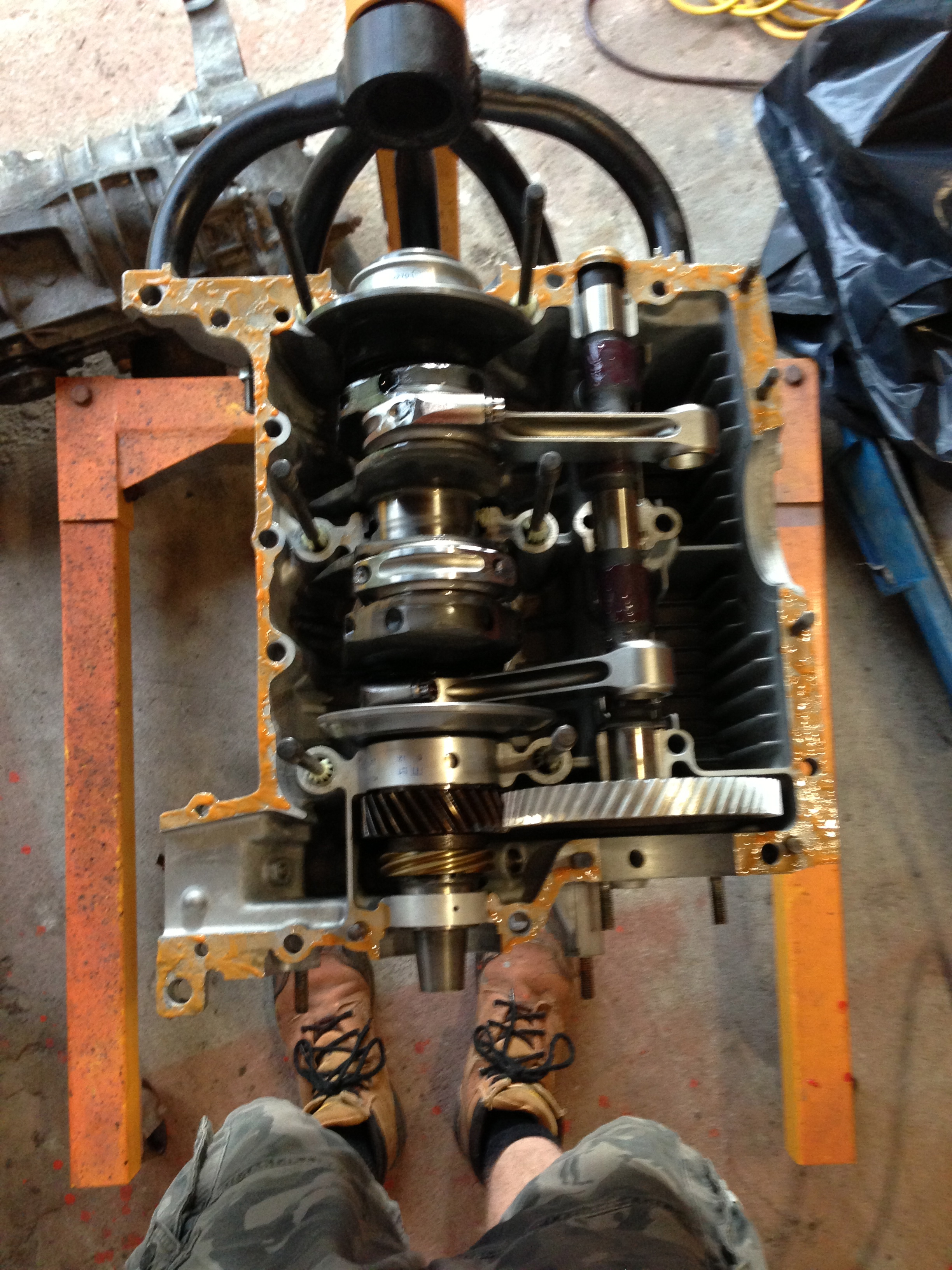

Wow... finally feels like a productive day...
One more time into the case after a thorough pressure wash, air blast, brake cleaner, air blast, etc.
MrHyde
post Jul 28 2013, 05:42 PM
Post #169
Posts: 525
Member No.: 12,268

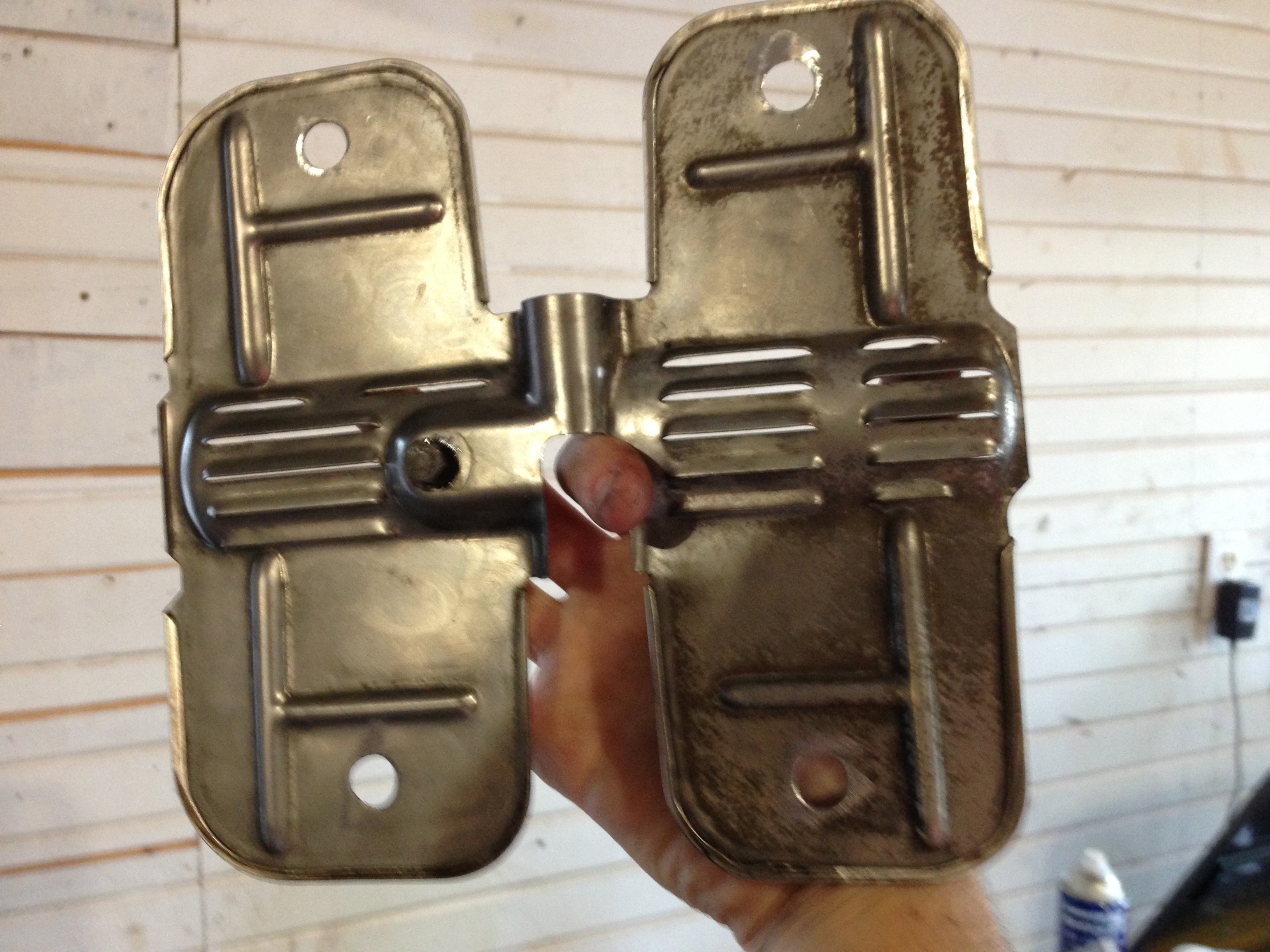

Minor mod to the windage tray and starting to clean it up..
When I took the motor apart, i bagged everything just as it came off the motor. 40 yrs of oil and all..

One side of the case all ready to go.
MrHyde
post Jul 28 2013, 05:44 PM
Post #171
Posts: 525
Member No.: 12,268
Other side ready.

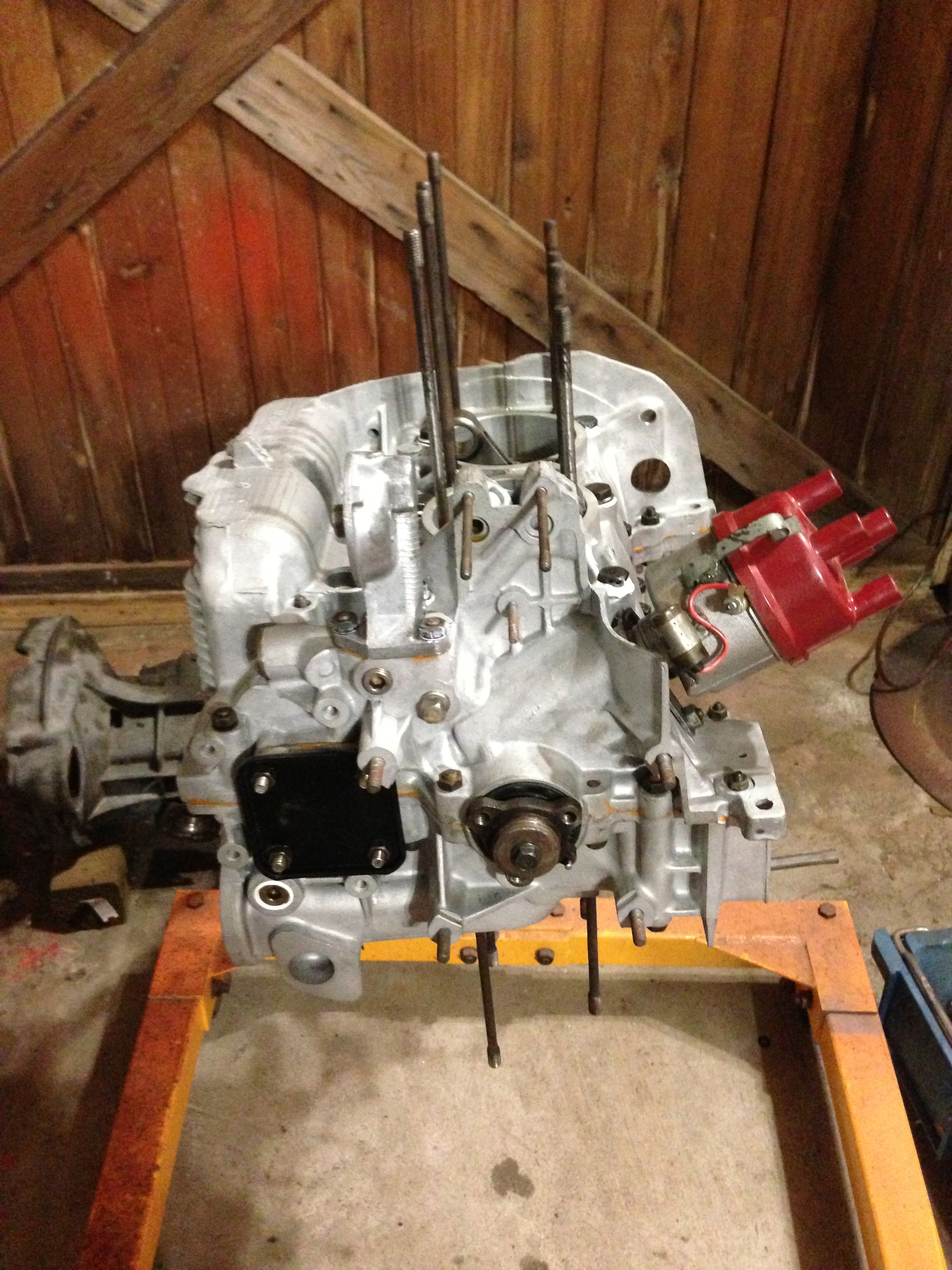

Had a bit of time tonight so I put some more stuff on the front of the engine.

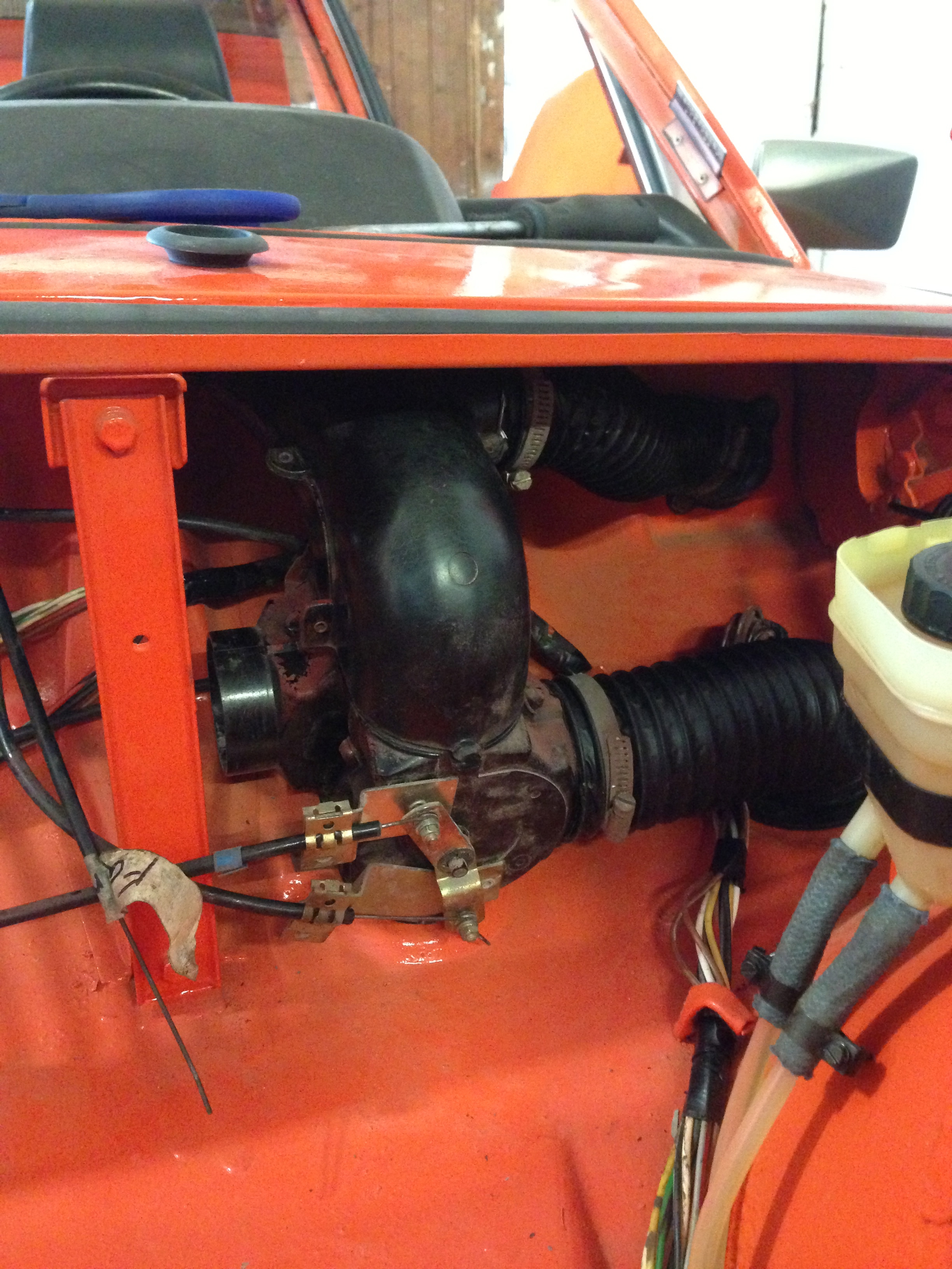

been tinkering away since I've been waiting for my cylinder shims to come in.. Got the headlight buckets all hooked up and the motors wired in. also got the ventilation diverters and controls put in. They're mostly there so whenever I get the heater box for my tangerine exhaust I'l have the rest of the components hooked up. Also got the wiper motor installed. Didnt take pics of the headlights or the wiper motor...

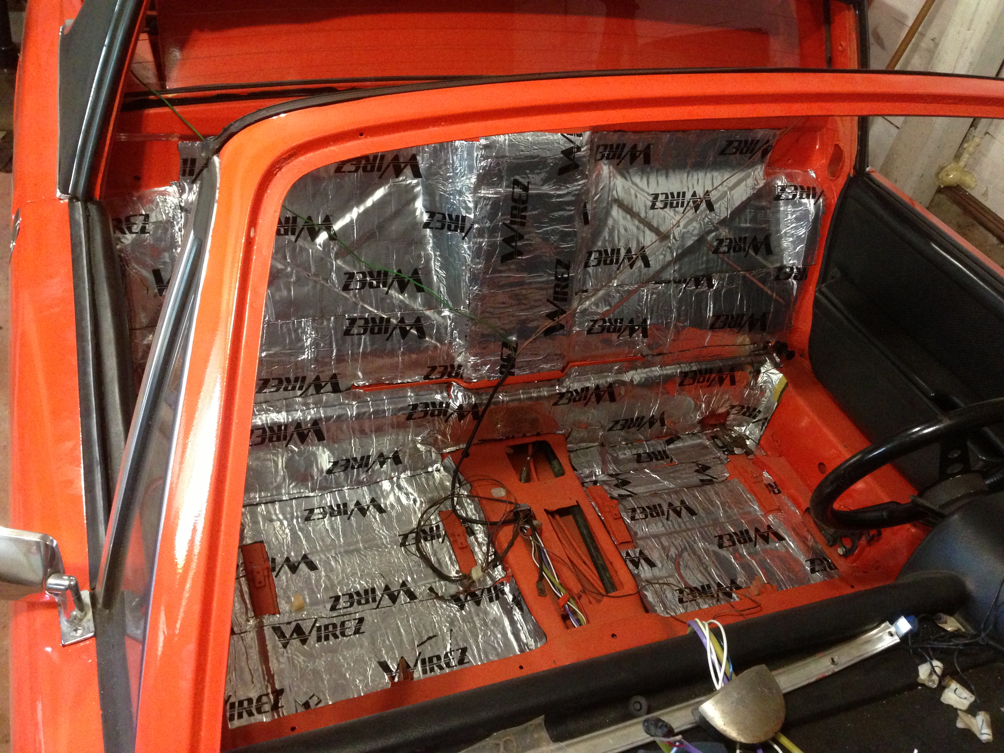

put some sound deadening in the car

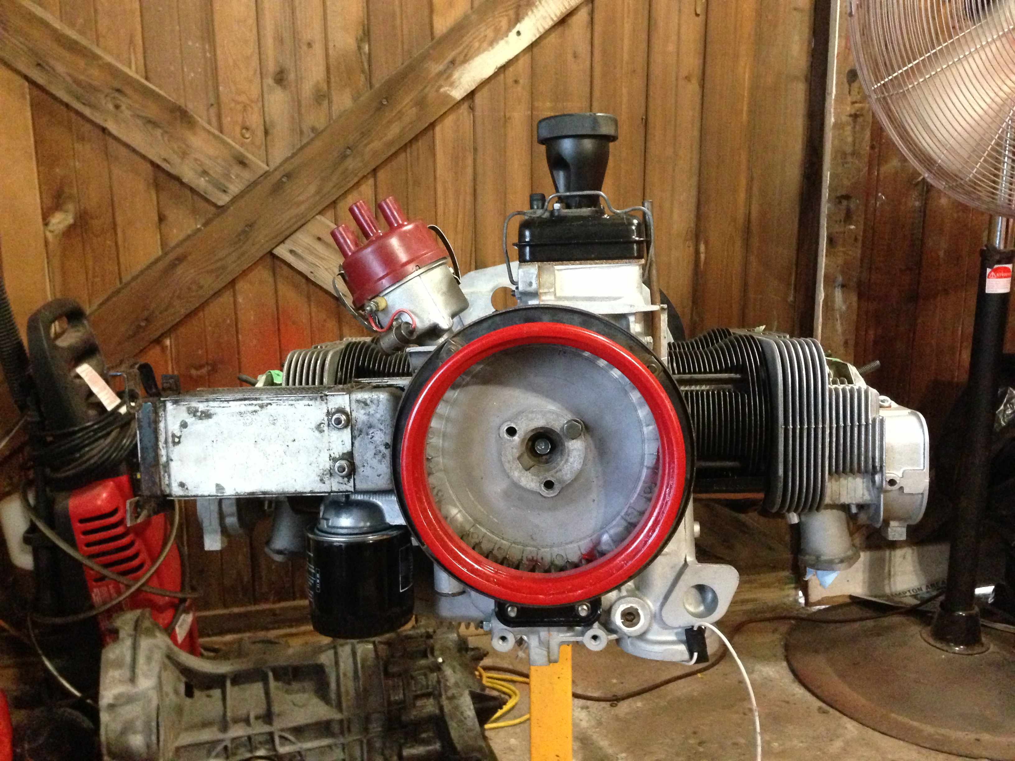

engine is coming along
