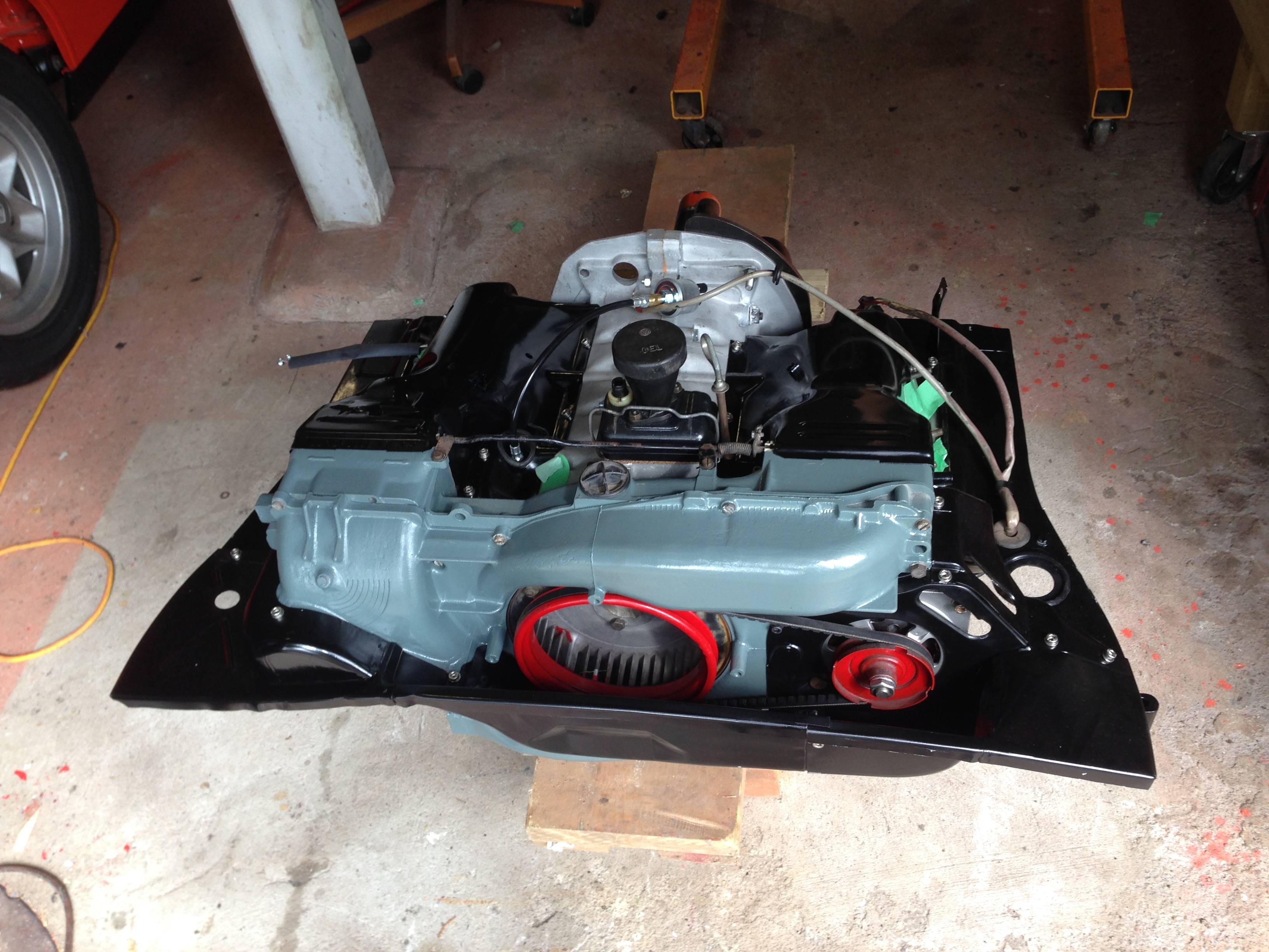

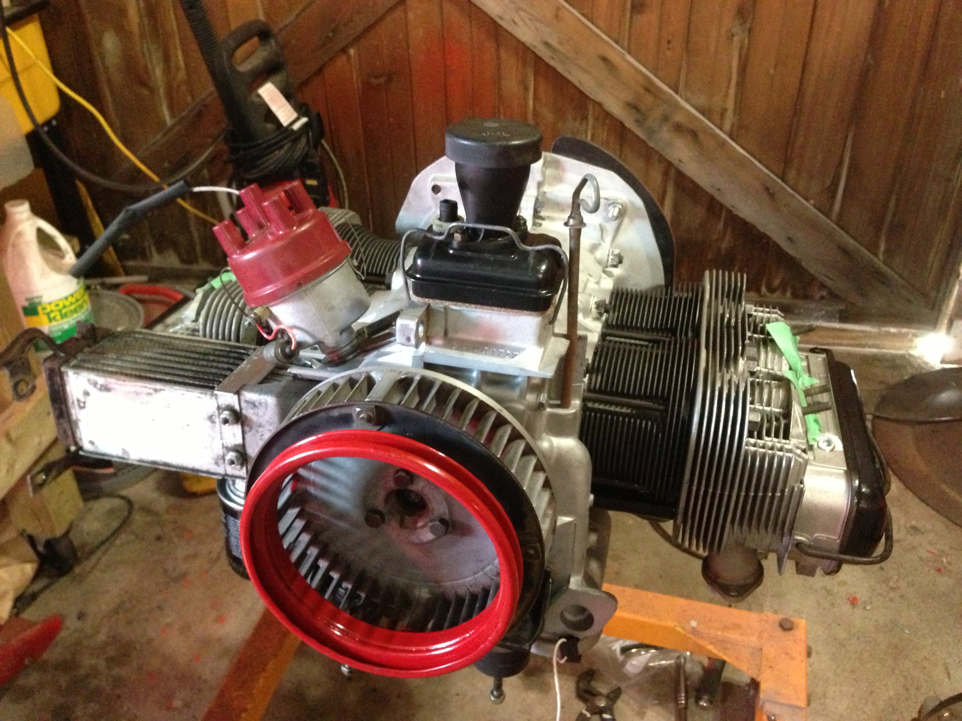

Engine down and off the stand today.

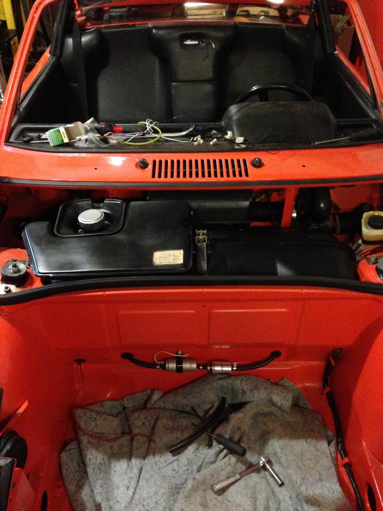

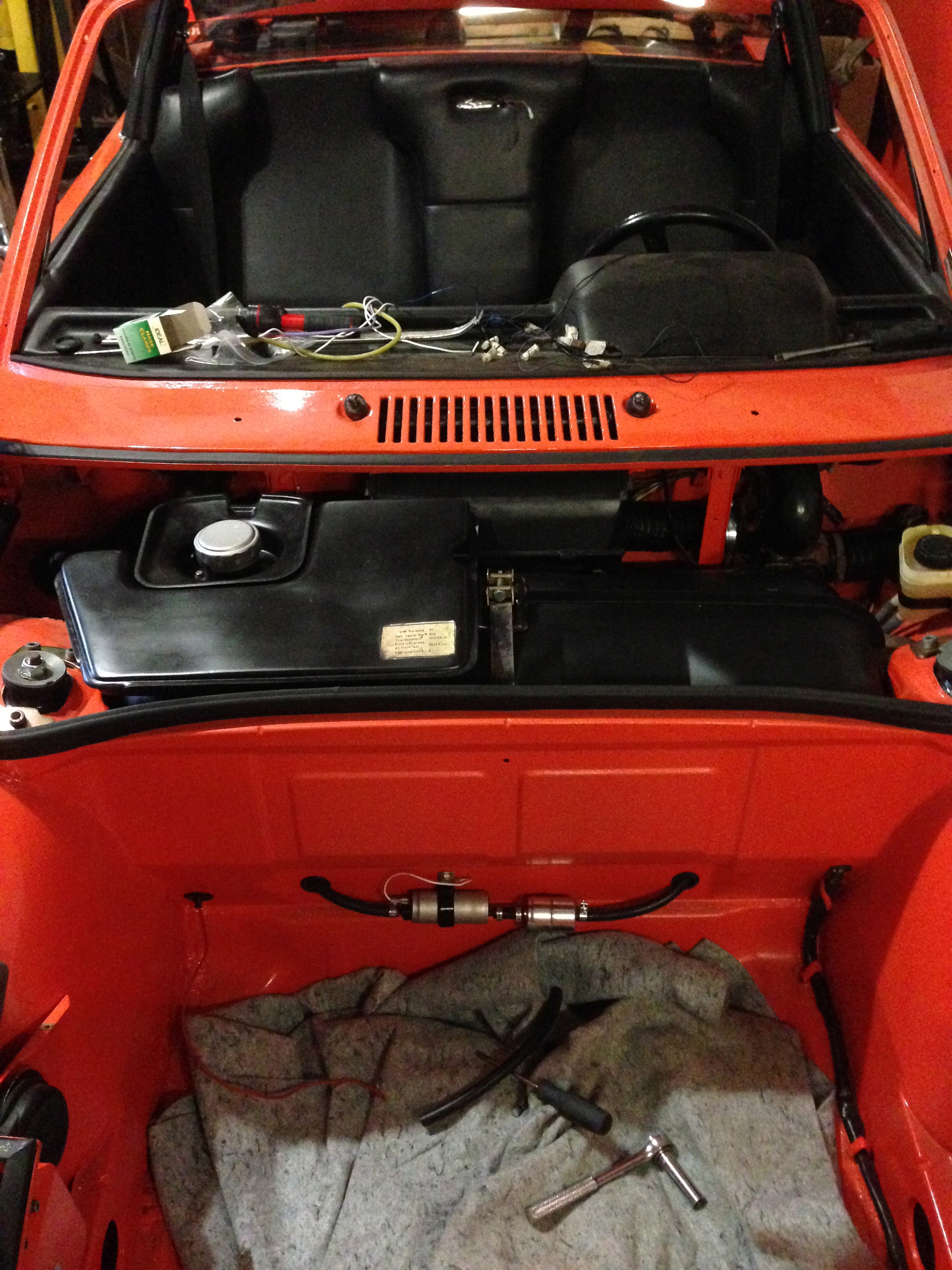

Got the Stainless Fuel lines and pump from Tangerine racing put in and cleaned up/painted the gas tank. its all in now. I ran a power line from the engine bay all the way up to the new front mounted pump. I'll hook it up to the original pump power line and do the relay jumper that Sir Andy wrote about. This way the fuel pump "should" act as normal.
MrHyde
post Sep 22 2013, 05:28 PM
Post #185
Posts: 525
Joined: 13-October 10
From: Ontario, Canada
Member No.: 12,268
Oh ... and the back pad it just sitting there for now. I have to take it back out so that I can put the carpets down and finish the gauge wiring.. I am waiting for a couple parts to come up from the US and a couple parts I got to pick up from Peteyd and then I hope I'll be able to stuff the motor into the car next weekend..

I hope your engine runs as good as it looks! Will you get it dyno'd after you get it running?
Very clean install on the front pump.

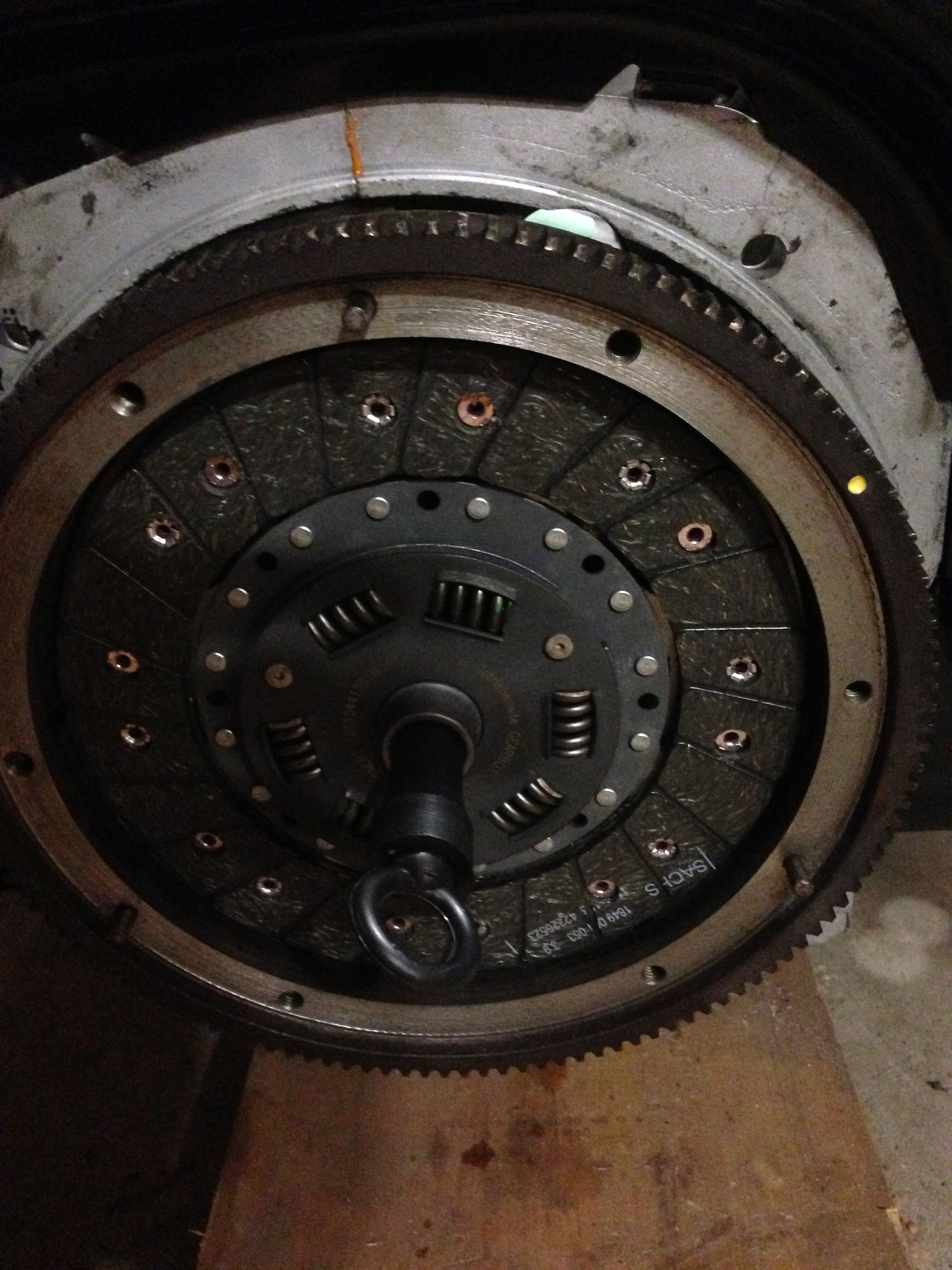

clutch going in

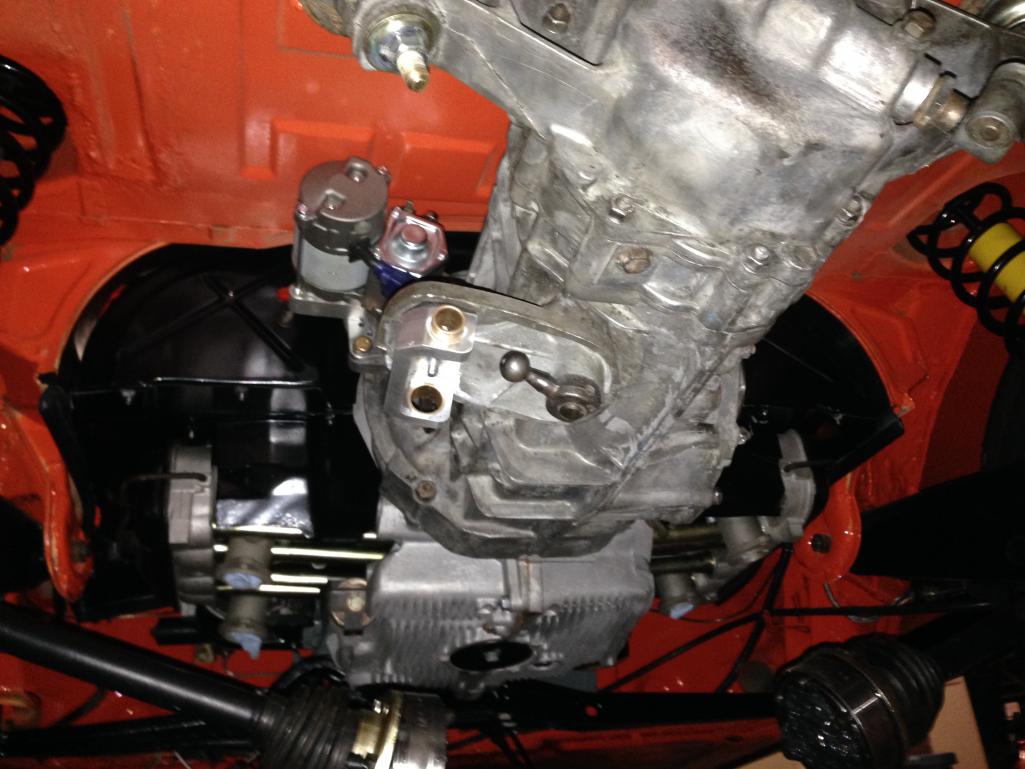

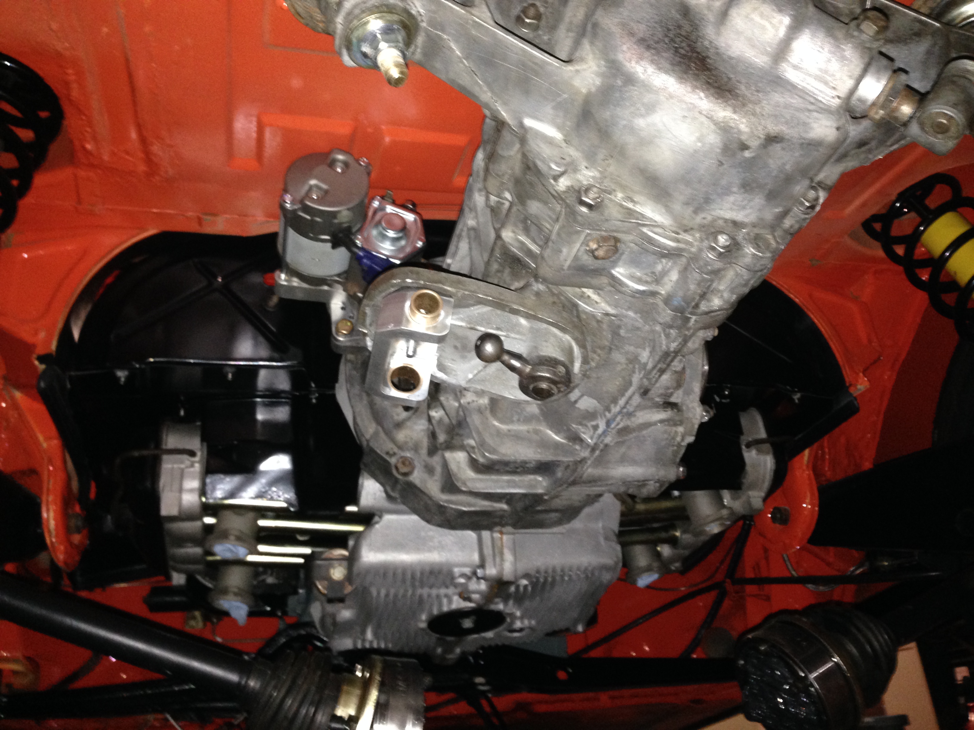

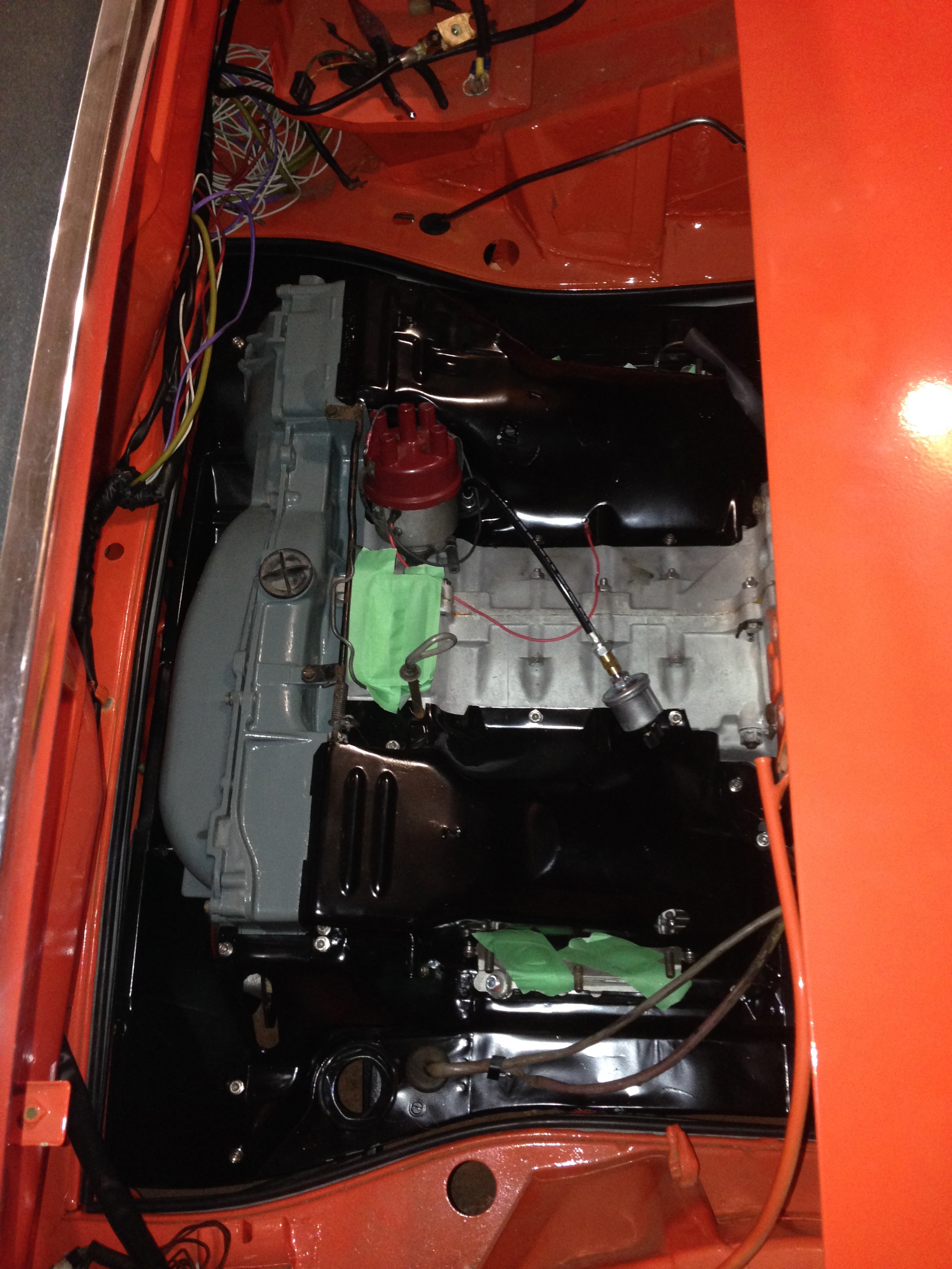

Motor is now bolted in !

under

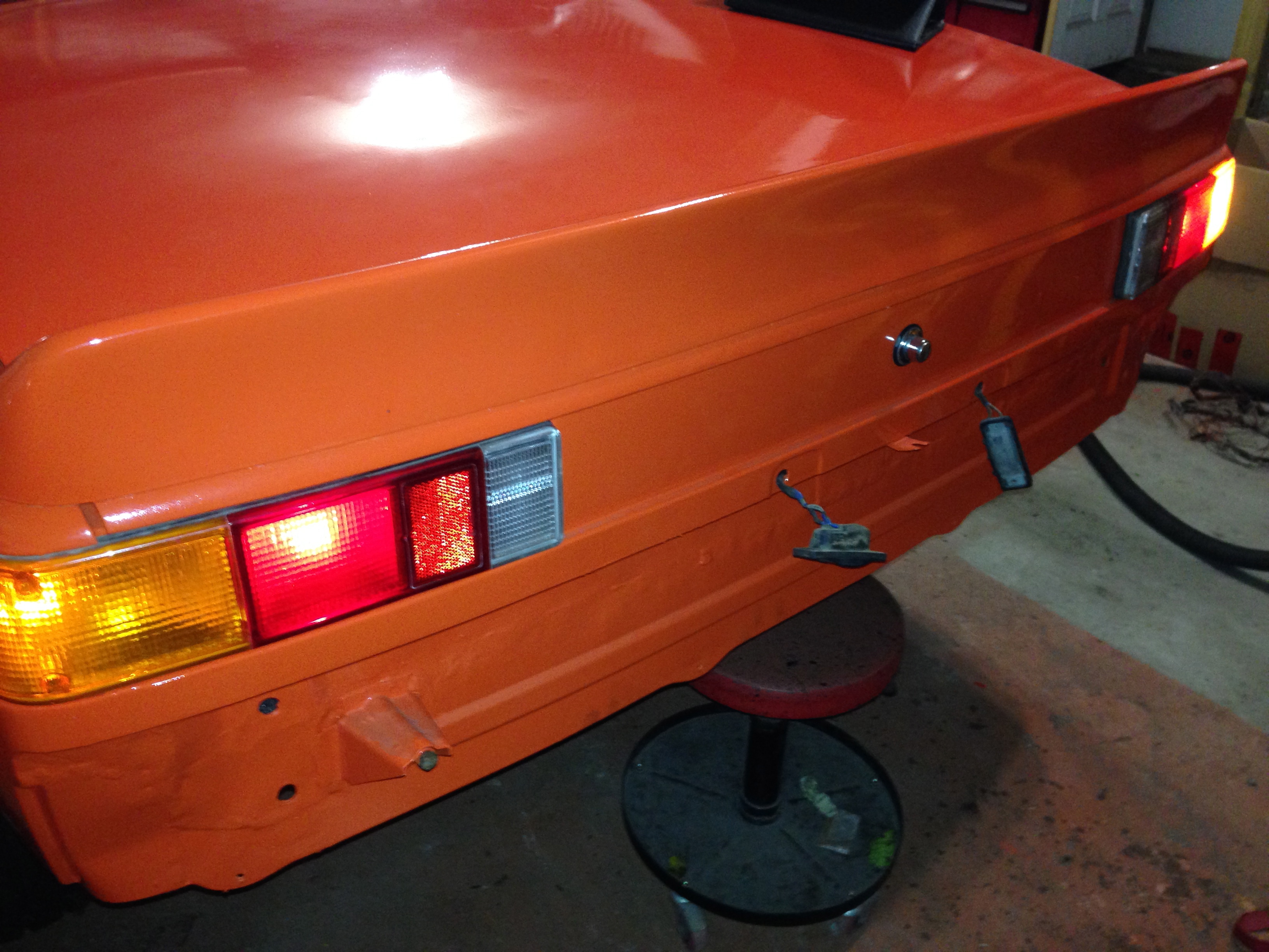

I have 2 Gremlins so far that have poped up.
1 license plate lights and trunk light have no power going to them.
2 Dome light only works on the "door" setting when the key is on.

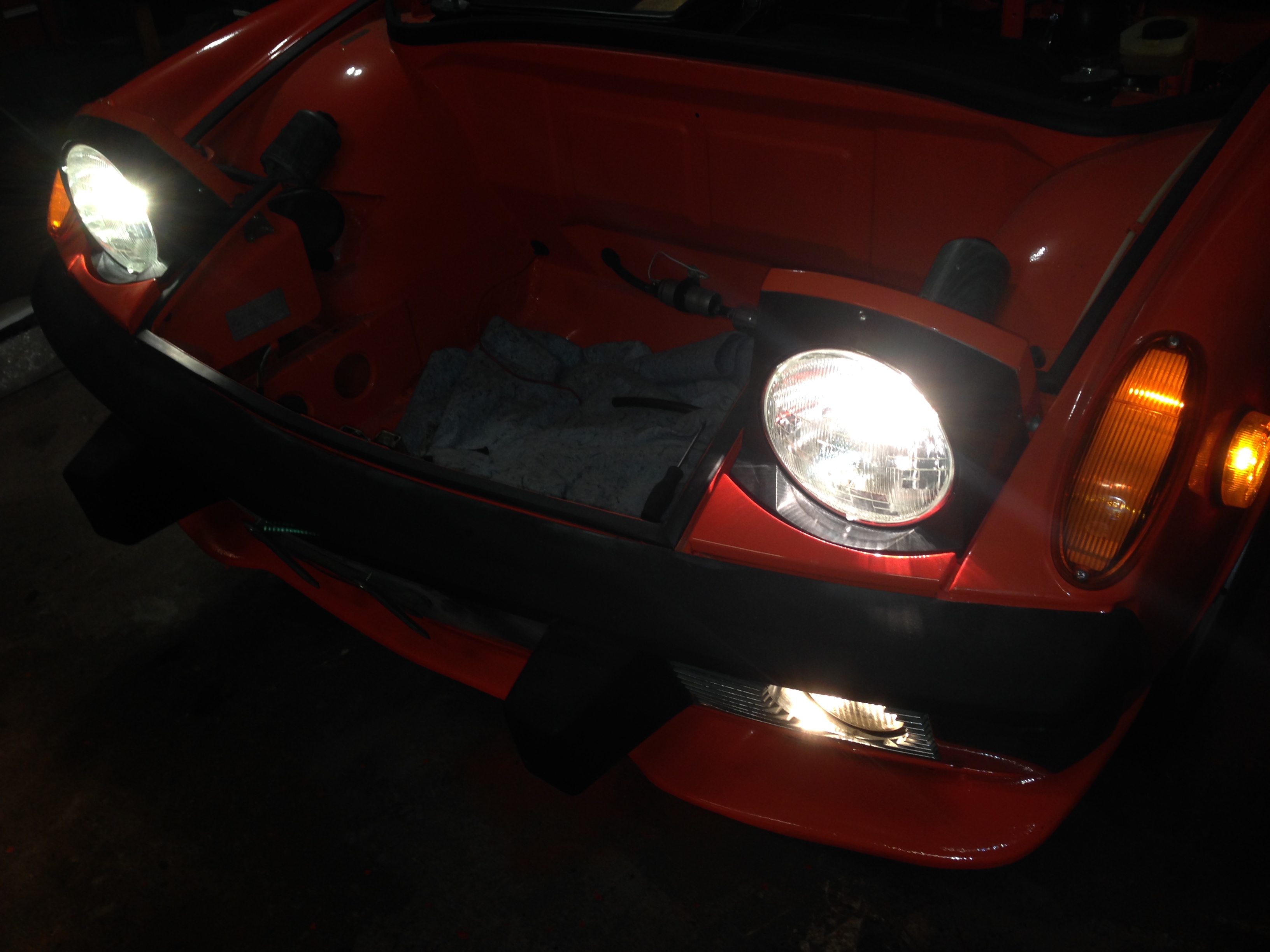

I got one of the Engman fuse panels a year or two ago. No fuses blowing so far and the headlight motors sync'd up and worked perfectly. My parts car I started with could never get the headlights to sync. With the lack of real metal I assume now it's because of poor grounding

All the electrical gremlins with the main harness are all sorted out.

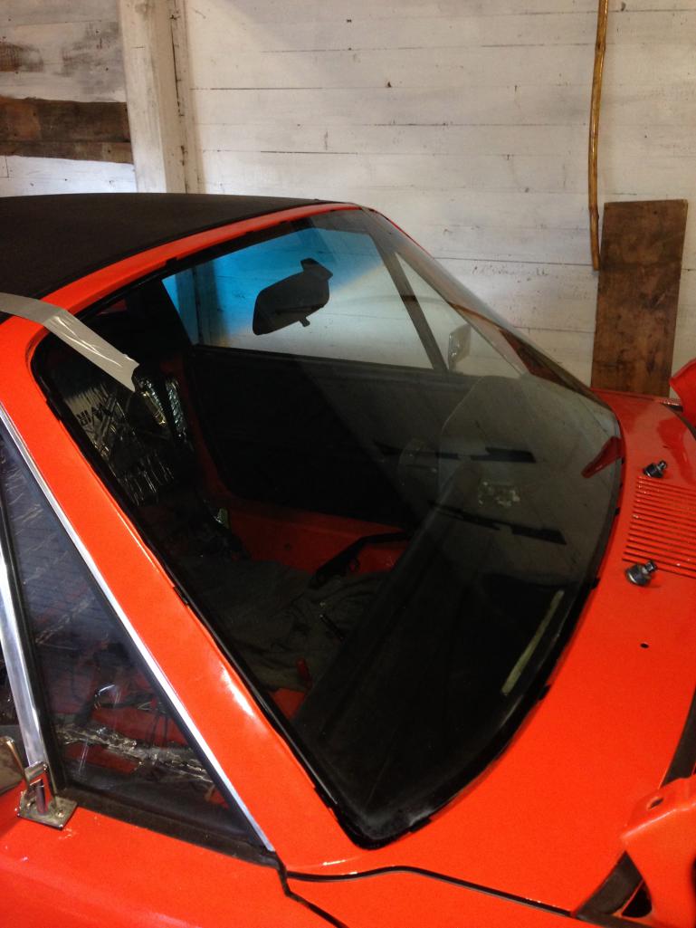

Got the windshield installed today. Next... Cables and fuel lines and carbs. Hopefully fire it up this weekend.. still waiting for a Tee fitting thats coming through the mail.
