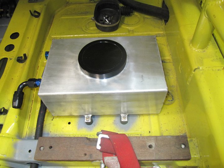

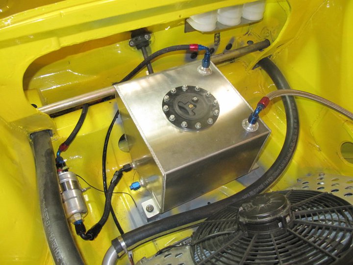

Progress has been a bit slow the last couple of days, but it is starting to pick back up.
Finished up the front truck area. I replaced the foam in the fuel tank and completed all the fuel lines.
(IMG:http://www.914world.com/bbs2/uploads_offsite/sphotos.ak.fbcdn.net-364-1294527193.1.jpg)

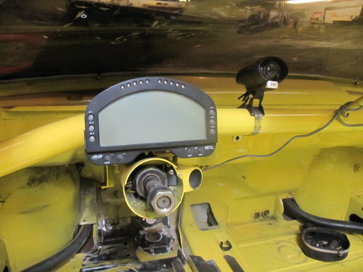

Got the AIM MXL dash mounted and ordered the Subaru interface harness so that I can read everything off the ECU.
(IMG:http://www.914world.com/bbs2/uploads_offsite/sphotos.ak.fbcdn.net-364-1294527193.2.jpg)

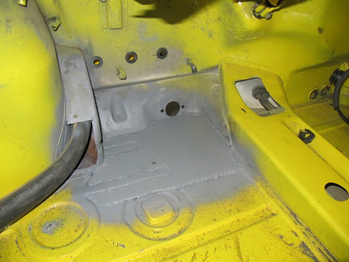

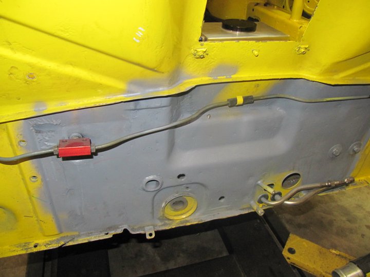

I got the welder back from my buddy who I am borrow it from so I was able to make good progress tonight. First I finished up clean the firewall. There were several large holes that were used to secure the 914/6 engine mount that have now been welded up.
(IMG:http://www.914world.com/bbs2/uploads_offsite/sphotos.ak.fbcdn.net-364-1294571216.1.jpg)
View from the backside of the firewall with the holes welded up and the brake line rerouted to avoid hitting the turbo.

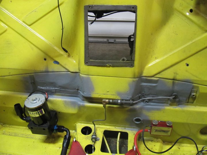

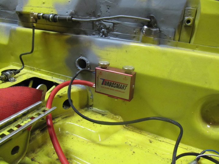

Turbosmart Dual Stage Boost Controller taken off my '69 912 Turbo project. This will work well for those tighter courses or wet weather occasions.
(IMG:http://www.914world.com/bbs2/uploads_offsite/sphotos.ak.fbcdn.net-364-1294571217.3.jpg)

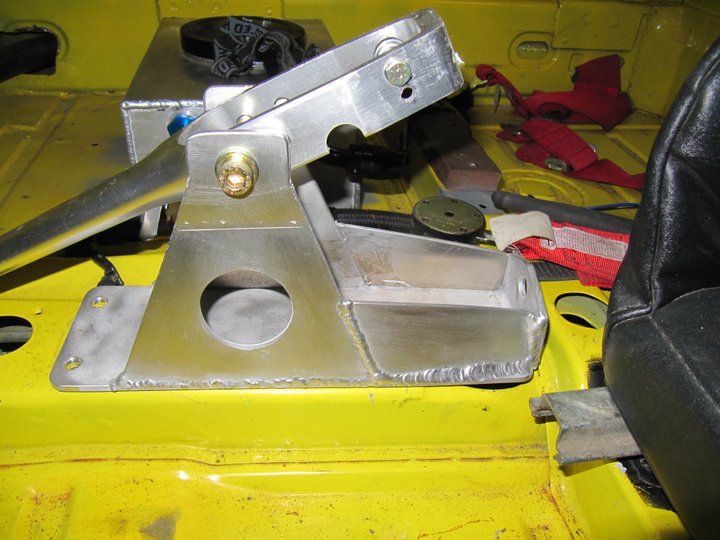

Pedal assembly plate welded in. These welds are not as pretty as I would have liked, however trying to weld in the cramped footwell was not easy and I had to ensure I didn't burn thru the floorpan.
(IMG:http://www.914world.com/bbs2/uploads_offsite/sphotos.ak.fbcdn.net-364-1294571217.4.jpg)
Tilton pedal assembly mounted. The positioning is perfect and the mount is very sturdy.

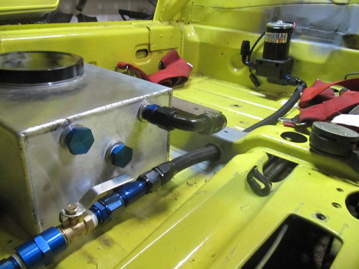

Ice box plumbing. There is a ball-valve to drain the water under the car.

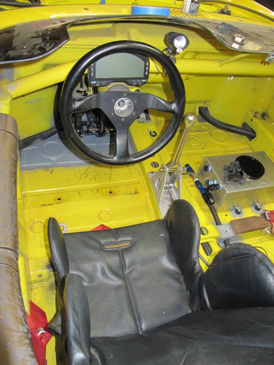

Took the son karting yesterday. It was his first time at a dirt flat track and although he started off slow, he really got the hang of it and it was a lot of fun.
(IMG:http://www.914world.com/bbs2/uploads_offsite/sphotos.ak.fbcdn.net-364-1295250444.1.jpg)

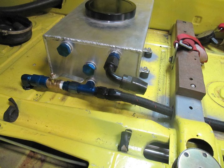

Anyway, back to work. Got the business end almost completed. Just had to put the seat back in to feel the new pedal/shifter/dash set-up. I will admit, I did sit there and make car noises for a bit. The last thing that needs to get done here is a panel for the ignition switches.
(IMG:http://www.914world.com/bbs2/uploads_offsite/sphotos.ak.fbcdn.net-364-1295250444.2.jpg)

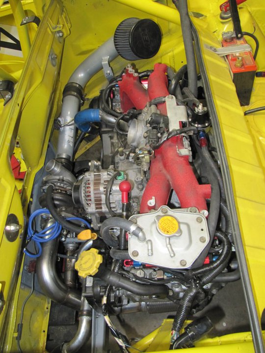

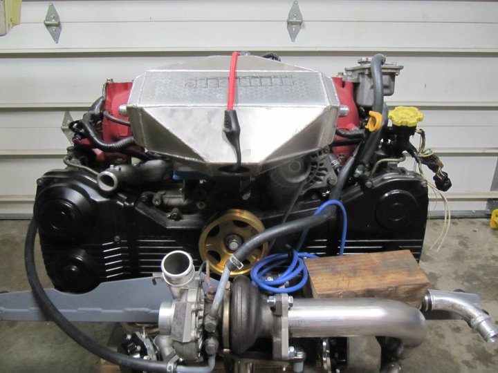

Reinstalled the engine to take some measurements for the throttle cable and clutch hose. Got the air intake installed and a bracket made to mount it.
(IMG:http://www.914world.com/bbs2/uploads_offsite/sphotos.ak.fbcdn.net-364-1295250445.3.jpg)

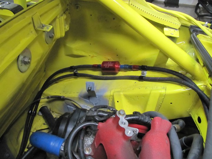

Fuel lines installed. Startlite line may cost a little bit more, but it is SO much nicer to work with and lighter.
(IMG:http://www.914world.com/bbs2/uploads_offsite/sphotos.ak.fbcdn.net-364-1295250445.4.jpg)

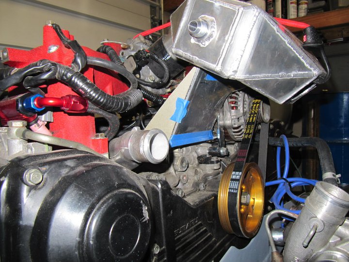

Got the intercooler back from being welded up by Marty Staggs (www.m-specmotorsports.com), turned out perfect.
(IMG:http://www.914world.com/bbs2/uploads_offsite/sphotos.ak.fbcdn.net-364-1295250445.5.jpg)

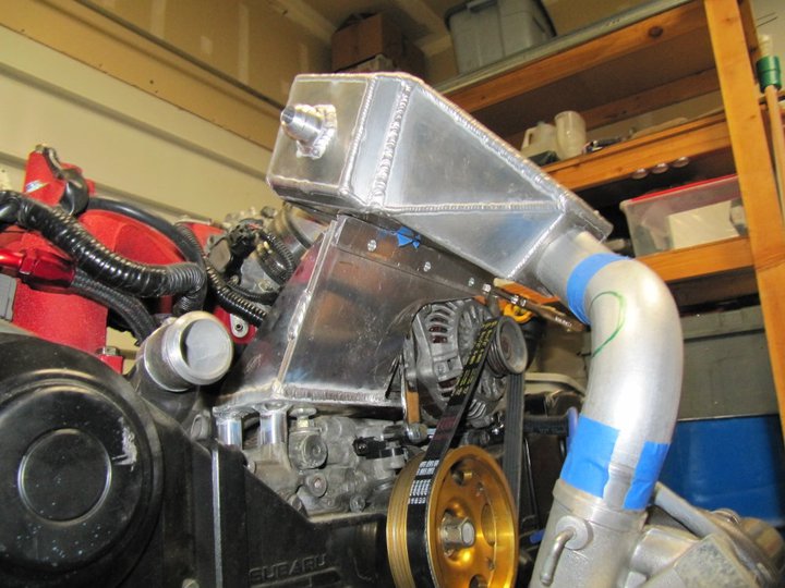

Starting to fab up a heavy duty mount off the engine block. The intercooler is fairly heavy as it sits and will be twice as heavy when the water is added.
(IMG:http://www.914world.com/bbs2/uploads_offsite/sphotos.ak.fbcdn.net-364-1295250445.6.jpg)

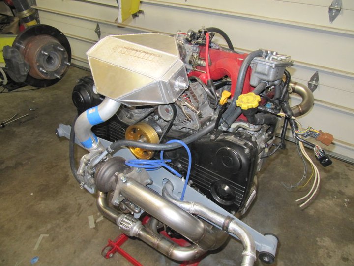

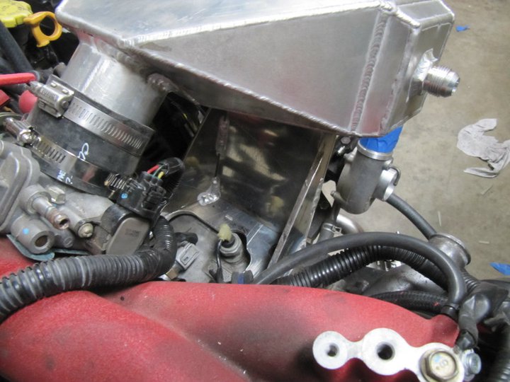

Was able to take the intercooler mount to the machine shop today and get welded up so that I could finish the routing of the intake piping. I also had some aluminum standoffs machined up to mount the bracket to the top of the engine block where the original alternator and power steering brackets were secured. I will take the rest of this to get welded up later this week.

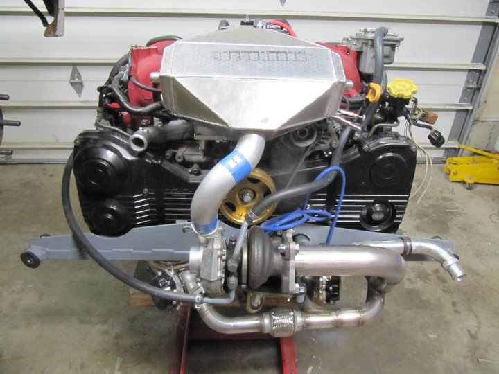

Intake piping between the turbo and intercooler mocked up.
(IMG:http://www.914world.com/bbs2/uploads_offsite/sphotos.ak.fbcdn.net-364-1295421419.3.jpg)
(IMG:http://www.914world.com/bbs2/uploads_offsite/sphotos.ak.fbcdn.net-364-1295421419.4.jpg)

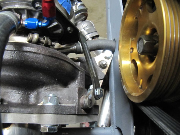

Even though I rotated the compressor side of the turbo I was still able to use a Grimmspeed bracket (with a little modification) to lock the internal wastegate closed.
(IMG:http://www.914world.com/bbs2/uploads_offsite/sphotos.ak.fbcdn.net-364-1295421420.5.jpg)

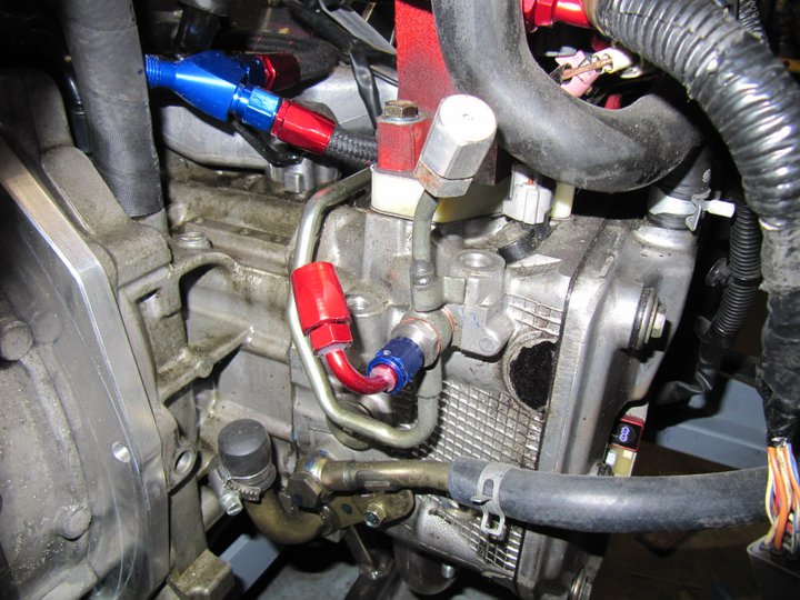

Found a nice solution for the oil feed to the turbo from Forced Performance. Consists of a custom made banjo bolt machined with an AN-4 male fitting on the end. The stock hard line that used to feed the turbo has a machined fitting to cap the oddball size threads. I will run a short lenght of AN-4 hose over to the turbo.
