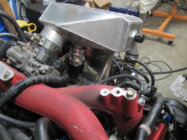

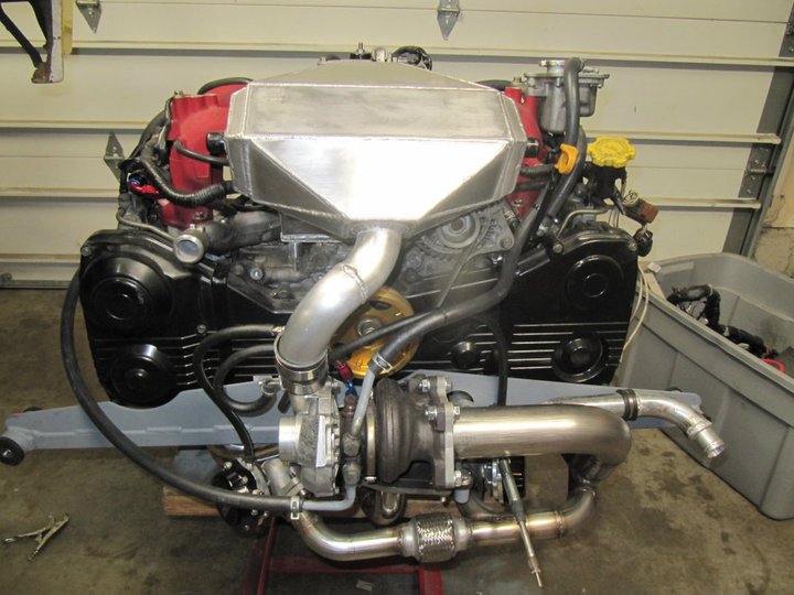

Intercooler mounting completed. Everything fit pretty well considering I had to mock it up at home and take it to a shop to get welded.
(IMG:http://www.914world.com/bbs2/uploads_offsite/sphotos.ak.fbcdn.net-364-1295828400.1.jpg)

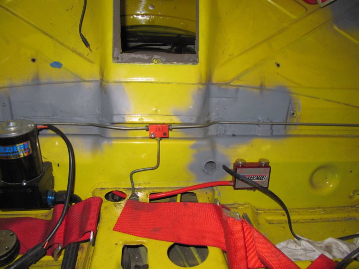

Turbosmart BOV mounted on the underside of the intercooler just before the throttle body.

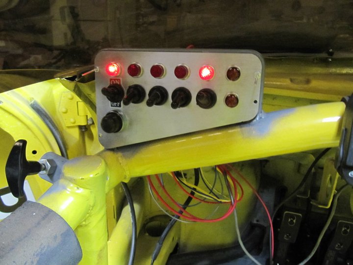

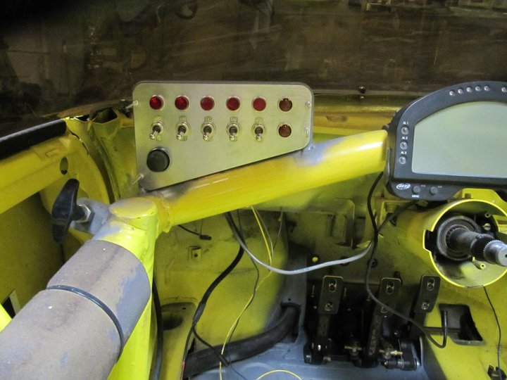

New gauge panel completed and mounted. I had this piece waterjet so that all the holes with line up properly and saved me a bit of time.
(IMG:http://www.914world.com/bbs2/uploads_offsite/sphotos.ak.fbcdn.net-364-1295828401.3.jpg)

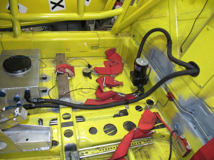

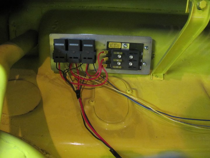

Front fuse box and relays for fuel pump, radiator fan, and intercooler water pump.
(IMG:http://www.914world.com/bbs2/uploads_offsite/sphotos.ak.fbcdn.net-364-1295828402.4.jpg)

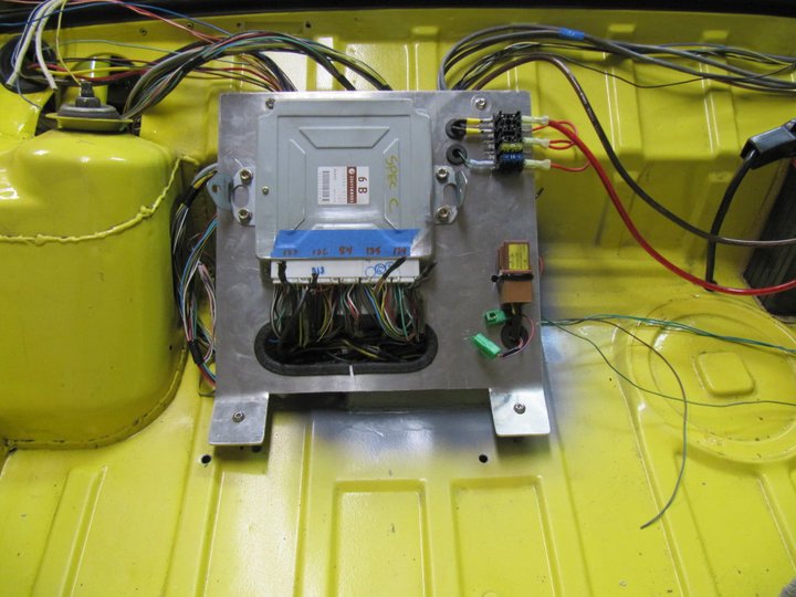

ECU mounted in the trunk. Not looking forward to sorting out the wiring.

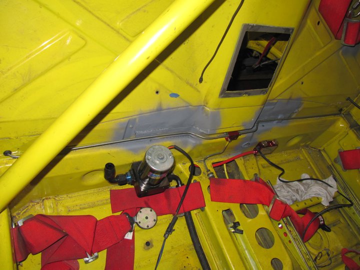

Third iteration of the brake line routing. The 2nd iteration interfered with the brake line routing. This time the brake lines are routed inside the cabin and then thru the firewall over the framerails.
(IMG:http://www.914world.com/bbs2/uploads_offsite/sphotos.ak.fbcdn.net-364-1295849664.1.jpg)
(IMG:http://www.914world.com/bbs2/uploads_offsite/sphotos.ak.fbcdn.net-364-1295849666.2.jpg)

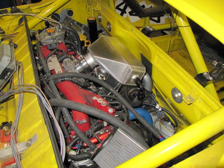

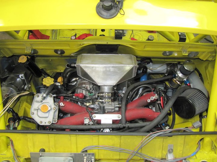

Engine bay with the intercooler installed. Getting pretty busy in there.
(IMG:http://www.914world.com/bbs2/uploads_offsite/sphotos.ak.fbcdn.net-364-1295849666.3.jpg)
(IMG:http://www.914world.com/bbs2/uploads_offsite/sphotos.ak.fbcdn.net-364-1295849667.4.jpg)
Intercooler water lines routed thru the firewall to the pump/tank.

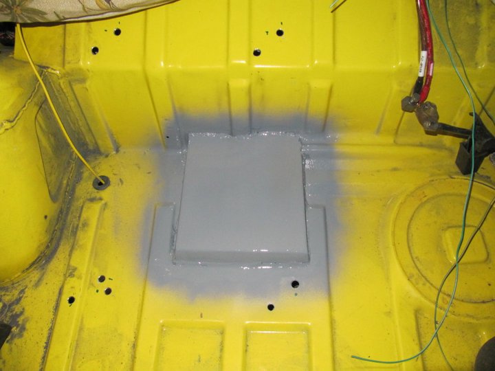

Summary of the work completed over the last couple of days.

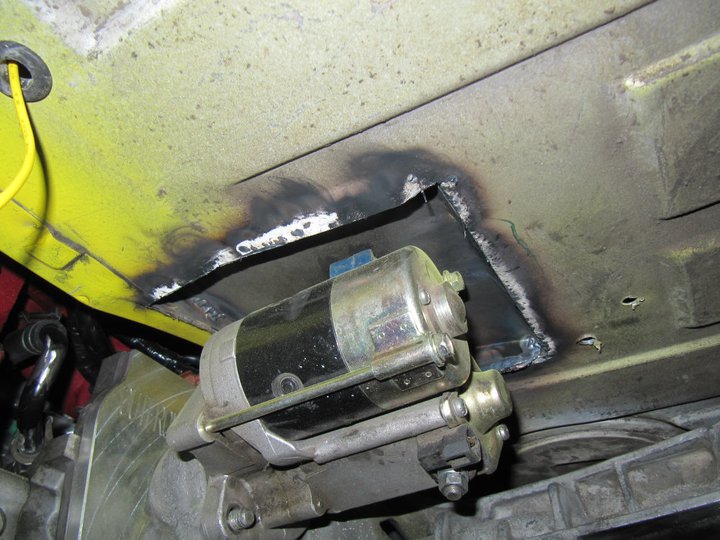

Went to install the starter and finish up the wiring and found that the position of the engine caused the starter to hit the trunk floor. Therefore I had to make this raised panel for clearance.
(IMG:http://www.914world.com/bbs2/uploads_offsite/sphotos.ak.fbcdn.net-364-1296719073.1.jpg)
View from underneath. I made the panel with the transmission in the car. When I pull the trans to install the new flywheel I will clean this area up.

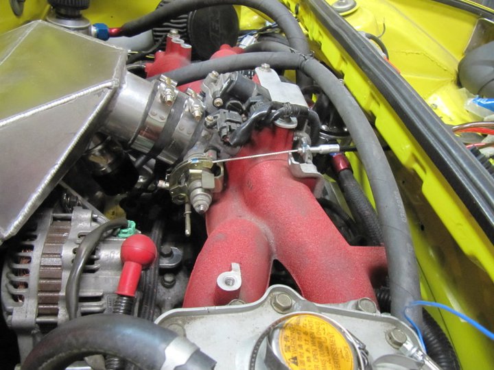

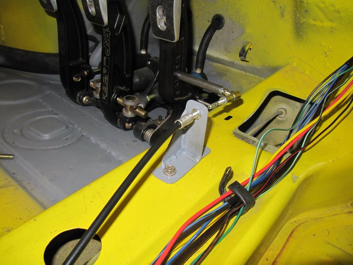

Throttle cable bracket completed and all adjusted. The feel of the throttle pedal is perfect.
(I got the throttle cable made custom from Terrycable and due to an error on my part, the first one I ordered was a bit short. If anyone is building a Suby conversion and needs a throttle cable 90" long let me know. It would work perfectly on a car with the intake manifold in the stock orientation (i.e. pointing back).
(IMG:http://www.914world.com/bbs2/uploads_offsite/a3.sphotos.ak.fbcdn.net-364-1296719074.3.jpg)
Throttle cable mounted in the engine compartment.

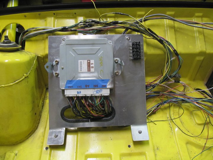

ECU mounting and the majority of the wiring completed. Still need to finish the alternator wiring and some various sensor for the VSS (Vesicle Speed Sensor) and NPS (Neutral Position Switch).

Switch panel has power. Lets see, we got master on, fuel pump, radiator fan, intercooler water pump, and boost switch.

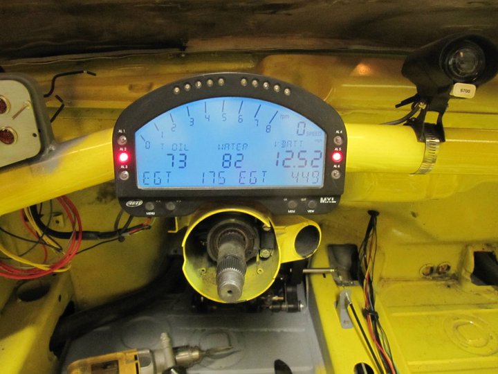

Dash display wired in and working. Not sure where it is getting the Oil/Water/EGT numbers as the ECU was not on...maybe memory from the engine it was installed on previously.
