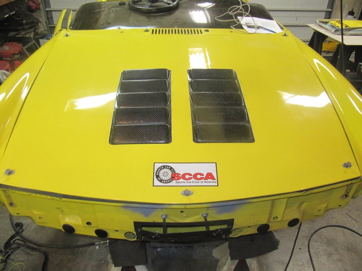

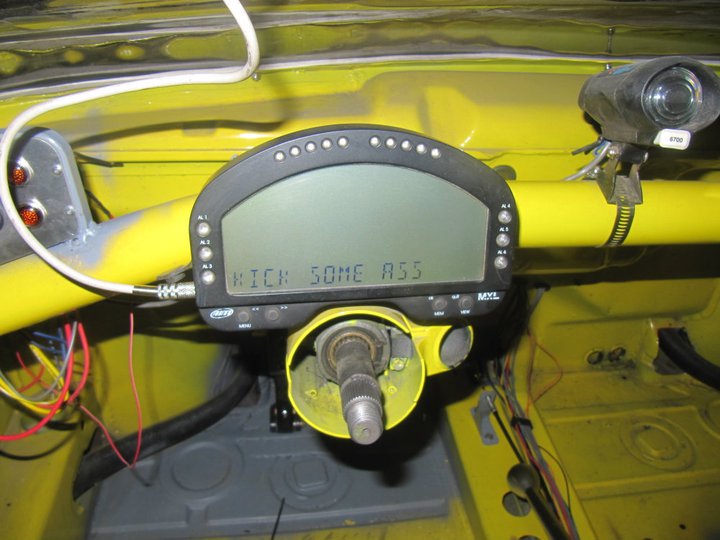

Ok, I am on the final push towards the end. I have dyno time schedules for Friday, Feb 18th at Cobb Tuning Surgeline. Still waiting on the flywheel, but I can get everything else prepared in advance.
Reprogrammed the dash for a little pre-race inspiration. (IMG:style_emoticons/default/smile.gif) I also wired up the oil pressure, oil temp, fuel pressure, and water temp sensors to monitor on the dash.
(IMG:http://www.914world.com/bbs2/uploads_offsite/a2.sphotos.ak.fbcdn.net-364-1297098064.1.jpg)

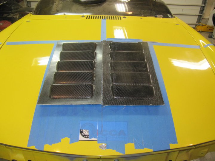

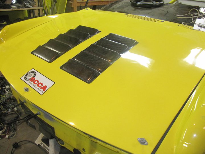

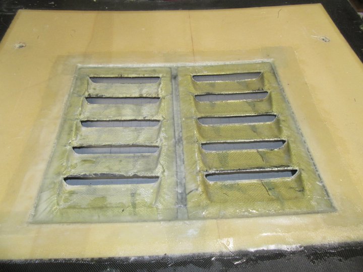

For radiator venting thru the hood, I purchased two louvered panels. These things were pricey and I was less than impressed with the quality. However, they will serve a purpose and I have to remind myself that this is just a race car.
Here are the panels in the approximate location on the hood.
(IMG:http://www.914world.com/bbs2/uploads_offsite/a8.sphotos.ak.fbcdn.net-364-1297098065.2.jpg)

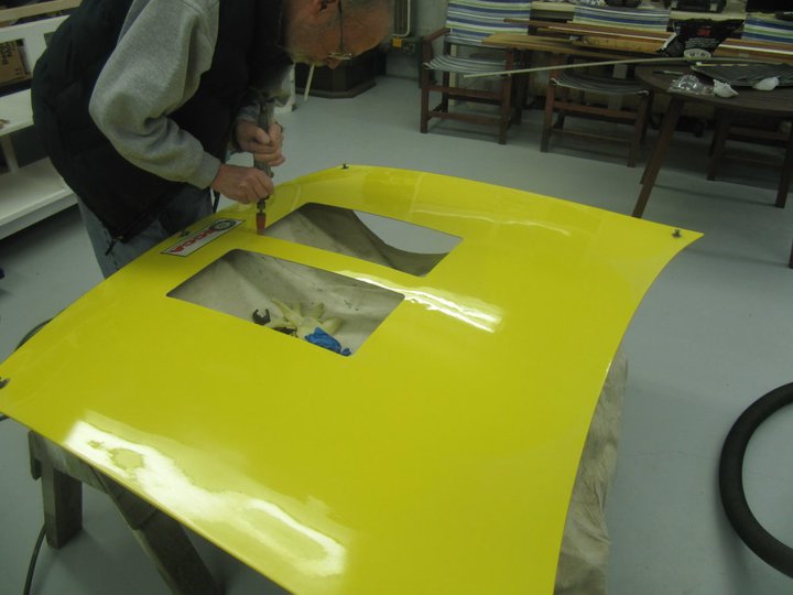

I took the hood up to JP's shop to make the cutouts. Fortunately I was able to get JP off his butt to help cut the hood. Notice that he can't do anything without a cig hangin out of his mouth. (IMG:style_emoticons/default/smoke.gif)
(IMG:http://www.914world.com/bbs2/uploads_offsite/a6.sphotos.ak.fbcdn.net-364-1297098065.3.jpg)
Here are the panels bonded to the back of the hood and in place on the car.
(IMG:http://www.914world.com/bbs2/uploads_offsite/a4.sphotos.ak.fbcdn.net-364-1297098065.4.jpg)

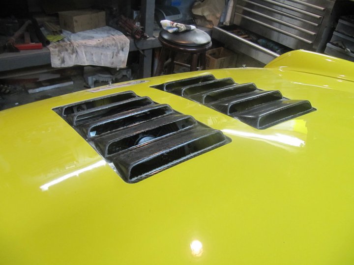

Side view, they are just under the 1" height restriction as per SCCA.
(IMG:http://www.914world.com/bbs2/uploads_offsite/a3.sphotos.ak.fbcdn.net-364-1297098065.5.jpg)
Looking down into the hood you can see the radiator and fan.
(IMG:http://www.914world.com/bbs2/uploads_offsite/a5.sphotos.ak.fbcdn.net-364-1297098066.6.jpg)
On the backside, you can see the area of the core mat we had to remove to bond directly to the backside of the hood. Added an additional layer of epoxy to the backside for strength.
(IMG:http://www.914world.com/bbs2/uploads_offsite/a2.sphotos.ak.fbcdn.net-364-1297098066.7.jpg)
I also was able to put a gallon of fuel in and test the system...good idea that I did this now as I found a pinched injector o-ring and had to get a new set on order. It was fun to have 45psi of fuel squirting out of the fuel rail.
-Britain

Hood came out nice Brit, even with JP doing the cutting (IMG:style_emoticons/default/biggrin.gif)
I have probably forgotten but where is the air coming in to the radiator from...?
Britain Smith
post Feb 7 2011, 11:17 AM
Post #147
Nano Member
Posts: 2,354
Joined: 27-February 03
From: Hillsboro, OR
Member No.: 364
Air entering the oil cooler cutout location in the front bumper.
-Britain

Is the radiator going to be shrouded to the vents? Just curious.
Were those louvers flexible to mold to the curve of the hood? Curious how you managed that.
Looking good as usual!
Britain Smith
post Feb 7 2011, 01:06 PM
Post #150
Nano Member
Posts: 2,354
From: Hillsboro, OR
Member No.: 364
The recent change to the SCCA rules do not allow ducting from the radiator to the vent. I am still trying to clarify exactly what I can and can't do. As per the rules I also need to add a mesh screen under the louvers...again, trying to clarify.
As for the curve of the hood, the louvers were fairly flexible but I had to use a bunch of weights and some strong epoxy to get the shape right...took all weekend to set.
-Britain

QUOTE(Andyrew @ Feb 7 2011, 10:25 AM) *
That touches a sore spot.
Believe it or not, per SCCA XP rules building a duct from the radiator to the vents/louvers is ILLEGAL! The result will be some trailer park engineering in an attempt to get the hot air out & away from the gas tank...... (IMG:style_emoticons/default/mad.gif)

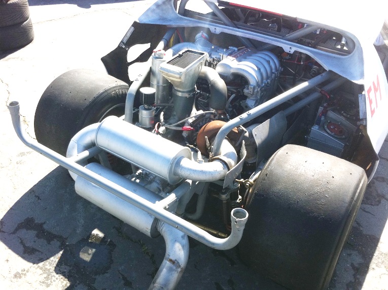

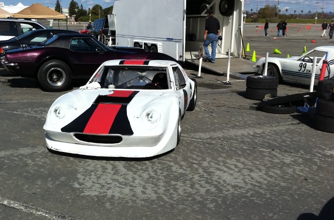

Check this out! Its still being developed but when they figure out all the ECU mapping watch out! EMod Lotus Europa with 20B triple rotor turbo. Makes 440 WHP! It amounts to little more than a tubeframe car with fiberglass shell. inboard brakes, Penske dampers, fat Avon slicks.

Yea, is that Jesus car? Looks pretty fast...glad it is in Emod. (IMG:style_emoticons/default/smile.gif)

No Jesus' car is in the background and is almost equally as fast.

Wow, there are 2 Europa's down there...nice!

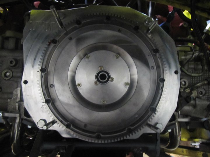

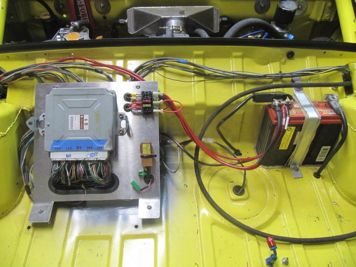

I haven't been posting progress picture as often, but I can promise you I have been working hard. I had to move my dyno time out a week due to a delay in the arrival of the custom flywheel, but now I am back on track.
All the car wiring is completed. Pictures of wiring is not that exciting, but here is the ECU and rear fuse panel wired up.
(IMG:http://www.914world.com/bbs2/uploads_offsite/a4.sphotos.ak.fbcdn.net-364-1298399904.1.jpg)

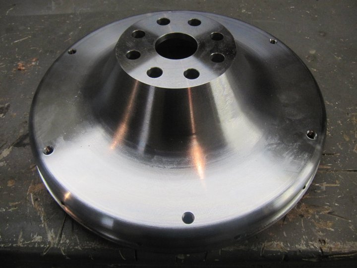

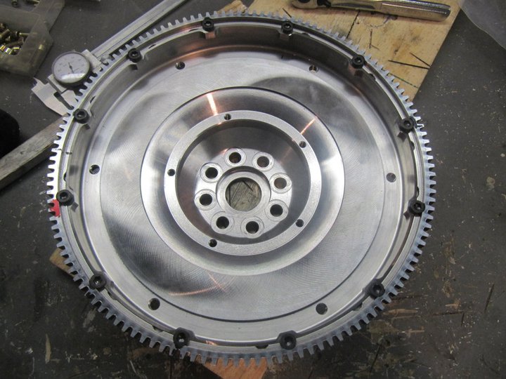

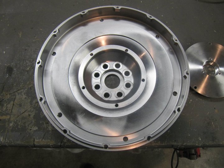

This is the custom flywheel that I commissioned WEVO to make. I had a concern about the conversion flywheels out there as they are welded together, about 32lbs with the pressure plate assembly, and intended for a 6200rpm USDM motor. This is an 8500 rpm engine and I wanted a little bit lighter rotating mass....therefore I went this route.
The flywheel is actually a three-piece design. This the flywheel as it arrived.
(IMG:http://www.914world.com/bbs2/uploads_offsite/a4.sphotos.ak.fbcdn.net-364-1298399905.2.jpg)
This is the back mounting flange of the flywheel. The large step is required to clear the adapter plate. This is where the conversion flywheels are welded.
(IMG:http://www.914world.com/bbs2/uploads_offsite/a6.sphotos.ak.fbcdn.net-364-1298399905.3.jpg)
Ring gear installed.

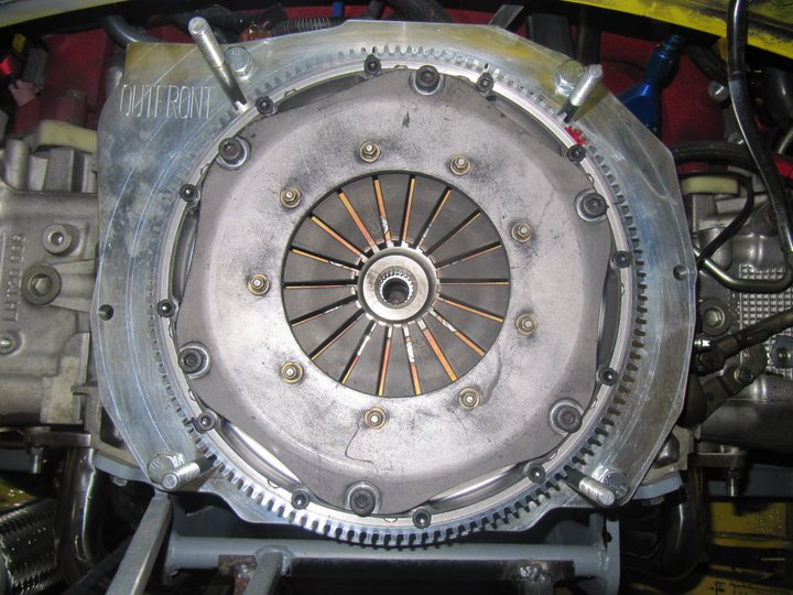

(IMG:http://www.914world.com/bbs2/uploads_offsite/a1.sphotos.ak.fbcdn.net-364-1298399906.4.jpg)
Flywheel mounted on the engine and the pilot bearing plate fitted.
(IMG:http://www.914world.com/bbs2/uploads_offsite/a5.sphotos.ak.fbcdn.net-364-1298399906.5.jpg)

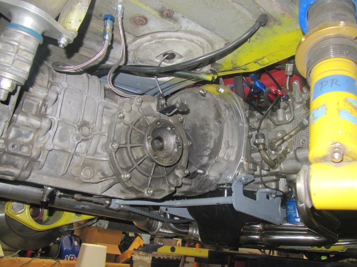

Tilton pressure plate installed.
(IMG:http://www.914world.com/bbs2/uploads_offsite/a3.sphotos.ak.fbcdn.net-364-1298399908.6.jpg)
As I mentioned when installing the pedal assembly, I decided to go with a hydraulic throw-out bearing. Here is the Tilton Hydraulic throw-out bearing assembly fit in the 901 transmission. This is a completely custom set-up with custom parts. It is actually a SAAB bearing.
(IMG:http://www.914world.com/bbs2/uploads_offsite/a7.sphotos.ak.fbcdn.net-364-1298399908.7.jpg)
And finally, the transmission reinstalled with the assistance of my wife. VSS sensor wired up and hydraulic lines routed.
(IMG:http://www.914world.com/bbs2/uploads_offsite/a4.sphotos.ak.fbcdn.net-364-1298399910.8.jpg)
I actually filled the engine with oil/water last night and cranked it over. I got it to start for about 5secs before it would stumble. I have some ideas on things to check, but the good news is that is started. It was about 11:30 last night when I was cranking it and decided that I didn't want to push it with the neighbors, I will try again this evening.
-Britain
