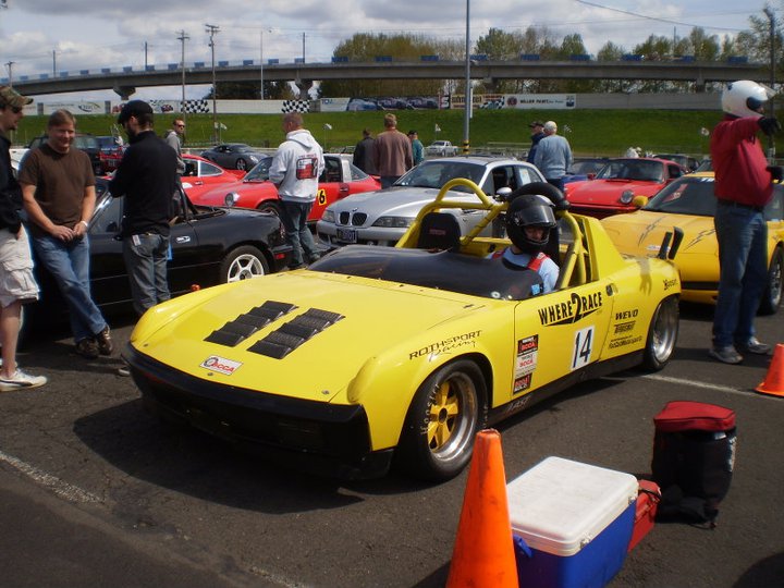

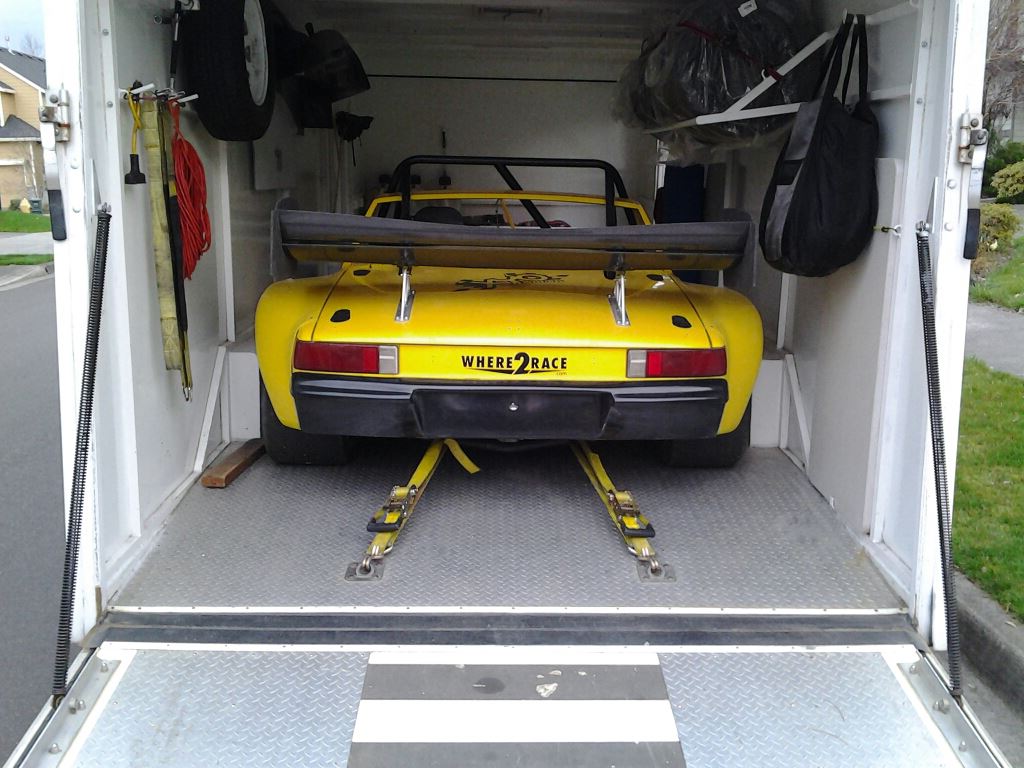

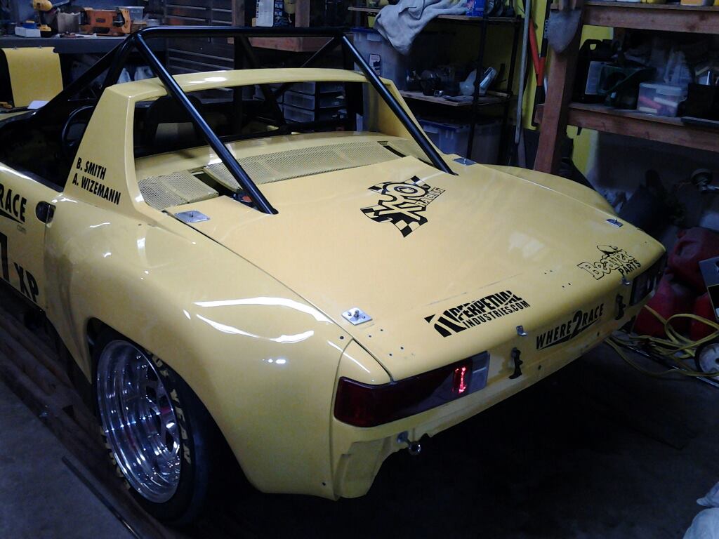

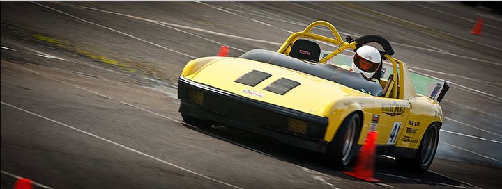

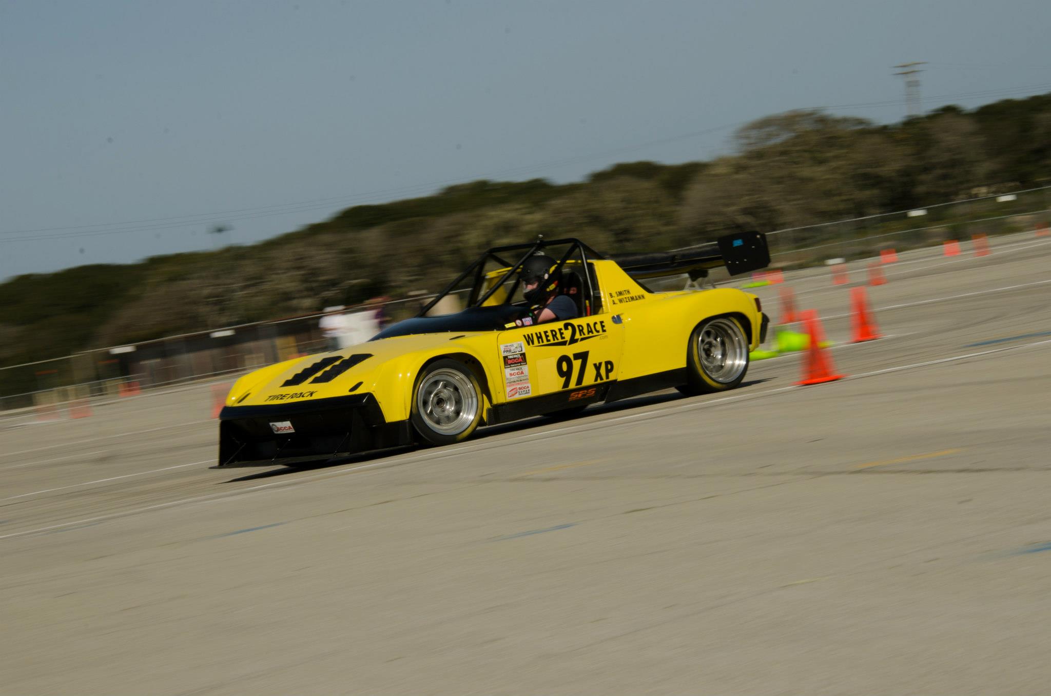

For those who don't know me or the car, I have a '74 914 that is a dedicated AX car. It previously had a high compression 2.7 6-cylinder motor and made 205hp/205ft-lbs at the wheels. This set-up wasn't all that bad considering that it won the 2008 and 2009 914 Shootout events, however the quest for more speed continues.
Here is the car in the 2010 season trim.
(IMG:http://www.914world.com/bbs2/uploads_offsite/dragracevws.com-364-1291656786.1.jpg)

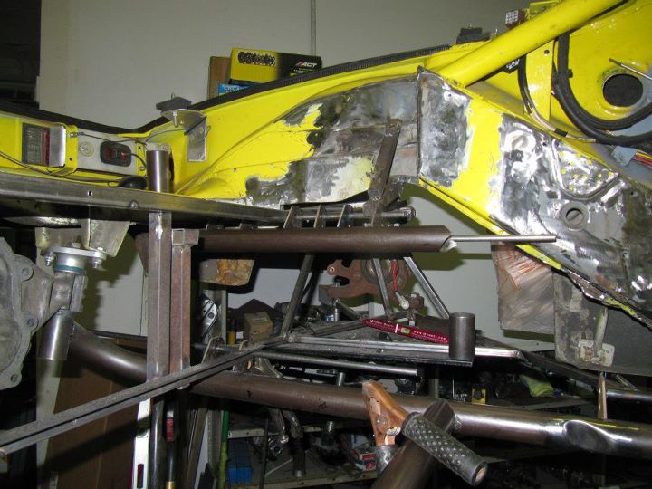

I have recently sold the 2.7L 6-cylinder engine and all the remaining 914/6 conversion parts. I have used the proceeds to fund the conversion to Subaru power. Now most would say that a Subaru conversion can be done on a budget, however I have found that the money goes flying out the window when doing something like this.
Regarding the engine...logical choice would be to go for a EJ257 2.5L USDM STi engine. However, all the SCCA rules for AX are built around displacement which in turn dictates the minimum weight. Therefore, I have gone with a JDM STi version8 Spec-C engine which is a 2.0L, twin-scroll, hand ported/polished, 8500rpm animal. I will get slightly less hp and torque numbers than the 2.5L, but save 150lbs of weight.

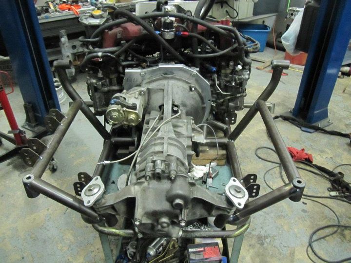

Britain Smith   So, I have been working on the conversion for abou...   Dec 6 2010, 11:33 AM

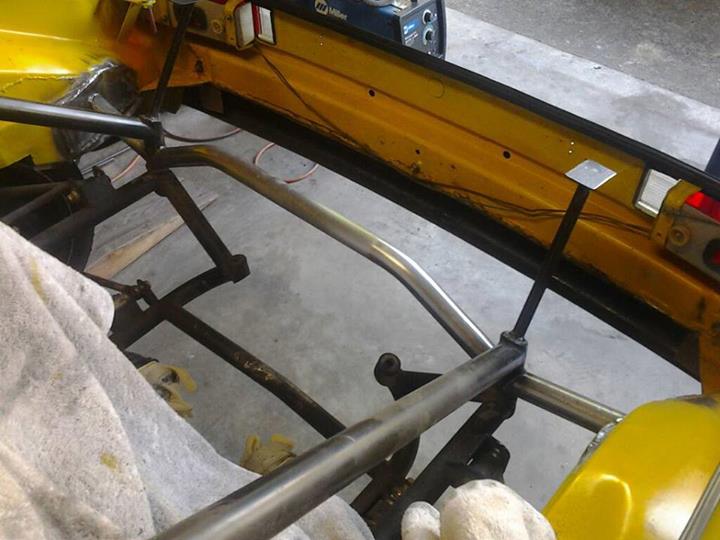

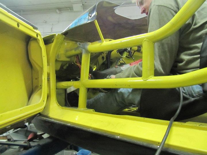

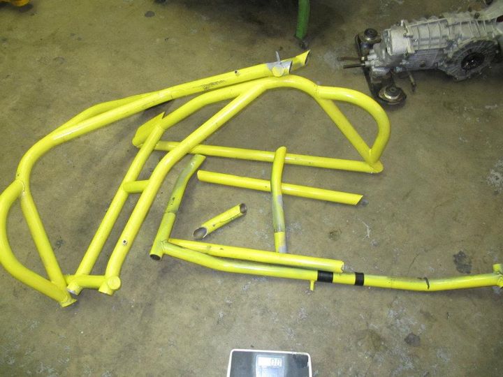

Britain Smith   First thing I did was cut out the 914/6 bulkhead e...   Dec 6 2010, 11:33 AM

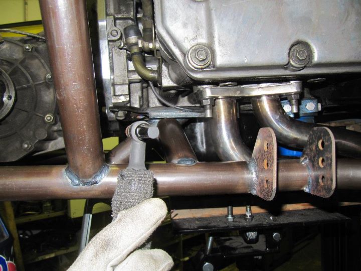

Britain Smith   I purchased the Synic Motorsports header which is ...   Dec 6 2010, 11:34 AM

Britain Smith   The Vanagon Engine mount came from Small Car P...   Dec 7 2010, 02:47 PM

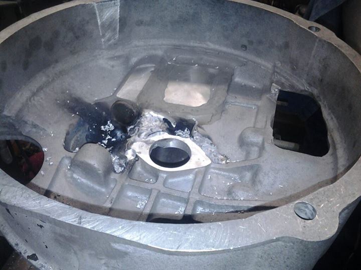

Britain Smith   Now that I have an idea where the turbo will fit a...   Dec 6 2010, 11:36 AM

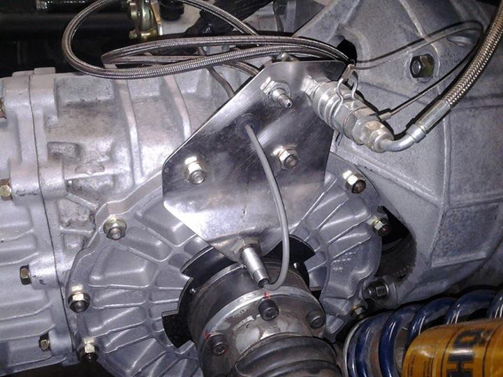

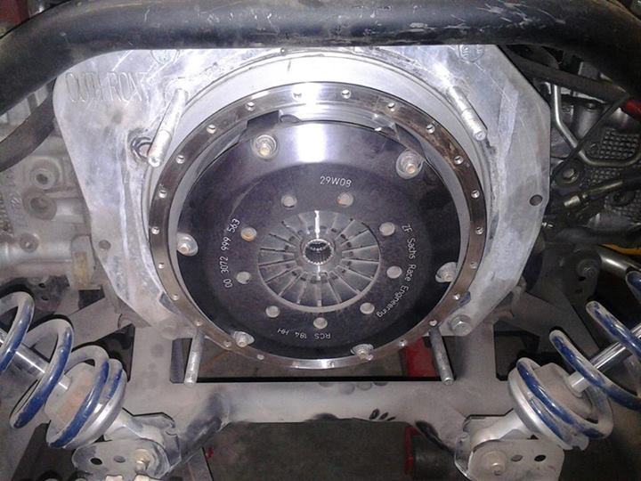

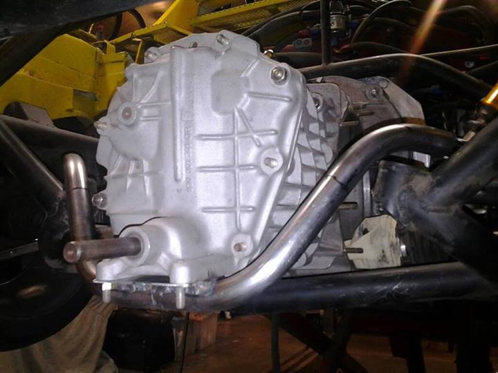

Britain Smith   With the engine mounted, it was time to address so...   Dec 6 2010, 11:36 AM

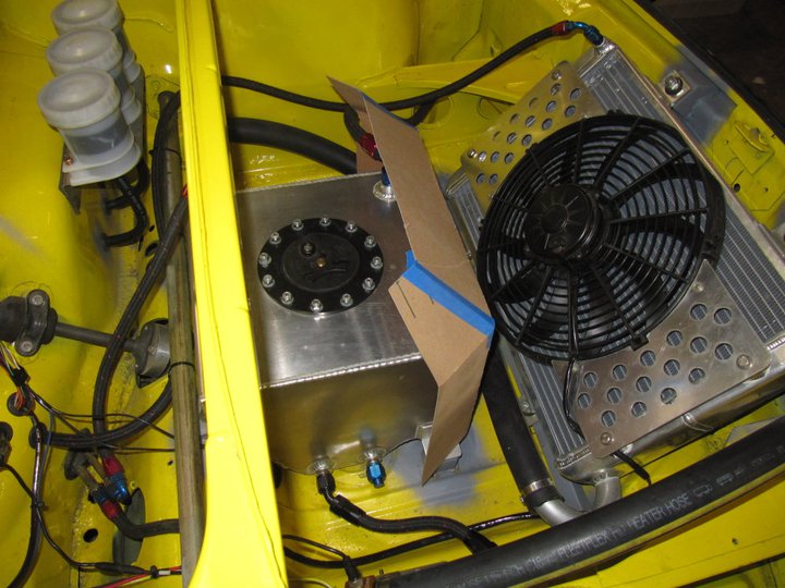

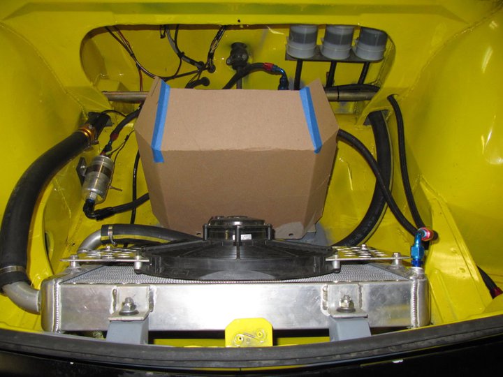

Britain Smith   Quick question...for the fuel tank I would like to...   Dec 18 2010, 11:10 PM
McMark   There's one on this site that has a thermomete...   Dec 18 2010, 11:59 PM
396   Keep them coming , VERY COOL PROJECT!   Dec 19 2010, 08:40 AM
jd74914   Don't use PVC tube. It will melt! (Edited ...   Dec 19 2010, 09:13 AM
McMark   Hmmm, I found a ton of different references to usi...   Dec 19 2010, 01:43 PM
jd74914   Wow...I think I read PVC this morning and thought ...   Dec 19 2010, 05:19 PM
ottox914   Not like you need more projects, but... Ducting ...   Dec 19 2010, 05:44 PM
Britain Smith   Yep, the radiator will be completely ducted front ...   Dec 19 2010, 07:27 PM
roadster fan   For the fuel site gauge look at custom motorcycle ...   Dec 20 2010, 02:41 PM
JRust   I would consider modifying or adding some kind of ...   Dec 20 2010, 03:44 PM
Britain Smith   The mounting points have rubber isolators, the rad...   Dec 20 2010, 09:09 PM
JRust   The mounting points have rubber isolators, the ra...   Dec 21 2010, 12:26 AM
Britain Smith   The mounting points have rubber isolators, the r...   Dec 21 2010, 02:46 AM

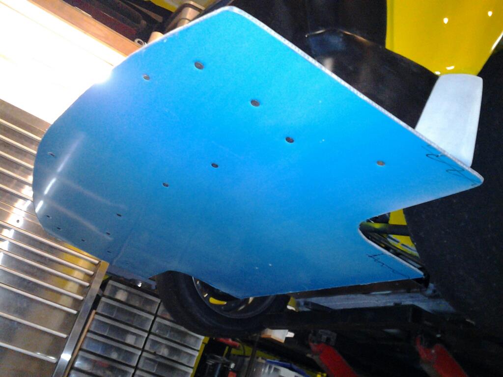

Britain Smith   I had the day off work and was able to get a coupl...   Dec 21 2010, 03:18 AM
