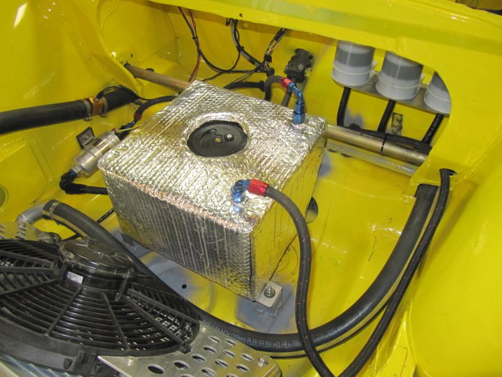

A hot fuel tank is usually the result of an EFI engine where fuel is constantly circulated by the fuel pump and heated from the hot injectors. Do you run low-Z (low resiatance) injectors (peak and hold) or high resistance injectors (as most OEM)?
The low resistance have a very high amp flowing through them and get much hotter then the high resistance injectors.
I think insulating the tank from the radiator may not help much, but worth a try at least as its easy and cheap to do and fuel coolers are a lot more work after all.

I was told that the front of the tank is hot while the back is cool. I too believe the wrap will do the trick and it is in the KISS mode. (IMG:style_emoticons/default/biggrin.gif) .

Would never disagree with KISS solutions but would note that I get quite a lot of heat in my motorcycle gas tanks from circulating the fuel past a hot engine and back into the tank. BMW injectors and fuel lines are hanging right out in the airstream, so that might be a factor.

QUOTE(Walter @ Apr 27 2011, 01:04 AM) *
That is a good point. I do have 16mm phenolic spacers between the intake manifold and the heads which should keep a lot of heat out, but I agree some degree of heat will be coming from the circulation.
That said, the front of the fuel tank was very hot to the touch compared to the sides and back of the tank. I will wrap in an insulation material and determine if that helps with the temps.

Anyway, for the fuel temperature issue I have decided to try out McMark's idea with a simple insulated cover made out of the bubble wrapped foil stuff used on windshield screens in the hot summer. We shall see how it works this weekend.
(IMG:http://www.914world.com/bbs2/uploads_offsite/a7.sphotos.ak.fbcdn.net-364-1304012567.1.jpg)

Doesn't Home Depot sell AC duct wrap? I use it on my test systems that have to go through temperature cycles. It's a foil based wrap with insulating foam with adhesion. Simple to apply. Just another thought.
