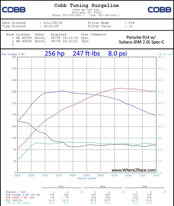

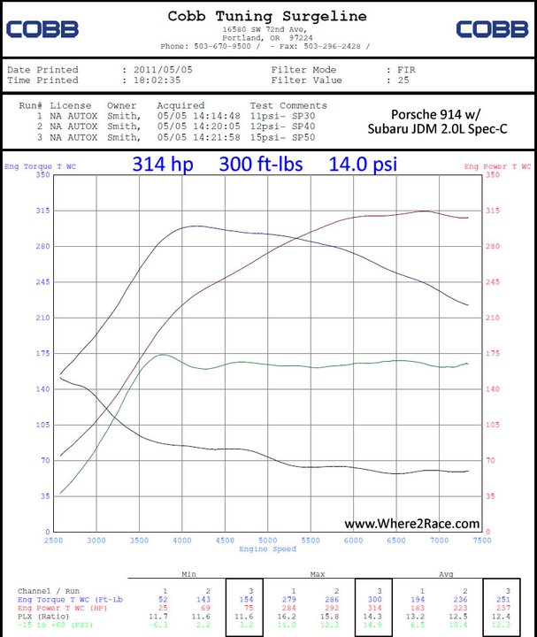

Ok guys, it is late and I am going to bed...but before I do, here is a little to share.
Spent the day at COBB Tuning Surgeline finalizing the tune on my car. First off, what a great atmosphere down there and a very knowledgeable group of guys. Many thanks to head tuner Timothy Bailey and Brandon Lumpkins for their work, I know they enjoyed the ride around the parking lot.
We got the cold start enrichment ironed out so that the car is a bit easier to start on the E85 in cold to mild weather. We also tuned the new Turbosmart E-boost boost controller set-up maps at various boost set-points. This will allow me to dial in the boost level depending on weather, track conditions, course layout, and tire life. This set-up is trick and very easy to adjust.
Here are both the low boost and high boost dyno graphs.
Low Boost, 8psi:

High Boost, 14psi:
(IMG:http://www.914world.com/bbs2/uploads_offsite/a2.sphotos.ak.fbcdn.net-364-1304666492.2.jpg)
Now, the motor will easily take 18psi without issue. However, the clutch package is rated at about 400hp and the transmission/CV's are already close to the theoretical limit so I decided that I wanted to stick to this power level and avoid the exponential decay of transmission. Besides, the car is only 1800lbs and just about uncontrollable at the high boost levels.
Just as a side note, I have driven this car in competition for over 5 years and after driving it tonight thru the parking lot I got out and had a good adrenalin rush, complete with shaking hands, for a good 5mins.
Overall, the car is running great and the driving experience is beyond my expectations...it is going to be a fun year.

OK, we get it, you now have to wear a g-suit coming out of corners.
Can you believe those torque figures? And it comes on so early and stays so late.
I'd say that engine is just about ideal.

Just my be prepared idea but why not get a 18 psi boost tune? You know you will get aquainted really well with the tune you have and you WILL be able to use more at some point. The higher boost will mean lower rpms overall I would think although it might get a little twitchy. I always thought a new fast motorcycle was fast and it made my knees shake but only for a while.

The tune is good up to 18psi and there is no reason on the engine side not to go there. However, the last thing I want to do is burn up the clutch or blow the transmission on the dyno. Believe me, the car is a handful at 14psi and until I feel I need more power, that will be the limit. There is something to be said about going to an event and not have to wrench on the car or scramble to fix something.

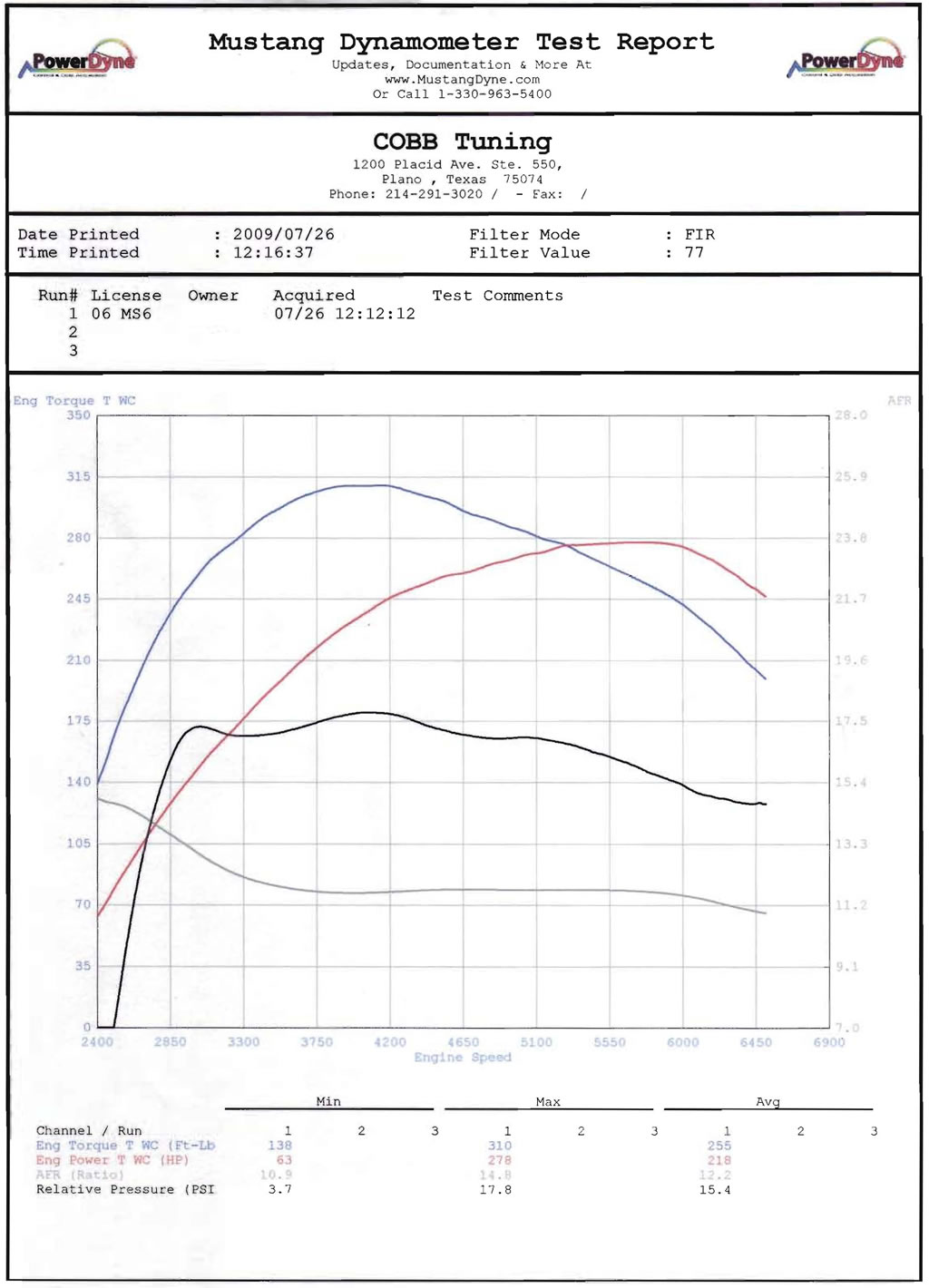

It appears to me that the driving style of the turbo vs the NA is different.
Yep espeically low displacement turbo motors like this one. You can see the cliff where power falls off from the dyno. Need to be on early and learn how to left foot brake like a mad man.
AWD cars are a little easier as they allow you to get on turbo early. 2wd is a little tougher but Brit will figure it out.
I liked the torque from my 2.3 DI turbo MS6. It pulled like a tractor from 2400 RPM. Of course I had 2000 more lbs of car to haul than Brit!
(IMG:http://www.914world.com/bbs2/uploads_offsite/www.lugg.net-433-1306441768.1.jpg)
