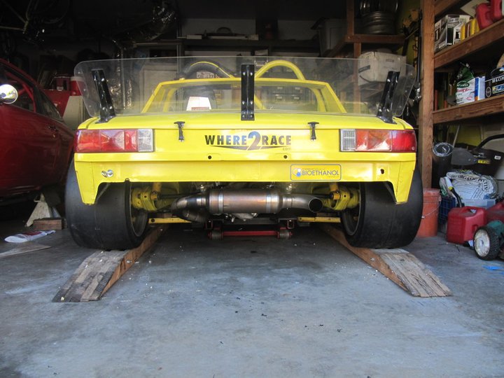

I want to give you guys a quick update as I prepare for the SCCA Nationals in Lincoln.
At the Packwood NT, we continued to struggle with lack of rear grip. Although I have tried several adjustments, springs, sway bars, etc., I just can't get the balance like I want it. If I compensate for the rear grip, then the car suffers from understeer. If I adjust that out, I have trouble keeping the rear end under control. Either way, the current set-up was just not working.
Therefore, short of completely changing the suspension to something from the 21st century (that is coming soon), I decided to take my tire contingency winnings and get a set of Hoosier Radials. For reference, my old set-up was 23.0x9.5x15 cantilever fronts and 22.0x10.0x16 rears, both bias ply in R35B compound. My new set-up are 23.0x10.0x15 R25B fronts and 23.5x12x16 R75 rears. The thought here is that the softer fronts will allow them to heat up faster and provide good front grip and the rears will last longer and provide more mechanical grip from the wider width.

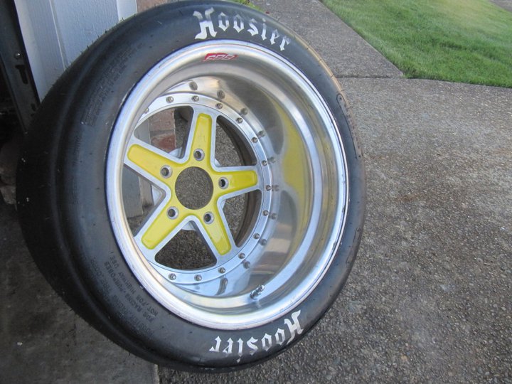

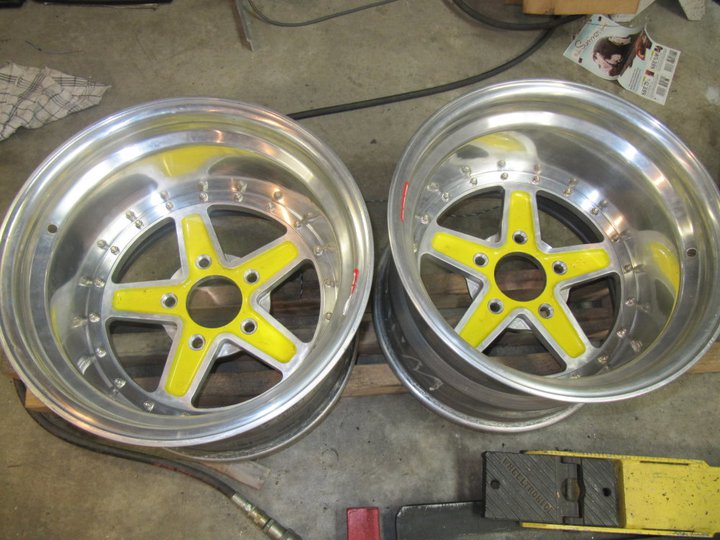

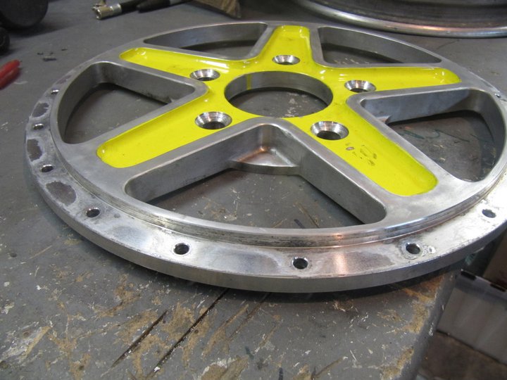

In order to fit the larger wheel tires properly, I was forced to rebuild the rear wheels. I first disassembled the 3-piece wheels.
(IMG:http://www.914world.com/bbs2/uploads_offsite/a3.sphotos.ak.fbcdn.net-364-1313821970.1.jpg)
Unfortunately the older wheel barrels were not BBS and where actually welded together at the seam. I therefore had to source 5" inner halves and 7" outer halves to make this work.
Here are the wheels assembled. Gotta love the "dish"

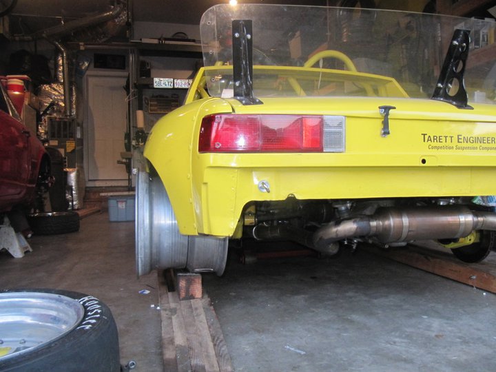

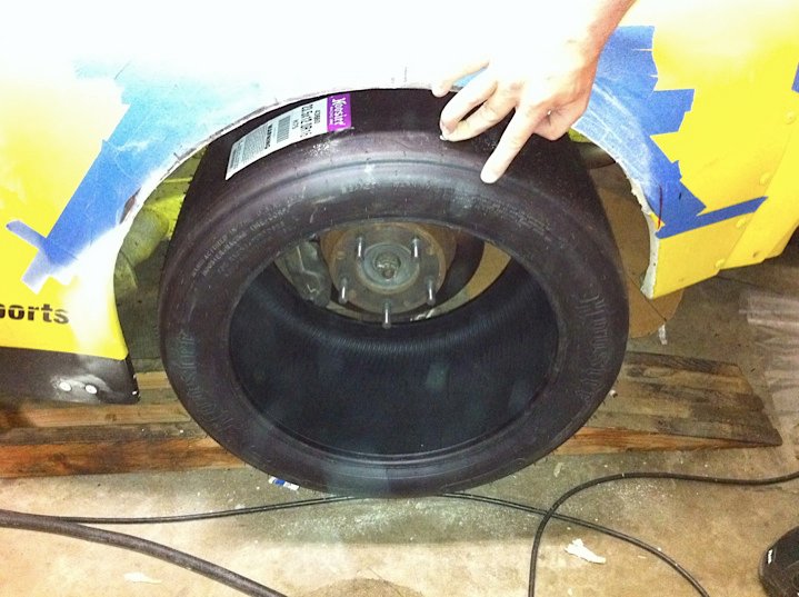

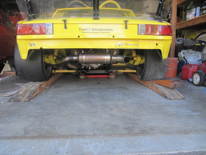

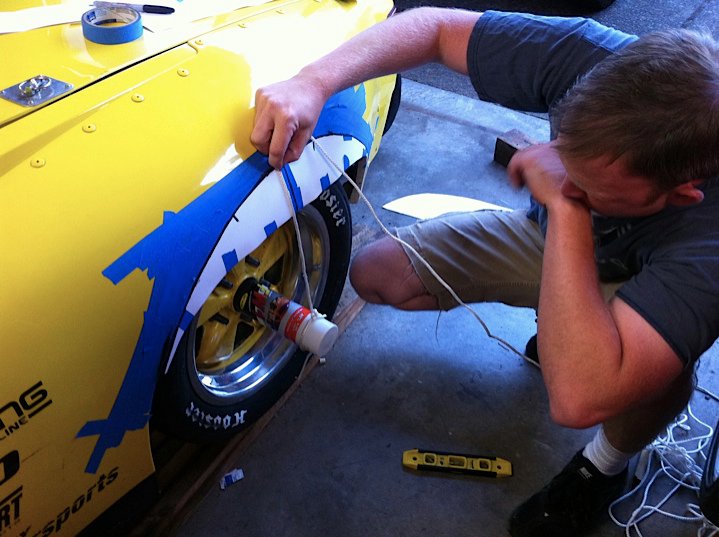

Now I was able to mount them to the car and see exactly how far they were going to extend past the fenders.
(IMG:http://www.914world.com/bbs2/uploads_offsite/a1.sphotos.ak.fbcdn.net-364-1313821970.3.jpg)

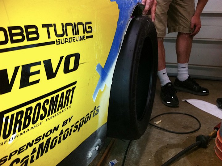

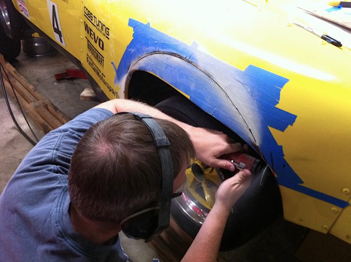

For the fender profile, I decided to follow the profile of the tire instead of maintaining the fender profile. Here is my quick and dirty wheel profiling tool.
(IMG:http://www.914world.com/bbs2/uploads_offsite/a3.sphotos.ak.fbcdn.net-364-1313821971.4.jpg)
The first cut was actually the hardest part. This isn't the best picture of the procedure that I used because I actually created a pattern out of hardboard as a reference while I cut.
(IMG:http://www.914world.com/bbs2/uploads_offsite/a3.sphotos.ak.fbcdn.net-364-1313821971.5.jpg)
Here is the approximate location of the rear tire, there is about 2" or clearance all around.
(IMG:http://www.914world.com/bbs2/uploads_offsite/a2.sphotos.ak.fbcdn.net-364-1313821971.6.jpg)
The 12" tires extend out about 1.5", hence the reason to cut the rear fenders.
(IMG:http://www.914world.com/bbs2/uploads_offsite/a4.sphotos.ak.fbcdn.net-364-1313821971.7.jpg)

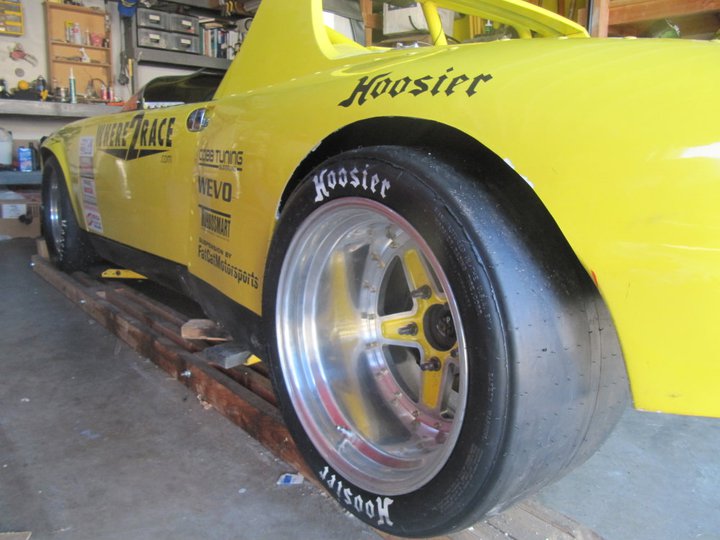

The next day I was able to finally get the new tires mounted. They look awesome.
(IMG:http://www.914world.com/bbs2/uploads_offsite/a4.sphotos.ak.fbcdn.net-364-1313822400.1.jpg)
With them mounted on the car, you can compare the size of the 12" to the older 10" wheel.
(IMG:http://www.914world.com/bbs2/uploads_offsite/a2.sphotos.ak.fbcdn.net-364-1313822400.2.jpg)
Check out the "dish"
(IMG:http://www.914world.com/bbs2/uploads_offsite/a8.sphotos.ak.fbcdn.net-364-1313822400.3.jpg)

Holy crapola that is alot of wheel & tire back there. Your a skinny dude but you sure have a fat ass (IMG:style_emoticons/default/evilgrin.gif) . Seriously though those really are wide. Hopefully it will help with your rear end issues. At least until the suspension fixes for next year. I look forward to the packwood pics & to hear how it feels with this new setup (IMG:style_emoticons/default/driving.gif)

Thanks guys...new set-up feels great. Just gotta drive it harder with the extra grip.

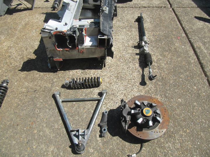

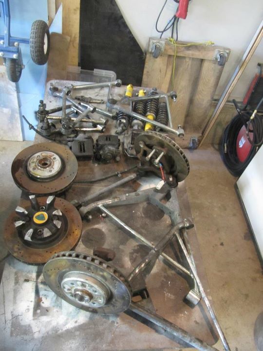

Now...we must move on and further the development of the car. One thing that was pretty obvious at Nationals is that the 40+ year old Porsche suspension has some serious shortcomings when compared to modern cars. Therefore, I have decided to go down the path of converting the chassis to a double a-arm set-up and I am starting with Lotus components.

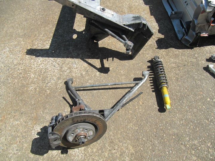

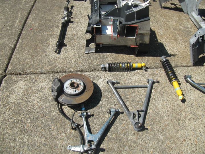

Just before I left for Nationals, I was able to locate a wrecked Lotus in Utah and it worked out perfectly to swing by on the way back from Lincoln.
I was able to get the front and rear suspension parts from. I was also able to source the both subframes. The rear unbolts from the car and the front required a little sawzall action.

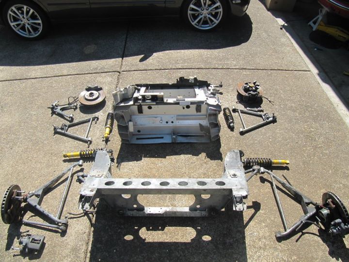

(IMG:http://www.914world.com/bbs2/uploads_offsite/a4.sphotos.ak.fbcdn.net-364-1315419236.1.jpg)
Here are all the components I sourced from the wrecked Lotus. The passenger front upper control arm and the passenger rear lower control arms are bent and new ones will need to be sourced.
(IMG:http://www.914world.com/bbs2/uploads_offsite/a8.sphotos.ak.fbcdn.net-364-1315419237.2.jpg)
Passenger rear components. This arm is actually bent and will be replaced
(IMG:http://www.914world.com/bbs2/uploads_offsite/a2.sphotos.ak.fbcdn.net-364-1315419237.3.jpg)
Front passenger components. Everything check out here...still need to get the proper 14mm star bit to remove the broken wheel center from the hub. Check out the broken shock.
(IMG:http://www.914world.com/bbs2/uploads_offsite/a5.sphotos.ak.fbcdn.net-364-1315419237.4.jpg)
Front driver side components. Everything here checked out fine.
(IMG:http://www.914world.com/bbs2/uploads_offsite/a7.sphotos.ak.fbcdn.net-364-1315419237.5.jpg)
Driver side rear...all good here as well.
(IMG:http://www.914world.com/bbs2/uploads_offsite/a1.sphotos.ak.fbcdn.net-364-1315419237.6.jpg)

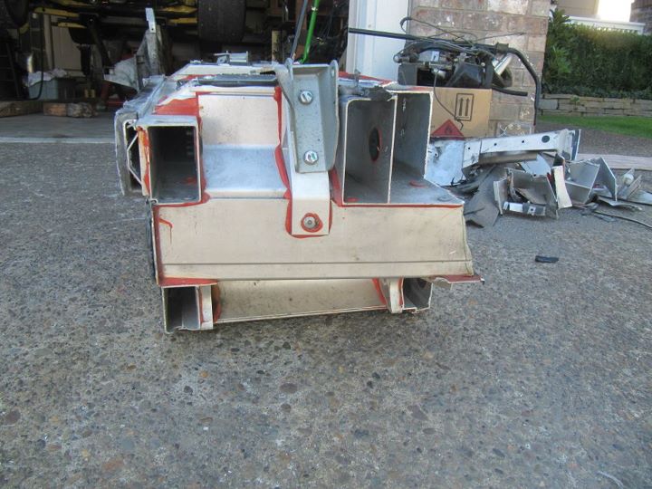

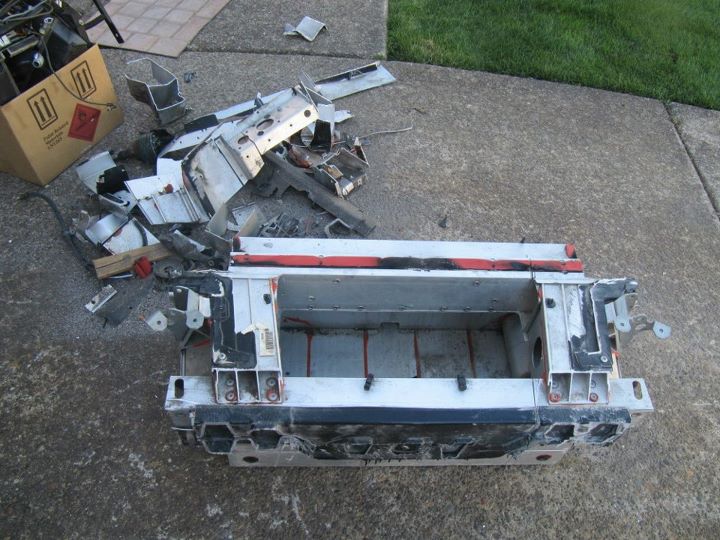

This is the front subframe assembly after about 3 hours of trimming with the combination plasma cutter, sawzall, cut-off wheel. That is the scrap pile in the back I must say that Lotus engineers did a great job in packaging on these cars. All the pick-up points appears to be intact and should be good for mock-up.
(IMG:http://www.914world.com/bbs2/uploads_offsite/a2.sphotos.ak.fbcdn.net-364-1315419237.7.jpg)
All excess material trimmed around each suspension pick-up point in order to aid in bolting and unbolting the components during mock-up.
(IMG:http://www.914world.com/bbs2/uploads_offsite/a8.sphotos.ak.fbcdn.net-364-1315419237.8.jpg)
All the components cleaned up and laid out. Having a little issue removing the rusted bolts holding the rotors on the hubs, I will tackle that again later.
(IMG:http://www.914world.com/bbs2/uploads_offsite/a1.sphotos.ak.fbcdn.net-364-1315419238.9.jpg)
This project will start off a little slower than my engine conversion because I have lot of measuring and mocking up to do. In addition, the car will attend a few more local events before getting torn apart for the winter.

Do you intend to use the front bulkhead assembly from the Lotus? If so, how do you intend to attach it to the 914 tub?
