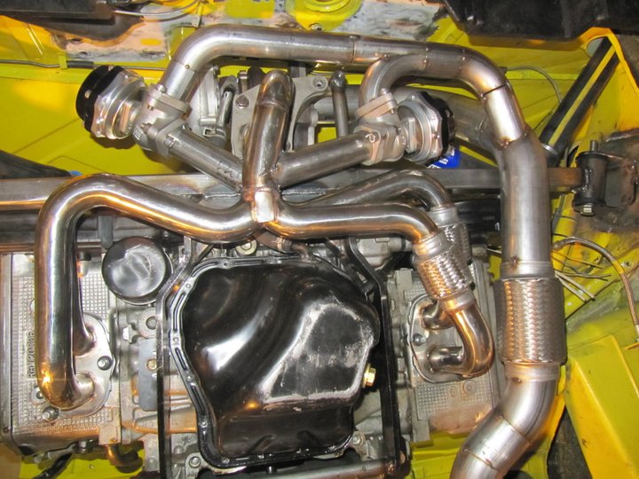

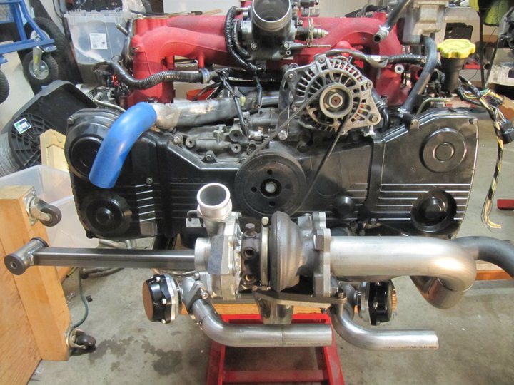

Few updates. Took a few days off work to make some progress before the holiday season gets underway. I also got a lot of parts in and I couldn't wait to get them mounted.
First off was to mount the pair of Turbosmart wastegates and finish the exhaust plumbing. Here you can see the general location of all the components.
(IMG:http://www.914world.com/bbs2/uploads_offsite/sphotos.ak.fbcdn.net-364-1292012081.1.jpg)
Both wastegates will dump back into the exhaust stream so that I can control the output noise levels due to sound restrictions at some venues. Both wastegate dumps are 1.5" and then merge into 1.75" before being dumped into the exhaust. After several hours of fab work with a "metal master" buddy of mine, it was all completed. Just have to get it professionally tig welded to call it done.
(IMG:http://www.914world.com/bbs2/uploads_offsite/sphotos.ak.fbcdn.net-364-1292012083.2.jpg)
(IMG:http://www.914world.com/bbs2/uploads_offsite/sphotos.ak.fbcdn.net-364-1292012083.3.jpg)

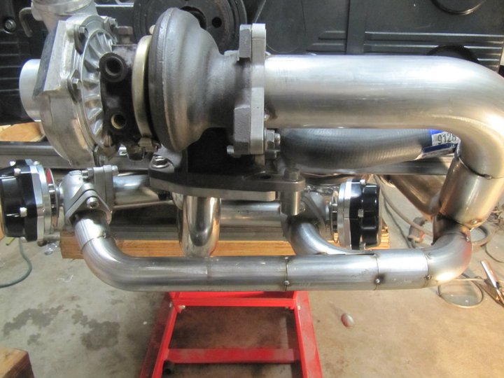

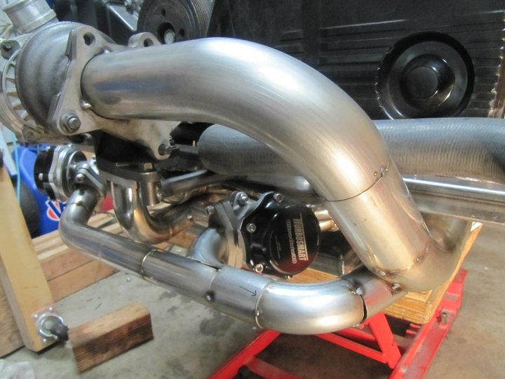

Here it is mounted in the car to ensure that everything clears and fits in its respective location.
(IMG:http://www.914world.com/bbs2/uploads_offsite/sphotos.ak.fbcdn.net-364-1292012084.4.jpg)

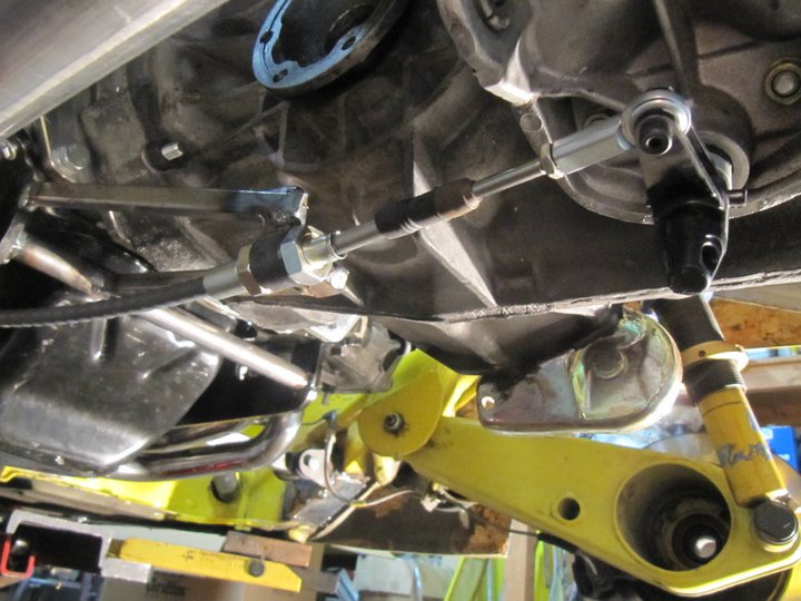

The location of the turbo and the mess of the header and exhaust plumbing has made it impossible to run the stock shifter bar. Therefore, I have adapted parts of a cable shift set-up to handle the shifted duties. If you remember, I only have 2 gears in my transmission and therefore only need to shift forward and back...pretty simple. Here is the transmission side.

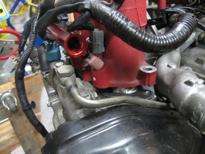

Because this engine is "special" and has the TGV delete manifold, the Aeromotive fuel rails interfer with the AVSC solenoids (blue plug).
(IMG:http://www.914world.com/bbs2/uploads_offsite/sphotos.ak.fbcdn.net-364-1292012110.1.jpg)

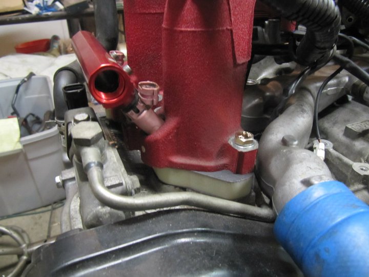

However, by spacing the intake manifold up ~16mm I was able to clear the plug. I order a set of 16mm phenolic spacers from KSTech and everything clears like it should.
(IMG:http://www.914world.com/bbs2/uploads_offsite/sphotos.ak.fbcdn.net-364-1292012111.2.jpg)

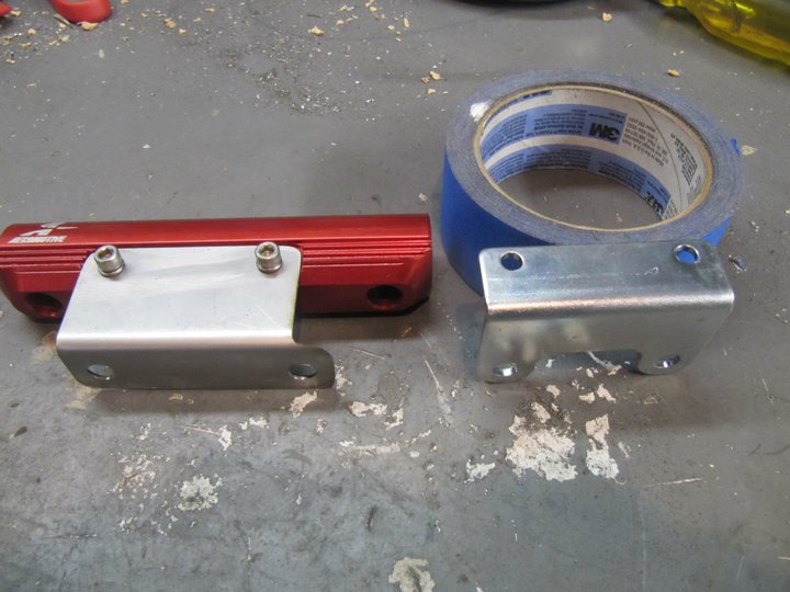

The second problem with the Aeromotive fuel rails are the mounting brackets. Again, because they are supposed to be mounted to a TGV they don't fit my Spec-C manifold. Therefore I had to fab up a pair of brackets to secure them. Here you can see the difference between the new brackets and the ones that came with the kit.

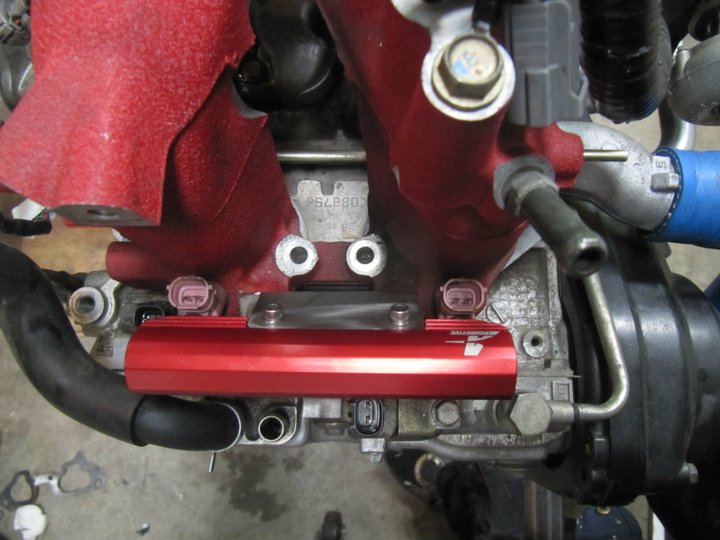

(IMG:http://www.914world.com/bbs2/uploads_offsite/sphotos.ak.fbcdn.net-364-1292012111.3.jpg)
Here they are on the engine...all good.
(IMG:http://www.914world.com/bbs2/uploads_offsite/sphotos.ak.fbcdn.net-364-1292012111.4.jpg)

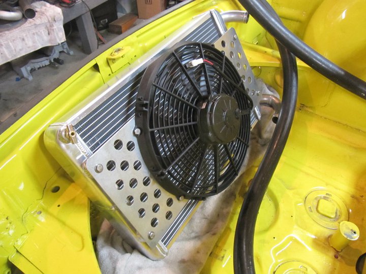

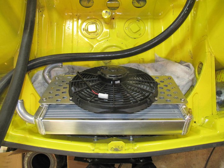

I usually don't like to show new parts until they are installed, but I had to show off the custom Griffen radiator I got in yesterday. It is going to fit perfectly.
(IMG:http://www.914world.com/bbs2/uploads_offsite/sphotos.ak.fbcdn.net-364-1292012135.1.jpg)
(IMG:http://www.914world.com/bbs2/uploads_offsite/sphotos.ak.fbcdn.net-364-1292012136.2.jpg)

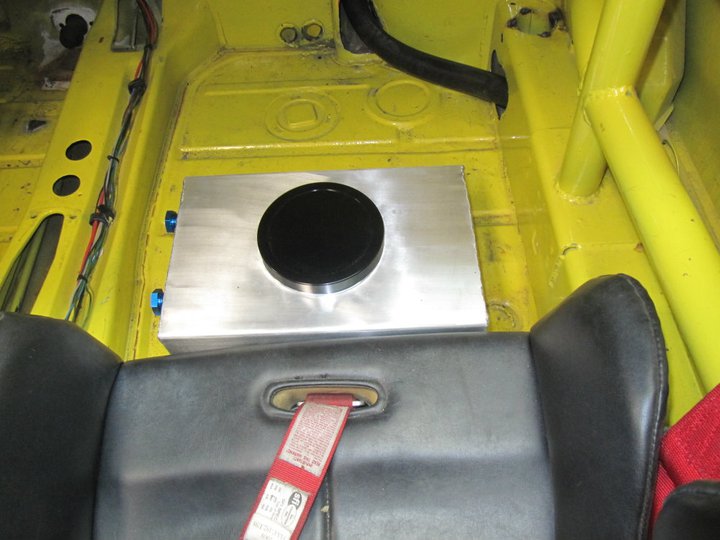

I also got in the ice box from Frozenboost.com. If you get to take a ride, this will be between your legs. Maybe I can hook up a "cool" suit for that hot days...hmmmm.

Looks great! Interesting how everybody has a slightly different take and process on fitting the Subaru engine. That header is wild!
How did you go about spec.-ing the radiator with Griffin? I notice it has unusually narrow end tanks - I guess to provide more core room? Did you make a model and sent them, or just sketches? I'll be going through the same process soon.
Jeff
