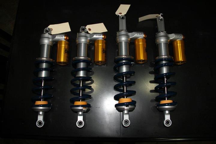

Now the exciting bits.
Got the custom set of Olhin shocks.
(IMG:http://www.914world.com/bbs2/uploads_offsite/sphotos.xx.fbcdn.net-364-1333579353.1.jpg)

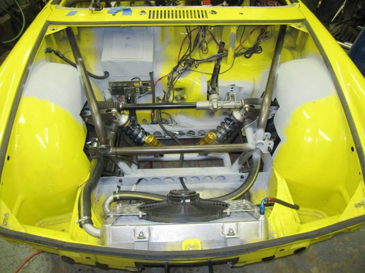

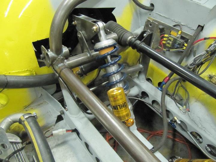

Front shocks installed on the inboard rockers.
(IMG:http://www.914world.com/bbs2/uploads_offsite/sphotos.xx.fbcdn.net-364-1333579353.2.jpg)
Close-up view of the front shocks installed.
(IMG:http://www.914world.com/bbs2/uploads_offsite/sphotos.xx.fbcdn.net-364-1333579354.3.jpg)

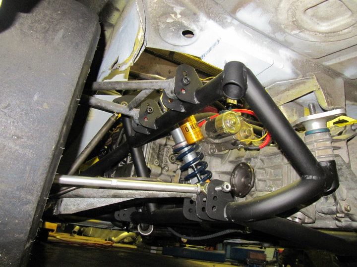

View from below of the rear shock and suspension.

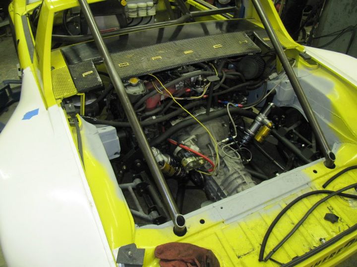

(IMG:http://www.914world.com/bbs2/uploads_offsite/a4.sphotos.ak.fbcdn.net-364-1333579354.4.jpg)

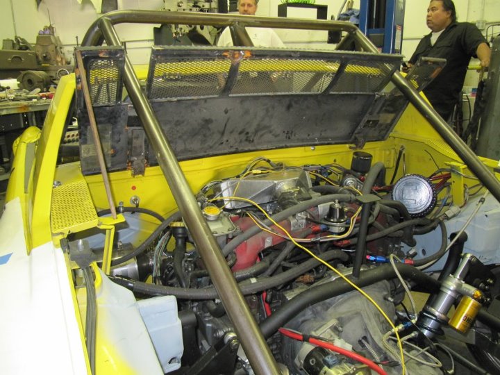

Clearance the rear trunk lid for the new cage bars. The holes are not as bad as I thought they would be.
(IMG:http://www.914world.com/bbs2/uploads_offsite/sphotos.xx.fbcdn.net-364-1333579354.5.jpg)

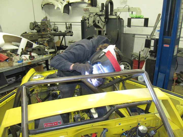

Master Welder Evan working his magic on the last few cage bars. As of now, all the major welding is completed.
(IMG:http://www.914world.com/bbs2/uploads_offsite/sphotos.xx.fbcdn.net-364-1333579355.6.jpg)

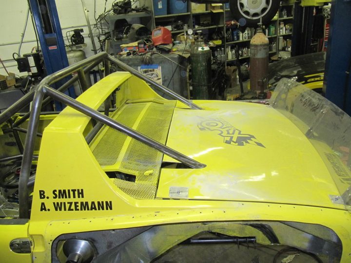

Due to the new position of the cage I had to find and modify another engine lid to clear the bars.
(IMG:http://www.914world.com/bbs2/uploads_offsite/a1.sphotos.ak.fbcdn.net-364-1333579355.7.jpg)
View of the modified engine lid in the up position.
(IMG:http://www.914world.com/bbs2/uploads_offsite/sphotos.xx.fbcdn.net-364-1333579355.8.jpg)

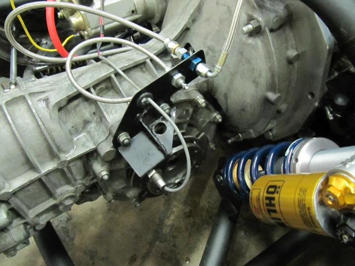

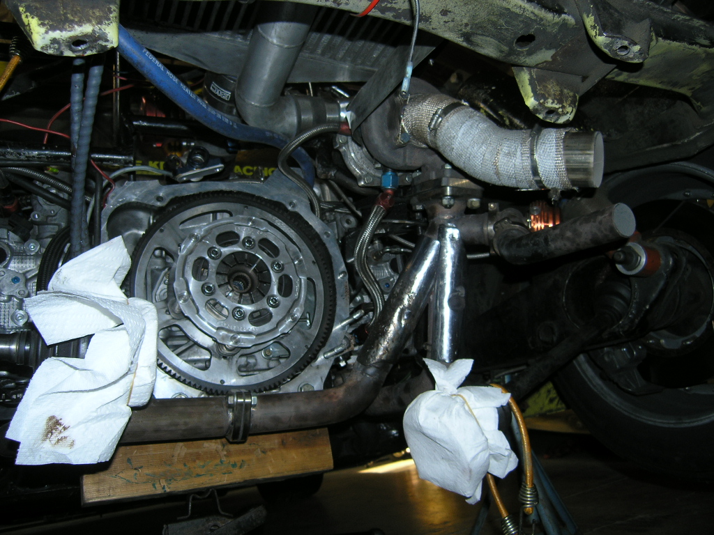

I previously mounted the vehicle speed sensor to the outside of the inboard CV, however this interfered with the springs. Therefore I had to weld it to the inside of the transmission output shaft and reverse the sensor mounting. Also added a mount for the hydraulic clutch lines.
(IMG:http://www.914world.com/bbs2/uploads_offsite/sphotos.xx.fbcdn.net-364-1333579355.9.jpg)

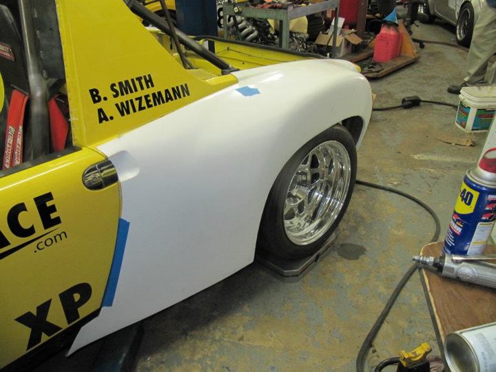

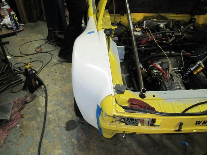

New GT Racing rear flares installed. Might need some slight modification, but at least they clear the wide wheels.
(IMG:http://www.914world.com/bbs2/uploads_offsite/sphotos.xx.fbcdn.net-364-1333579457.1.jpg)

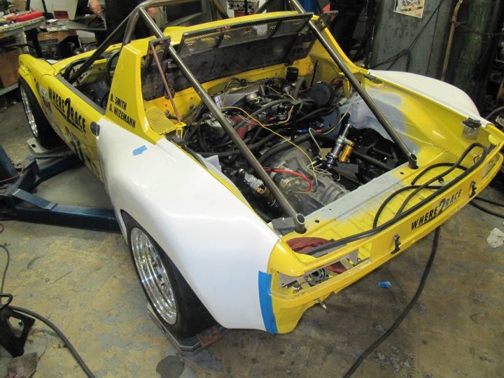

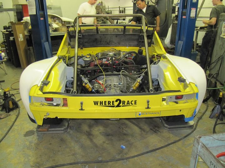

Back view of the car with the rear flares installed.
(IMG:http://www.914world.com/bbs2/uploads_offsite/sphotos.xx.fbcdn.net-364-1333579457.2.jpg)

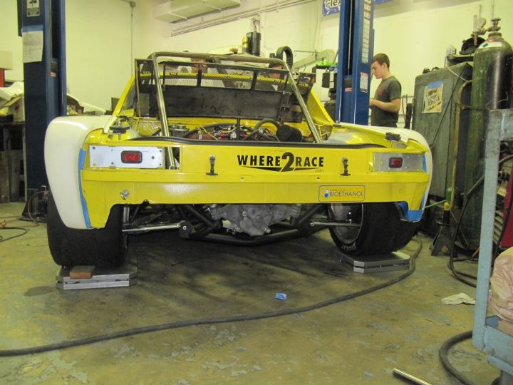

Good lower view.
(IMG:http://www.914world.com/bbs2/uploads_offsite/sphotos.xx.fbcdn.net-364-1333579458.4.jpg)

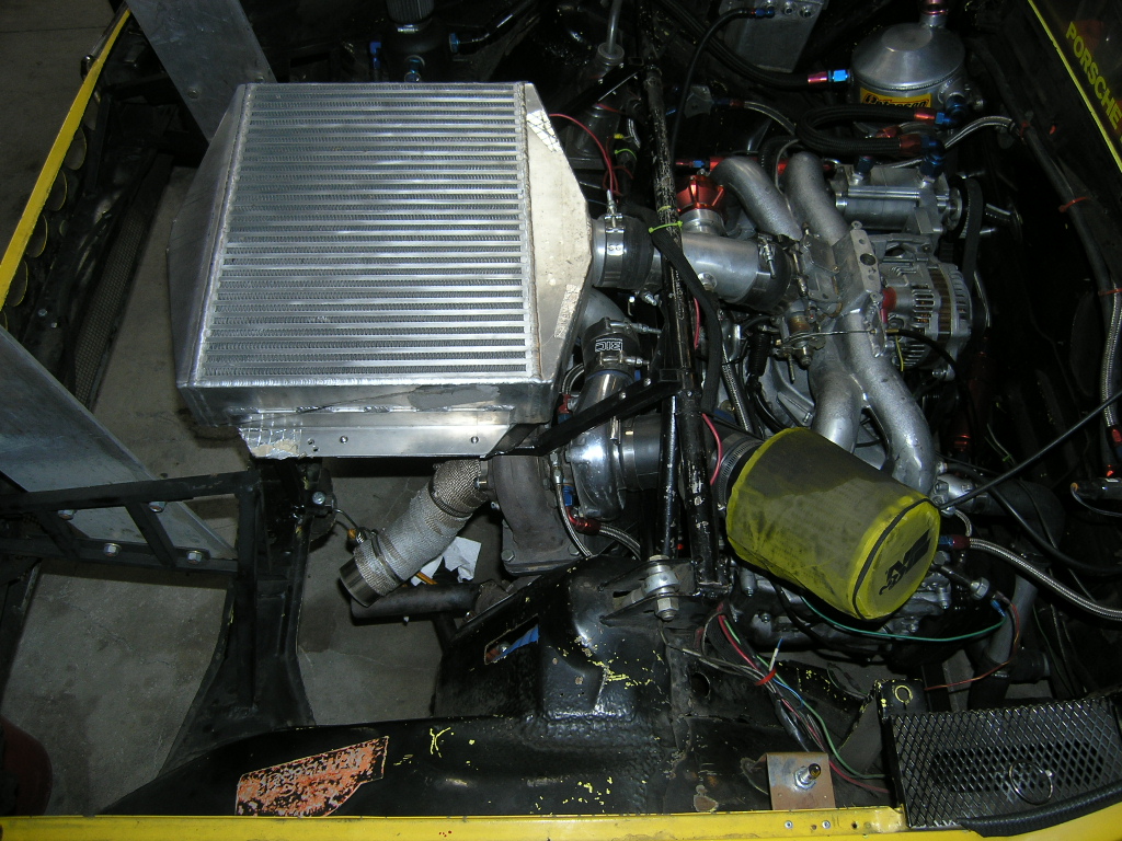

I run an Air/Water intercooler right on top of the motor....very efficient.
As for the muffler, I need to ensure that I hit 93db at 50ft in San Diego. Remember, my motor spins to 8500rpm and is a bit louder than the US Spec engines.

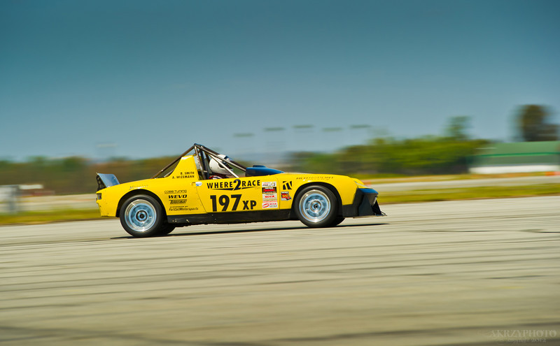

She is alive!
I didn't get to drive it yet, but the car successfully made it through a set of shake down runs at El Toro this past weekend. Still needs proper bodywork, ride height lowered, sway bar, new tires, proper brake pads, cage painted, replacement ball joint, and some spring changes...but it is getting closer.
(IMG:http://www.914world.com/bbs2/uploads_offsite/akrzyphoto.smugmug.com-364-1334601310.1.jpg)
-Britain
