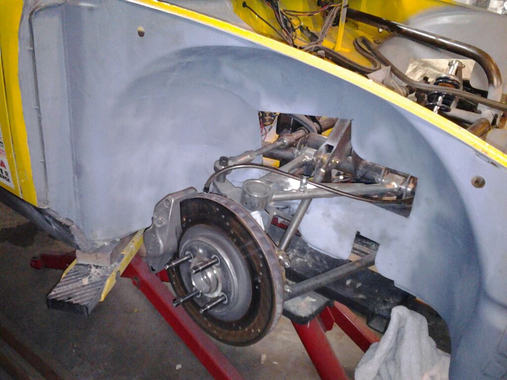

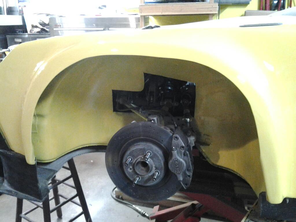

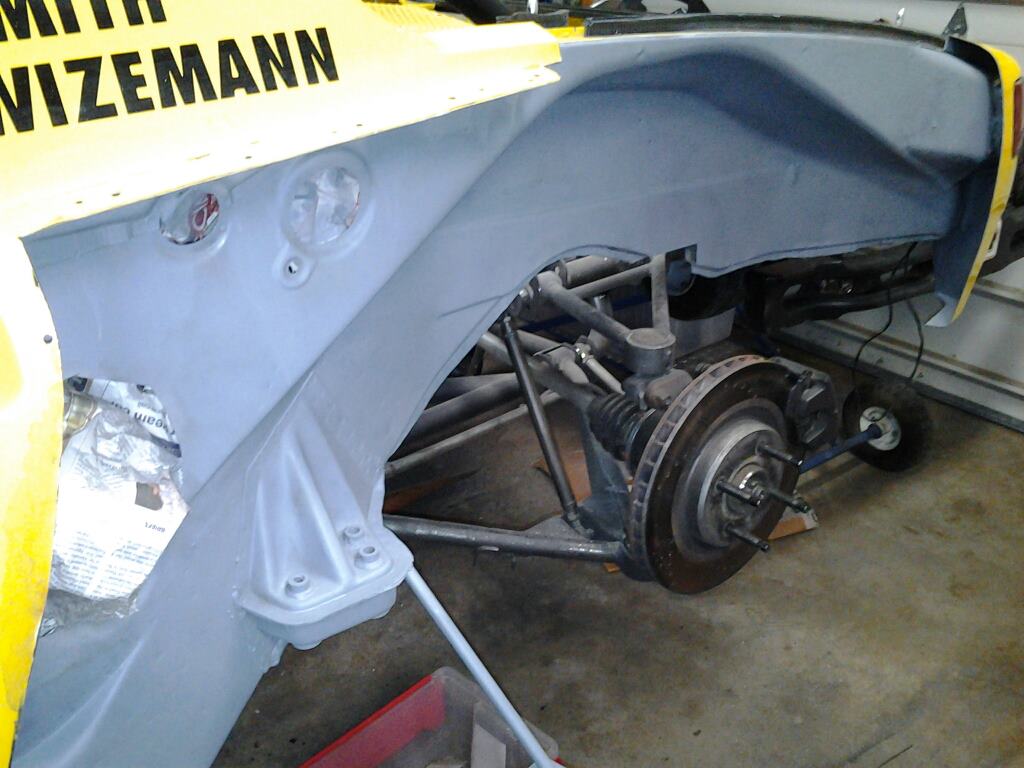

First, I decided to strip the multiple years of undercoating, grims, etc. out of the fender wells. A quick coat of primer and they look much better.
(IMG:http://www.914world.com/bbs2/uploads_offsite/sphotos-b.xx.fbcdn.net-364-1360881470.1.jpg)
Rear fender well stripped and primed. Gotta add another fender support that will go out horizontally just before the wheel opening. I hit a few cones this last season and actually cracked both rear fenders.
(IMG:http://www.914world.com/bbs2/uploads_offsite/sphotos-b.xx.fbcdn.net-364-1360881470.2.jpg)

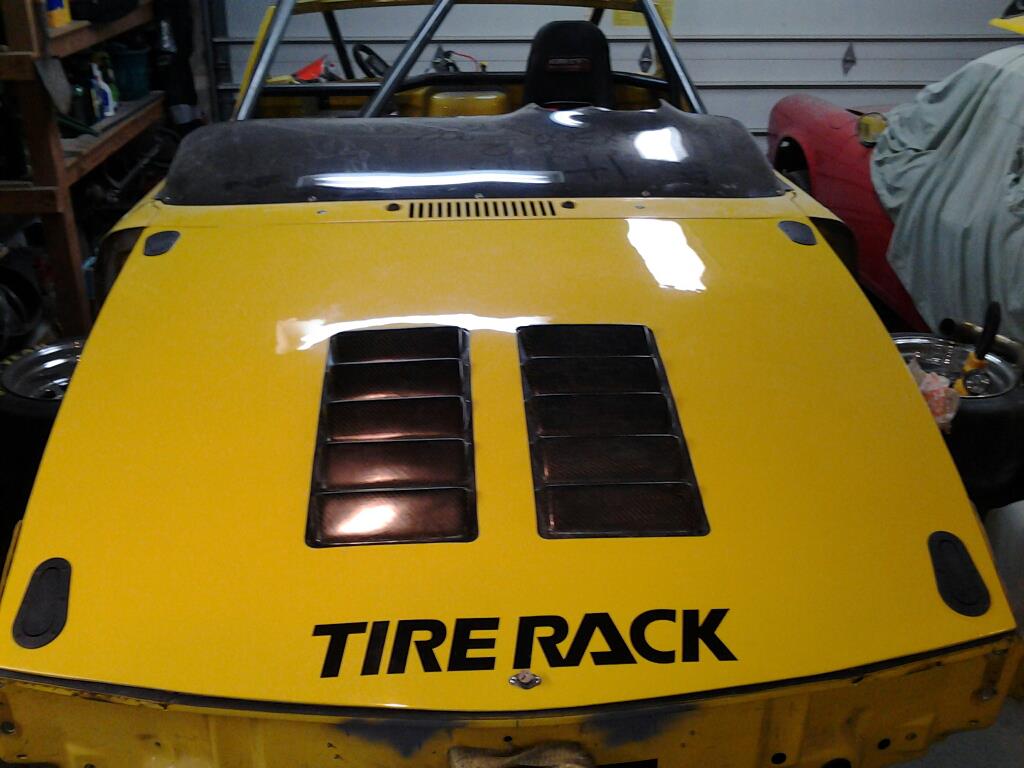

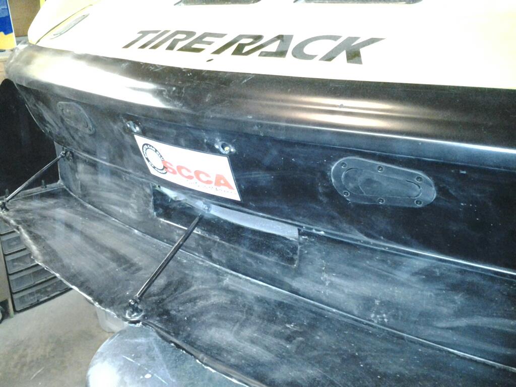

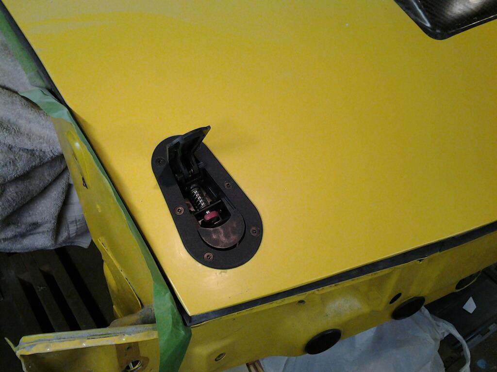

hated the duez fasteners that were holding the front hood on so today I replaced the outside four with Aerocatches. I had to redo all the mounting brackets and cut holes in my carbon hood, but overall weren't too bad to install. They are very nice parts, pricey, but nice.
(IMG:http://www.914world.com/bbs2/uploads_offsite/sphotos-b.ak.fbcdn.net-364-1360881470.3.jpg)
(IMG:http://www.914world.com/bbs2/uploads_offsite/sphotos-a.xx.fbcdn.net-364-1360881471.4.jpg)
Aerocatches on the front bumper. I will fill the old DZUS holes and clean all that up.
(IMG:http://www.914world.com/bbs2/uploads_offsite/sphotos-a.xx.fbcdn.net-364-1360881471.5.jpg)

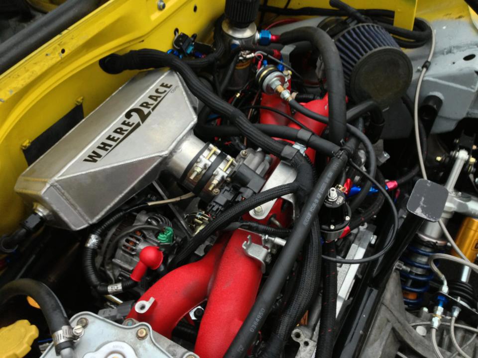

Degreased and powerwashed the engine today. The JDM intake manifold looks so much better with the engine clean.
(IMG:http://www.914world.com/bbs2/uploads_offsite/sphotos-b.xx.fbcdn.net-364-1360881471.8.jpg)
That is a lot of yellow. The car is all cleaned up and ready to hit the dyno next week for a retune.

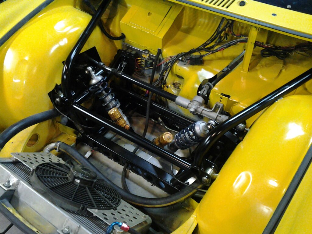

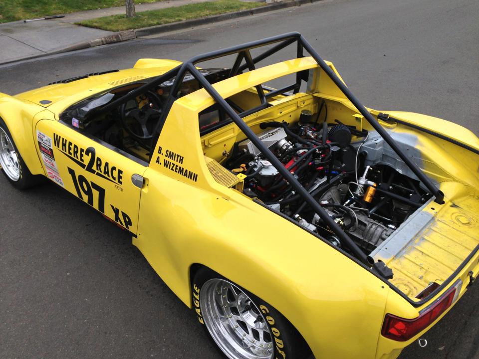

Well, if I can't make it go faster, I might as well make it pretty. Painted the cage in the front and sprayed some yellow on sheetmetal.

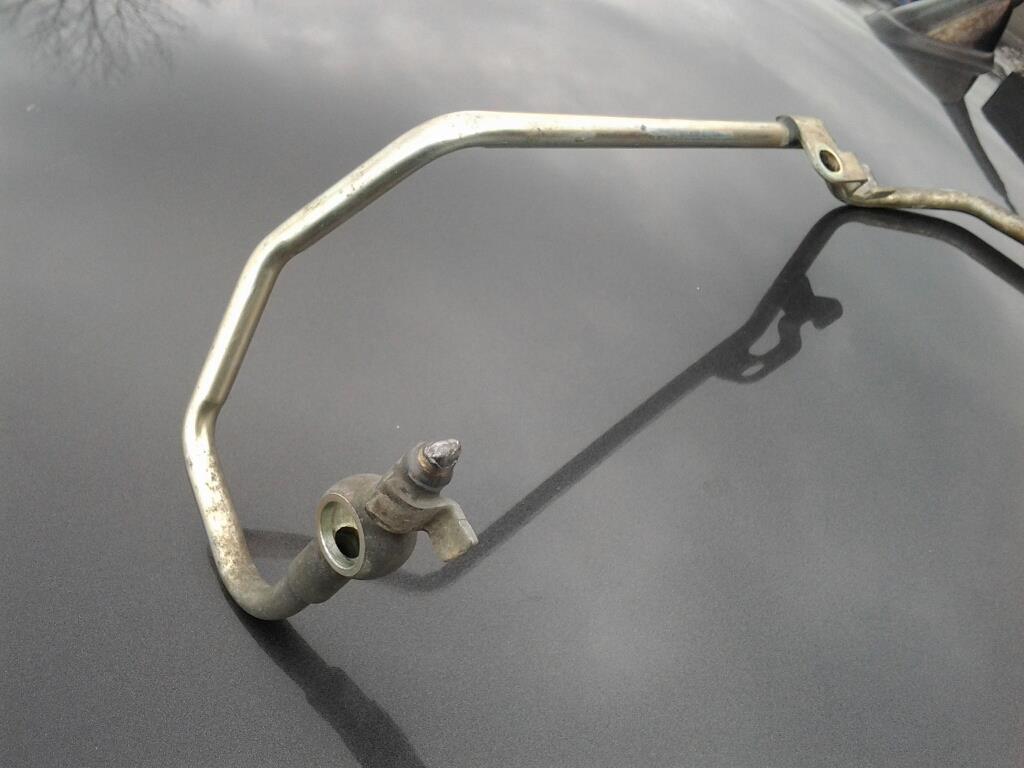

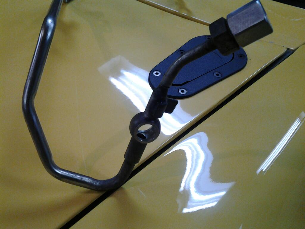

Then...Murphy's Law strikes again!! Getting the car ready for a dyno session on Thursday so I took a few laps around the block only to find oil squirting off the back of the motor. See the hairline crack just above the banjo fitting. This is the AVSC line on my engine.
(IMG:http://www.914world.com/bbs2/uploads_offsite/sphotos-b.xx.fbcdn.net-364-1361337126.2.jpg)

Oil line tig welded shut this morning, now to reinstall tonight and re-bleed the radiator.
(IMG:http://www.914world.com/bbs2/uploads_offsite/sphotos-b.xx.fbcdn.net-364-1361382695.1.jpg)

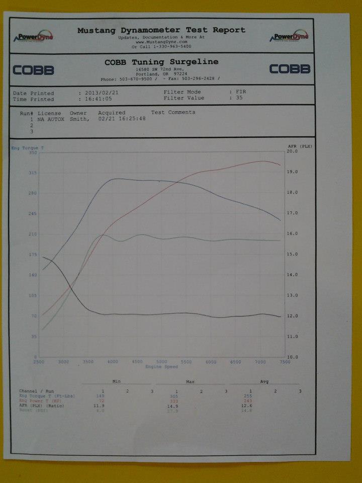

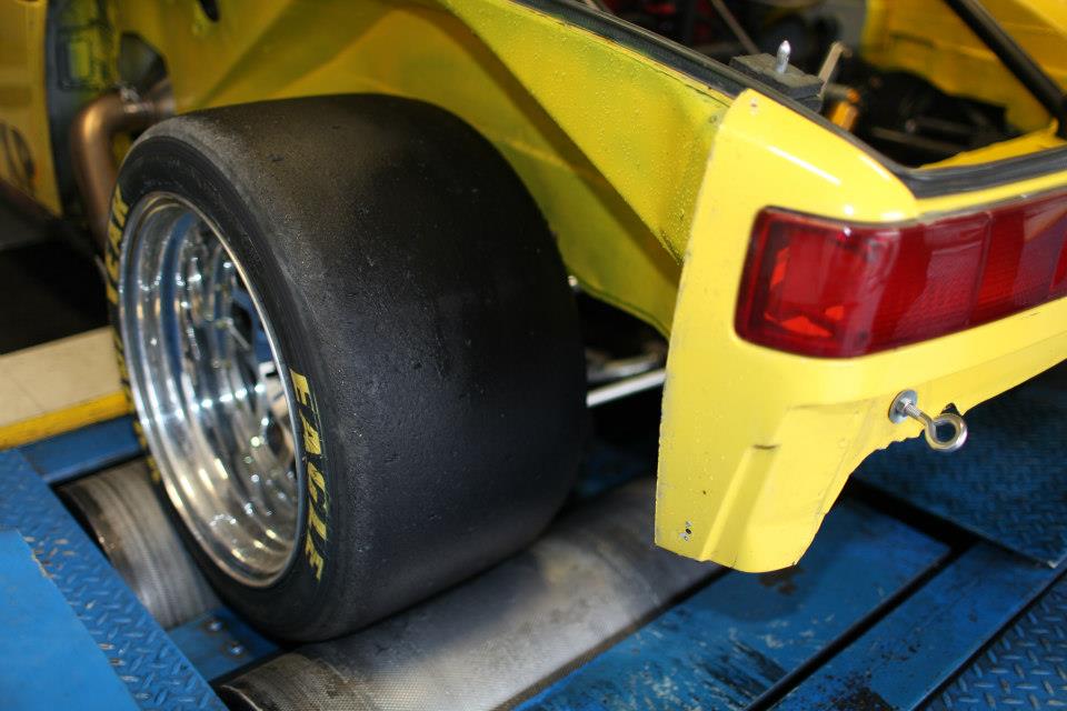

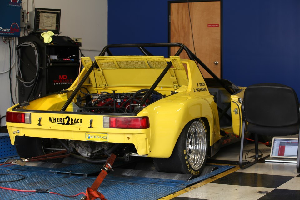

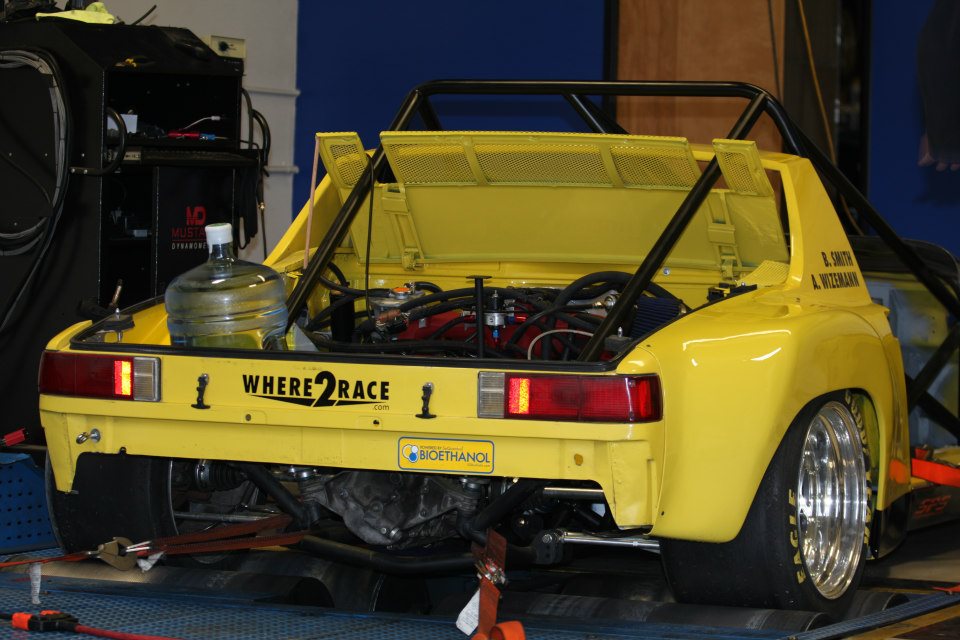

Took the car down to Cobb Tuning Surgeline for Dr. Tim Bailey to work his magic on tuning the car for the new injectors and more boost. Overall the session went great with the engine running well and no major issues.
Here is the car strapped down to the dyno.
(IMG:http://www.914world.com/bbs2/uploads_offsite/sphotos-b.xx.fbcdn.net-364-1361559455.1.jpg)
I had to take off the driver side rear fender in order to get an A/F meter on the exhaust which exits out under the car.
(IMG:http://www.914world.com/bbs2/uploads_offsite/sphotos-a.xx.fbcdn.net-364-1361559455.2.jpg)
At higher power levels we were dealing with significant rear wheel spin. We ended up with 3 jugs of water in the rear truck to put weight over the rear wheels.
(IMG:http://www.914world.com/bbs2/uploads_offsite/sphotos-a.xx.fbcdn.net-364-1361559455.3.jpg)
Here are the final dyno plots. At 18psi, we are making 335whp and 305ft-lbs. This is on a Mustang Dyno which notoriously measures low. Either way, the hp is fairly linear all the way up, we reach full boost pretty quickly, and the torque curve is nice and flat where we want it.
(IMG:http://www.914world.com/bbs2/uploads_offsite/sphotos-b.xx.fbcdn.net-364-1361559455.4.jpg)
I am working on video and will post it soon.
-Britain
