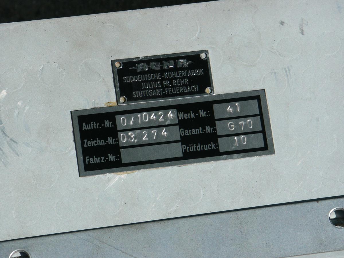

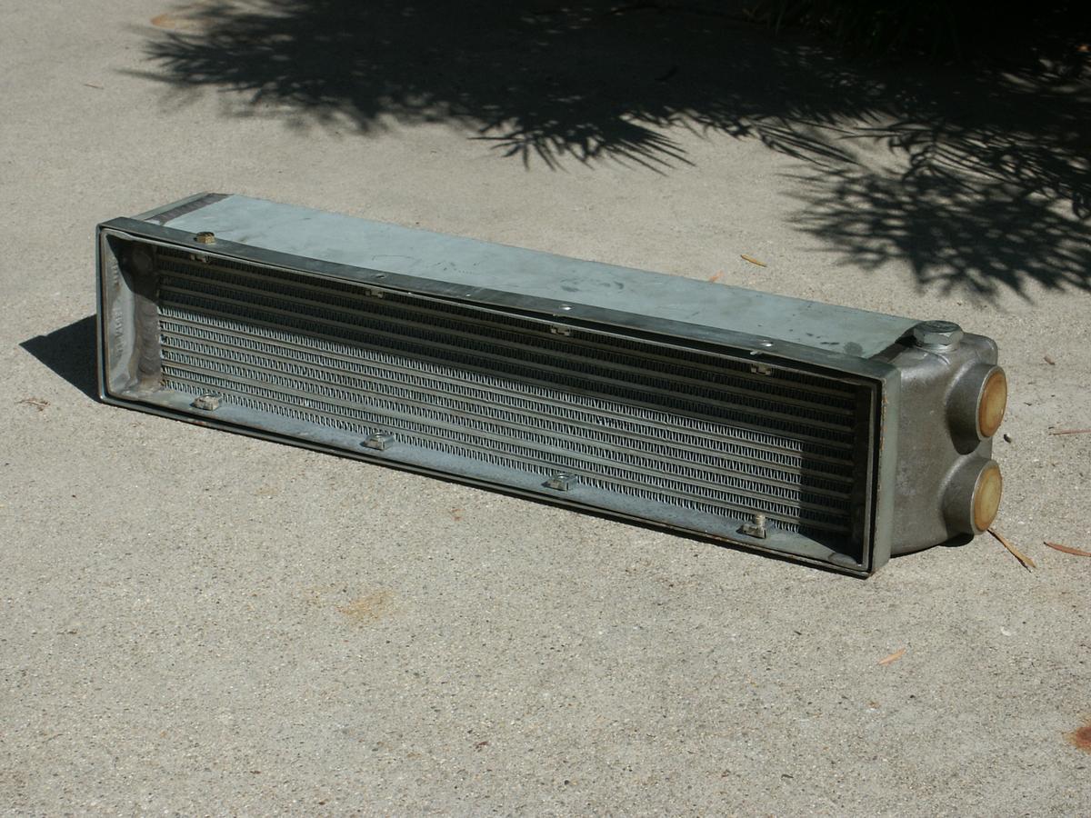

I've come across these two Behr oil coolers on Armando's site. The first is a 1970 914/6 GT and the second is a 1973 RSR. Both are only rated at 10 bar, so I have to think that the pressure relief valves should pop-off below 10 bar, not above. At least for this period. I haven't been able to confirm what the pressure rating was on the 1974 RSR oil coolers which had an in-built pressure relief valve.
Behr 1970 914/6 GT Oil Cooler
Attached ImageAttached Image
Behr 1973 RSR Oil Cooler
