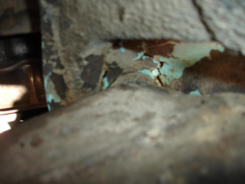

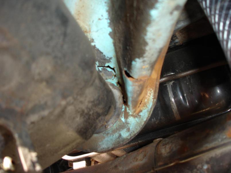

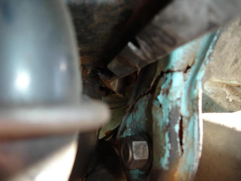

im totaly bummed out about this. after about 50 hours of research and electrical work on my new toy, i found this while hooking up my fuel line.
its really bad. to the point where i dont think its safe to drive the car.... (IMG:style_emoticons/default/headbang.gif)
do you guys think this is something i should try fix this myself and box it in? im not sure my fab skills are up to the task....
or should i leave this one up to the professionals? is there a shop in so cal. that is competent enough to fix this? forgive my noobieness for not knowing any shops around. i'm not out to insult anyone. i just dont want a hack job. i could do that myself. LOL

mrbubblehead   heres another shot.   Dec 27 2010, 02:50 PM
Tom_T   Better check the other side too! <_< I...   Dec 27 2010, 03:00 PM
dr914@autoatlanta.com   don't be bummed! Happens all of the time...   Dec 27 2010, 03:02 PM
SirAndy   its really bad. to the point where i dont think it...   Dec 27 2010, 03:02 PM
mrbubblehead   its really bad. to the point where i dont think i...   Dec 27 2010, 03:15 PM
Joe Sharp   We have a friend in your neighborhood that can hel...   Dec 27 2010, 04:09 PM

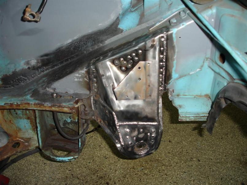

stugray   That looks very familiar: http://www.914world.com...   Dec 27 2010, 04:15 PM
mrbubblehead   wow, im not the only one with this problem. im goi...   Dec 27 2010, 04:22 PM
SirAndy   wow, im not the only one with this problem. im go...   Dec 27 2010, 05:05 PM

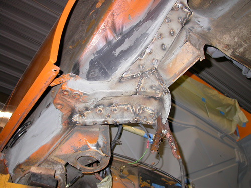

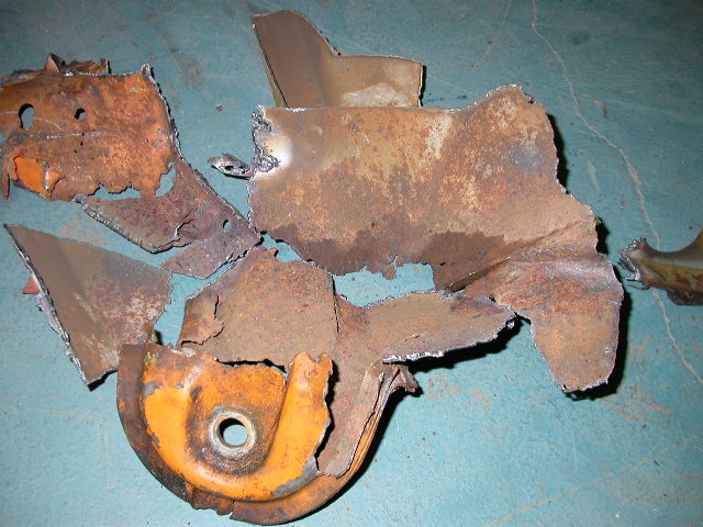

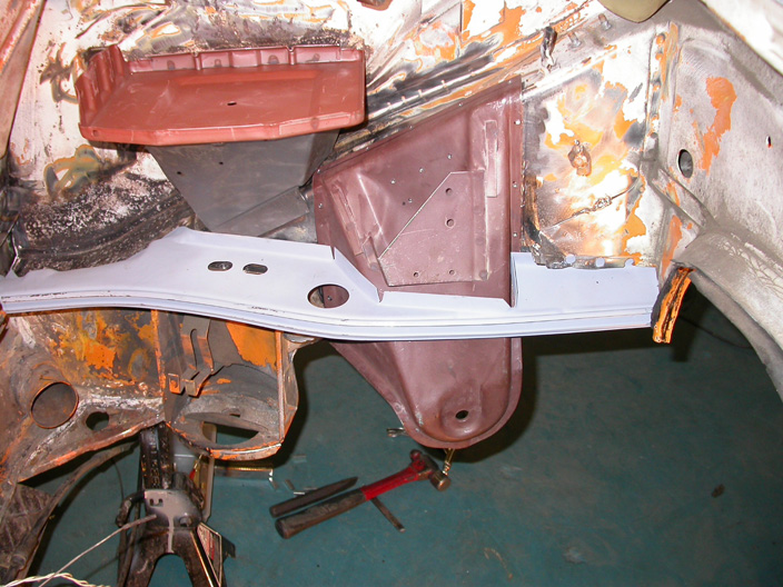

sean_v8_914   I have posted at least 3 of these repairs here and...   Dec 27 2010, 05:41 PM
sean_v8_914   the driver side is not available and must be fabri...   Dec 27 2010, 05:47 PM
sean_v8_914   bvmncgh   Dec 27 2010, 05:55 PM
sean_v8_914   mn,   Dec 27 2010, 05:57 PM
sean_v8_914   whoever welds it up: be sure they passivate the ru...   Dec 27 2010, 05:58 PM
mrbubblehead   thanks alot sean. a picture is worth 1000 words.   Dec 27 2010, 06:10 PM

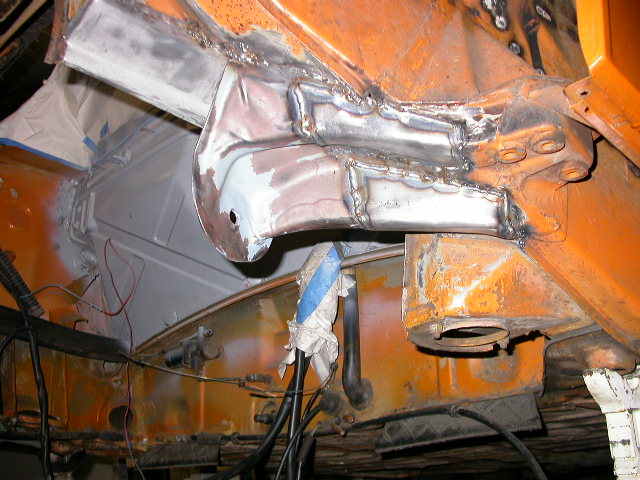

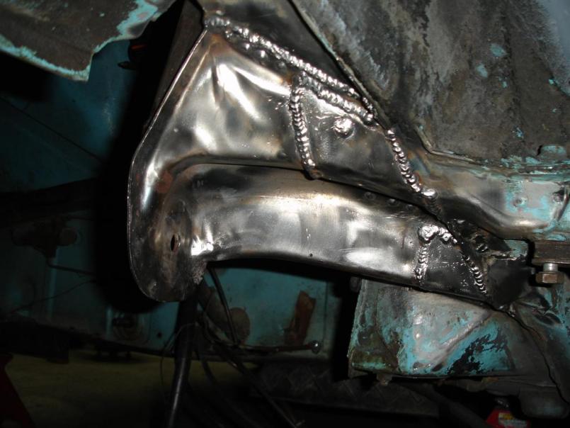

mrbubblehead   well, im doin it fellas. i replaced the rear conso...   Jan 6 2011, 10:38 PM
kg6dxn   Looks great! nice welds! :first:   Jan 6 2011, 10:42 PM
silver74insocal   :trophy: looks pretty damned good to me..keep it u...   Jan 6 2011, 10:46 PM
championgt1   :agree: Looks good!   Jan 6 2011, 10:51 PM
mrbubblehead   thanks. i should be on the road in the next few we...   Jan 6 2011, 11:01 PM
70_914   Hmmm... had thoughts of scrapping my car because o...   Jan 6 2011, 11:54 PM
Joe Sharp   Nice work Doug.   Jan 7 2011, 03:49 AM
mrbubblehead   Nice work Doug. thanks joe. it was a pleasure m...   Jan 7 2011, 08:49 AM
SGB   Dang- wish I could weld like that... Wait until y...   Jan 7 2011, 09:11 AM
sean_v8_914   missing the plate that bridges he two ribs togethe...   Jan 7 2011, 09:52 AM
sean_v8_914   ear to ear is less critical than ear to pin hole i...   Jan 7 2011, 10:00 AM
mrbubblehead   ear to ear is less critical than ear to pin hole ...   Jan 7 2011, 11:49 AM
