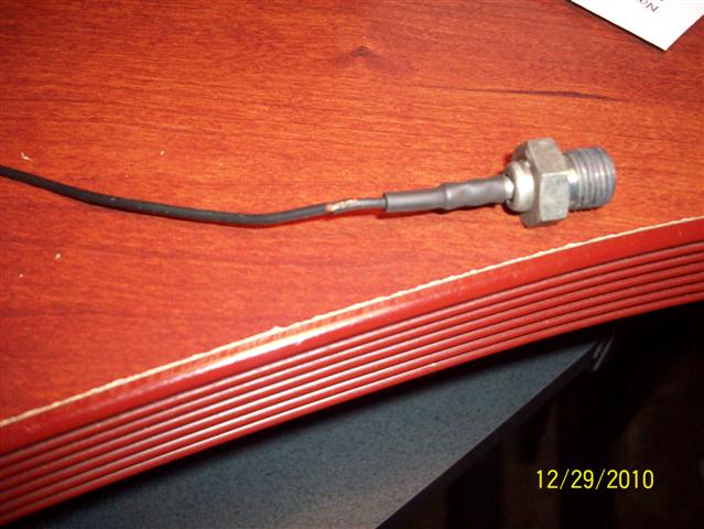

> 022.906.041 A, temperature sensor for cylinder head / CHT
type47
post Dec 31 2010, 11:23 AM
Viermeister
Posts: 4,254
Joined: 7-August 03
From: Vienna, VA
Member No.: 994
PET 117-10 # 36 022 906 041 A temperature sensor for cylinder head M >>GA0 006 765 914-2,0 qty:1
related 311.906.041 A temperature sensor for cylinder head
GA0 006 766>>
EC0 000 001>>
GC0 000 001>>
Tom_T
post Dec 31 2010, 02:26 PM
TMI....
Posts: 8,321
Joined: 19-March 09
From: Orange, CA
Member No.: 10,181
Jim & All -
This is the superseded CHT (Bosch p/n 0-280-130-012) which does not apply to the 73 MY GA000000 > GA006765 (or >>GA006766), but is the p/n still available as of this date at the parts suppliers.
The 73 MY 2.0s use a distinct 0-280-130-017 p/n CHT (now NLA), and won't run right on these -012's, along with some other resistors, etc. that go along with it for 73 MY, in order to match the "tune" of the 73 MY ECU etc.
Readers should refer to the D-jet parts chart for Cylinder Head Temperature Sensor at the link below:
http://members.rennlist.com/pbanders/DjetParts.htm
