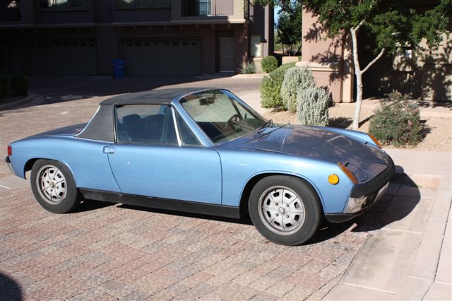

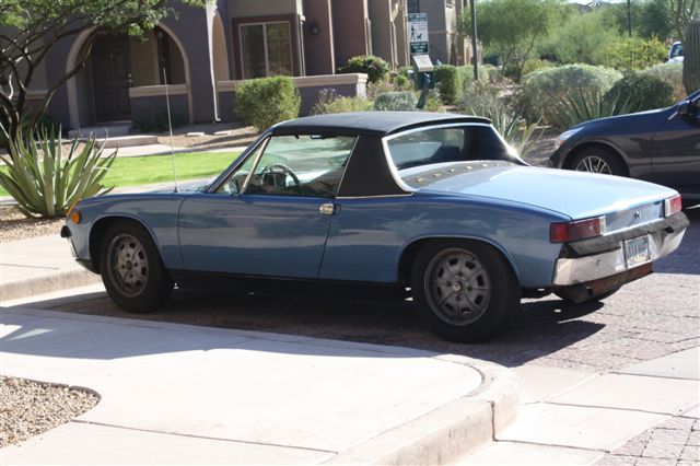

Here is what I am trying to inform you, not low low but stock/lower than what you have now; I had what you have and just paying it foward...
This is bilstien allaround, 2nd from bottom rung on the rear and 1/2"-3/4" lower than the rear in the front... 4 wheel professional laser allighnment (a couple times now..ouch!)- I say ouch so that maybe you do all of your suspension at once and then get a pro allighnment once and save some $$$ If I remember correctly I am approx 5 3/4" off the ground from the rockers.... no bump steer and I can go into driveways and dips without issues or concern realy.. oh the tires are 205/60 not 195/65 so there is thatto consider in the picture, but the wheel wells are definately filled in nicely even with the lower profile tire, if you go /50's than there goes that..

Nice, Same color as my car.

Yeah, it is the factory 'marathon blue', I bought it silver but had it painted back to its factory color.. looks awesome in the sun or in the summer, silver looks better at night and in the winter.. chicks dig the 'marathon blue', i got compliments from mostly 'dudes' when it was silver.. i like chicks,.. just screwing around..
the marathon blue changes shades and depth, very light dependent.. 96m color code.. 74 2.0
