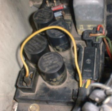

The yellow wire from the dual relay should not be going to the coil if it has the original wiring.... There is a series (3) tests you can do to verify a dual relay works properly. It only requires a 9 volt battery and two leads. Shoot me an email with your email address and I can send you a copy--it's in excel.

See pic:
