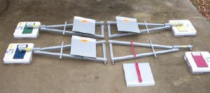

I have a set of 4 scales, arms, balance plates. With one under each wheel. Like the picture above.

The lever arms for the scales do have rollers on them and they roll side to side under the car; with one set of wheels on the ground and the other set on the scales. Do the wheels on the lever arms act as "slider plates" and negate the tire friction?
I'll take pictures next time I have it set up.

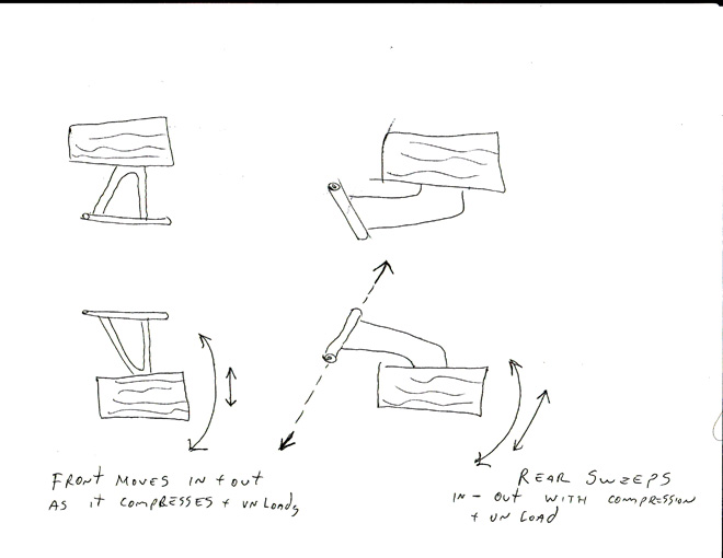

square metal plate about 15 x 15 on top of similar plate with lube in teh middle
one goes under each wheel
wheels on a 914 do not move up and down whlie trackign teh same tire patch

rubber bushings and this sweep conspire against good readings
