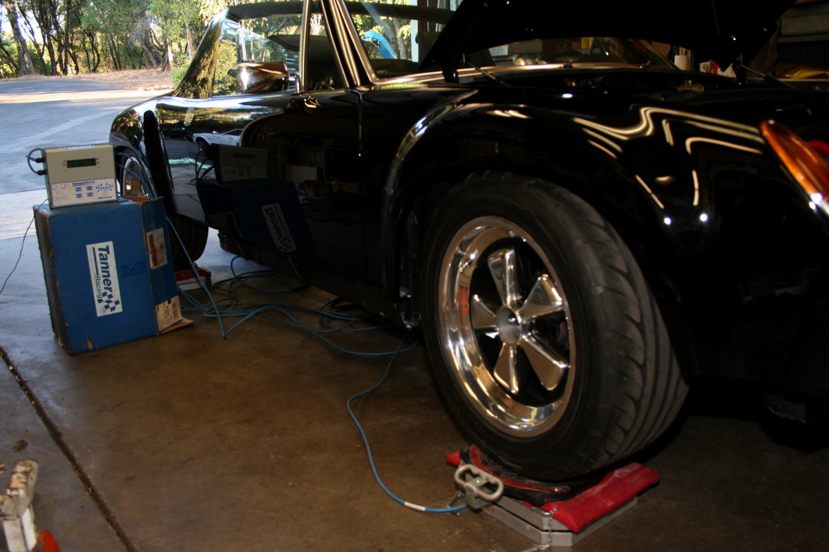

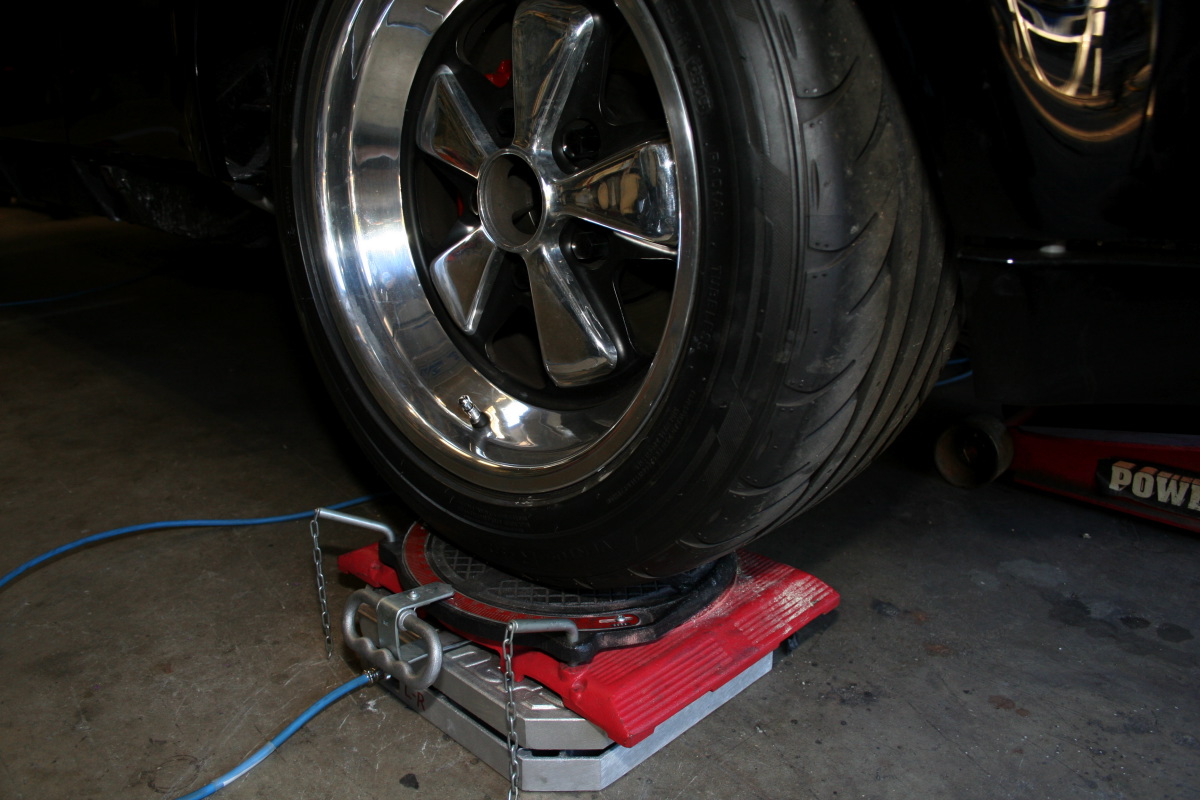

The tires and wheels need to "float" or you have to roll the vehicle after each time it is jacked up. It makes a SIGNIFICANT difference. Note the red device on top of the scales when I corner balanced my car. They are ball bearing plates. With 2 fingers I could push my car around on top of the scales. You can also use grease between 2 pieces of sheet metal under the tire but you risk losing the car off the scales and hurting yourself if not restrained and they don't work as good as the ball bearing plates.
