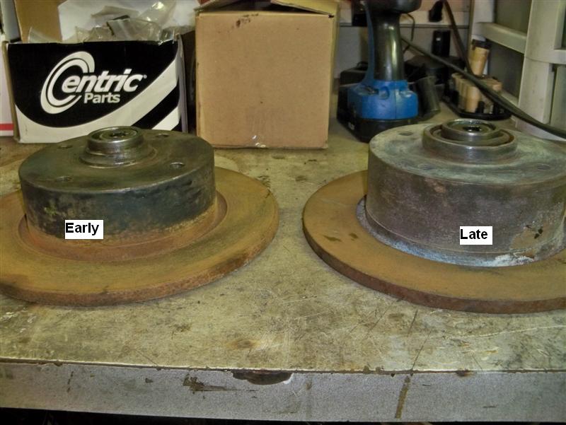

Ok I needed an answer so I pulled out some parts to test fittment (IMG:style_emoticons/default/wacko.gif)

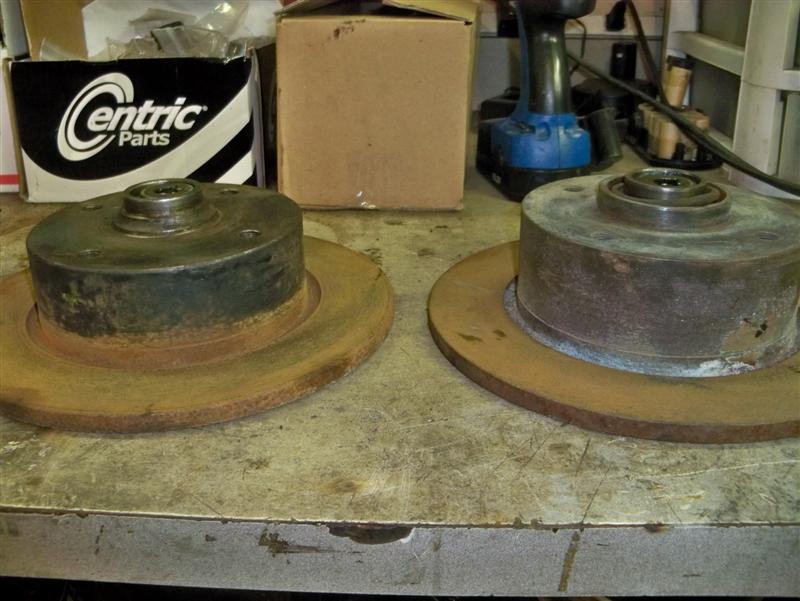

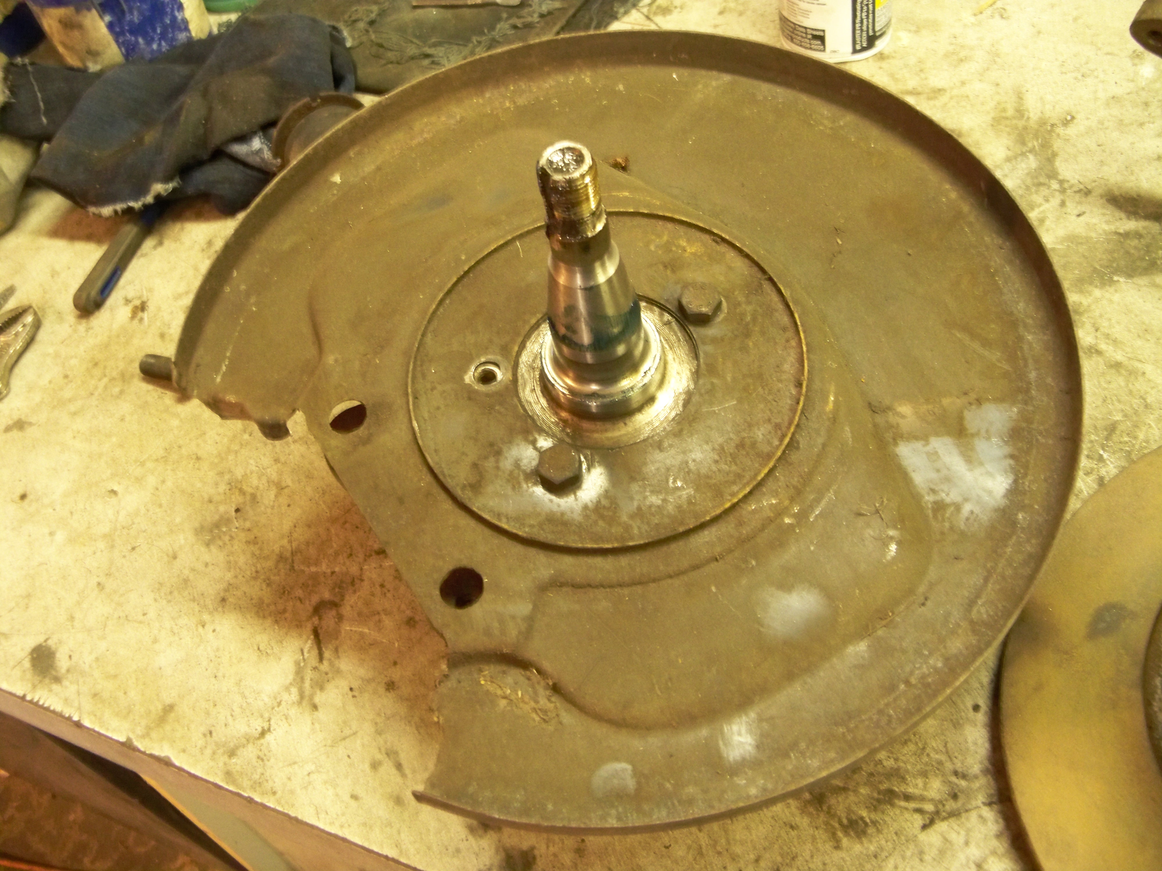

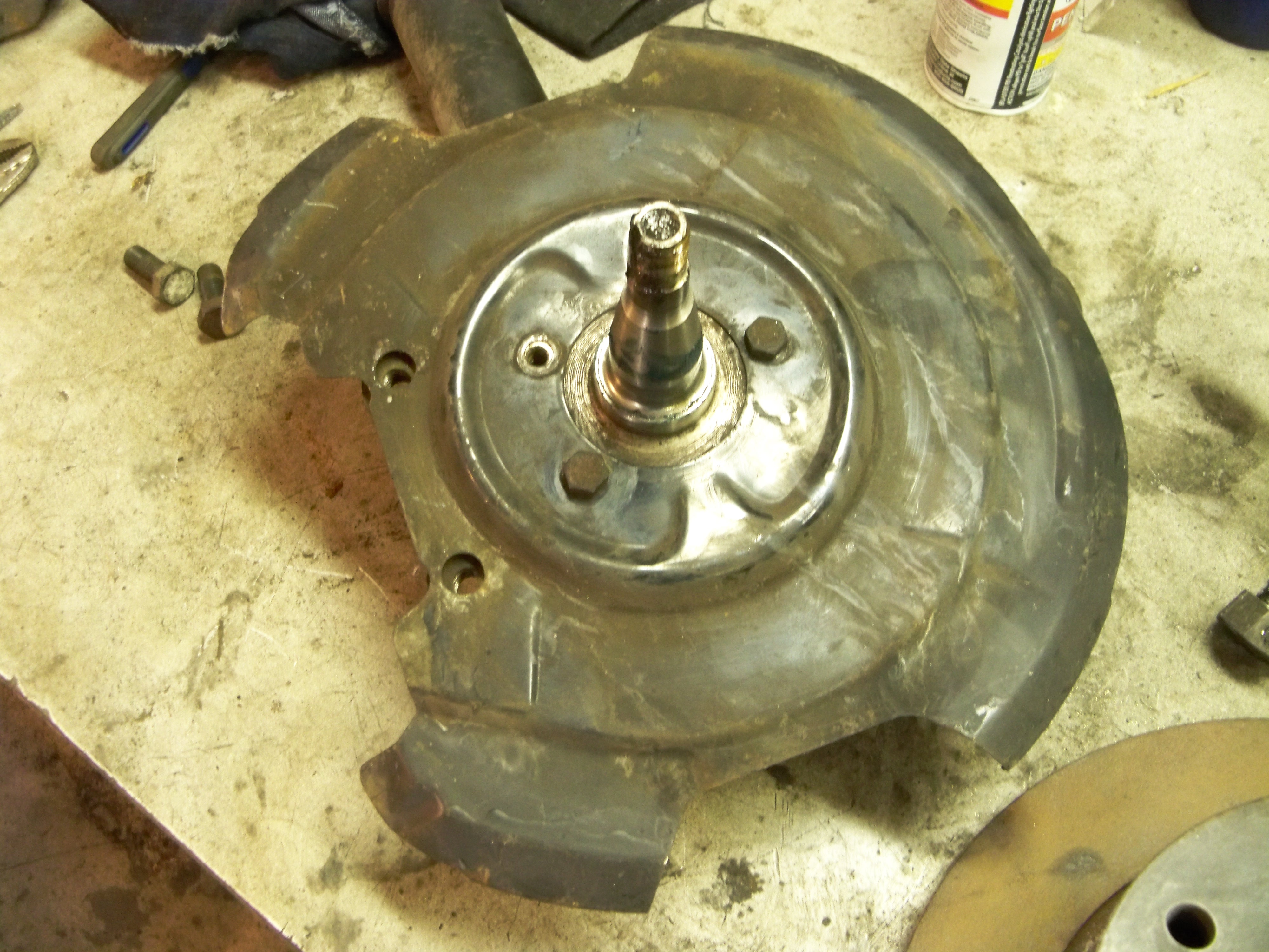

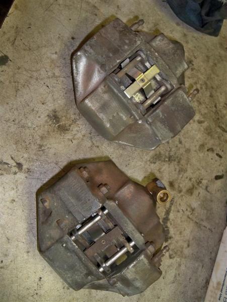

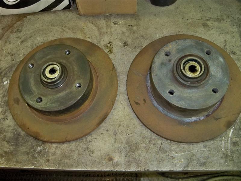

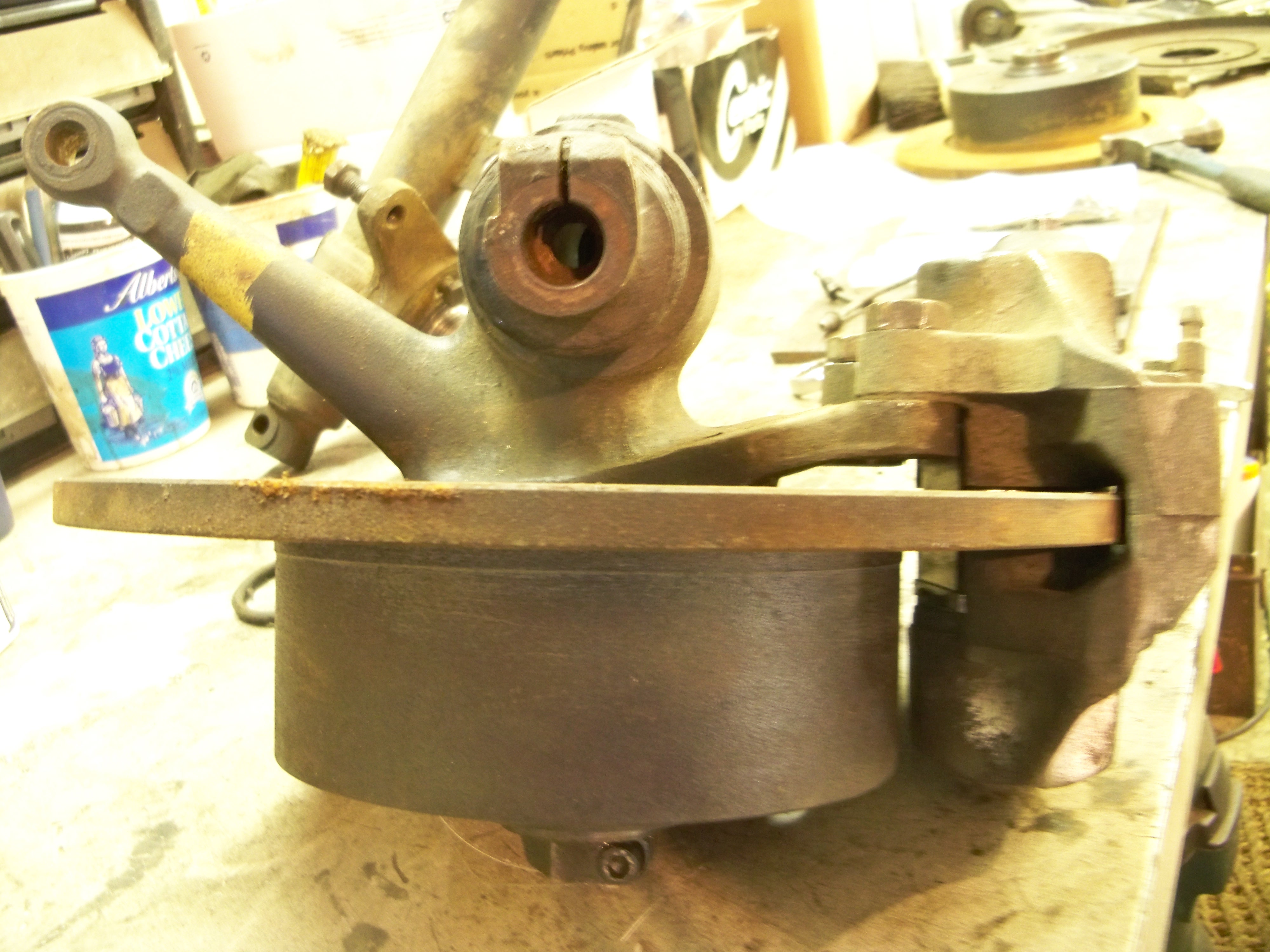

Ok Ok... I got a bit preoccupied w/ Finals. (IMG:style_emoticons/default/confused24.gif)

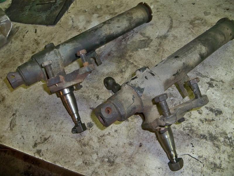

So the answer is ....YES!
not really interested in this debate as to whether or not there were 2 or 3 different rotor/hat variants, but there are 2 available currently, Early 70-72 and late 73->.
First some pics of what were working with, Early vs late struts, back plates, rotors & calipers.

Very useful information. That's what I suspected. Thanks for taking the time to clear this up. Practical applications:
You want to run a rotor with a centering ring on your early car (found a pair of late Fuchs?) - Use late model calipers and rotors.
You want the deeper pad depth of the later caliper on your early car (longer lasting for racing or street applications) - Again, use the late model caliper and rotor combo.
You want to run the lightweight Brembo calipers without the spacers on your later car - Use the early rotor.
You want to run 911 Fuchs on your 914 and simply stud the rotor (slightly less expensive than studding the rotor and machining off the centering ring) - Early Calipers and Rotors. It might be more initially to purchase the early calipers but after you change out rotors a couple of times, that cost would be realized.
Thanks again Rich.
rdauenhauer
post Aug 26 2012, 09:18 AM
Knee dragger
Posts: 3,869
Joined: 22-March 03
From: Pacific NW
Member No.: 453
One thing I might add is dependent on your early car, you may have to change (or remove) your backing plates (dust shield).
With the early style installed the late rotors will not seat on the spindle.
