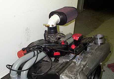

I have a stock 1972 1.7L little porsche. It has the oil bath air filtration on it. The oil bath seems to me like it would rob the engine of air. Since i live in colorado i was thinking the more air the better. I found a k&n filter kit on the 9xauto.com that will fit a 1.7L engine. My question to you guys is it worth it?? Will it help my engine?? i need a new air filter boot anyway because mine is cracked.
Thanks
I know this picture is not a 1.7L but they said it will work

Will all the hoses hook up to this k&n filter system.
Rgreen914
post Apr 28 2004, 04:26 PM
Posts: 285
Joined: 20-October 03
From: West Covina, Ca.
Member No.: 1,266
Based on the number of brass fittings shown in the pics, and they look like standard, barbed brass fittings, all the hoses should find homes; I seem to remember another fitting on top of the filter itself. I've always used K&N Filters whenever possible; I even tried to find one to fit into the stock filter housing (1973-1.7) without any luck so I'm currently running a paper element in it. However, I've got a K&N in my big block Suburban and ran one in the big block dually I used to own.

If I'm not mistaken all the hoses attach to the boot, not the filter housing anyway.
I used a K&N motorcycle filter on my 1.7 liter when I ran in SCCA ITB. All I did was cut the boot in the middle and insert a piece of thinwall steel tube so I could rotate the inlet to a better position for the K&N. Then I used another piece of steel tube to attach the filter element.
I'll see if I can dig it out of my pile of old parts and take a pic.
