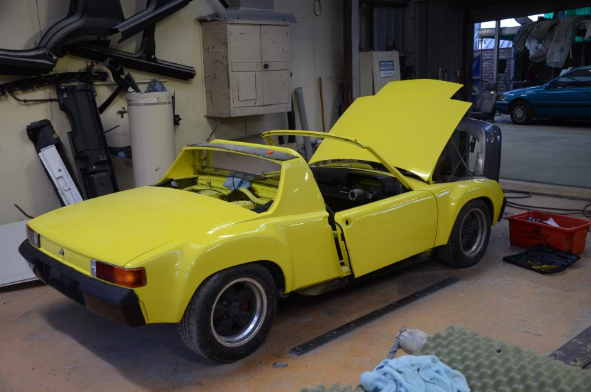

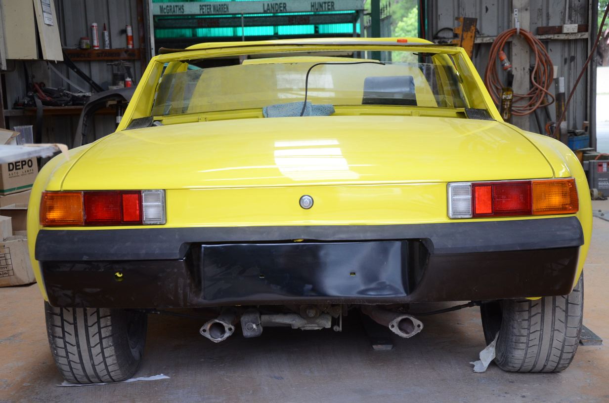

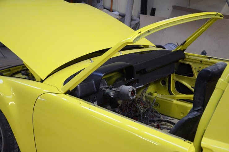

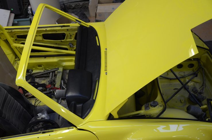

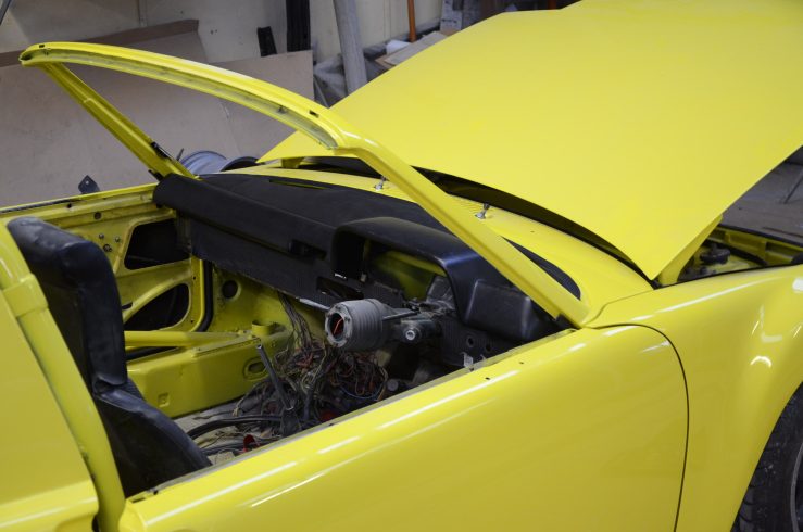

Progress is slow and the task is huge and I admit to feeling overwhelmed by it all. I hope I can see this through to completion.
You guys that live in the U.S. don't realize how good you have it when to comes owning these cars. Talk about the tyranny of distance. Waiting for parts, having no-one around to help out or go visit with, swap meets, early morning runs with friends etc etc. I just want go for a drive in it.
I've got most of the panels back on without any real drama. Doors need further alignment, hoods are good to go, got the dash back in but glass isn't.
Still so much more to do though...electrical, sideshift conversion, new exhuast, fuel system overhaul, pull the fan housing and check for dead rodents, get engine going after not having run for 11 years etc etc.
I'm going to be asking lots of questions here in the next few months, some of them dumb/obvious but keep in mind my situation.
So thanks to those that have helped me with parts and advise so far.
Some more pix attached of the work to date.

I know of two 914's here in Sydney, Downundermans beautiful original -6 and mine. Over the 20+years of owning mine I've seen maybe 10 in total, some of them goers and some not.
We did the rhd conversion in 1988 (pre digital cameras) and didn't do any pictures. The beauty of the 914/early 911's is the central steering pinion which makes the conversion a cinch. Here's how we did it.
1. Pull the dash out.
2. Cut the bracket that holds the steering hub and lift it over to the right and weld it back up again.
3. Move the pedal assembly and brake master cylinder over after modifiying the right side of the firewall to accomadate them.
4. Cut a section from the fuel tank to allow it to drop into the smaller space for it because of the firewall changes (You lose about a gallon of tank capacity as a result).
5. Disassemble the dash, cut the dash up carefully into six sections, align the instrument binnacle and switch panels correctly in relation to the steering hub, weld it back up and have it recovered.
6. Re-fit the dash and you're now driving on the correct side of the road. (IMG:style_emoticons/default/biggrin.gif)
I would love to see more Aussie 914's so ship as many as you like when you come over, Rod.
Colour is one I matched as close as I could to what was in the hell hole, it's not a custom colour but I don't know the name of it. I suppose I should find out.
Thanks again to all for the positive comments, they're very helpful and keep me inspired to move forward with the project.

It certainly is summer here, last week we had a couple of +40 Celsius days so not much work was happening then.
If any of you want to come over and help you're more than welcome. I ain't joking.
Oh yeah I forgot to mention the handbrake...Notched the rightside inner long and mirrrored it.
Phil
